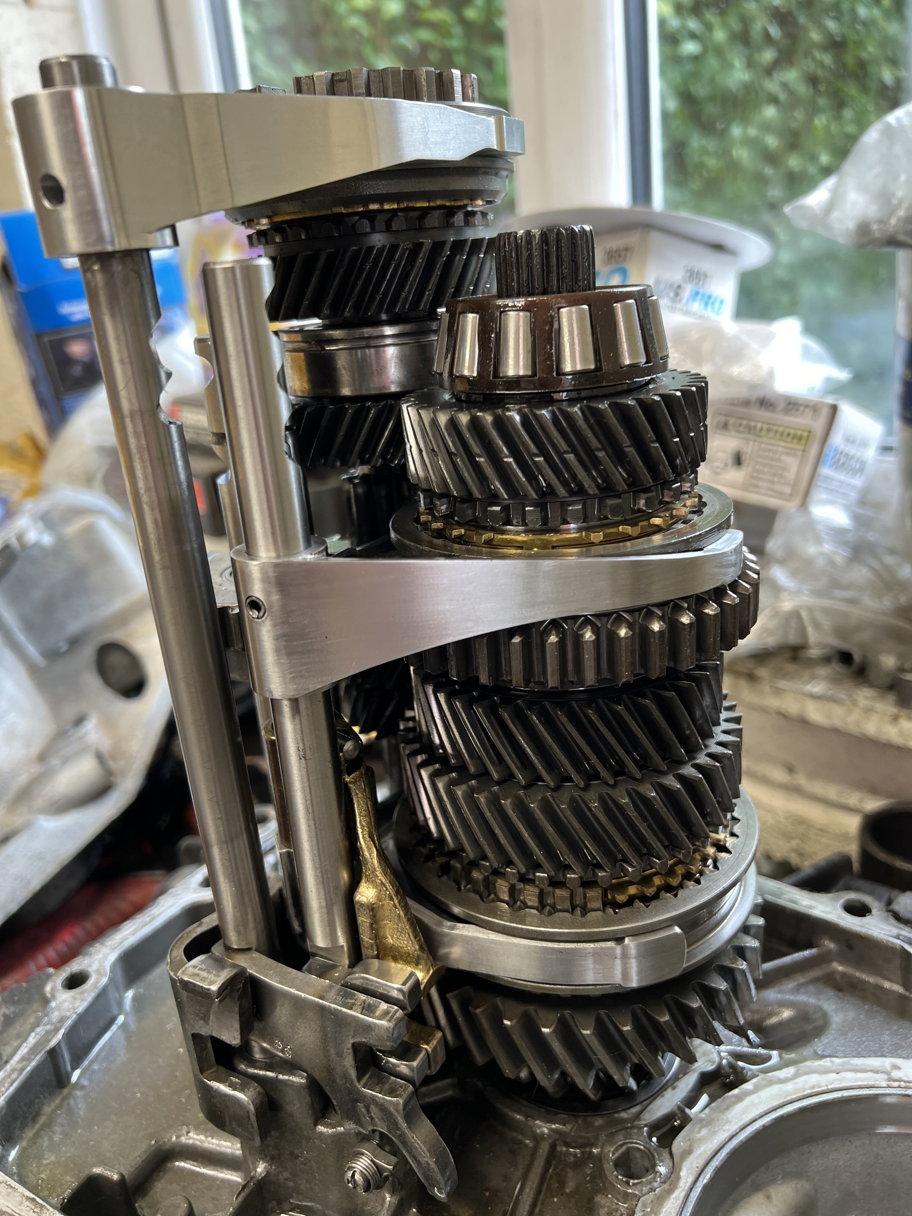

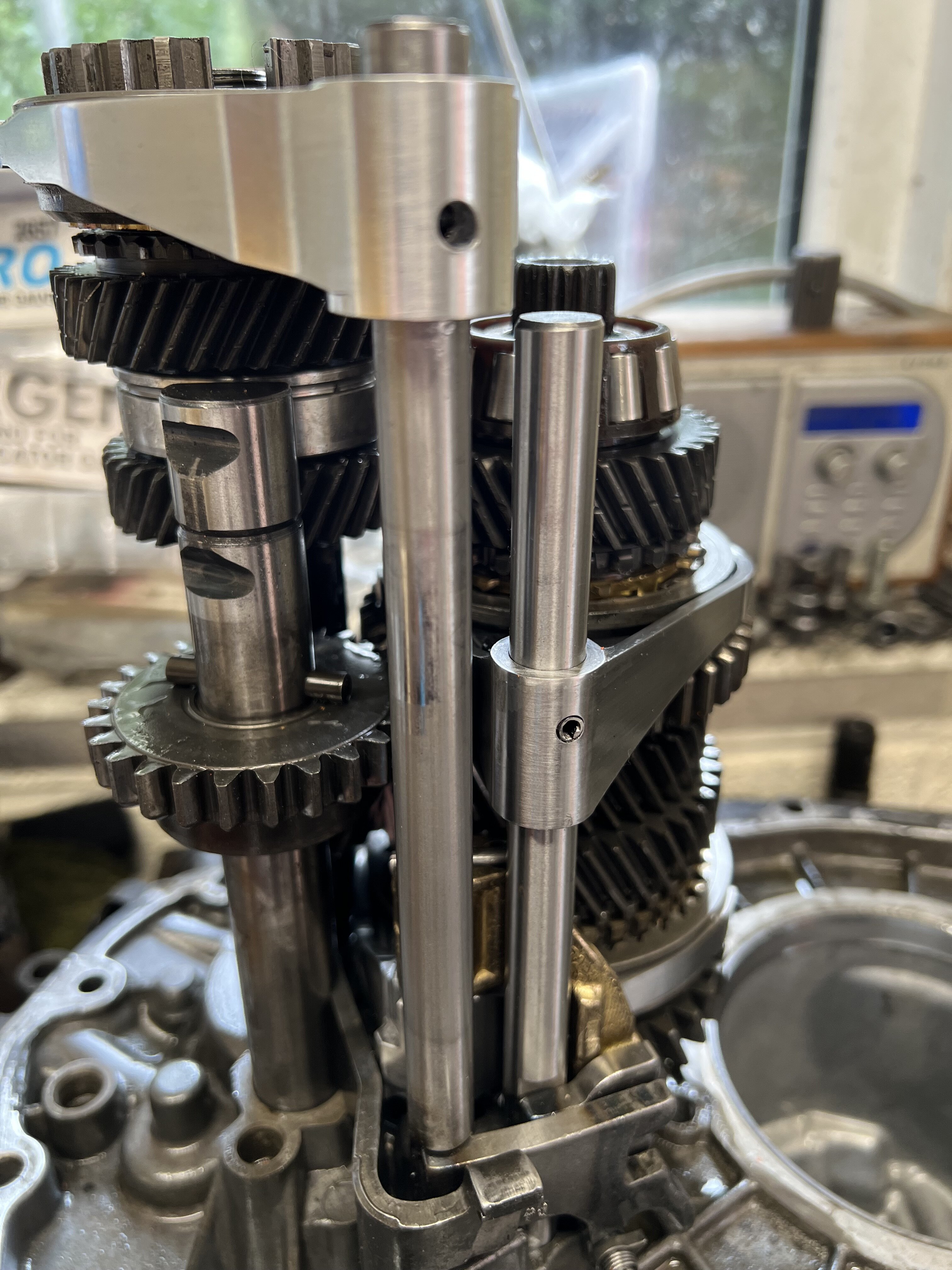

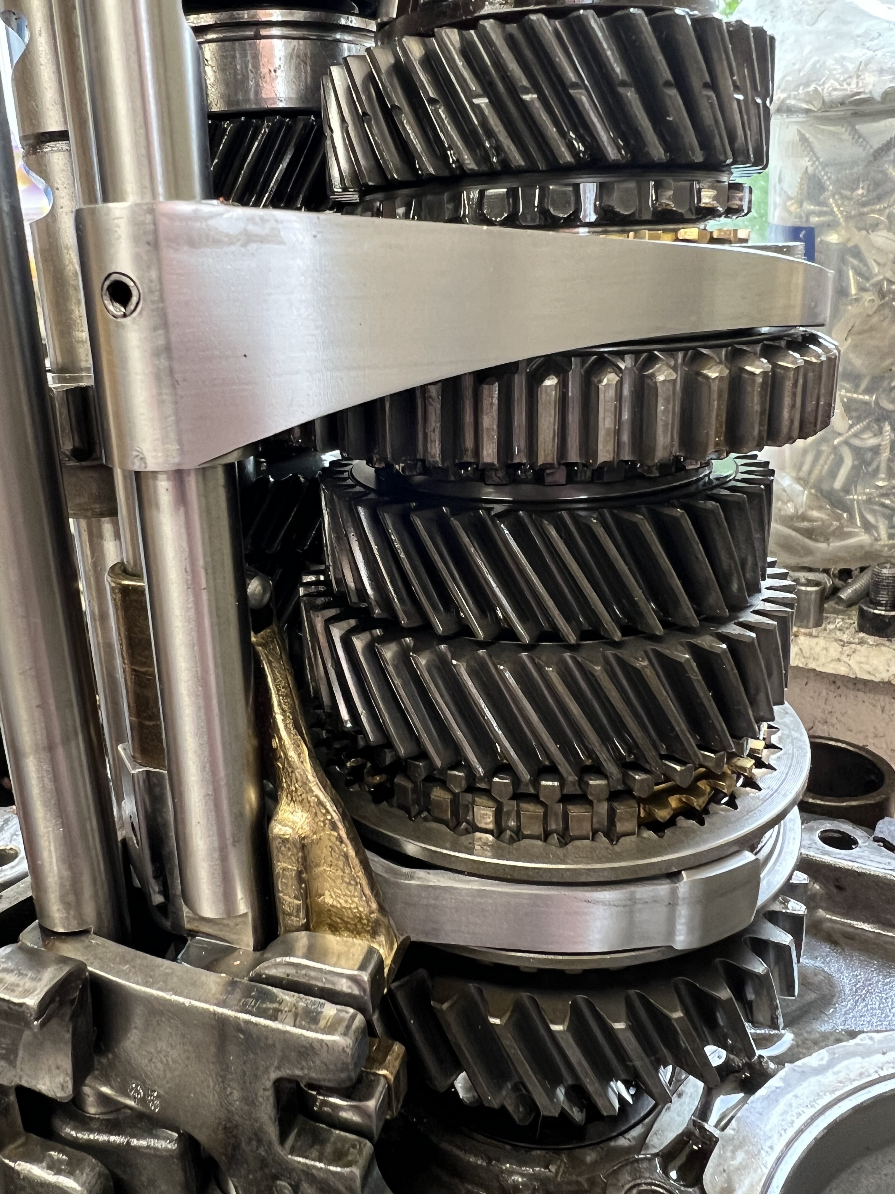

NorthloopCup
Cliosport.net exclusive here folks. Billet forks are here with me and I’ve installed them in a test gearbox to make sure they’re ok.
The fit is like a glove, and the quality is bang on. And it’s safe to say, they look the part as well!
Next step is to put them in the development gearbox and wave them on their way to see how they perform.
I am very confident though that they won’t be an issue.
