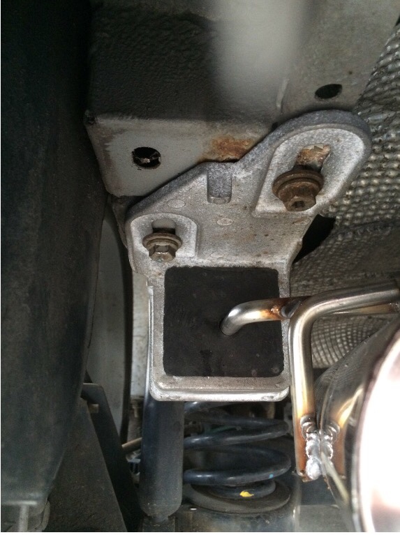

Any chance of pics underneath mate? On my 172 cup it drones at around 3000 to 4000rpm which is annoying at motorway speeds. Under that and it's acceptable but I know the tip is visible

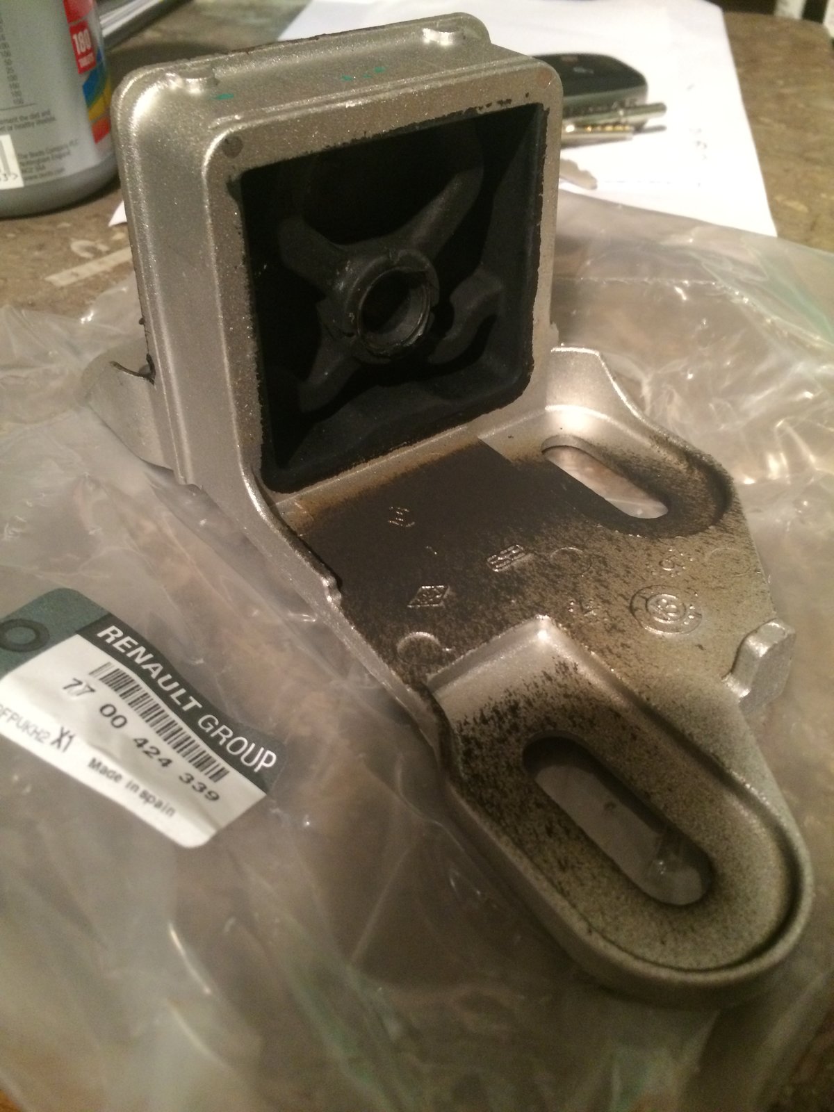

Despite only fitting a new rear exhaust hanger less an 2k miles ago, the £9 one from eBay was split. No wonder it was noisy, was sitting on the alumium hanger and resonating through bodyshell. Fitted a new genuine renault one £14 from eBay. Much better now .

My rear mount lasted 2 months. Is vibrating on idle now. So annoying. Going to make my own mount soon.
Have you seen the powerflex inserts for these? Or @levaz ones that he does? They look very good imo.
I charge £35 delivered for those.
They come either blank for you to drill your own hole (to suit box height) or i can drill a hole centrally for you
They're much stronger than the oem ones lol.
Been running mine for nearly 2 years now after doing 2 genuine renault ones in 9 weeks!
