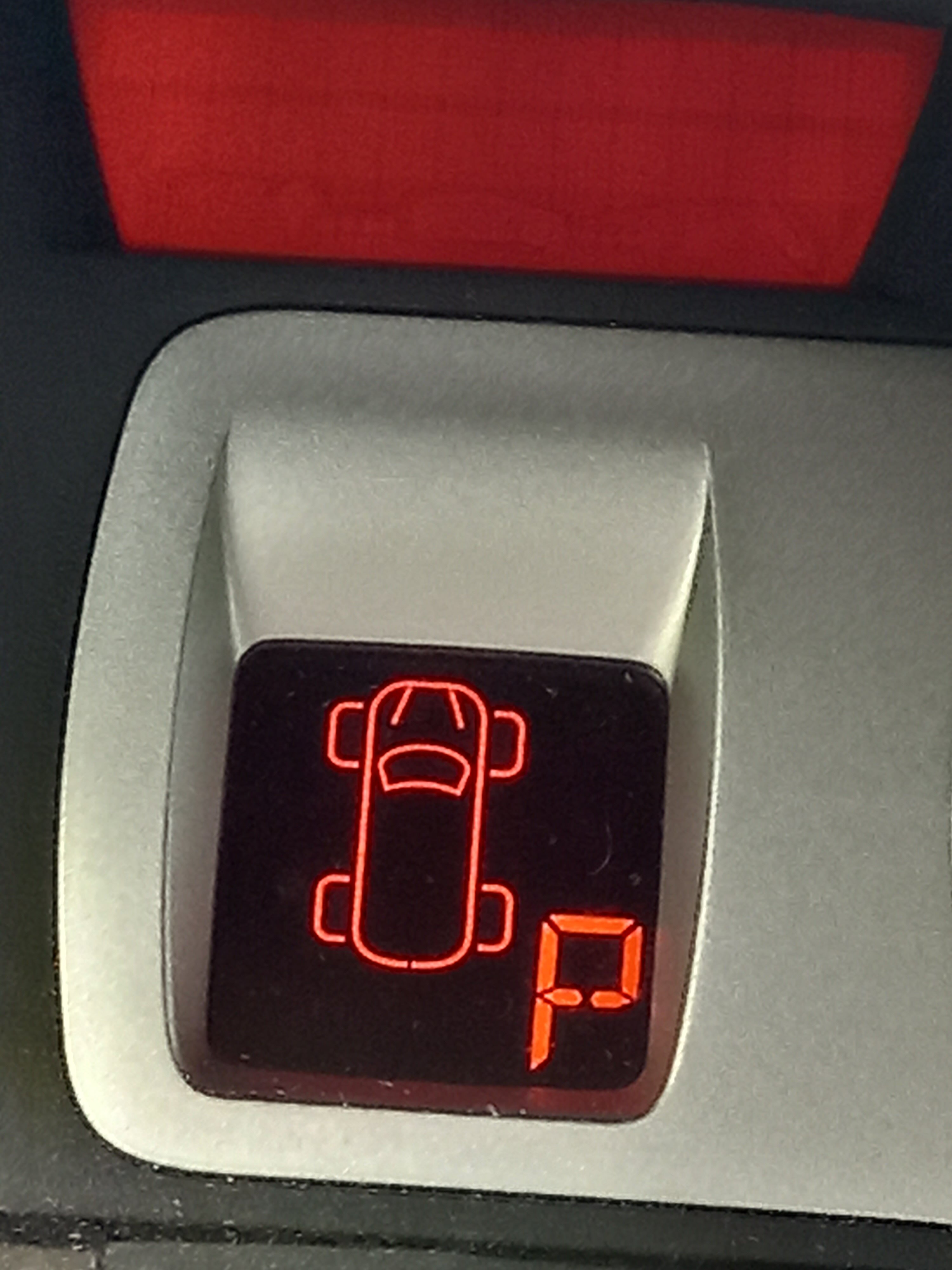

I have a problem with my car( REN CLIO III ) It is when I start the engine, the odometer appears for a few seconds, then disappears, and then the screen becomes like a digital wristwatch when the battery power is low. This photo I took from my car shows only the orange screen color without numbers.

I assume you’ve toggled through the display with the button on the stalk to see if that works.
Only other thing worth checking is the fuses below the steering wheel.

Tomorrow I will check the fuse, but I do not know its exact location, and it seems that I will use YouTube or the Internet.

Looks like a faulty cluster. You could try these places on eBay where you send away for repair
I knew the reason, I just started the car, the numbers were there, but after a while they disappeared, due to the high temperature of the engine.
Looks like I'm going to take my cars to a car repairman 😔
