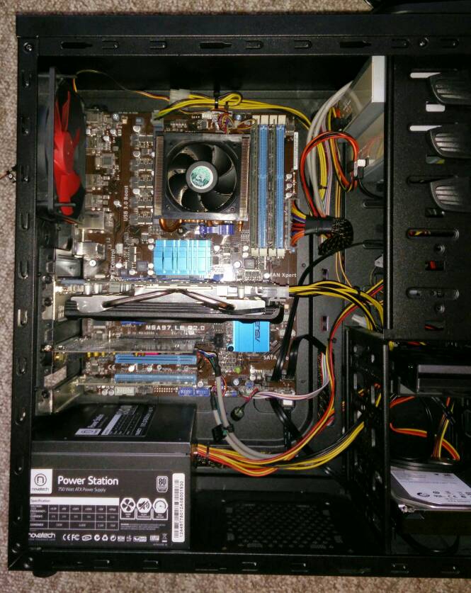

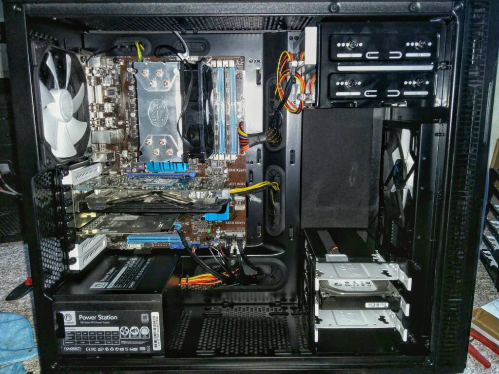

New case (define R5) and cpu cooler (hyper 212 evo) arrived on saturday. Never realised how fiddly a job it was replacing a cpu cooler! Could've done with 3 hands trying to get it all back together.
Love the new case though. Much neater inside with all the cables tucked away at the back. Excuse the horrific photos here.
Went from this:
To this:
No idea how well I've applied the thermal paste for the new cooler but it certainly doesn't seem to be running as hot under load any more. It's much quieter too.
Did you fit the heatsink while the motherboard was in the case? It's not hard at all if you do it on a desk (or if you have a case with decent access)
The only change I'd make to that m8, would be to ditch the flexible SLi bridge and get a fixed one. I had issues with a couple of flexible bridges back in my GTX460 days. Blue-screening, sometimes saying that SLi was disabled when I'd only just put it on, etc. Switching to a rigid one fixed it immediately - plus it does look smarter with one fitted!

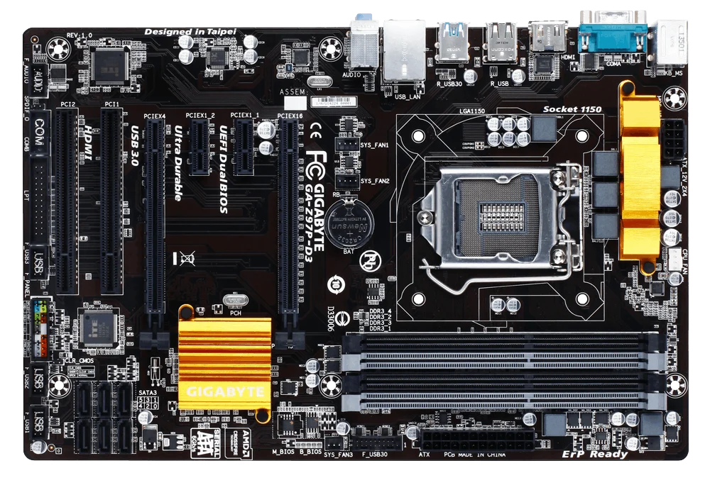

So everything arrived for my new build, the only thing I used from my old build was a corsair 450w PSU and the 4x Hard drives.
I built it all up to the point of turning it on and all that happened was the fans span up - then died. Same thing over and over.
So I stripped the graphics card, same thing. Took the ram out, same thing, removed everything apart from the PSU and mobo, tested the PSU and thats fine, tested the mobo with another PSU and it still pulsed the fans. My conclusion was a faulty motherboard? Ended up building up my old set up in the new case and everything works fine again.
My only concern was that possibly the 450w PSU wasn't enough to power the motherboard but surely 450w is fine for just the motherboard alone. I can understand if I plugged the graphics in and then it started having problems. Replacement board is arriving tomorrow.

Did you test the motherboard outside of the case? May have been a shorting issue against the case
Yeah I took it out and tested it resting on the box it came in and had the same thing,
Corsair cases stand off's for the motherboard where absolute s**t and nearly every other screw rounded off in the stand off forcing me to replace the painted stand off's to normal brass ones which where fine - thats where I thought there could be a shorting issue but I have my old set up running in the new case all fine right now. Never the less its going back on RMA due to the crap parts and massive air bubbles in the sound proofing (and its also not in the lease bit a "quiet" case imo).
Received the brand new motherboard replacement, tested it on the box with nothing connected but the power supply, my test power supply doesn't have the 4 pin connector ( I will try my 450w power supply shortly with the added 4 pin as obviously its lacking power ) but WITH the 4 pin 12v connected the other day it still pulsed the fans and wouldn't kick into with the bios screen? I will do some more testing later but there cant be a problem with this mobo as well. Do I need a stronger power supply? or am I missing a simple trick.
I guess the only way to find out is to connect my 450w up when im finished work and see.

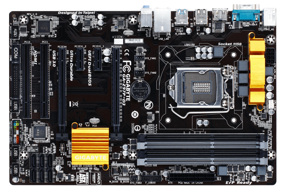

Motherboard: Gigabyte Z97P-D3
There's a guide on TomsHardware for computers that won't post. You just need to work through that as it says (i.e. not skipping bits because you think you know a certain component is fine).
The times I've had the symtoms you describe was when I forget to connect the CPU 12v rail. But it could be anything really which is why I'd recommend going through the guide if you're stuck.

Thanks for the response - I think I'm missing something as well, been a while since I built a PC so probably something simple.
I will remove the battery on the mobo when I get home and try and re set it . I'm reading something about it being stuck in a boot loop.
Ordered a 550w psu to play it safe have got a lot running on it after all with a more powerful graphics card etc.

It won't be load on the PSU. A dead PSU maybe, but not overloaded.
When your PC boots it's using next to no power.

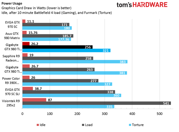

You'd be surprised at how little loading even high end PC's put on a PSU.
Power
To test power consumption using our reference platform, a bit of creative math is needed. Since Haswell-E processors don’t have integrated GPU cores, we can’t boot the system without a discrete board installed to get a baseline. We are able to estimate consumption based on the approximate power draw of the test bench, though. In our observations, we’ve found that the approximate power draw from everything other than the GPU is 120W. By deducting that from the recorded wattage reported on our in-line power meter, we can calculate the approximate draw of the GPU.
So it's unlikely to be PSU ? On my 450w when everything was plugged in the case fan stopped and started.
My test 550w I had the motherboard plugged in but it has no 8 pin plug, when testing it with that both the case fan stopped and started and the psu stopped and started.
That was just psu and motherboard plugged in.
So I'm not sure what I'm doing wrong? I read that without the 8 pin plug the motherboard won't post bios ?
When I have the new psu wired in today I'll see what happens, I'll put the cpu / hsf and one stick in and see if i have any luck !
That last post doesn't paint a full picture.
Question: Do you have power connected to the CPU plug on the motherboard (I believe it's 8 pin for Haswell and later but 4 pin for anything before).
Top right of the picture, and bottom right. You need power to both of those black plugs. (If that is the motherboard you've posted)
You'll also need CPU and RAM in (and a graphics card if it's not got onboard), or it won't POST)
Ok thanks cookie, first time I built it all up I had both of those in and I had the fans stopping starting problem. But I have a few more things to try tonight, also there is no on board speaker for beeps so I think I've read if I plug a speaker I go the line out I might be able to hear and fault beeps. We will see - cheers.
Cleared the CMOS etc, didnt even open the new PSU used the original, think there could have been a few simple errors from me before a possible short to the case as suggested in the Corsair, too hasty to call the mobo a failure and send it back, built it up and let it run it didnt post first time, shorted the contacts to turn the mobo off and on and when it re booted it showed the bios screen. Happy days, thanks for all the help.

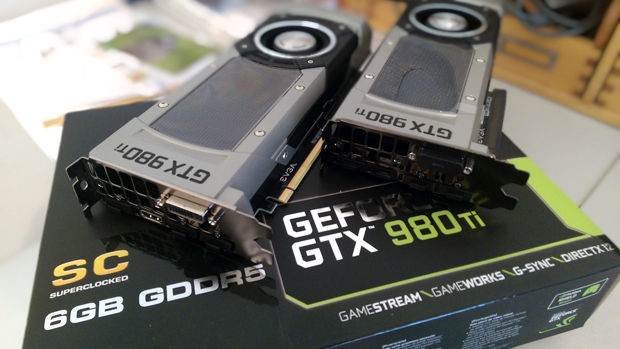

lol bro, I just sold both my TITAN X with EK blocks :smiley:

I'm on a single 980 Ti mate... one of those has been returned as it is faulty.
Fair enough! I'm on a single TX which will be going Monday. Then it's the count down till Pascal :wink:
