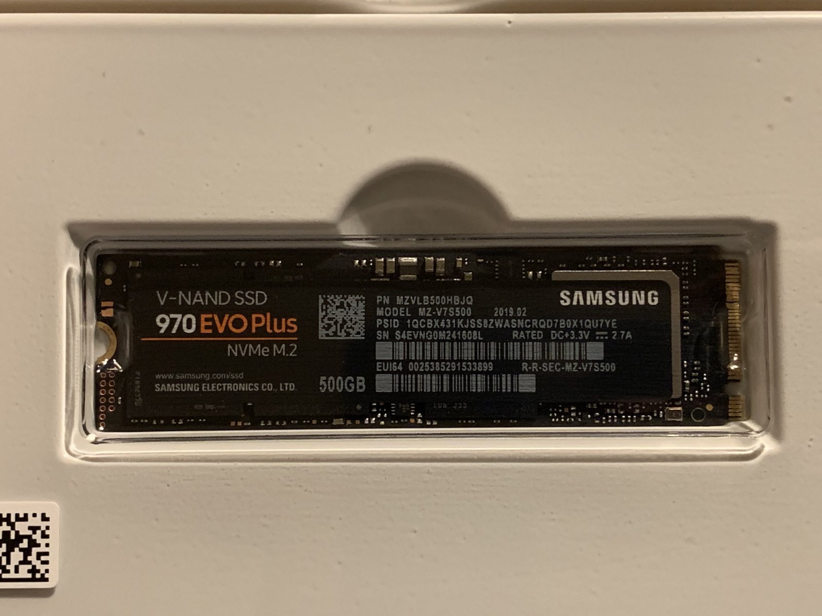

Happy Easter to me ?
1415506

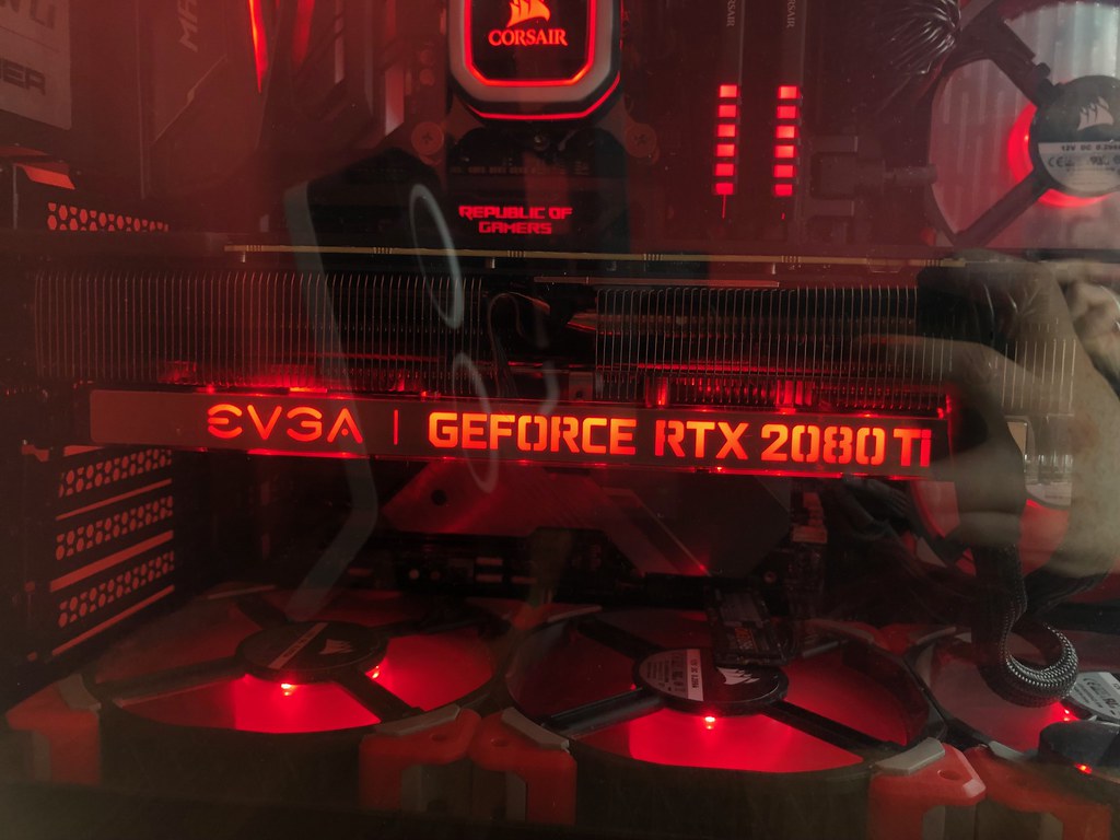

Dont mean to rain on your parade, but I hope you got a good deal as Nvidia are releasing the super RTX cards next week I believe and the 2080 ti is going to be a whole new chip at the same price as a normal 2080 ti and the "standard" one is getting a price reduction...
There is no information/leaks regarding a 2080Ti Super. Only up to a 2080 Super. The only thing this'll have over the 2080Ti is 16Gbps memory speed compared to 14Gbps. This is based on current specs leaks.
Also, I'm not one of those folk that constantly think, oh should I wait or buy now, oh should I wait or buy now person. I've made my choice and I'm chuffed to bits with it. I've been using my 2080Ti for a month now and love it. There is no parade to be rained on. If i wanted the best of the best I'd have bought (after selling an arm and a leg) the RTX Titan.
There is alot of information regarding the super cards. Including the 2080ti super which will feature a new chip rather then just a memory change.
Wasnt trying to offend you or anything just didnt know if you were aware of it. Glad your enjoying it.

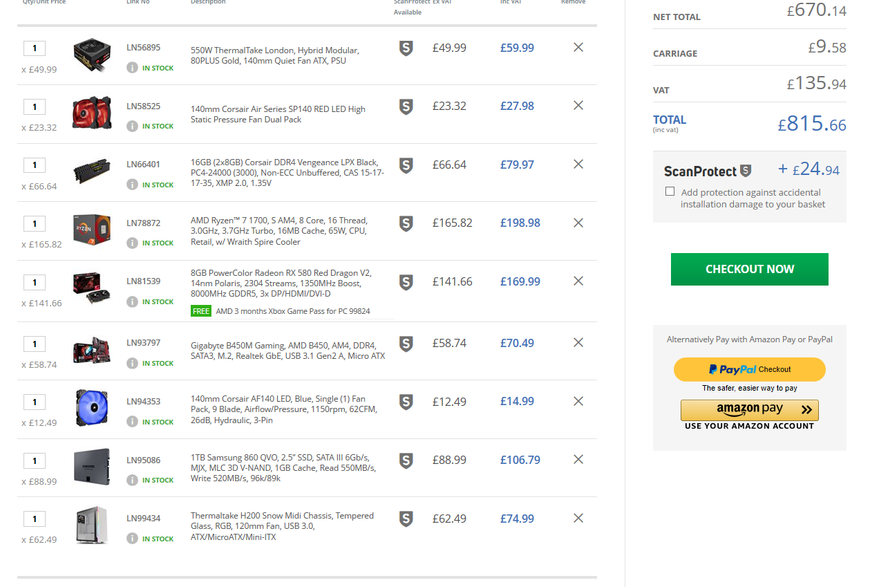

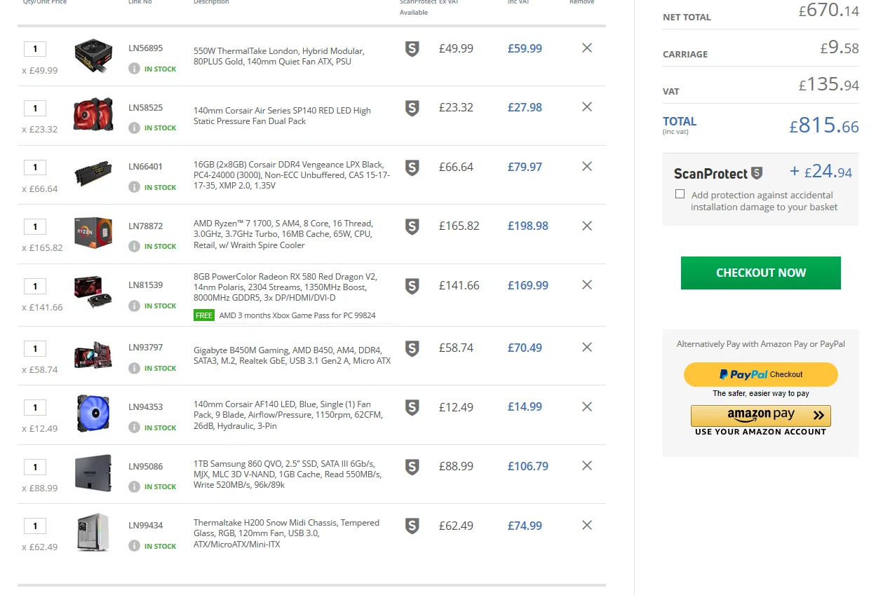

Hi all
My current PC I built back in 2008! still going strong but needs an update (8880 GTX gfx and Intel Quadcore Q6600)
I have a max of £1k to spend I have put a basket together just after advice on possible better components for the money etc.
Thanks
