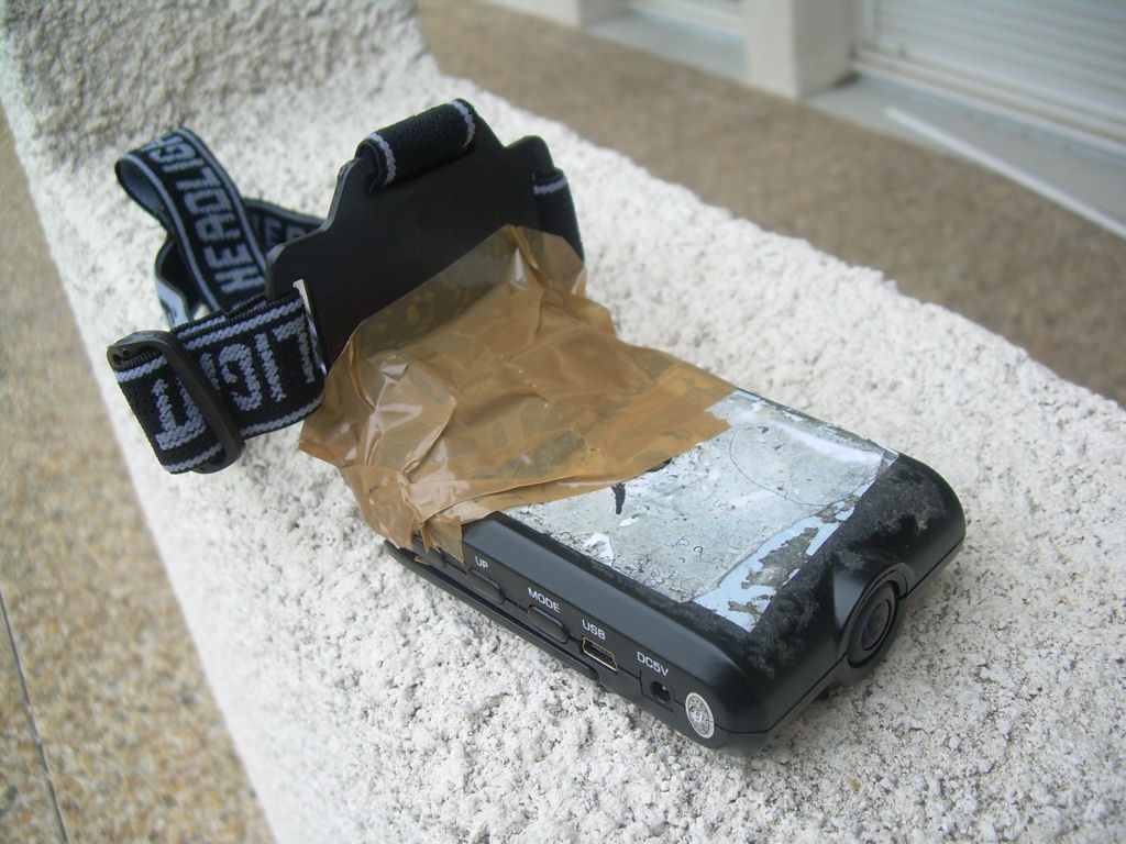

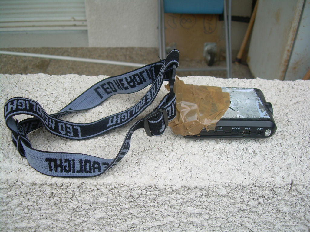

YO everybody
Wanting to test the new frontal position (on my head ^^) of my small camera wide angle, high technology made in "Adhesive tape Scotch" :lolup:, I made a new small video in this afternoon
Arfff you should not be "seasick" LOL
I shall try to move less the head the next time ^^
To INDICATE, the fate doing sometimes well the things ^^, that on the same way as me, I ran and we made a part of the road together (2 in 3 km running in some fast accelerations ^^) with one Clio 3RS phase2 Black that you can see at the beginning of the video
[video=dailymotion;xrg2eb]http://www.dailymotion.com/video/xrg2eb_through-the-windshield-of-my-car-a-travers-le-pare-brise-de-ma-voiture-2_travel[/video]

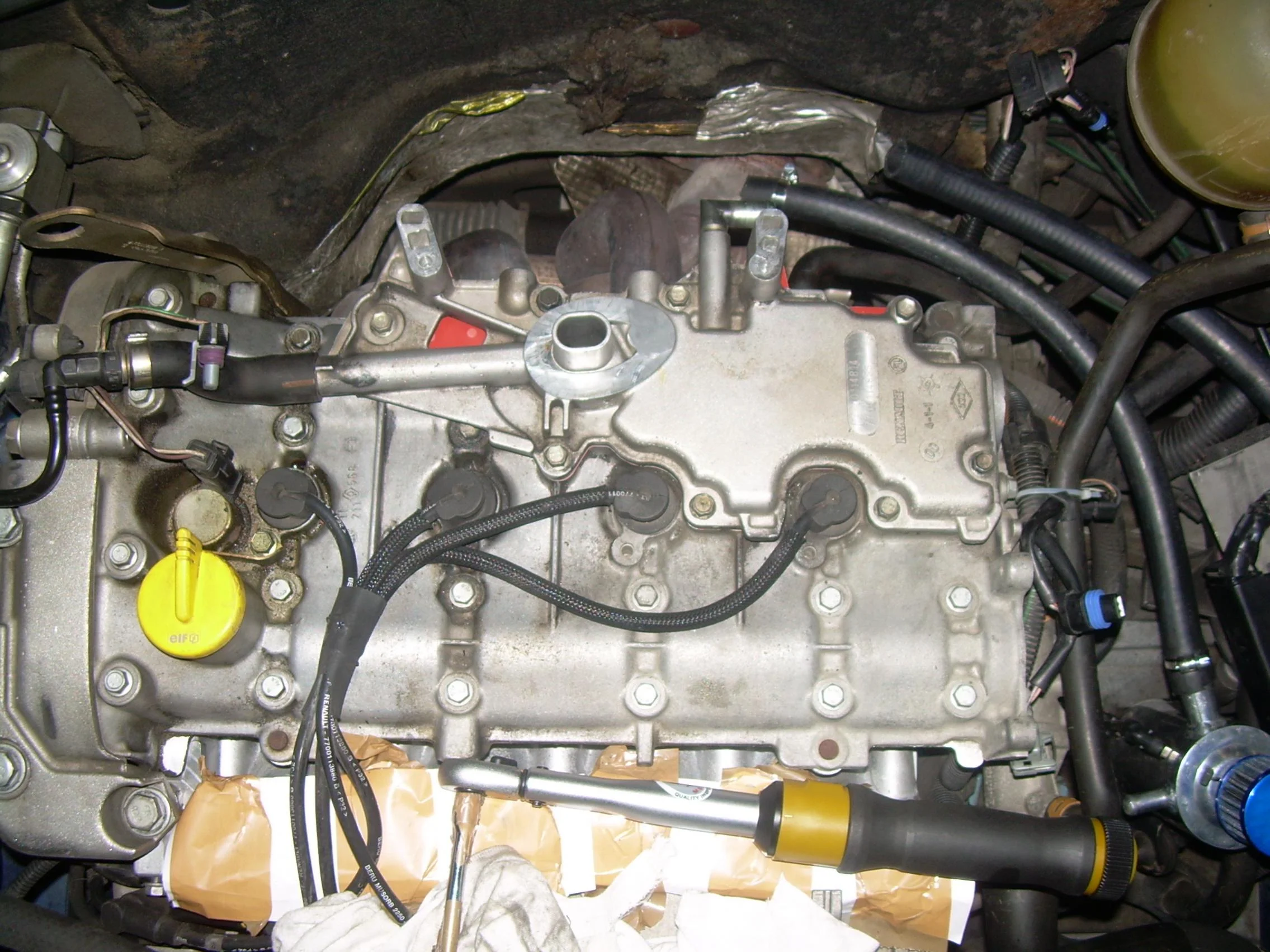

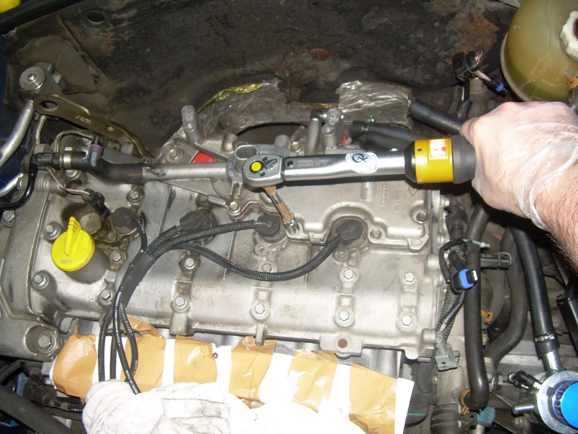

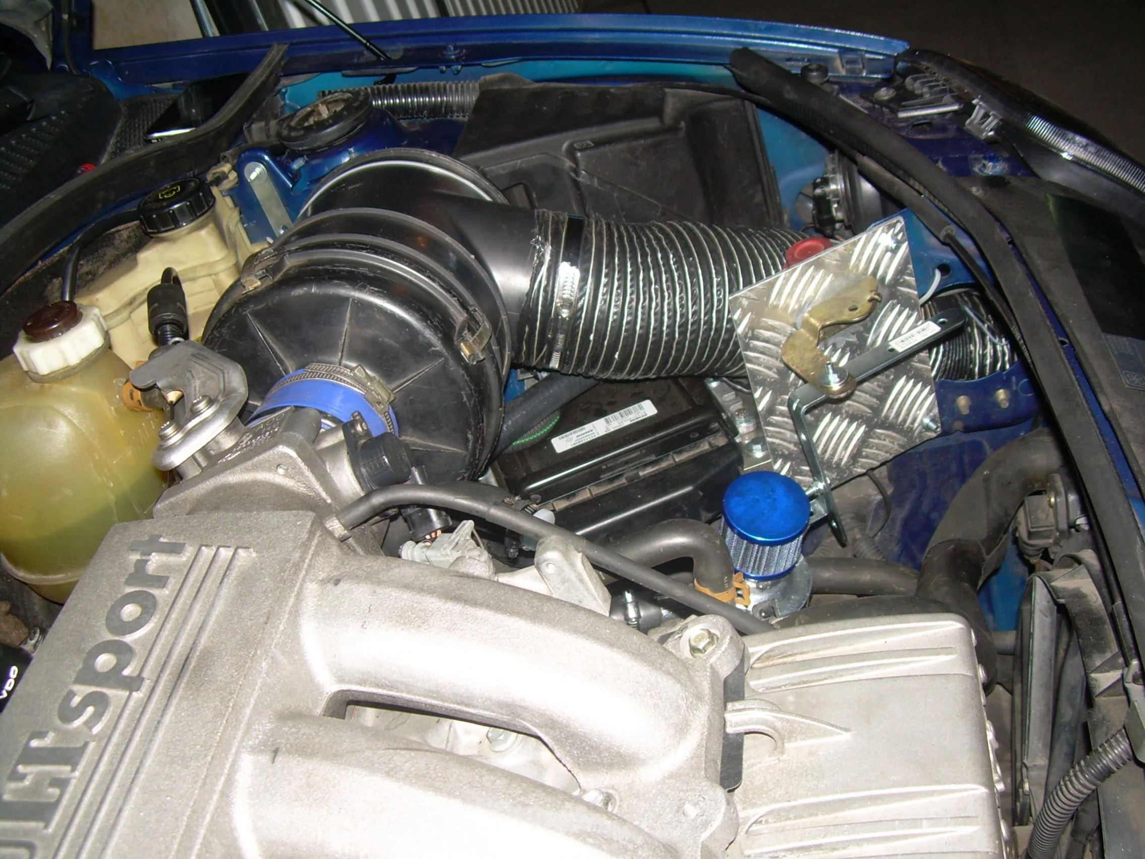

Hello everybody

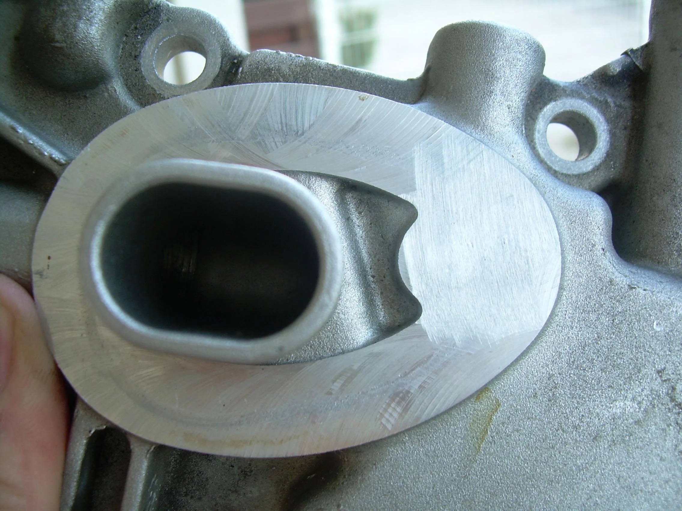

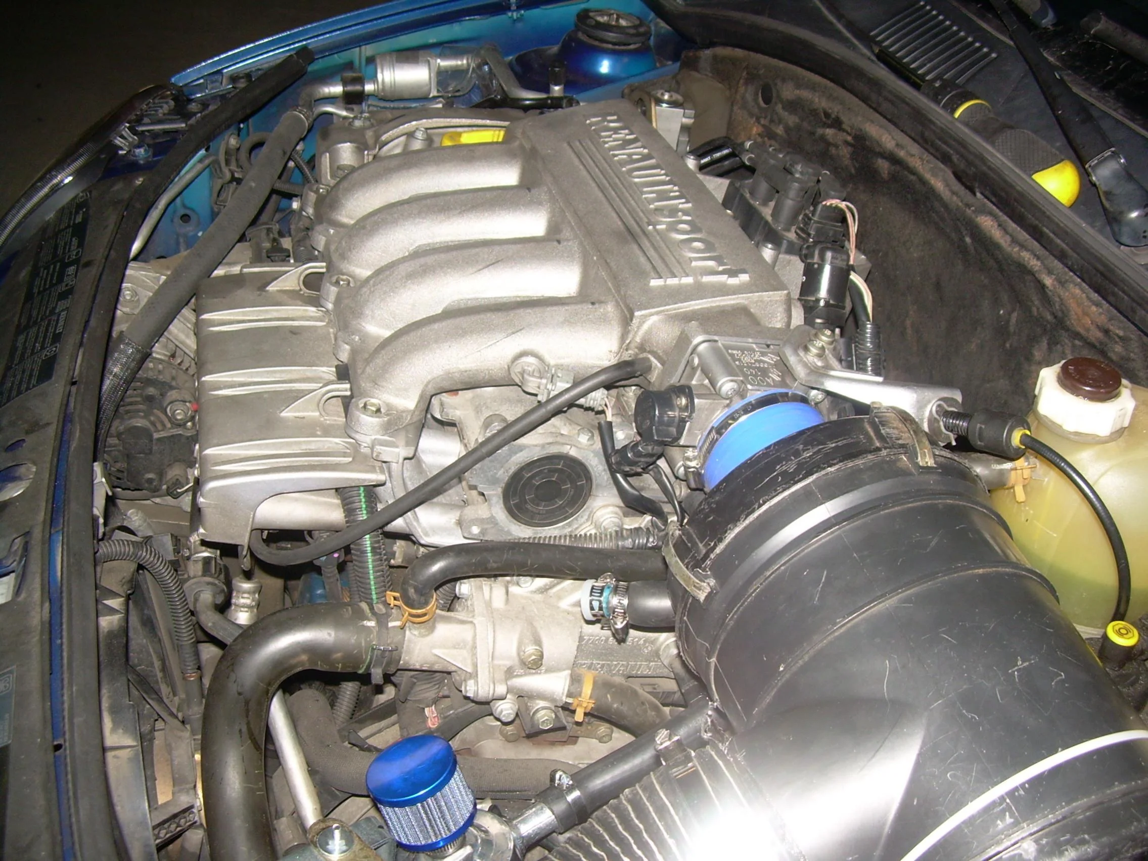

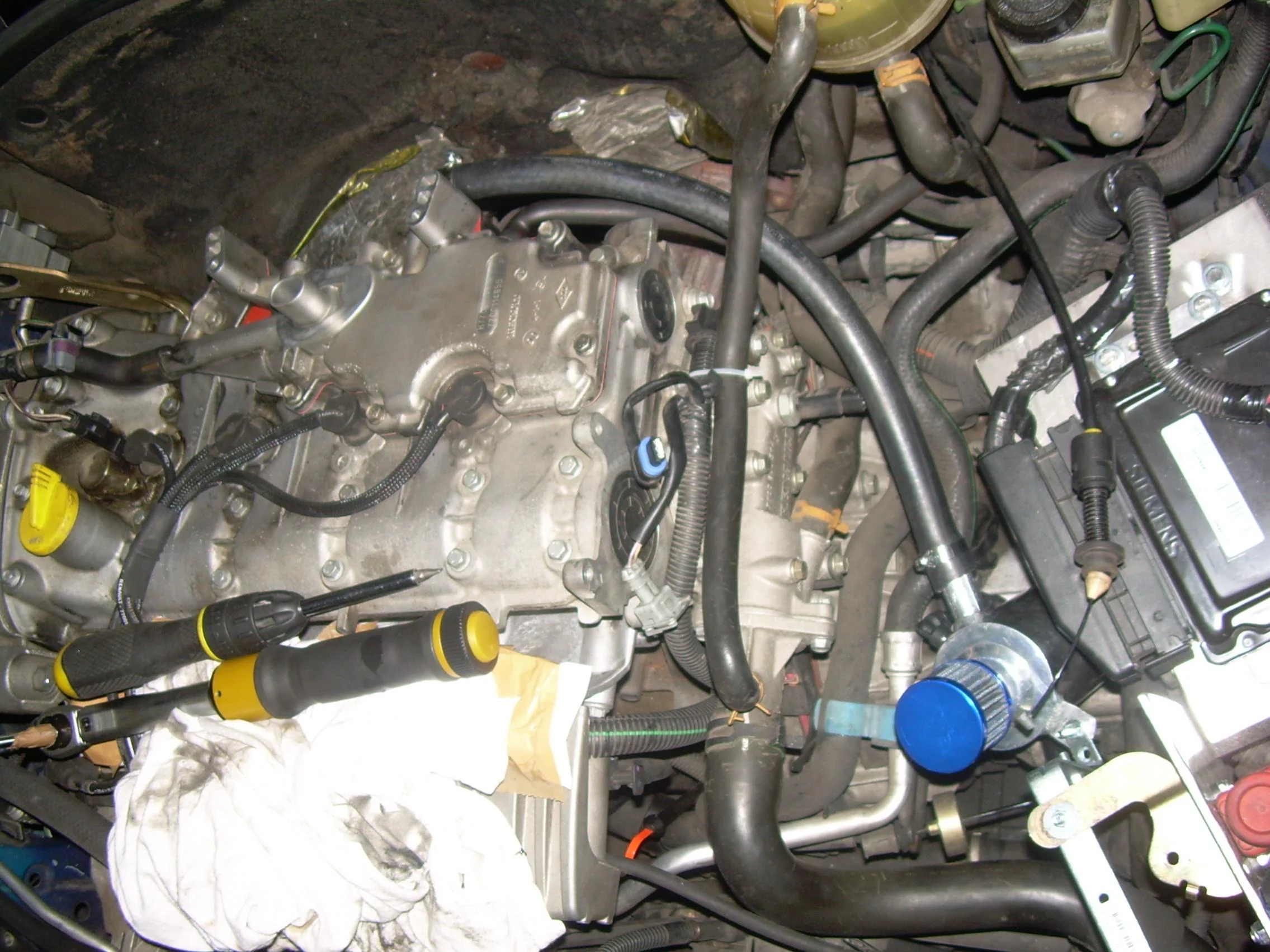

So, My last work in the engine is to eliminate all the returns of oil in the engine and the admission air
Already I have made this for the return of oil in the admission air (under the case "buttefly) by diverting the circuit towards a oil-catch tank and by blocking the entry under the case butterfly

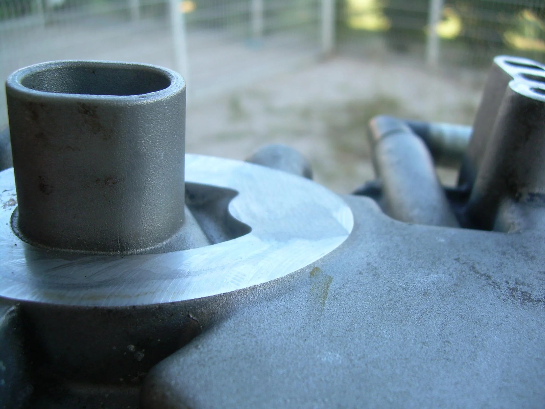

For this last week I "attacked" the last return of oil which go in the plenum by bloking the small hole in the top of the decanter of oil (number 1 in the photo)
attachment.php
I prepared the things for that :)

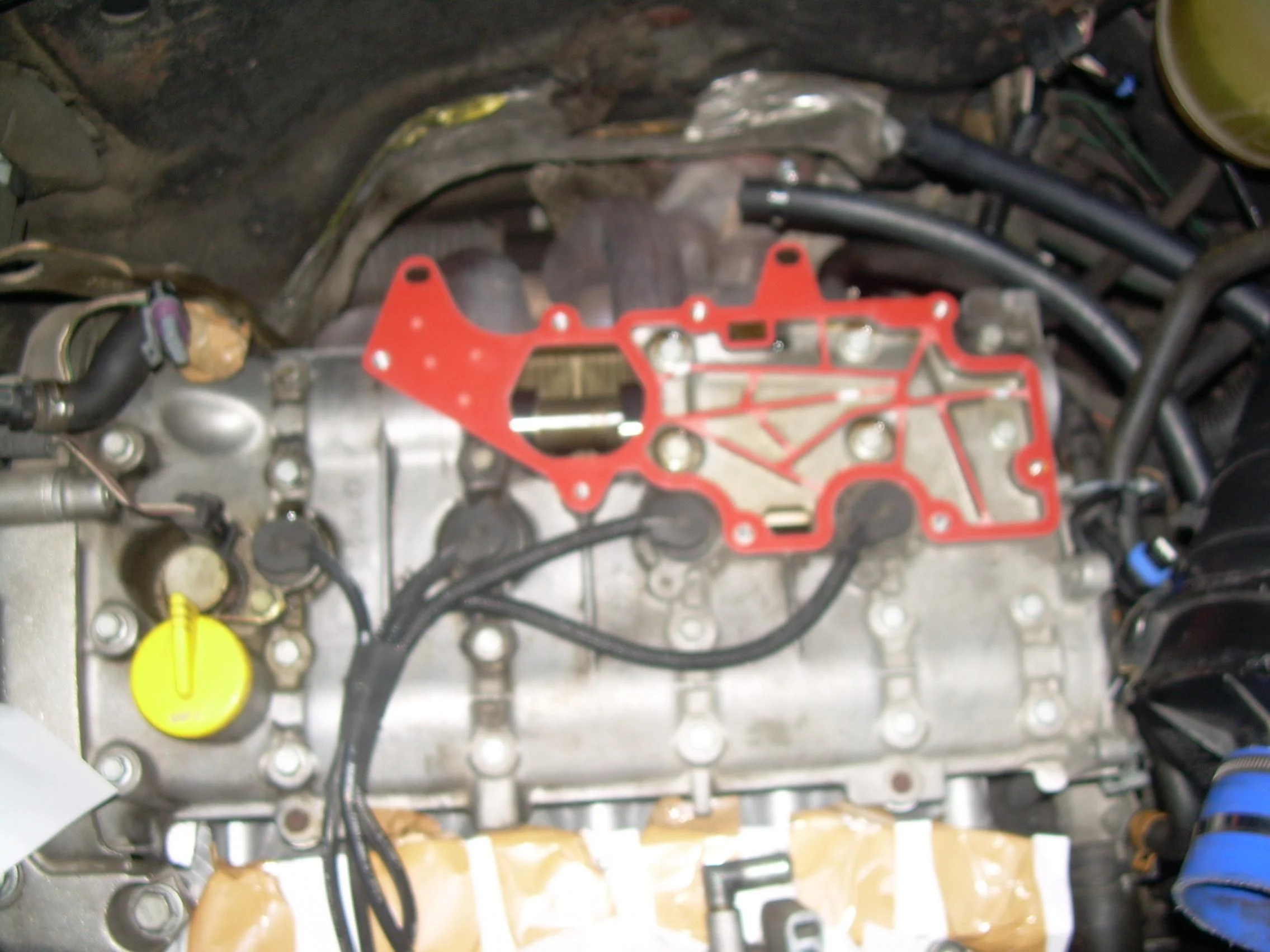

You see in the next photo the joint dough which was in stock on the decanter of oil
I am going to clean because I bought the metalique joint that I prefer
And the same decanter of oil after the cleaning :cool:

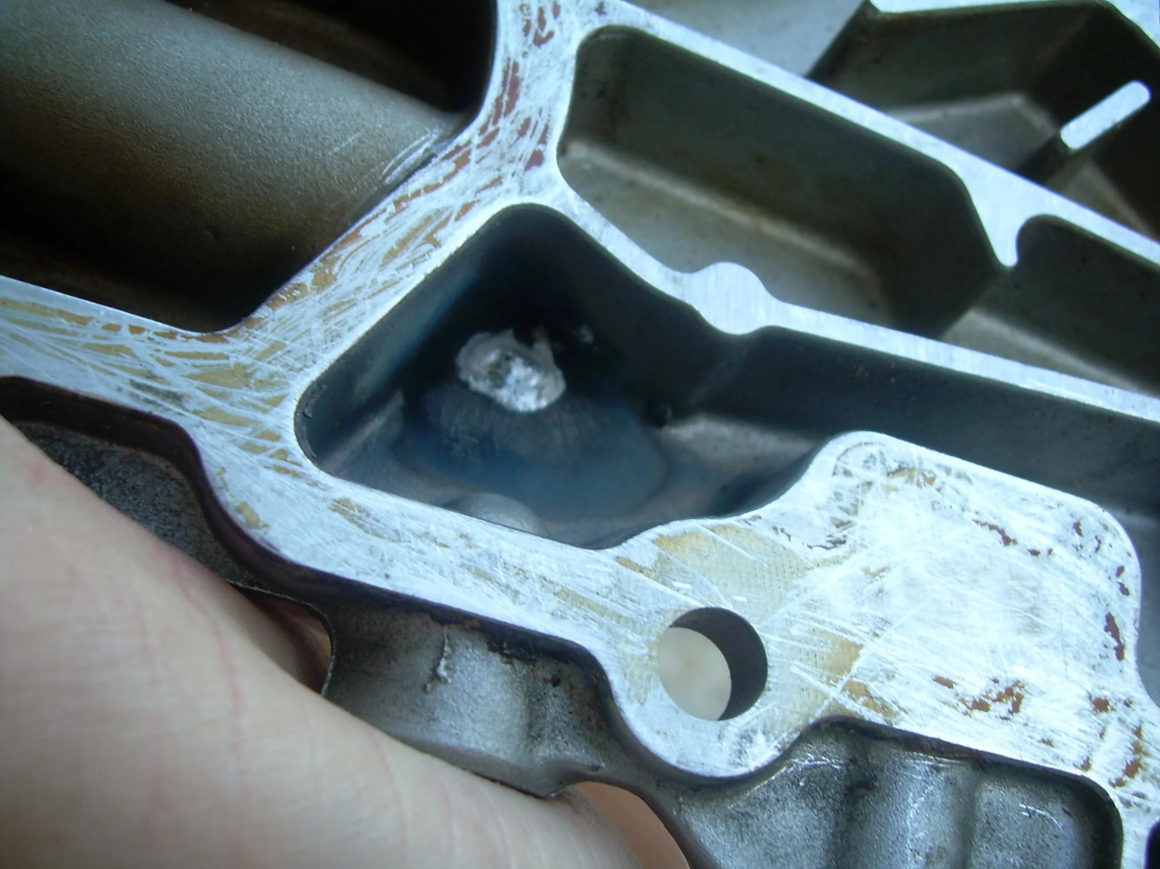

I visited my friend boilermaker to block cleanly the small hole by small welds
And I remounted all that this day :)
Torque for the screws : 13nm for the decanter of oil and 11nm for the plenum :)

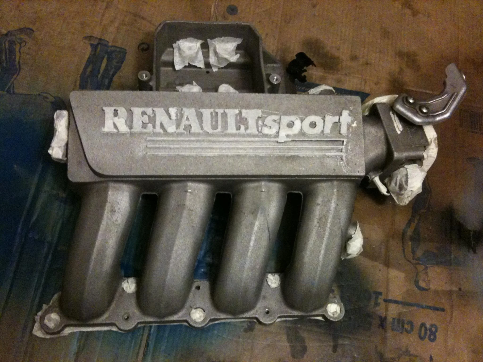

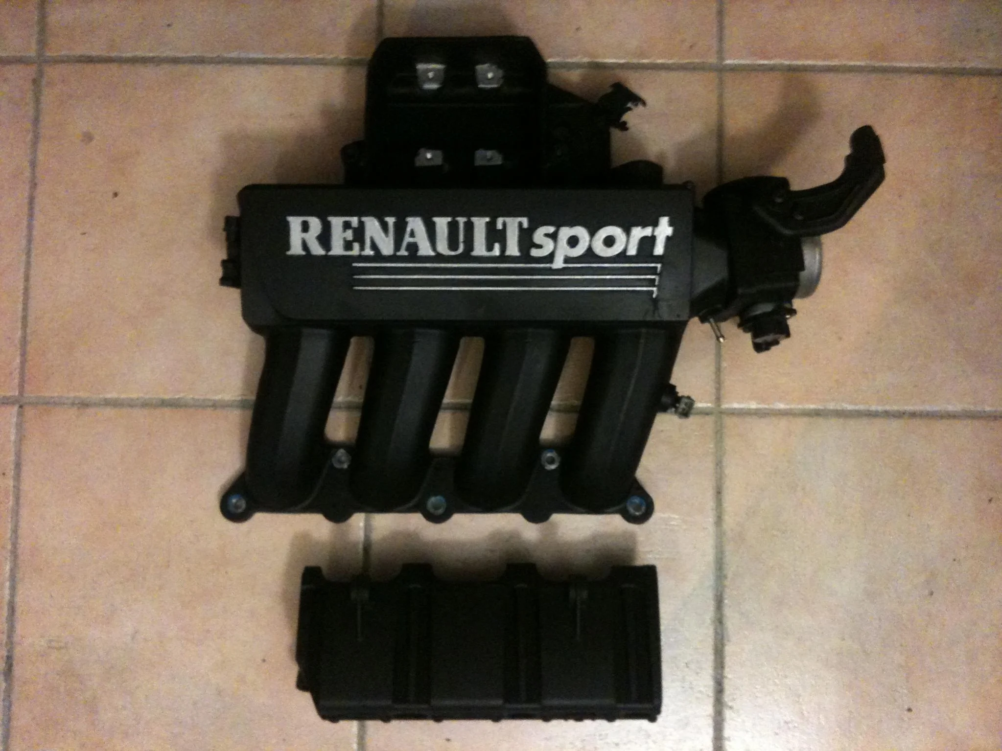

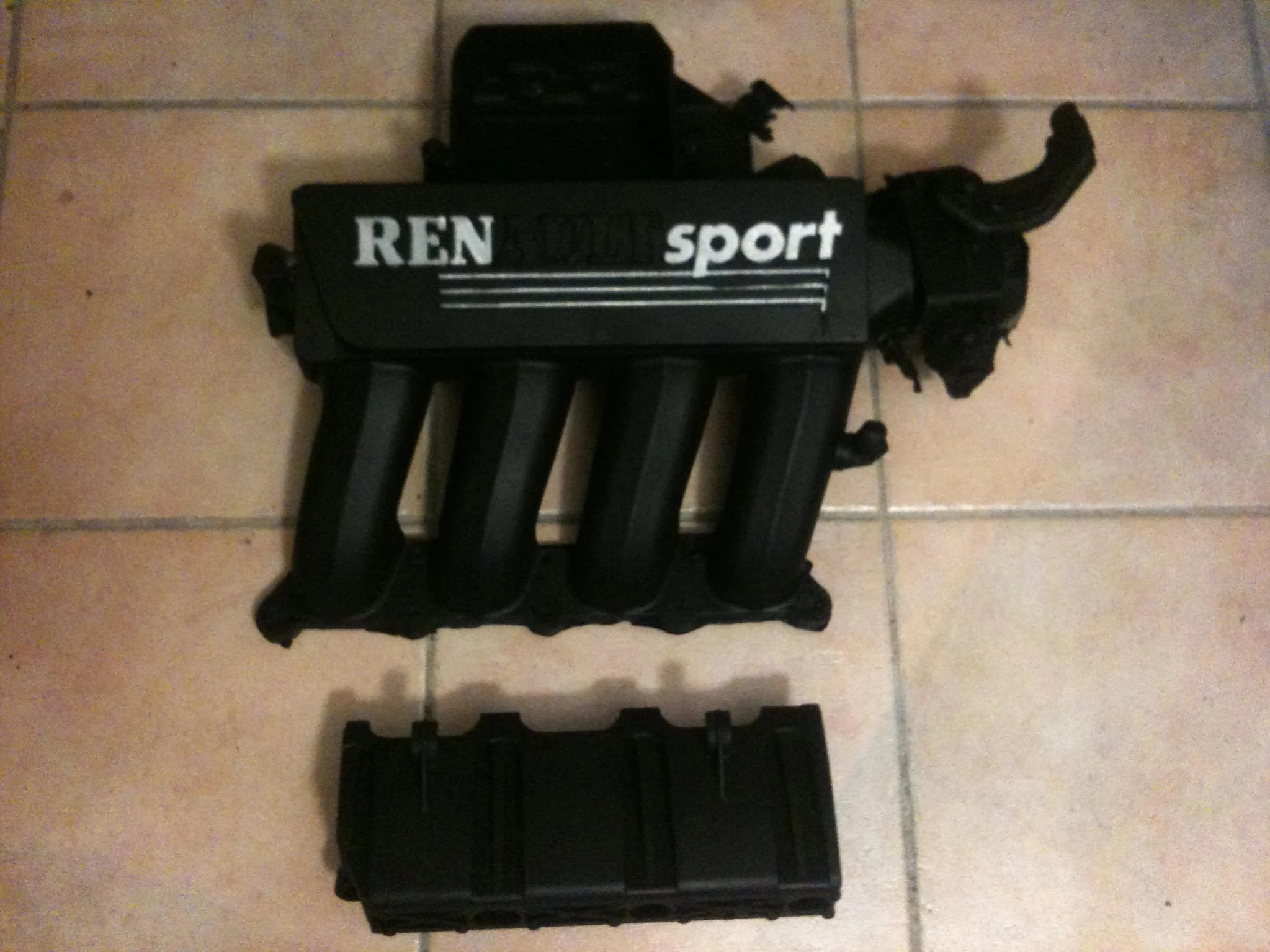

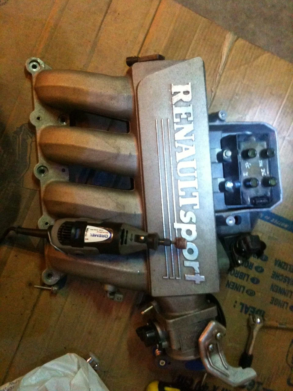

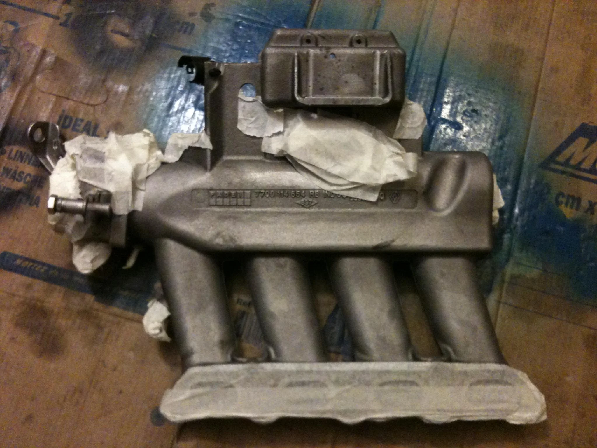

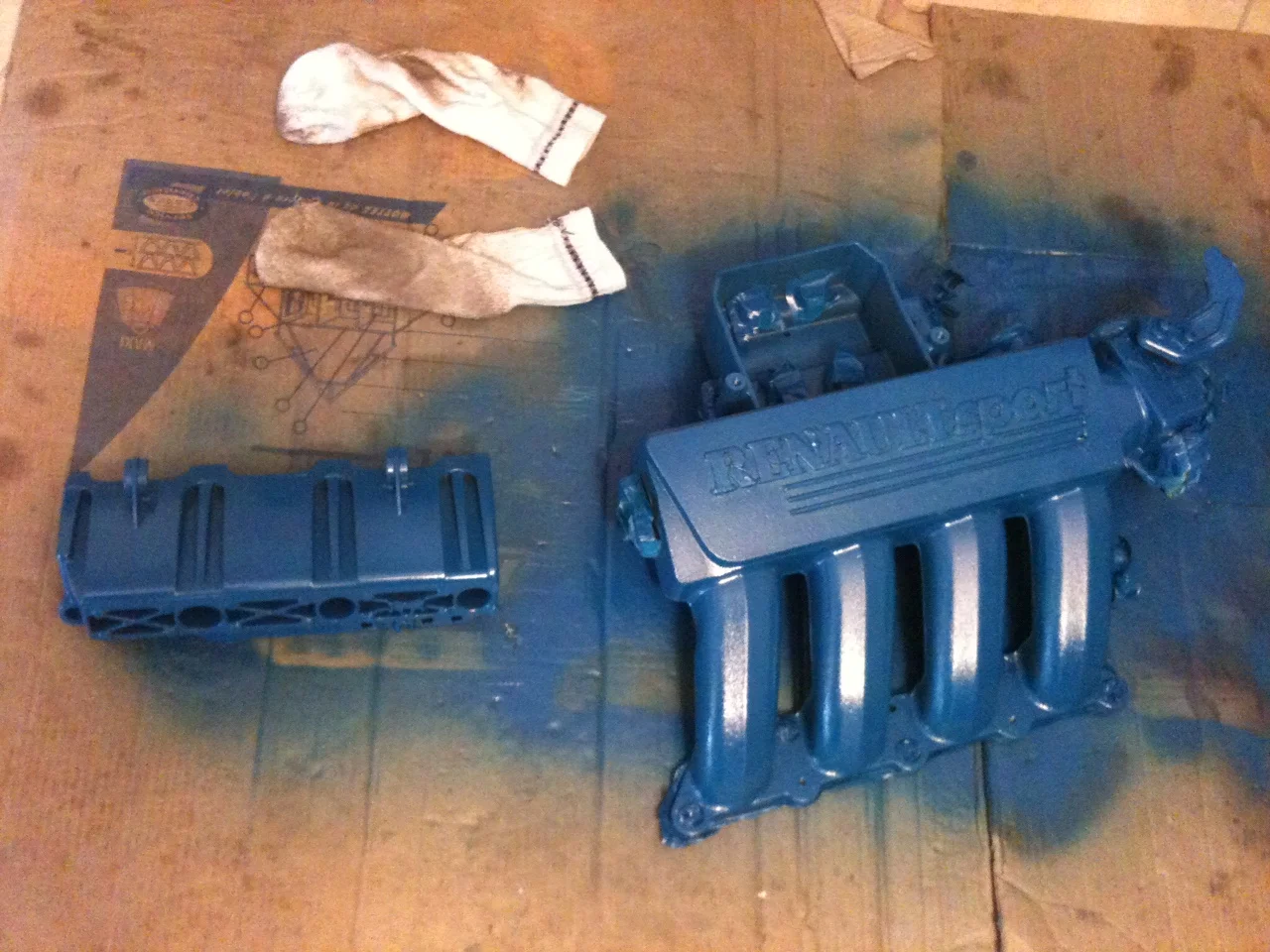

The RS1's engine RS F4R730 of my car have .. the BLUES... ^^
Fast sanding with the dremel of letters and decoration RS of the plenum (which will not be painted)
Removal of all which I can and covering besides with adhesive paper made for that
Cover the letters of the plenum was a long work of precision but it's necessary to know what we want and I am a fanatic of the precision ^^
Admire the small socks - rags which will not serve me any more in their leading part of course :lolup:
Now It is necessary to wait that dries completely, to remove the adhesive, to sand at best with a very fine abrasive foam the letters RS of the plenum and to remount all that to see the final result
To be continued tonigh or tomorrow :)

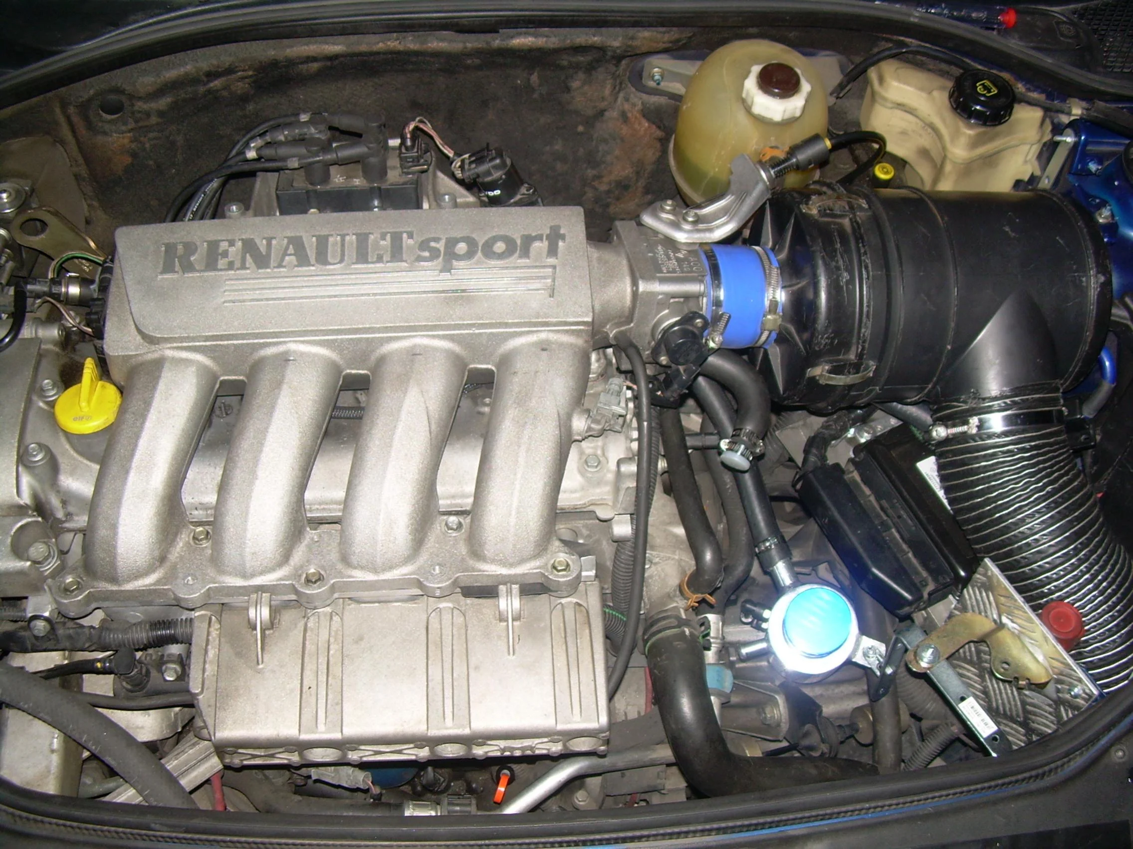

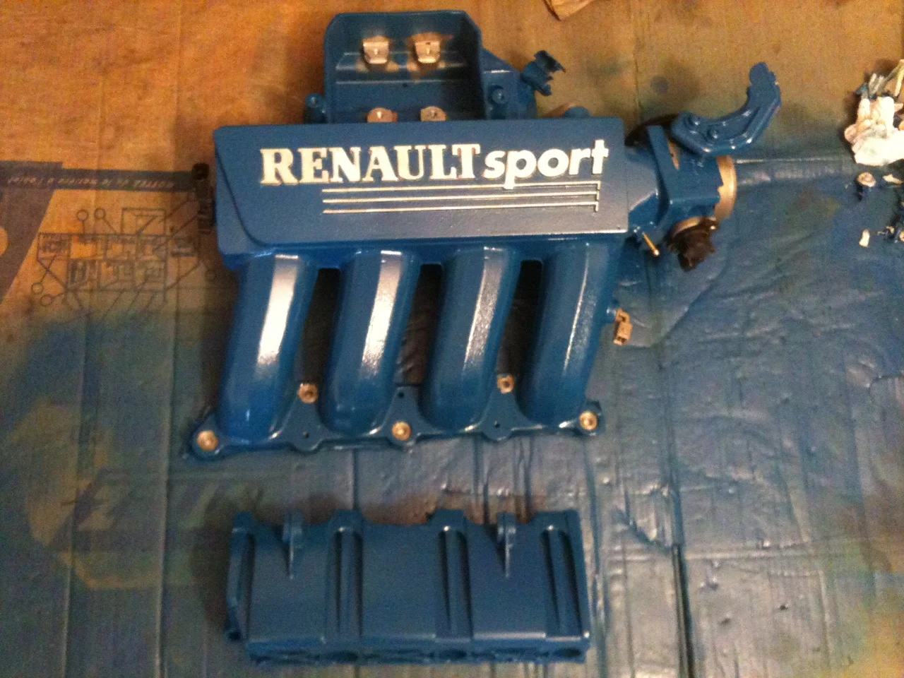

I change the colors... :p
To kitch really this blue and I choiced a color more classic but more class also for me and which is perfect for an engine and the style of a Clio 2 RS1 : Black
  CLIO 2 RS trackcar
I think too ^^ :drunk:
I didn't plan more things than its current preparation phase 2 which is ended and this black painting will be as the make-up, the rimel on the eyes of an attractive woman lol :p
  CLIO 2 RS trackcar
Some small tracks of 1 or 2mm of blue to be erased on the side of the upper line just under "Renault Sport ", but I find that makes better that the light blue before, that goes more with an engine and more with an atmosphere "dark colors" of the car and the engine

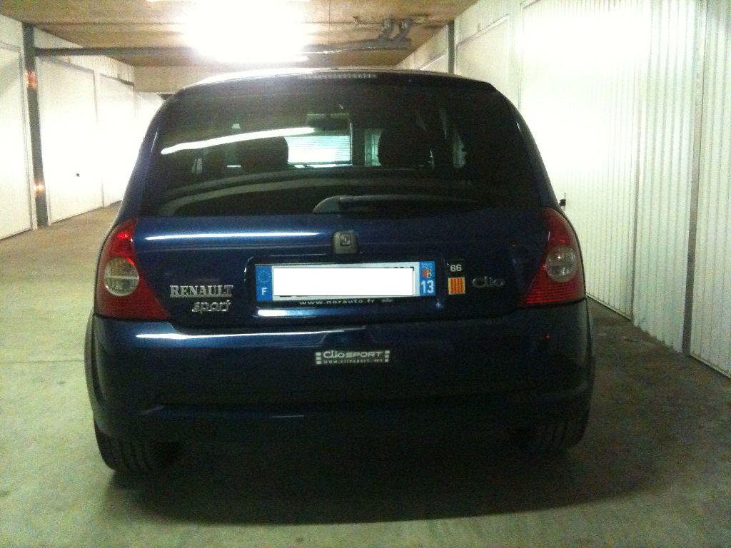

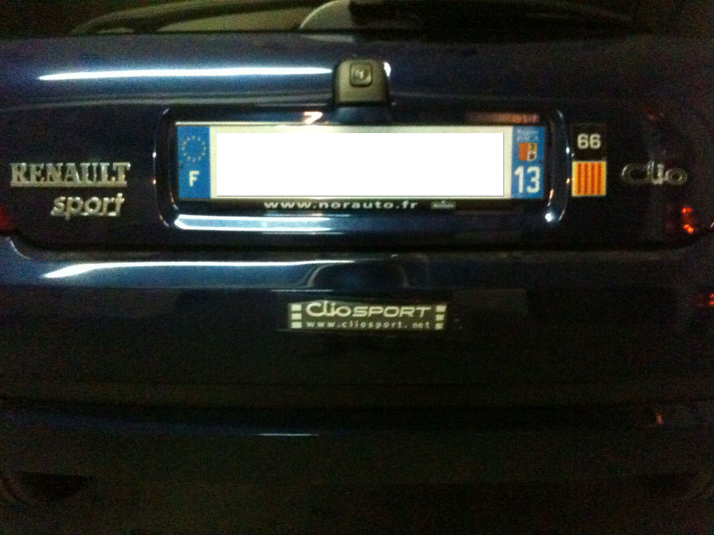

it's allright now I advertise the website in the South of France ^^ :clap:
I was not able to put the logo because of adhesives dark black on the windows (we see nothing behind that ^^), thus I have to stick it on the rear bumper
:p
Sorry for the bad quality of the photos I made that with my Iphone on my garage
