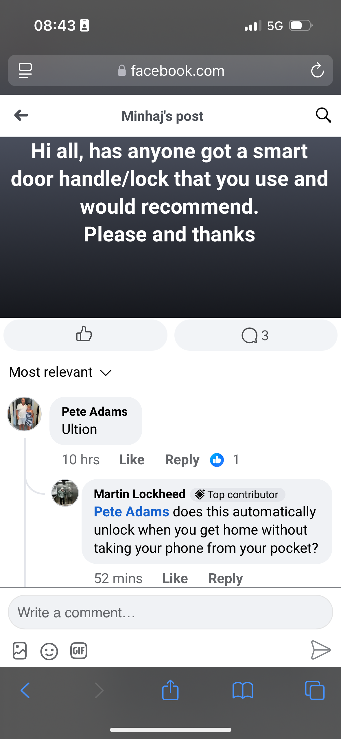

Im actively looking for a Smart Lock for my front door. Number pad unlock, or with a fob. Sounds ideal to me?
No hiding a key, I can set up temporary codes if I want to allow someone access - like my parents when im away so they can feed the cats etc.
I can absolutely assure you when you've got a baby seat in one hand, dog lead in the other hand with dog pulling having the door being already open for you would be f**king amazing.
It's an idea that I'm surprised isn't more popular tbh!
We've got keyed alike locks front and rear with thumb turns on the inside on both doors and I can't fathom why someone would still use a key on the inside. Blows my mind!
Sounds perfect to me, setup a zone that when your phone is detected the front door unlocks, saves all the messing about with keys and keeps your hands free.
Perfect application that comes to mind would be some integration with things like AirBnBs
Part of the problem is they are often more insecure than a regular lock.
Think of all the issues with car keyless tech, now imagine that’s your house they are stealing 😂
But as with everything it’s a trade off, and you’ll do what works best for you :)

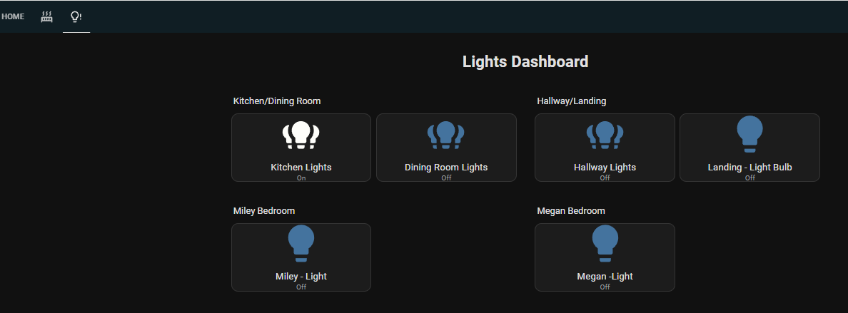

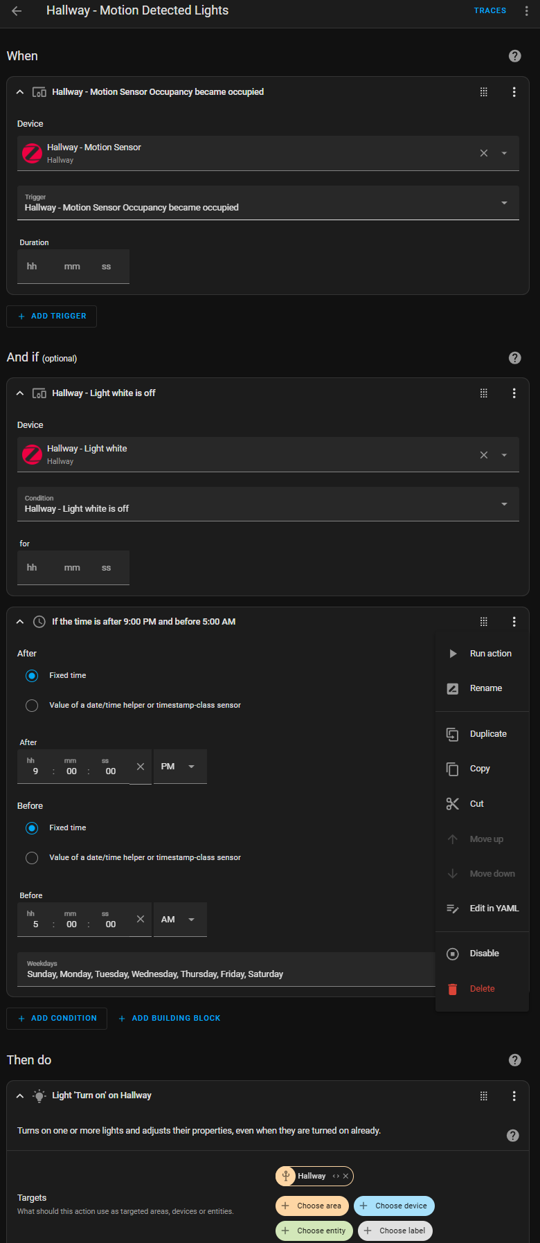

Some more progress recently.
Hive Thermostat installed
Sonoff TRV installed.
I've got them both added to Home Assistant now so when I get chance I'll check I can control them from there and then work out the automation to control the Hive from what the Sonoff TRVs are wanting.
Also got a presence sensor setup in the office now that indicates in Home Assistant that I am in the office or not. Not done anything with it yet but will likely get it to control lights, blinds, heater etc depending on temp, light levels and time of day.
Also also wired a Sonoff smart relay into the office light switch so I can now turn the non smart light on and off from Home Assistant and the switch itself without it ever becoming non controllable.
Been squirreling some pounds away for the Switch S10 robot vac. So hope to add that in the next few months and plumb into the mains so it will mop and vacuum itself for over 10 weeks with no interference needed.
Only disappointment recently is the lack of control of the Govee from Home Assistant, it is inconsistent and the control I have from it from HA is minimal. May look to upgrade all the lights to Hue backlight and lamps in the living room.

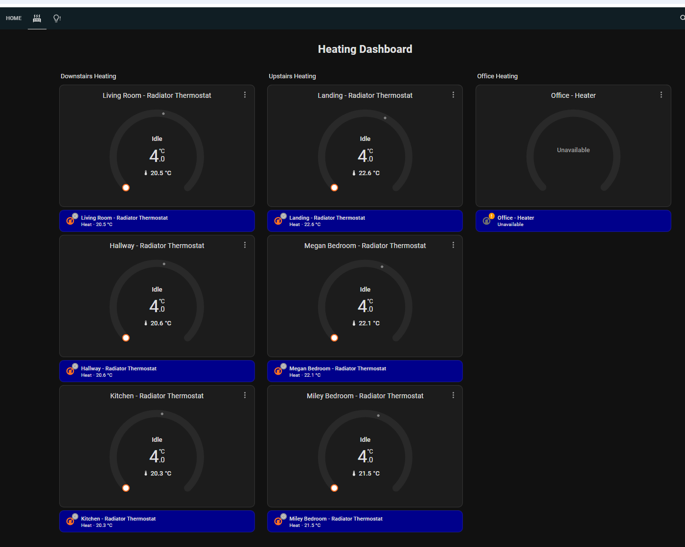

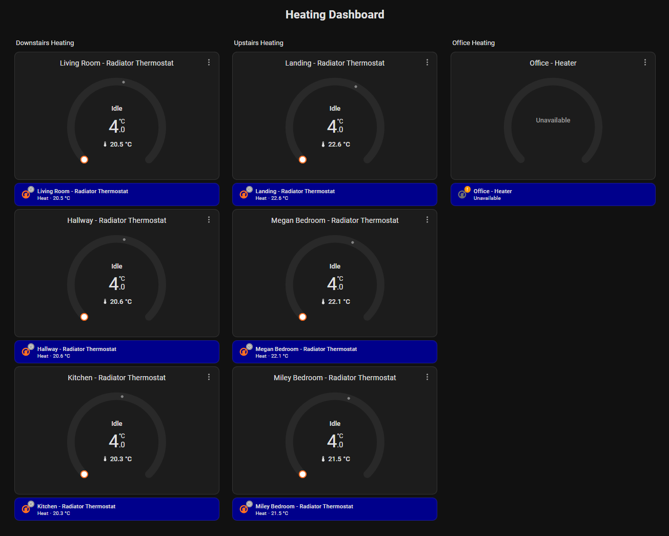

More progress at lunch today (proper boring but I'm excited)
Been trying to get my head around how I could reliably turn the heating on and off if I had multiple TRVs in HA telling the Hive when it needed to switch the boiler on and off. Much time of head scratching I decided I needed one thing that could tell the Hive to turn either on or off.
So the solution was to create a virtual sensor in HA that polls all the TRVs asking if they require heat. If any of the TRVs want heat then the sensor sets itself to HOT and if none want heat it sets to NORMAL.
I could then go ahead and when the sensor was set to HOT, trigger the Hive to fire up and when NORMAL switch off.
Next issue was that the Hive only works off Target temperature or a schedule. So with a bit of help from GPT I've got some custom code in HA to set the Target temp on the thermostat to really high when sensor is HOT and really low when sensor returns to NORMAL.
Can't say how impressed I am by Home Assistants abilities and pretty easy to use once you get your head round it, mostly works from a simple UI.
Whilst this is quite cool, would it not have been easier to use Hives TRVs and then you could say to HA - increase temp to X° in Y room? You could also set up different 'scenes' so if your at home alone working in the office you could say 'home working' and it would set the temp correctly in the office and turn everything else off?
Yes and no.
100% agree it would have been easier to just setup with an all Hive system but the Hive TRVs at £30 each more than the Sonoff. I think I need 8 so that is £240 saved straight off.
Not looked into it yet but I can set scenes in Home Assistant. So I guess it would be possible to do as you say.
Can also link Alexa to HA so could control the TRVs that way, but I'm trying to get away from any manual interaction so that it is all automated. You don't even know it is happening.
I'm not sure if I've gone the right way about it but I had multiple apps to control all the different manufacturers devices and HA seemed like one way I could have one central location to control everything.
It is the fun part of tinkering and getting things working also. It isn't perfect and you do need to research quite a bit to make sure there is an integration with HA that works and I have been caught out with a fair few hundreds worth of Govee kit that isn't reliable so not all plain sailing.

As of tonight I now have a fully working heating system with the TRVs and Hive.
All lights now controlled by Hue light switches with an aftermarket light switch cover over the old light switches that the Hues fit into. So no switching the lights off anymore.
Also been working on a custom dashboard in HA. This is just for my PC at the moment but will also do a mobile and tablet based one for more suitable layouts.
Tabs at the top for different things like lights and heating

As an example this is my automation to turn the hallway lights on after 9pm if motion is detected. checks to see if the light is off and if so turns the hallway lights on if it is between 9pm and 5am. I also then have a similar automation if there is no motion detected and the lights are on turn them off. This also allows me to use a dimmer warmer white when lights come on by motion to not blind you at 3am in the morning, light switches give bright white 100%.
So lights can't be turned off by the standard light switches I've installed Hue light switches throughout the house, and because they are Zigbee they integrate brilliantly with HA. Using these covers to go over the standard light switches
