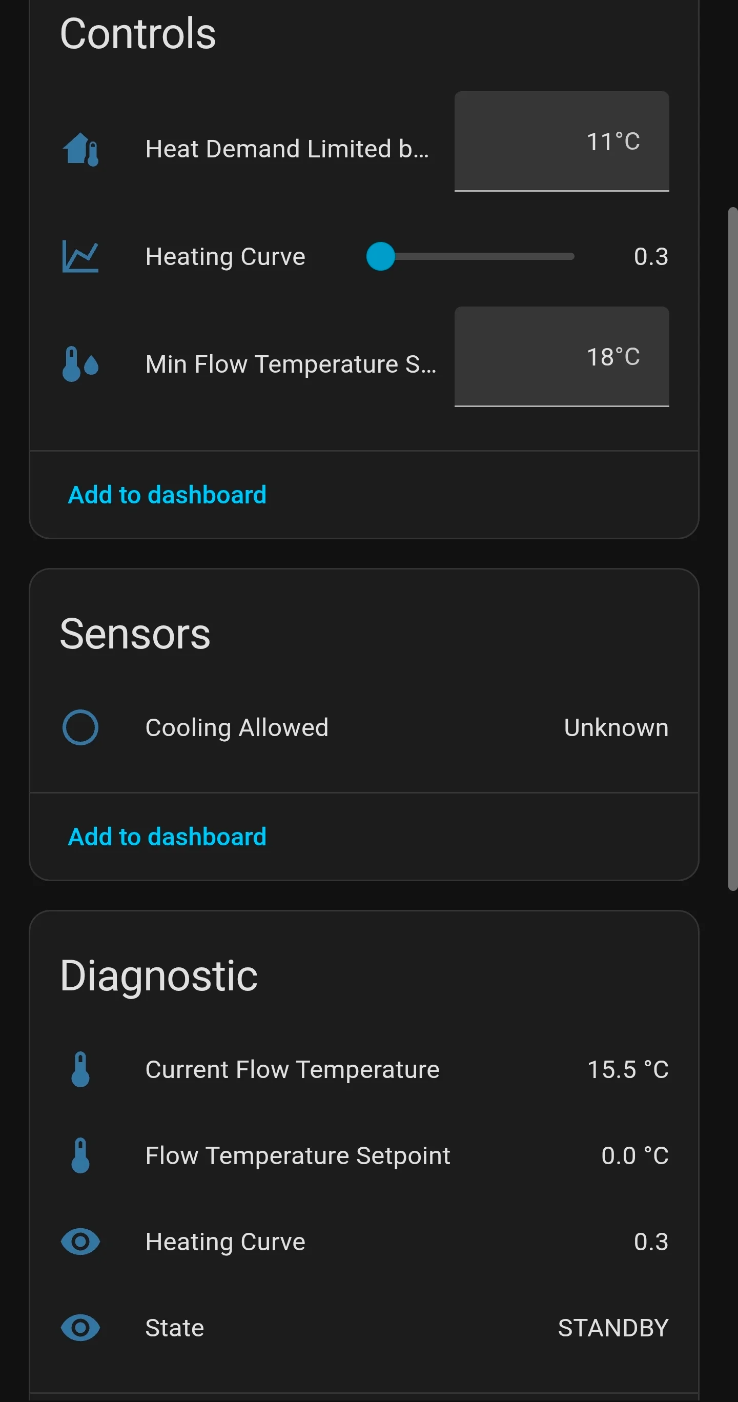

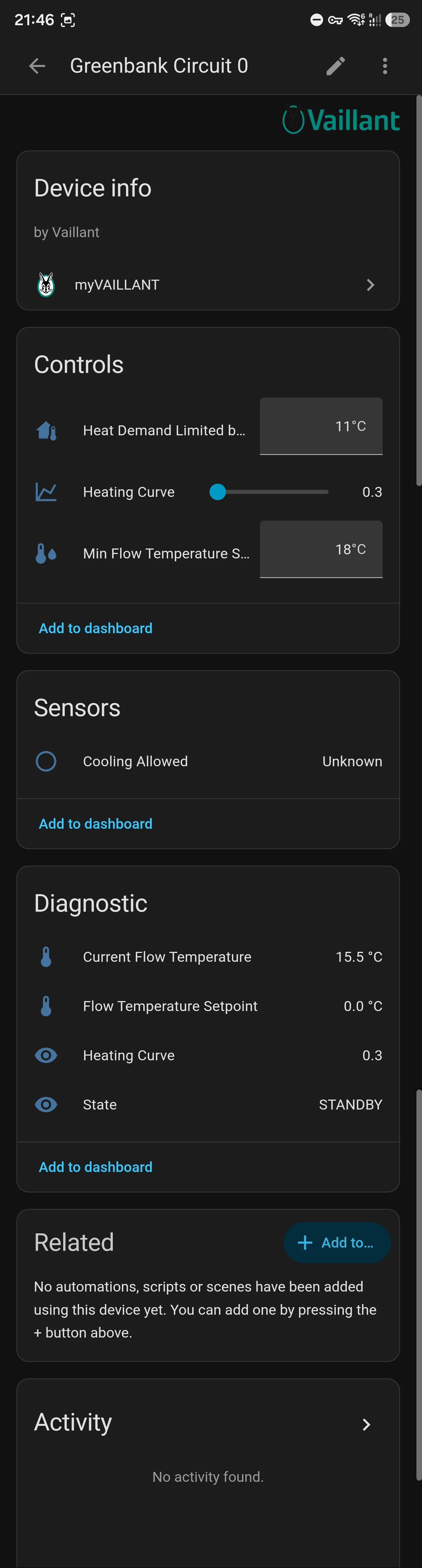

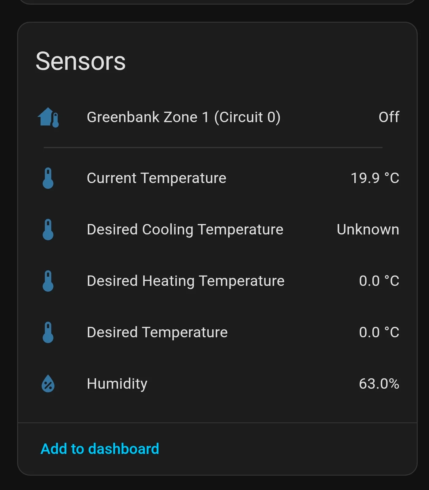

Today I've loaded our heat pump onto the system, basically accessing all the heat pump controls and sensor info into HA.
I can now use and control these directly instead of via the app or control display in the kitchen which also means I can automate the based on external conditions.
For example, the heating is now fully controlled by weather compensation (outdoor temperature). But on sunny calm days the heat loss is less than in overcast windy days.
The Vaillant system struggles to deal with this but in HA I can automatically adapt heat curves to a local weather forecast including expected wind speed, direction and temperature.
These are only a few of the entities of the heat pump that can be used.

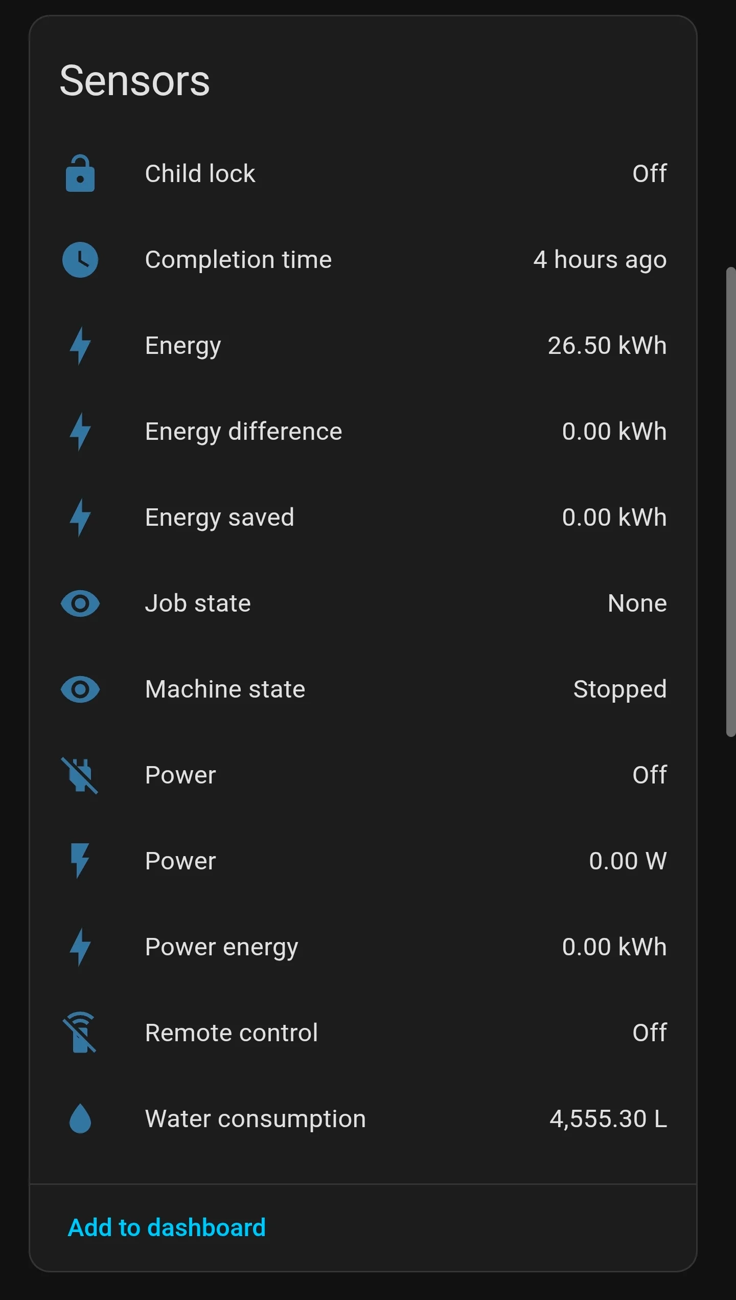

Or all the info that gets pulled from our washing machine.

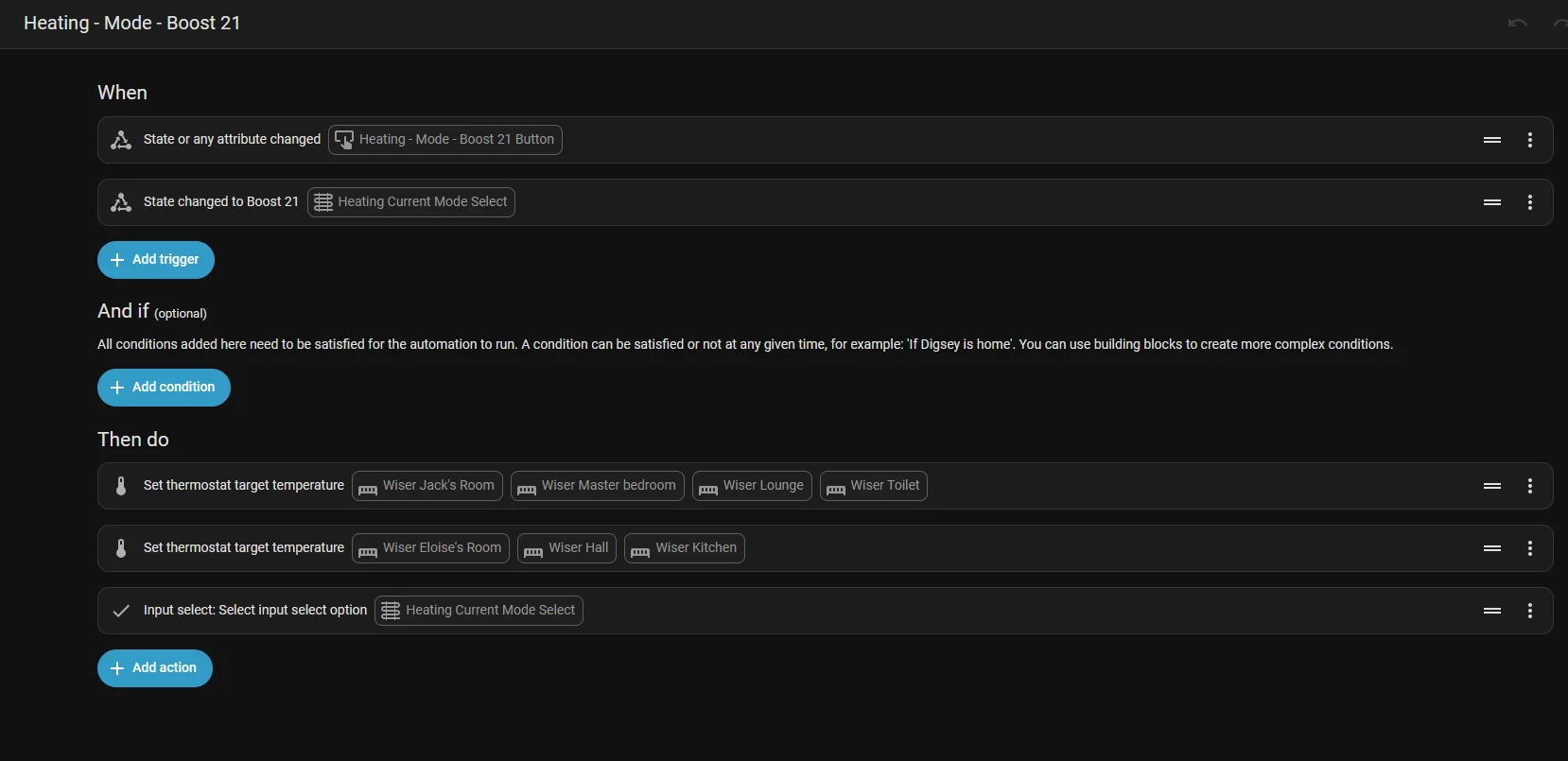

basic control screen within HA -
Example Automation - This activates if a dashboard button is pressed, or alexa is told to "boost temp to 21", two temperature lines as hall, kitchen and one bedroom are set at a different temp to the rest
