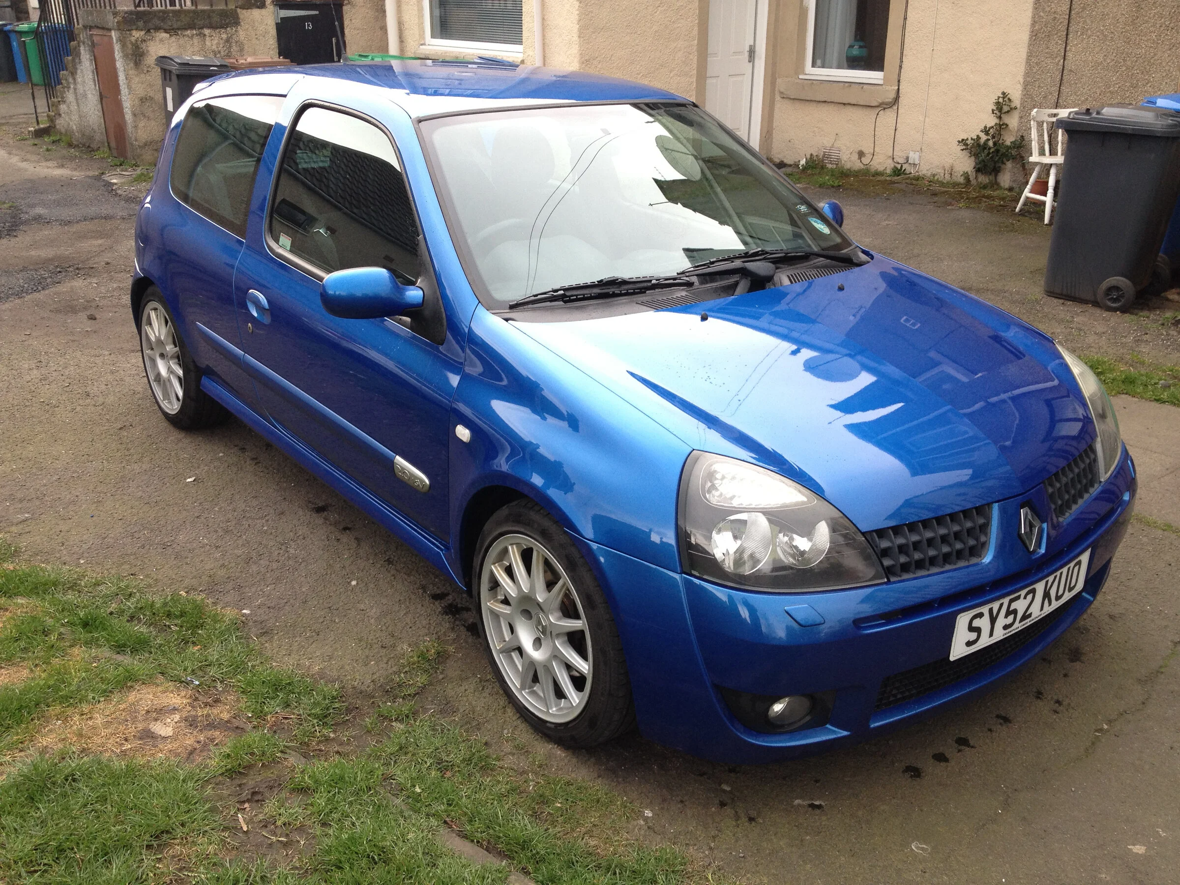

Back in 2011 I was working in Scotland on a long-term engineering project. As I had no outgoings, living on expenses and being just over half an hour from Knockhill a track car made perfect sense… Enter SY52 KUO, a Mondial Blue 172 Cup, collected in August 2011 from Perth for the princely sum of £2,200.
It had covered 84,000 miles, some service history and very dodgy track rod ends but I fell in love with it.
The day I picked it up (note the splitter intact!) –

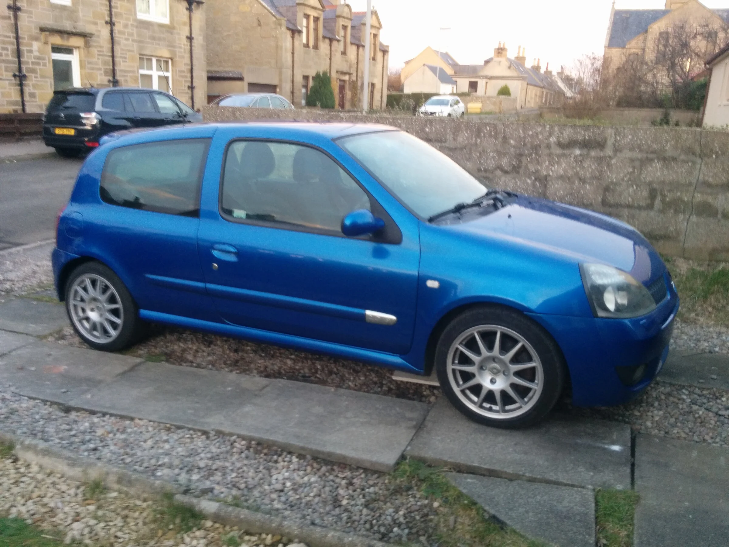

I arranged for a full set of tyres to be fitted a few days later, I serviced it, fitted a Powerflex dog bone mount and some Eibach Sportline springs and set about using it as a daily for a few months. How it stood after a run in with a pheasant... (Note the lack of a splitter)

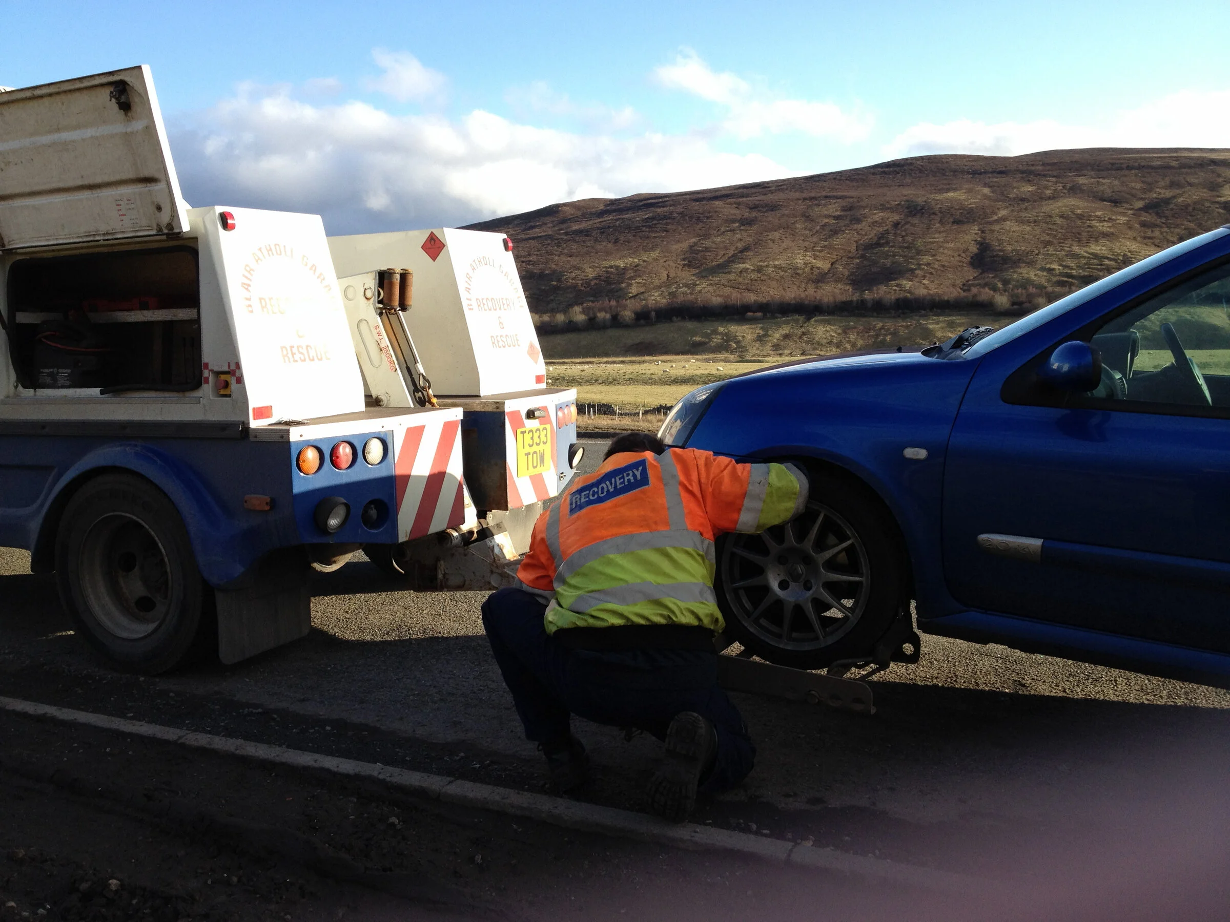

I started my new job with my girlfriend staying in the central belt, the Cup became a commuter and I racked up a fair few miles up and down the A9. On one of the trips down, just coming off a dual carriageway section there was a load bang from the rear, I braked and the car squirmed around so I coasted gingerly to the nearest layby… the view was nice…
It turned out one of the rear pads had fallen out… so my AA membership card earned its keep…

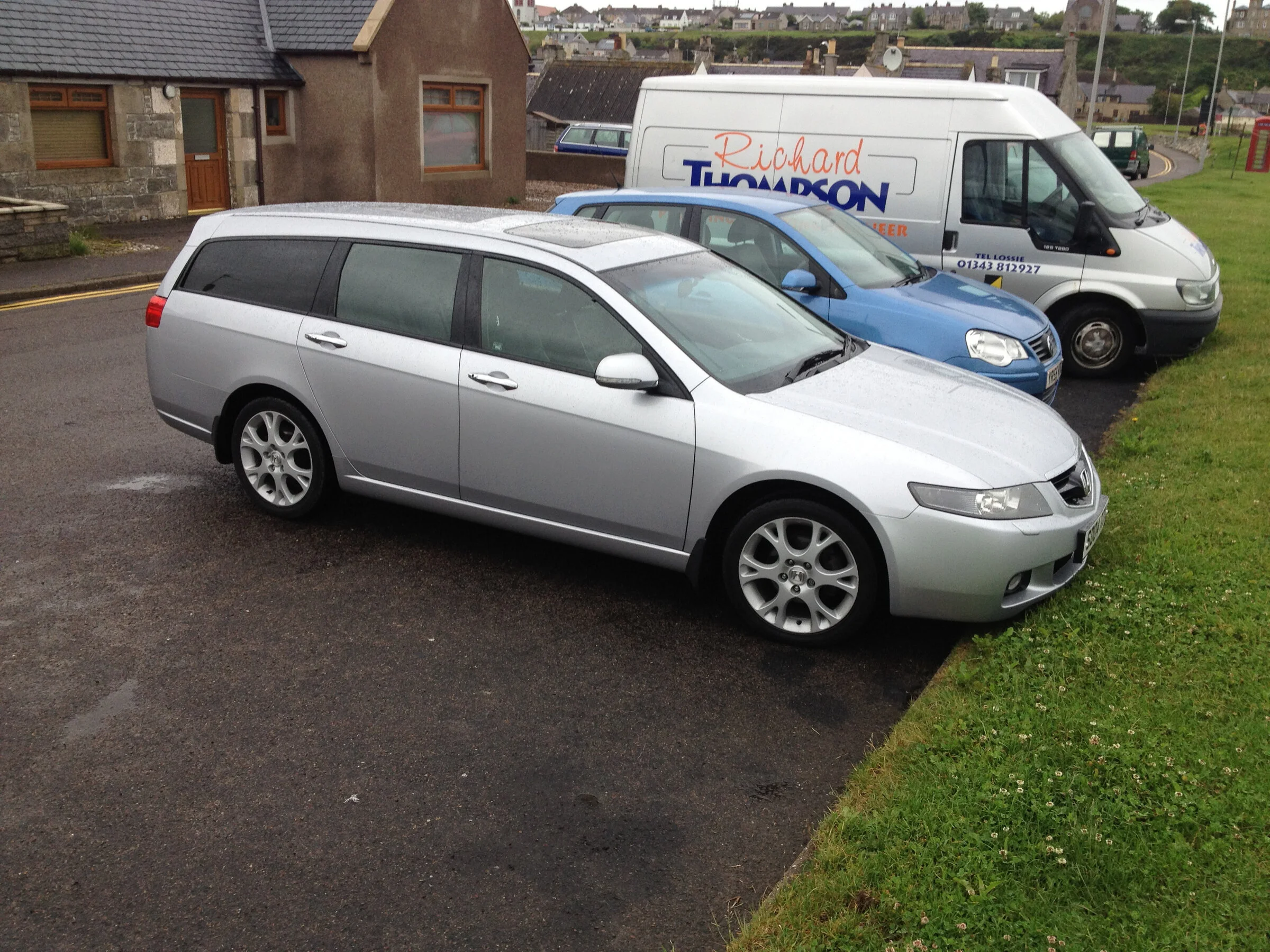

Pads renewed and the Cup resumed its commuter duties until my girlfriend moved up with our dog and two cats and the Clio, even with a roof box just wasn't practical and was replaced for daily duties by our trusty Honda Accord Tourer.

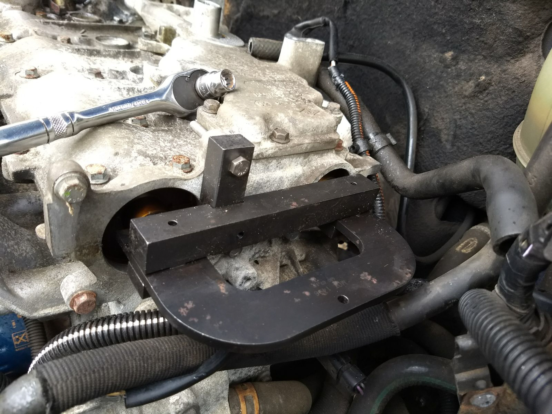

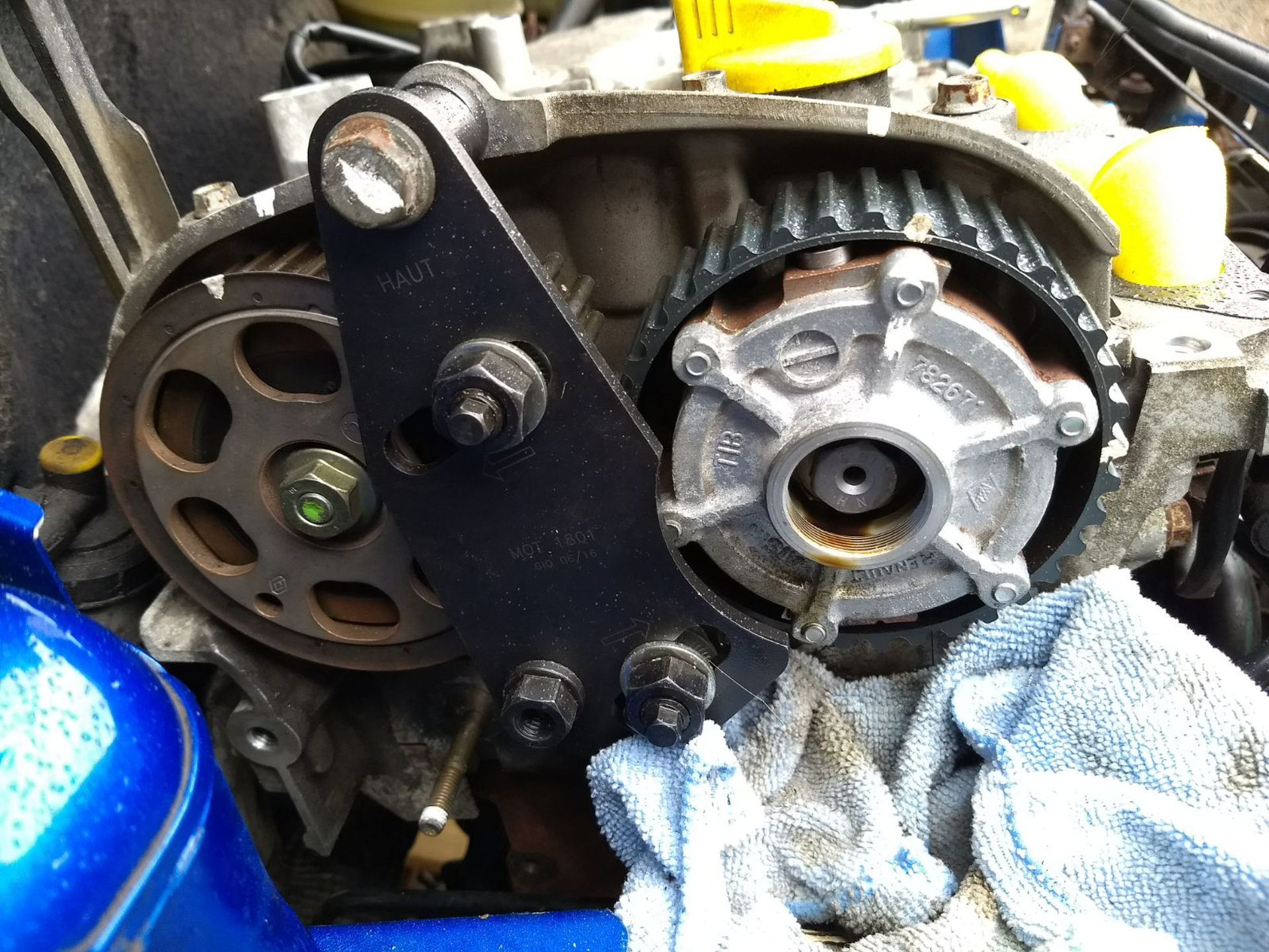

The Cup was then used as a commuter for a little while, by that time the belt that I’d had Renault (I know I know!) fit at the eye-watering cost of £800 was due to be replaced on age. I enjoy a bit of spanner fondling, I have a degree in Mechanical Engineering... how hard could it be… Turns out, with the right tools, not too hard at all, as long as you follow the technical guides available on here! To note, the timing from the main dealer was out too!

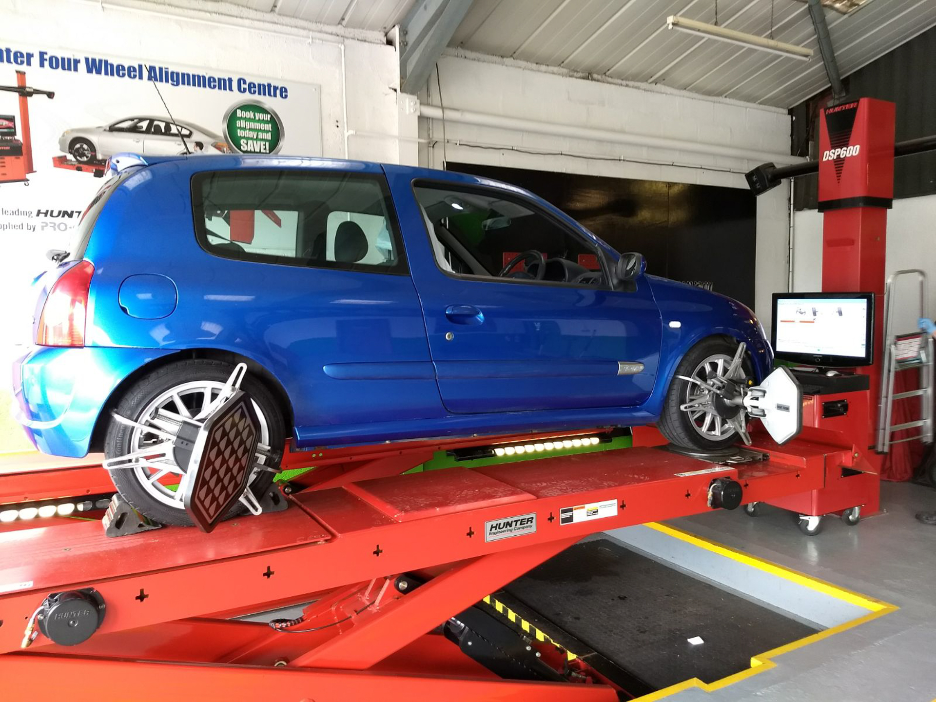

At the same time as replacing the cambelt I splashed out a little, renewing all the shocks with OEM Cup shocks, renewed all of the front bushes with Powerflex Black series (wishbone, inner and outer arb and steering rack), renewed the inner and outer tie rods and ball joints, new top mounts etc etc, essentially every consumable on the front was replaced and after a full hunter alignment the car was transformed.

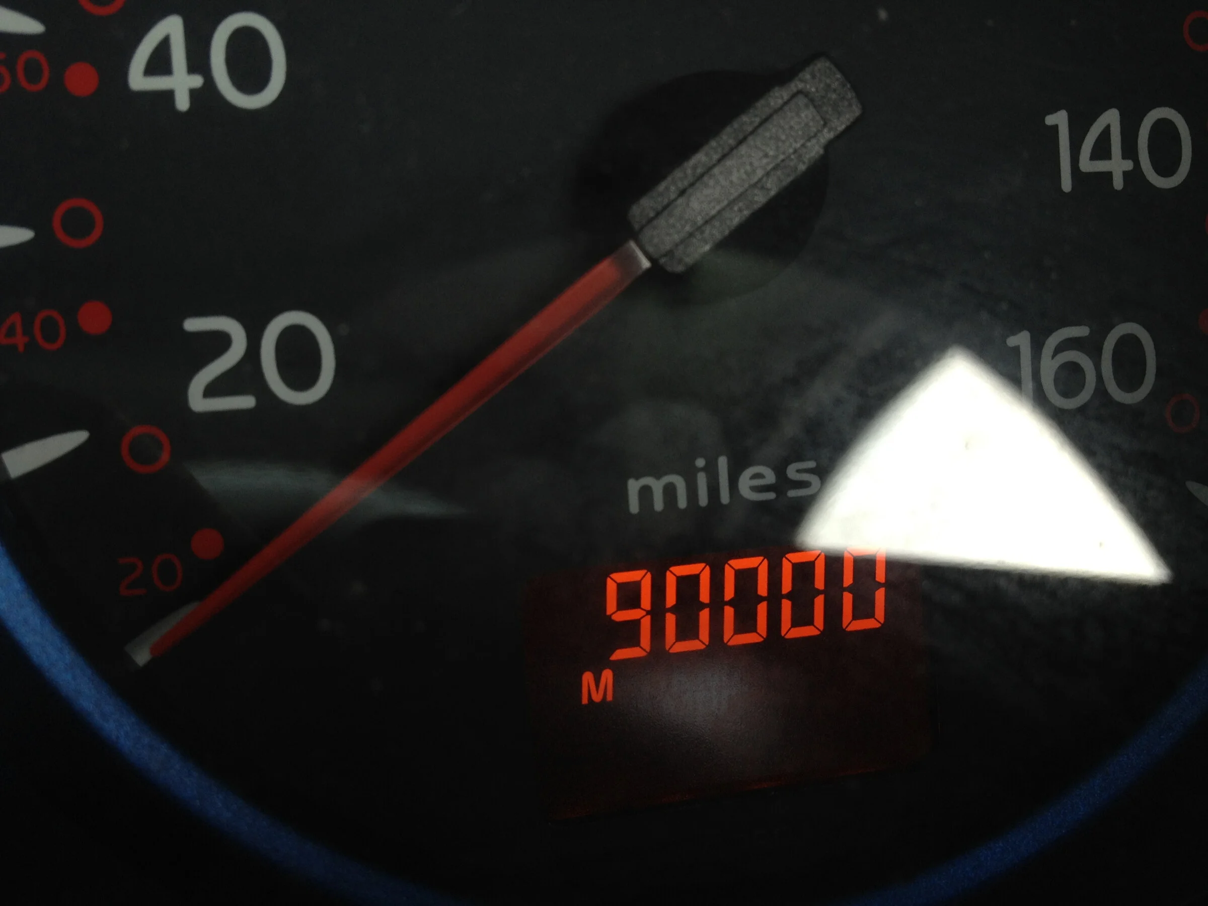

The Cup clocked up the big 100k just as we were getting back to Inverness...

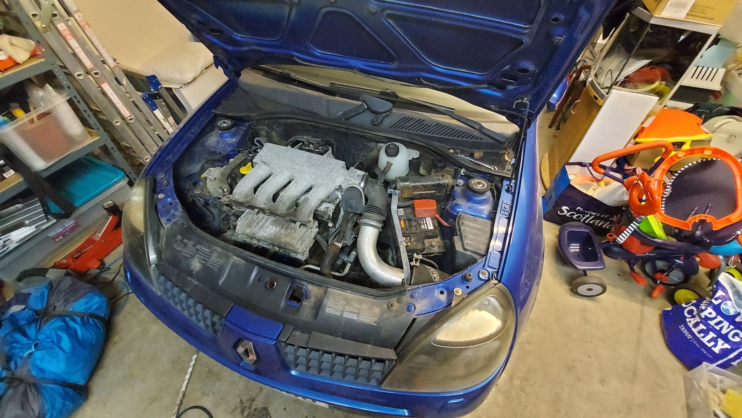

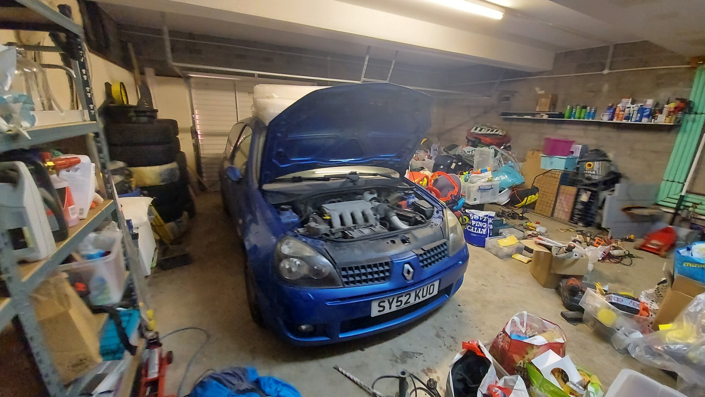

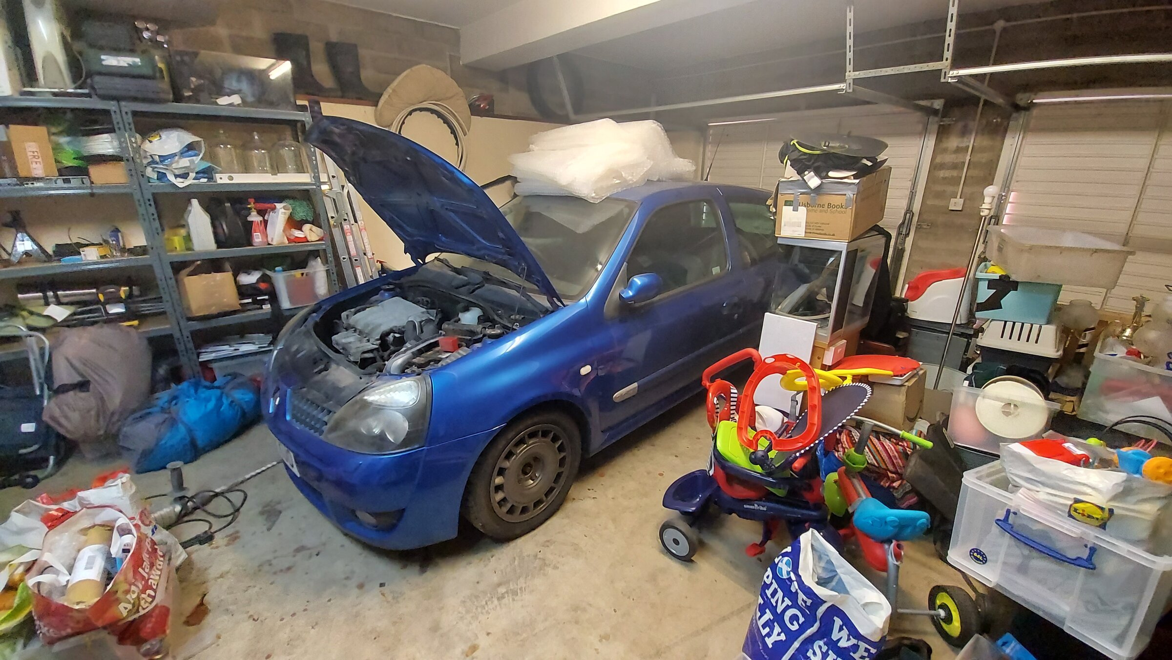

This brings us to 12 or so weeks ago, we finally got the keys to a new house on the Friday before lockdown, we got moved in that weekend, returning the moving van at 2pm on the Monday we got locked down! I had charged the Clio and moved it under cover of darkness to its new home, my new double garage!!
Here it sits, surrounded by general crap that you accumulate over the years!
I don’t have grand plans, I just want to get back to using it and protecting it for a few years to come.

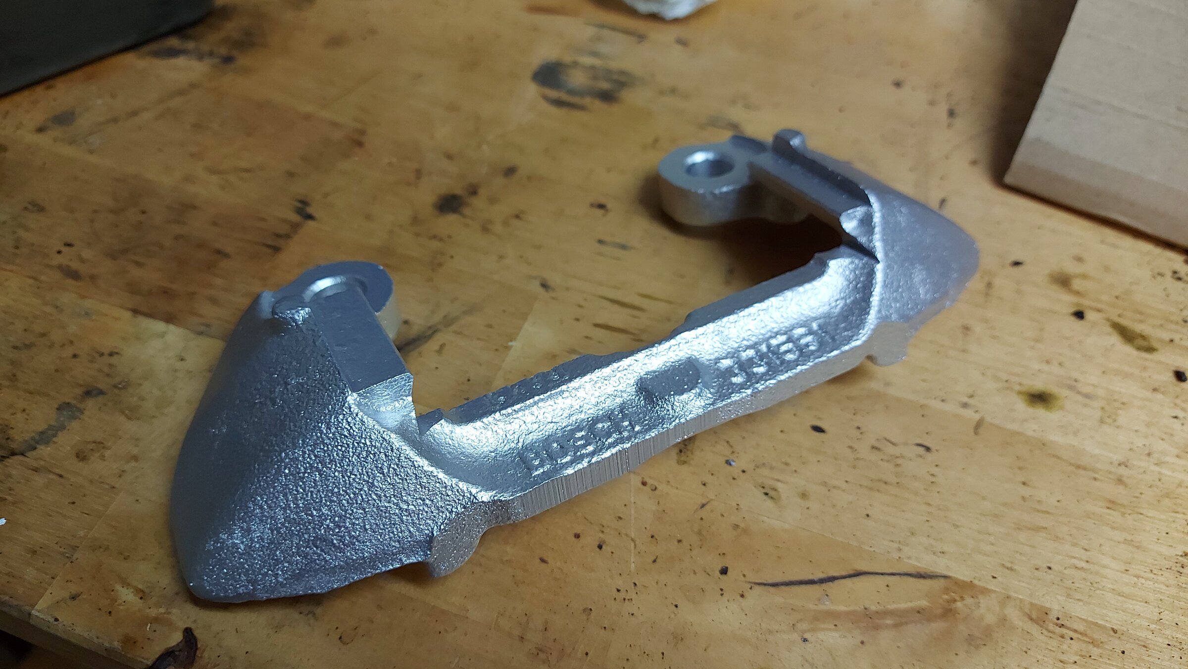

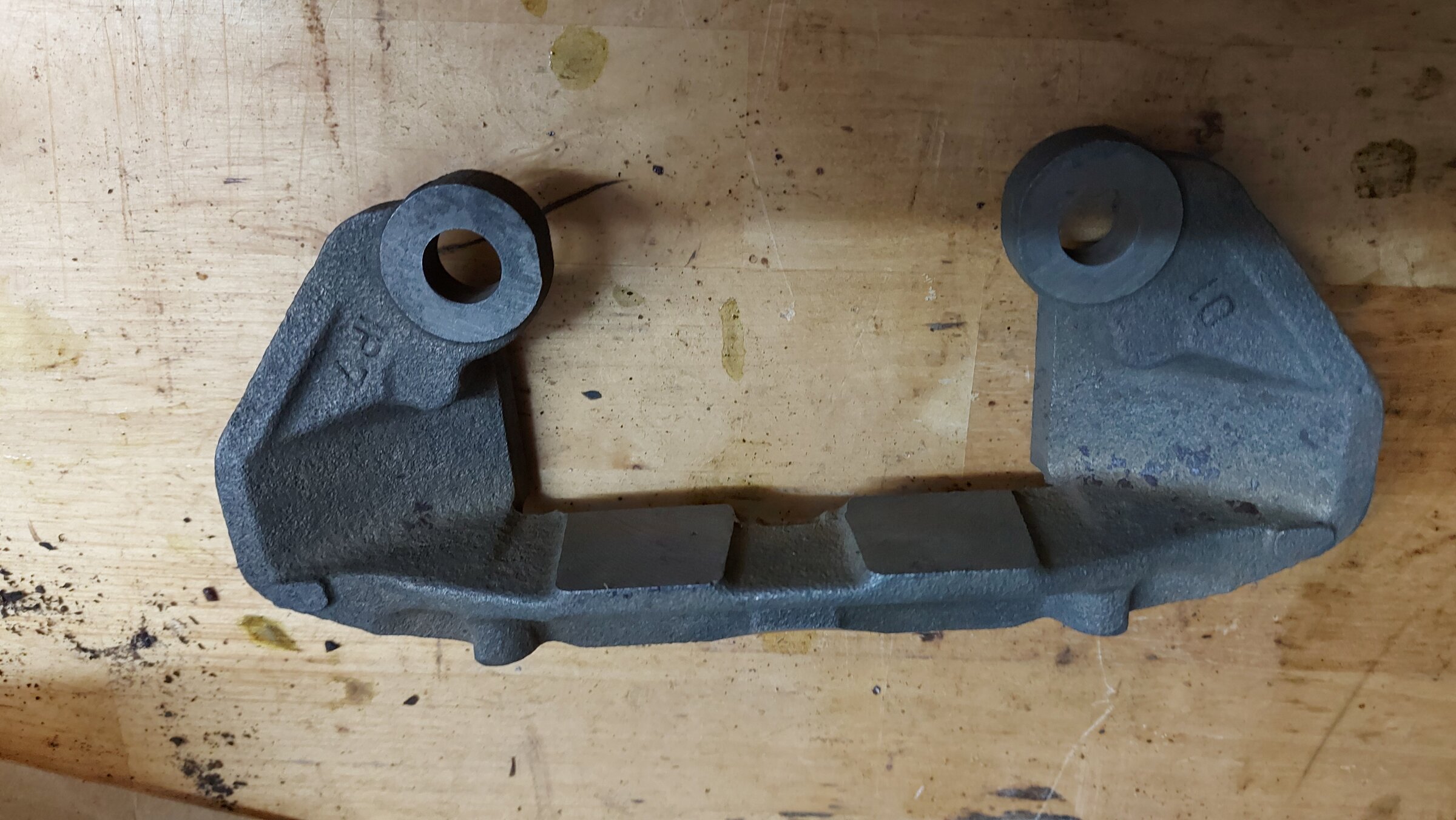

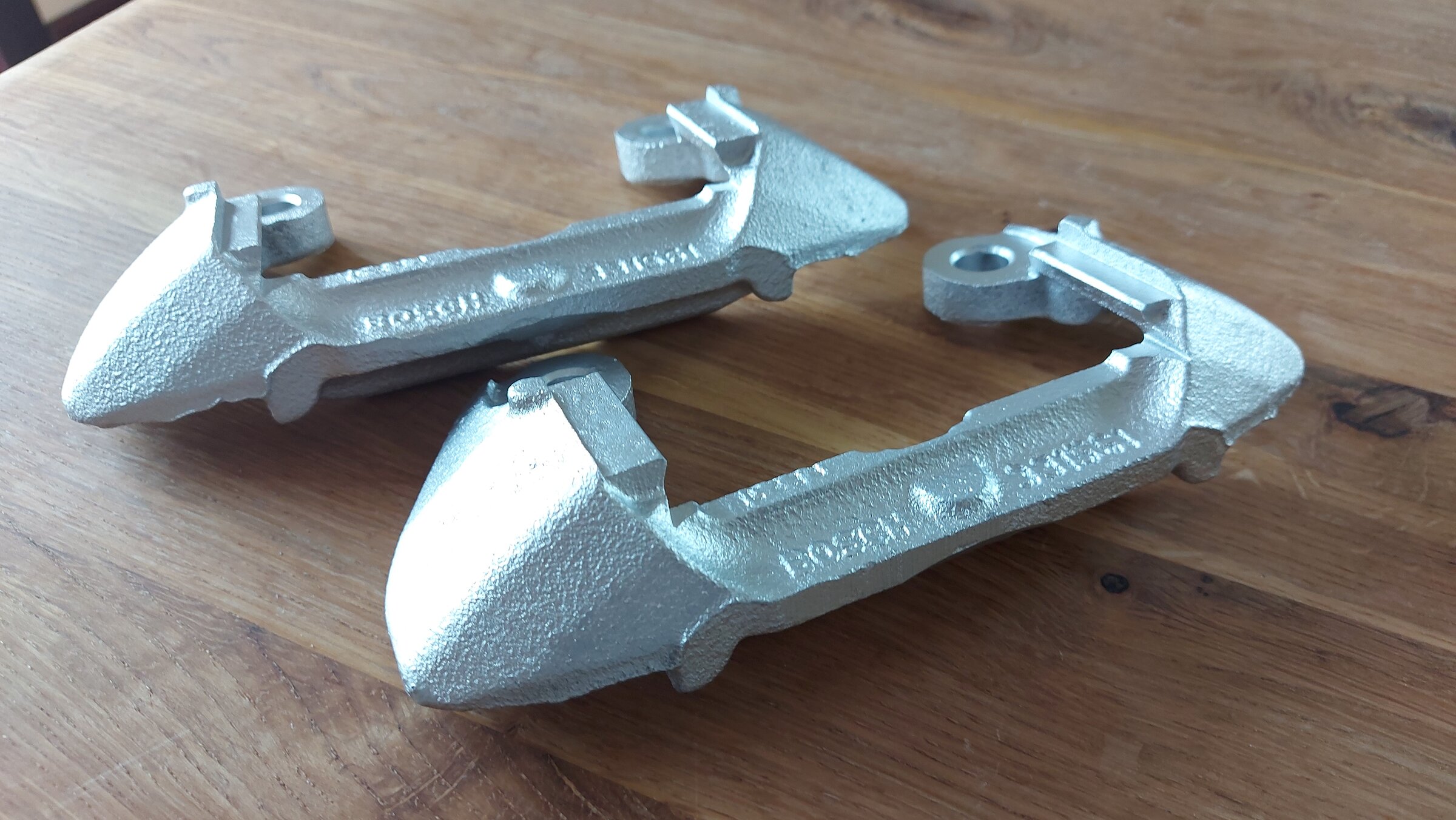

A quick weekend project!

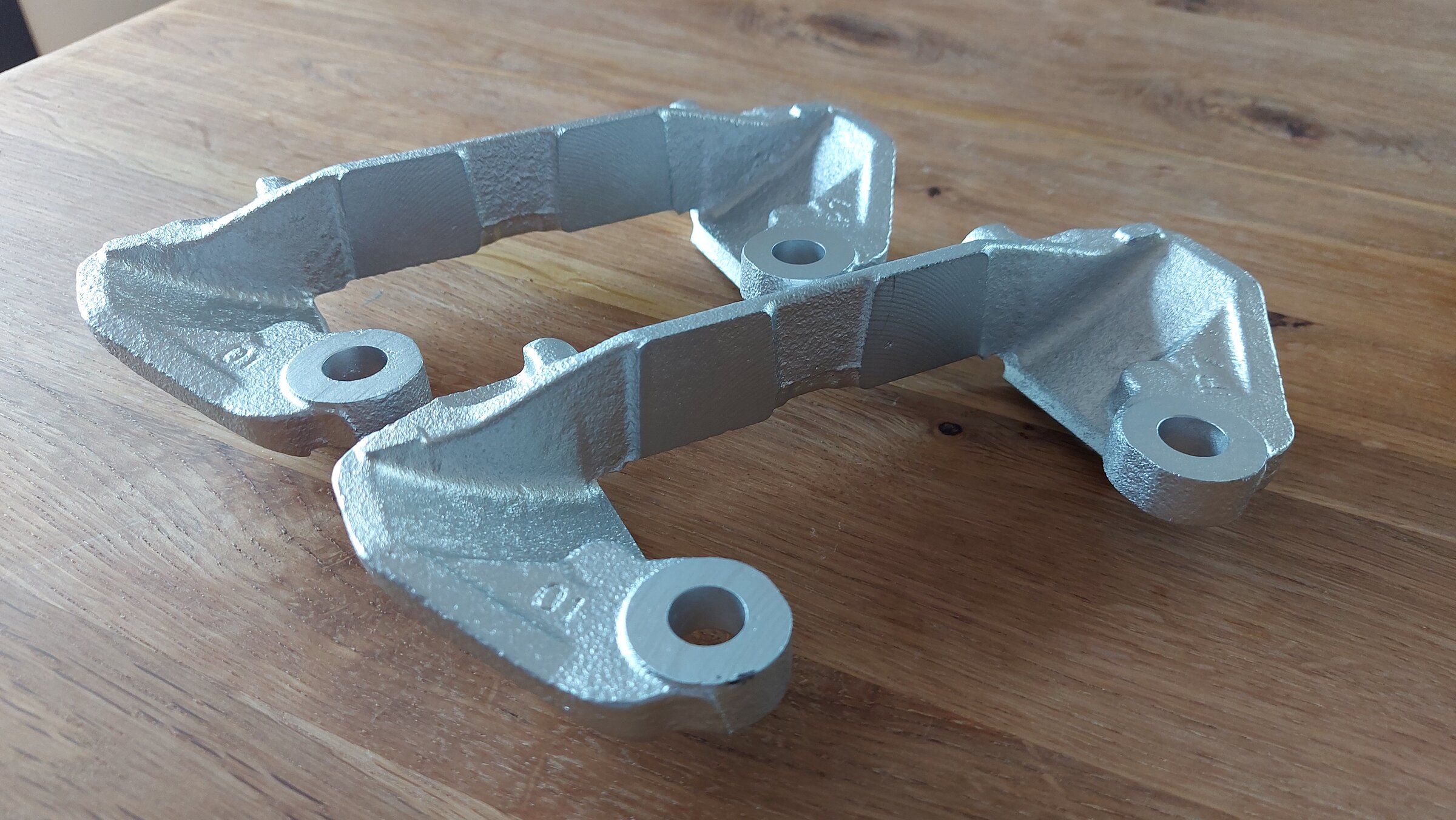

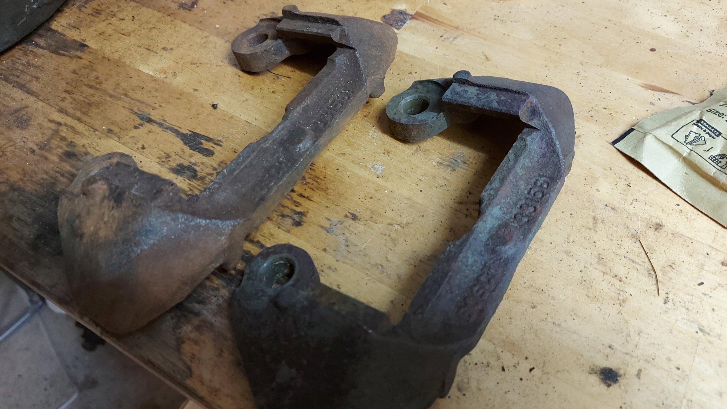

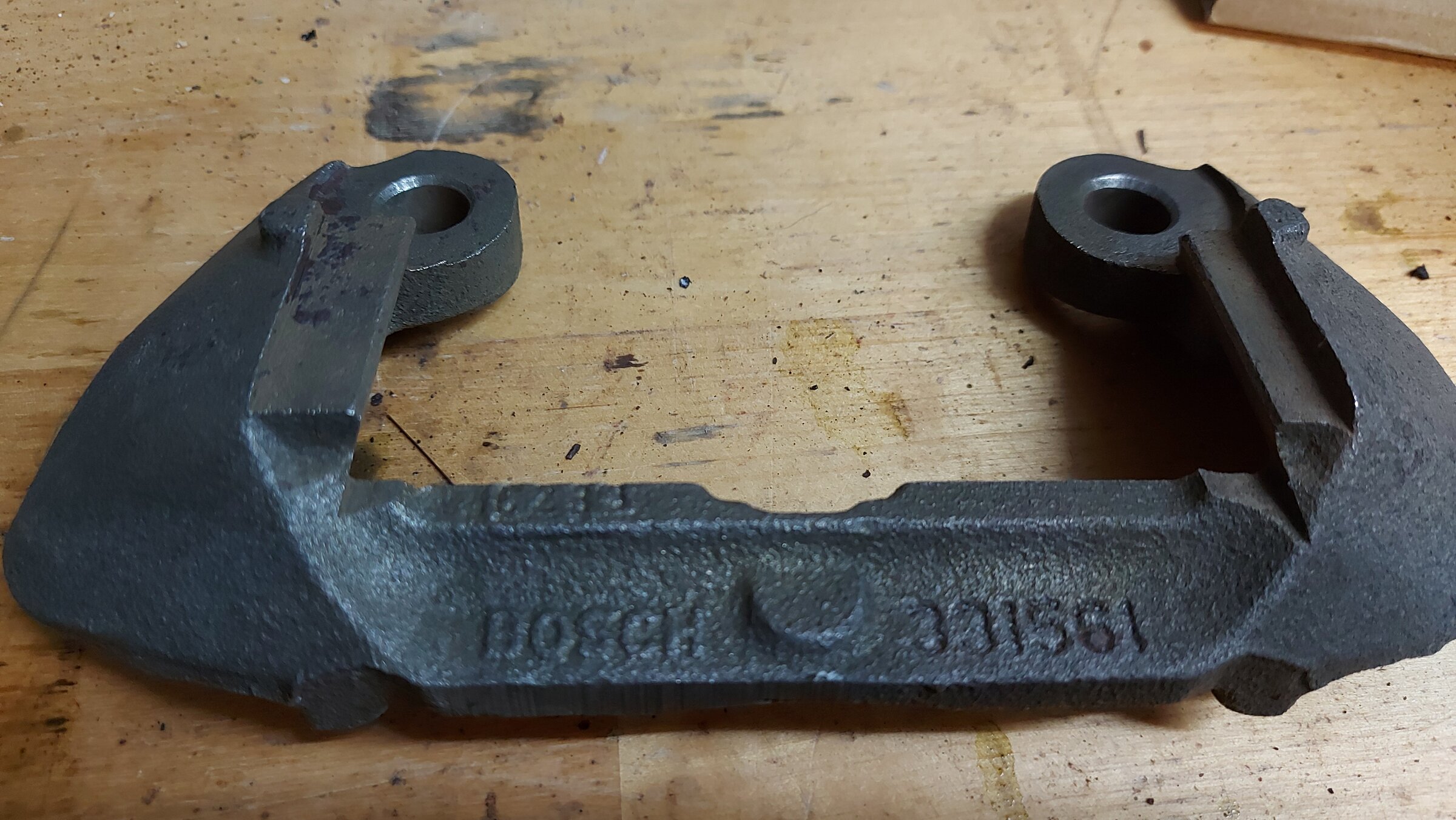

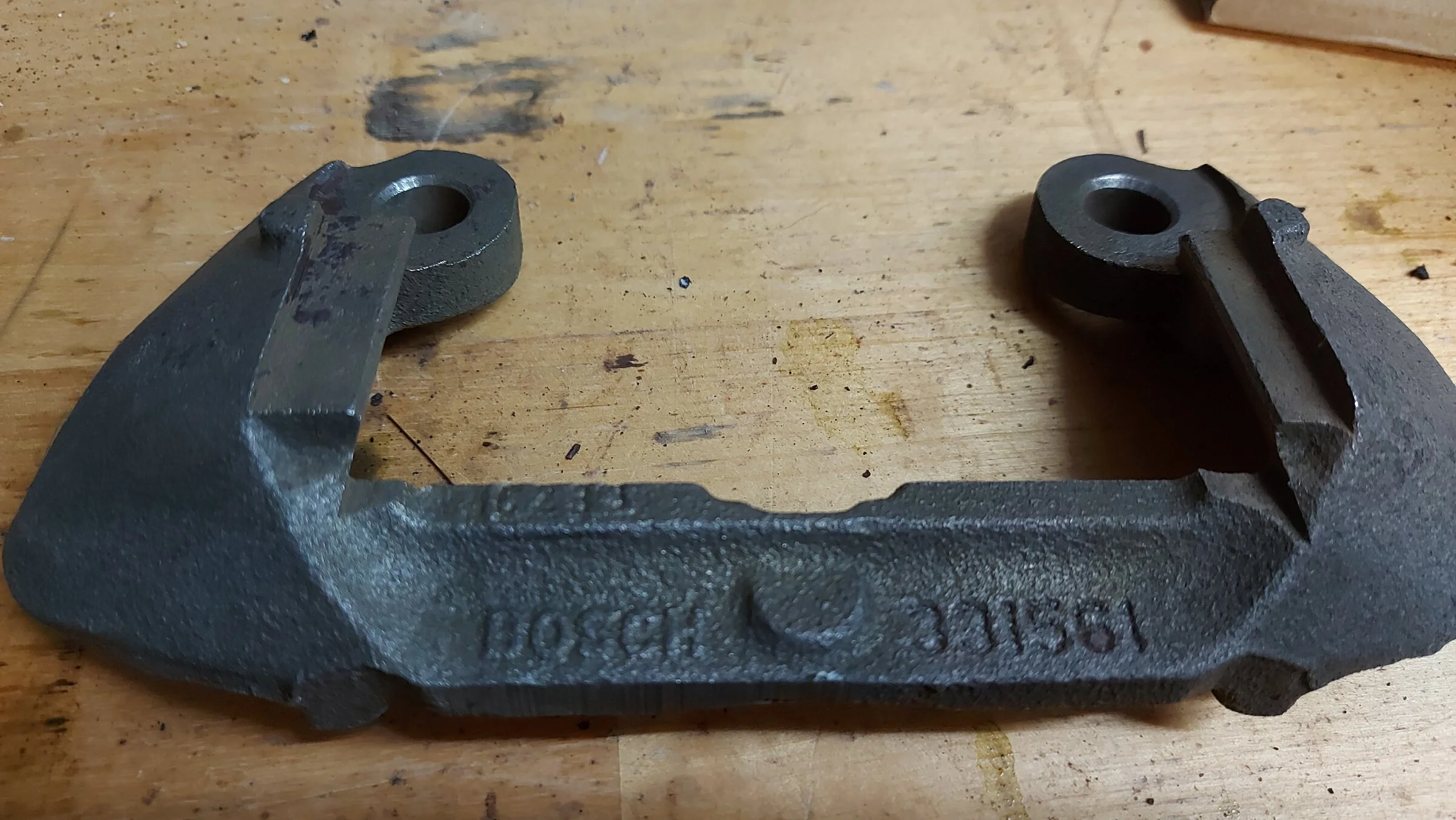

On Friday a tub of Bilt Hamber Deox C powder arrived, £16.49 for a Kilo off eBay.
Being as impatient as i am I dug around for something to de-rust! I give you a spare pair of rear caliper carriers...

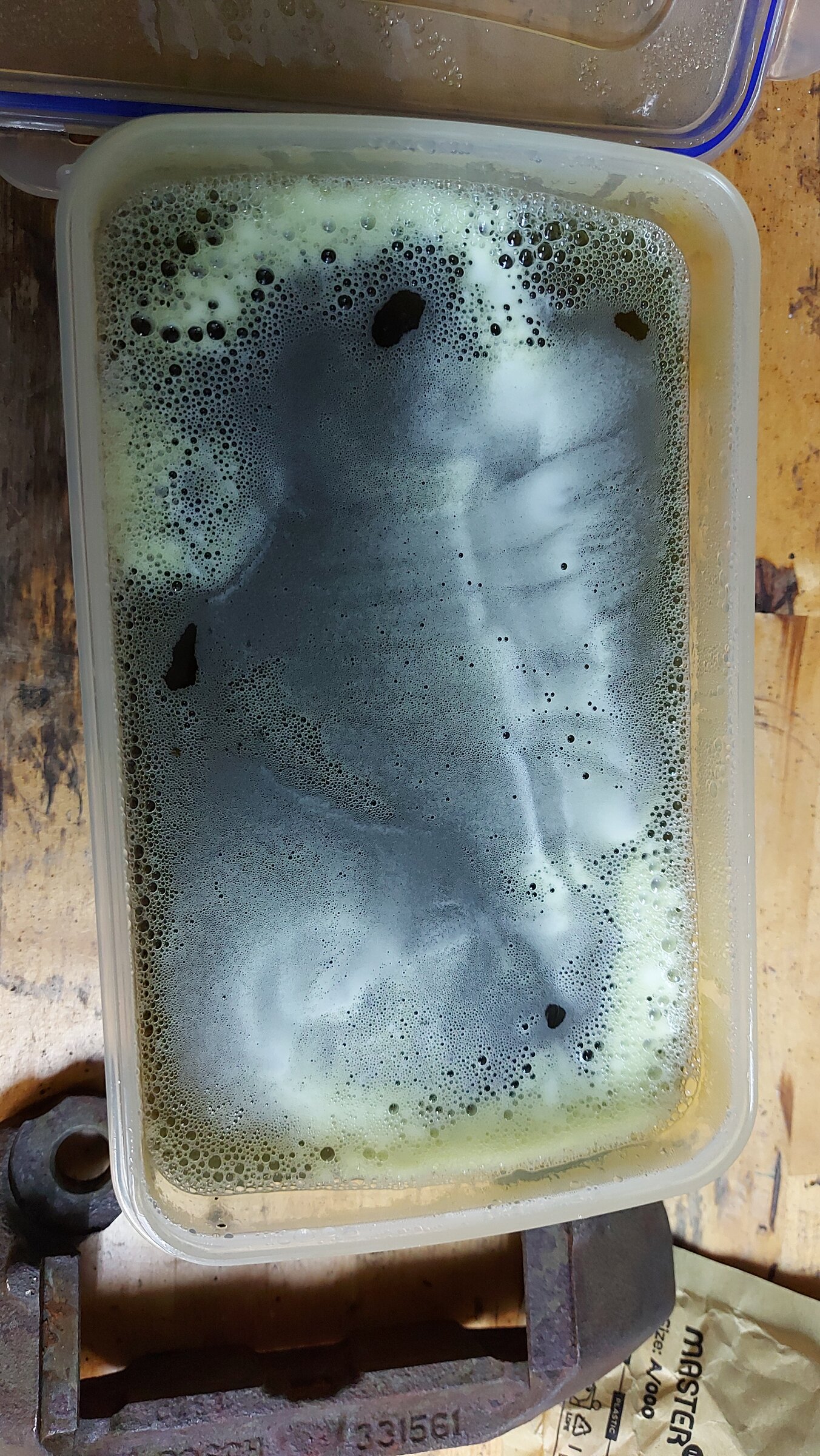

I made up a batch at 19:1 with hot water and dropped in the first carrier (I only made 800ml as the tupperware wasn't very big), it instantly started to fizz away...
6 Hours of soaking and the tub looked like this...
A quick rinse and a scrub with a nylon brush, quite incredible!

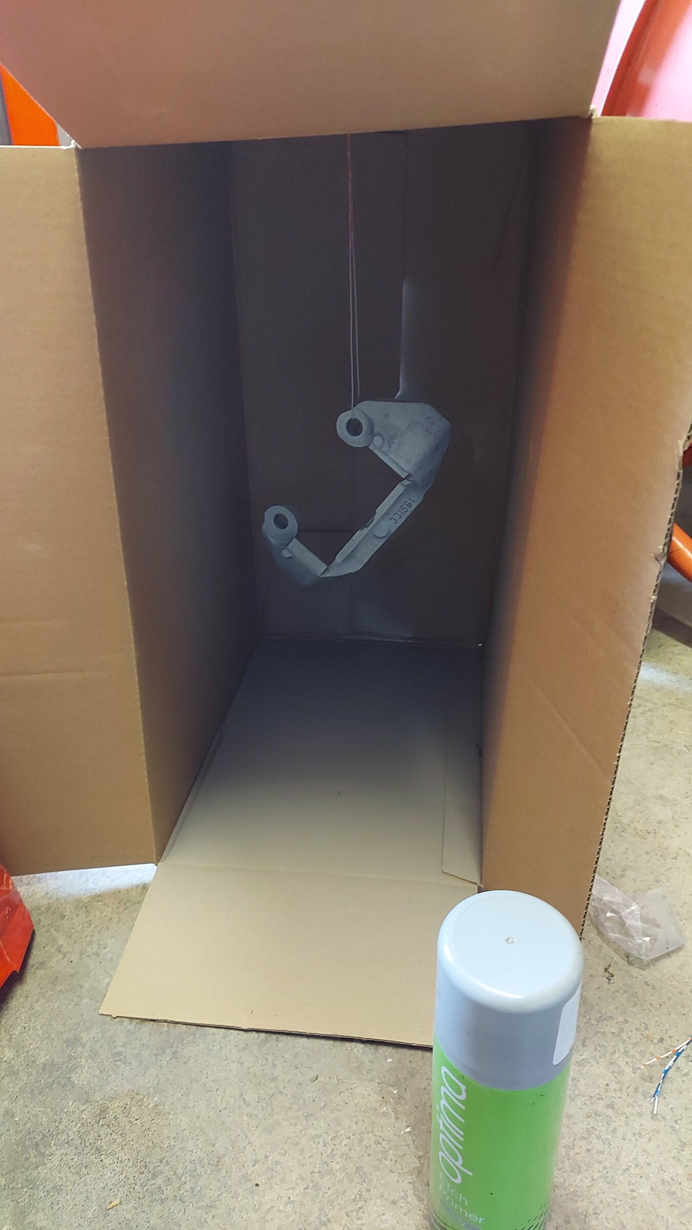

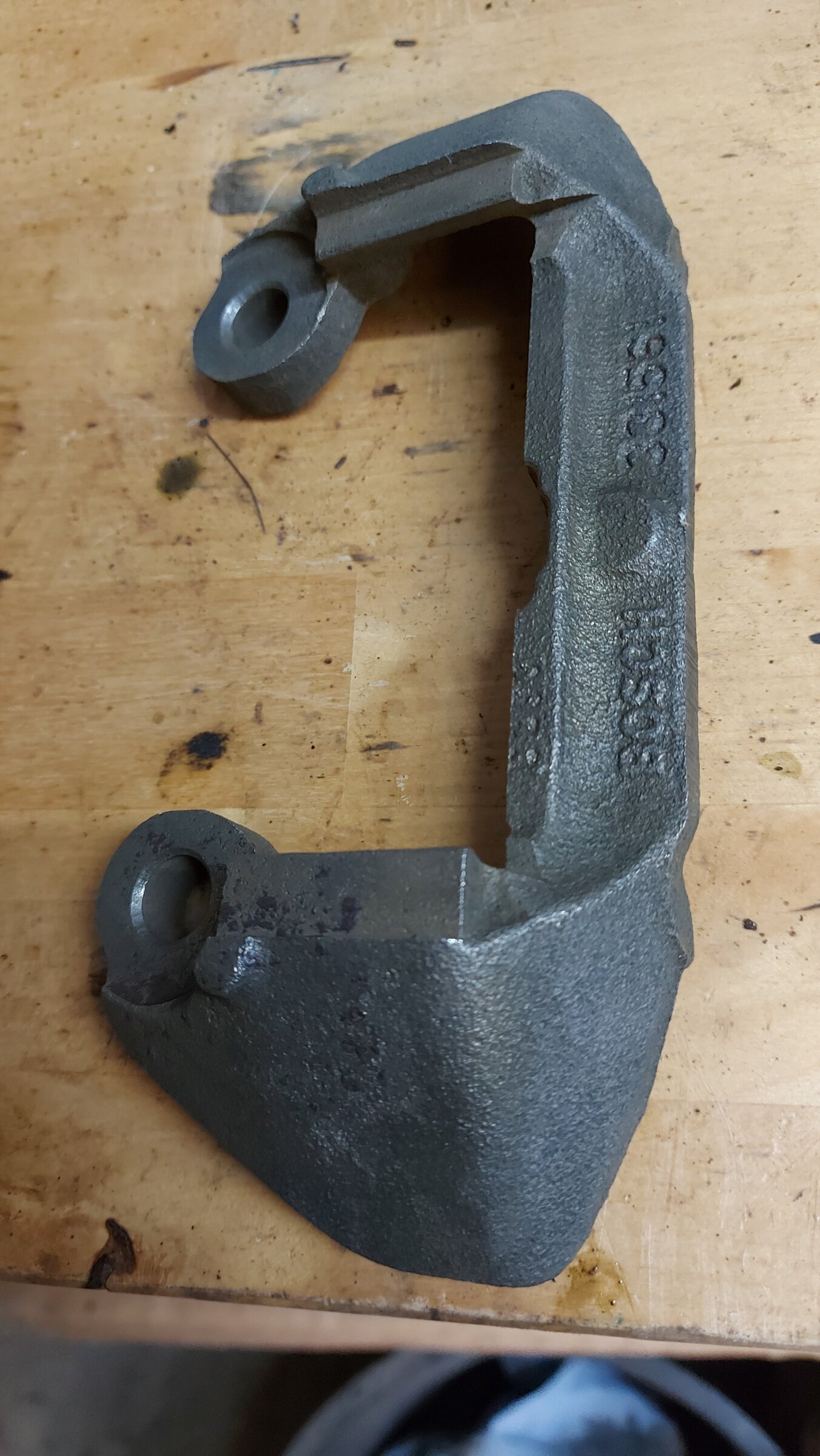

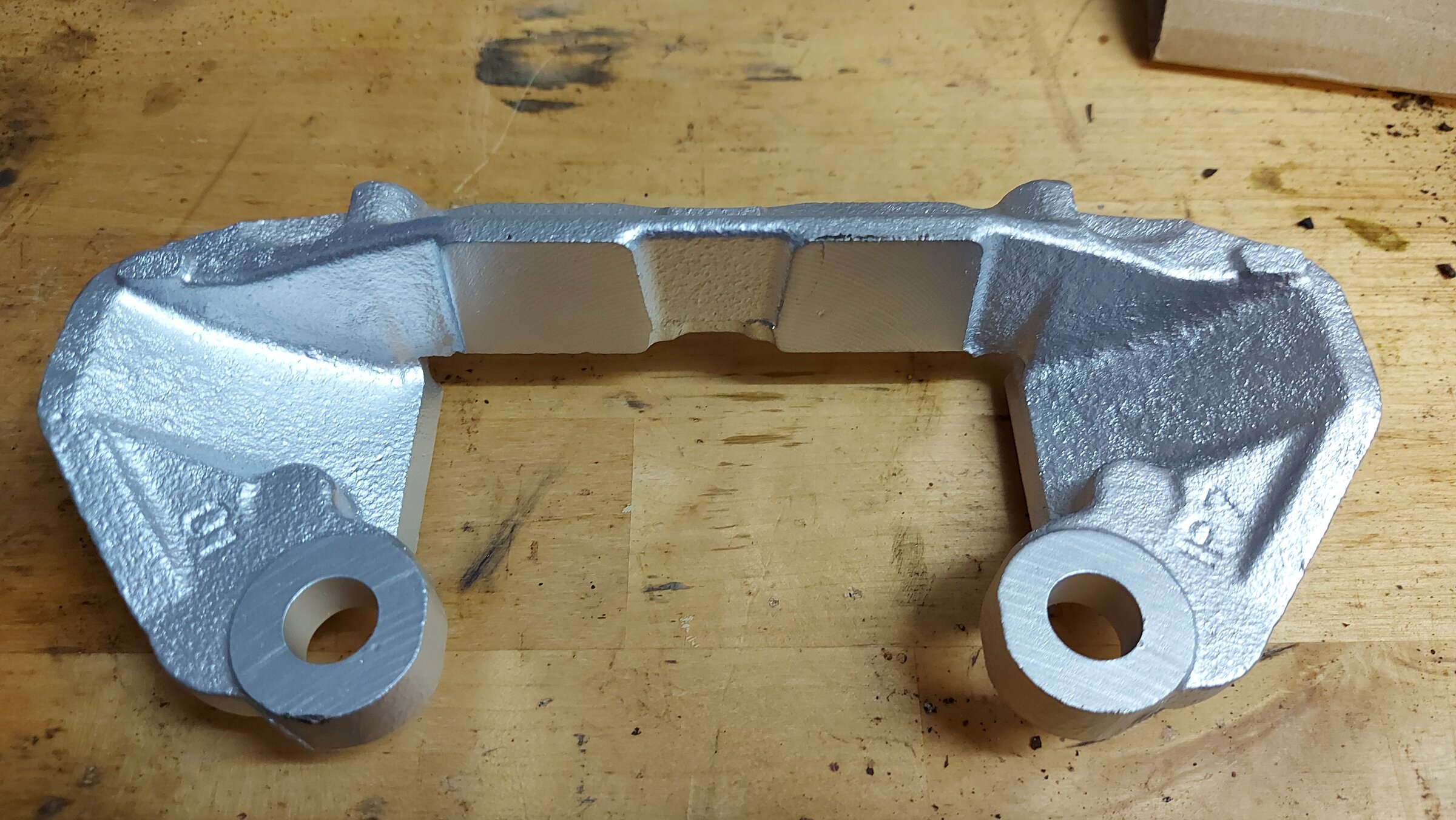

Into the "booth" for few coats of primer and some VHT silver and the first one is looking pretty good!
I only used 40g of the power, which equates to about 65p. In my opinion a complete bargain to get it as rust free as that, almost looks like a fresh casting! I've got a tub of the gel on order for the sills and a few on the bits on the shell, hopefully its as good as the powder.
Plan is to get the other finished and then maybe strip the fronts off and give them the same treatment.
Cheers

Good work! Off to get some of that powder now! 😂
Lol Cheers, It's impressive stuff. I'm not planning on getting some of the Hydrate 80 Rust Converter to add to the line up! I'm pretty sure once i start poking about underneath i'm going to find more rust!!
Need to get the front calipers off and get them in to soak! I've ordered the Bigg Red Seal kits and pistons so nothing stopping me getting on with it now!
