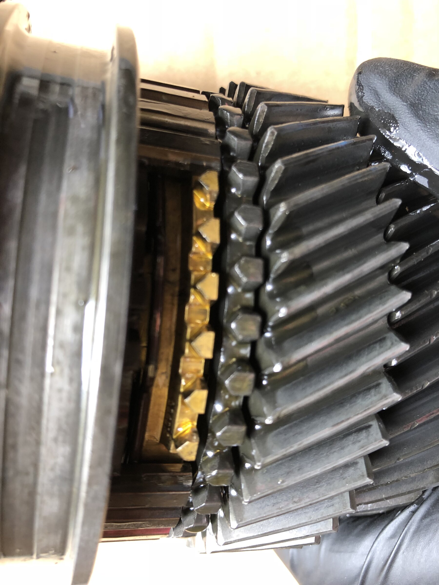

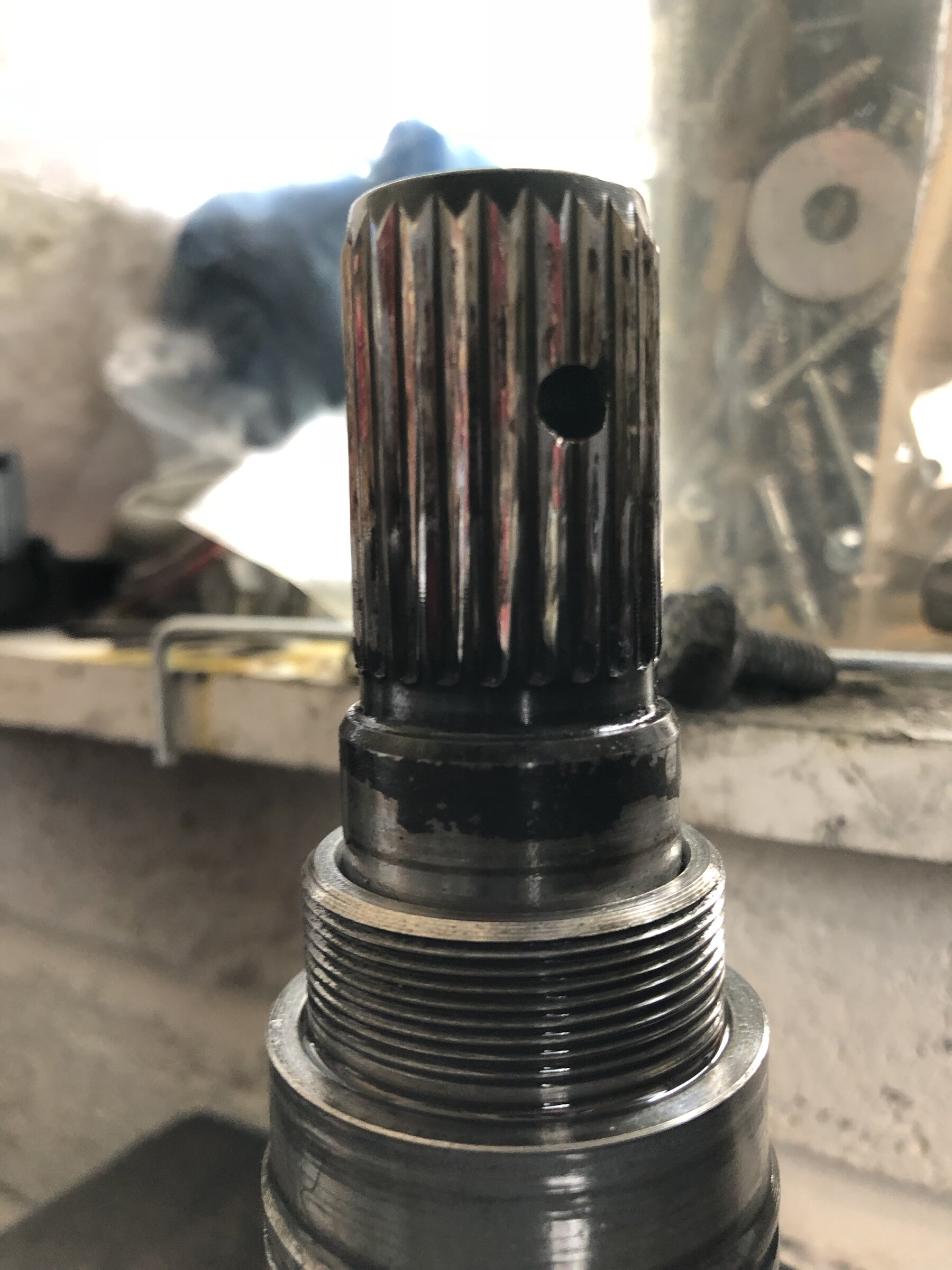

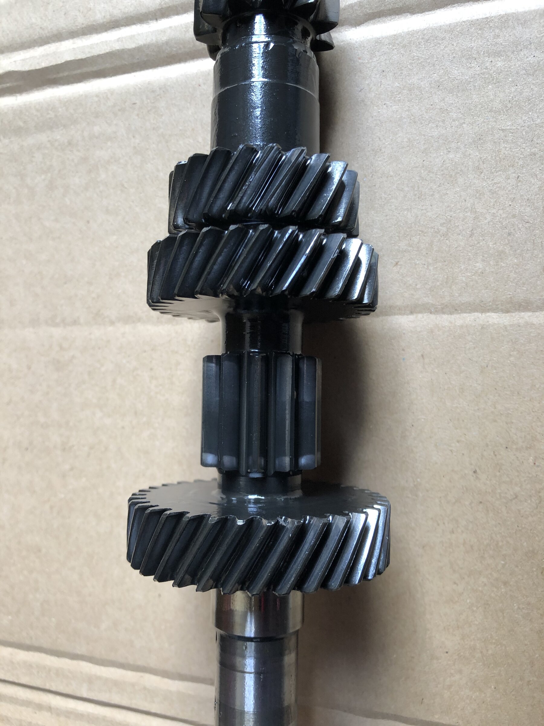

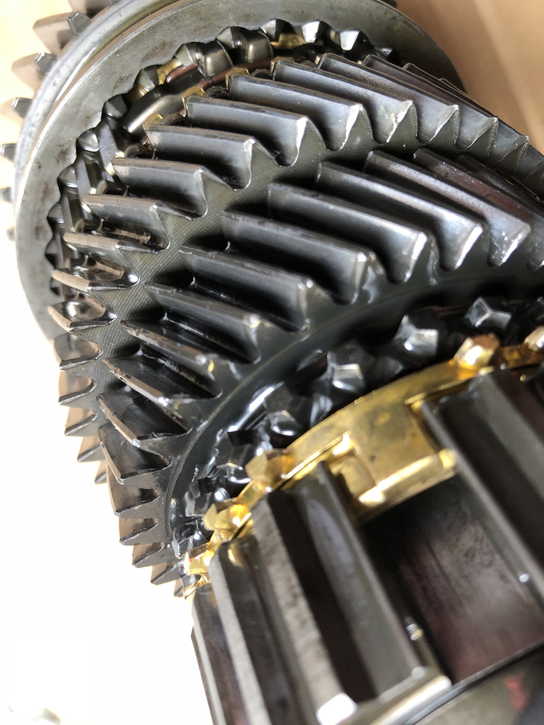

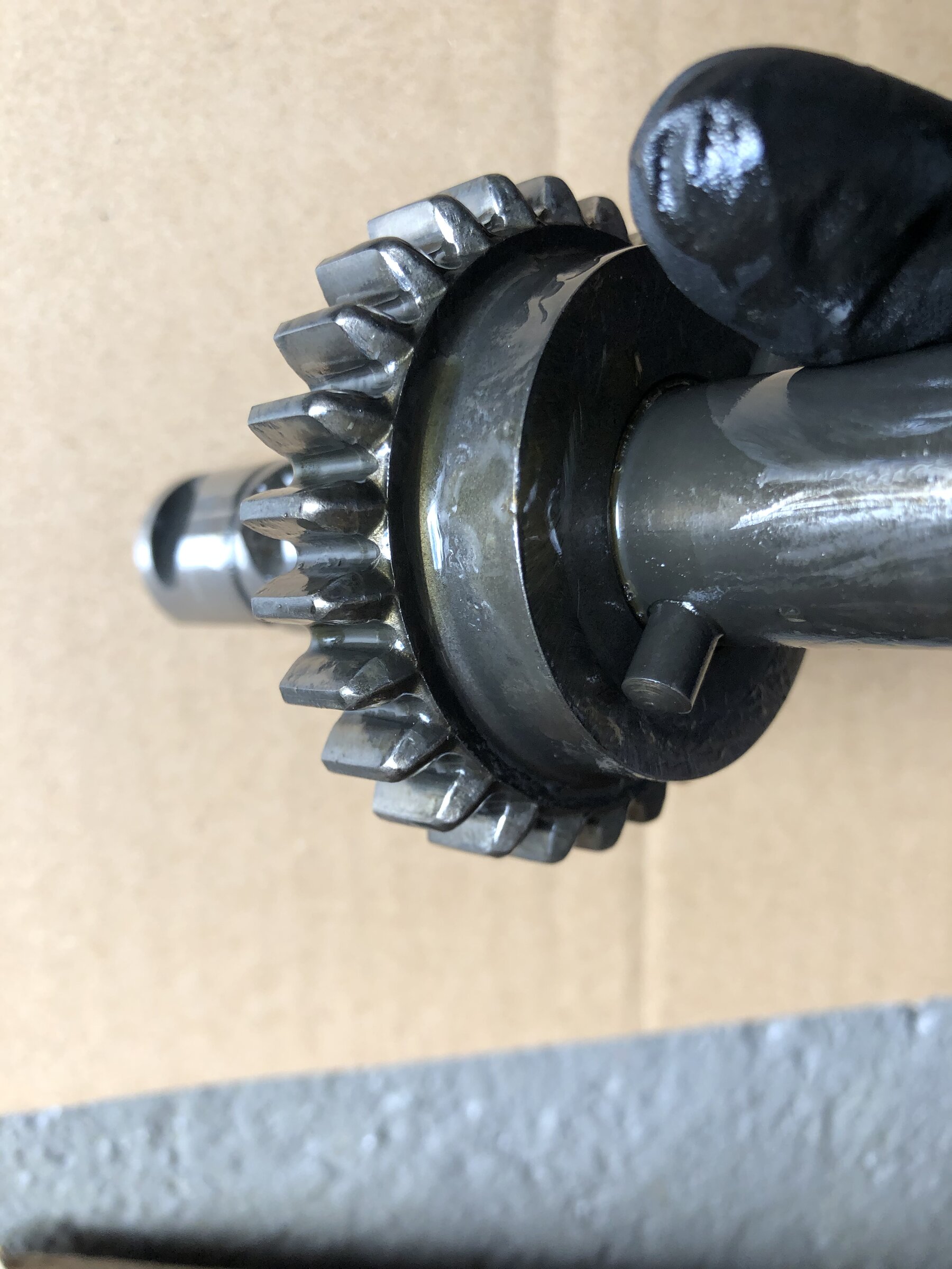

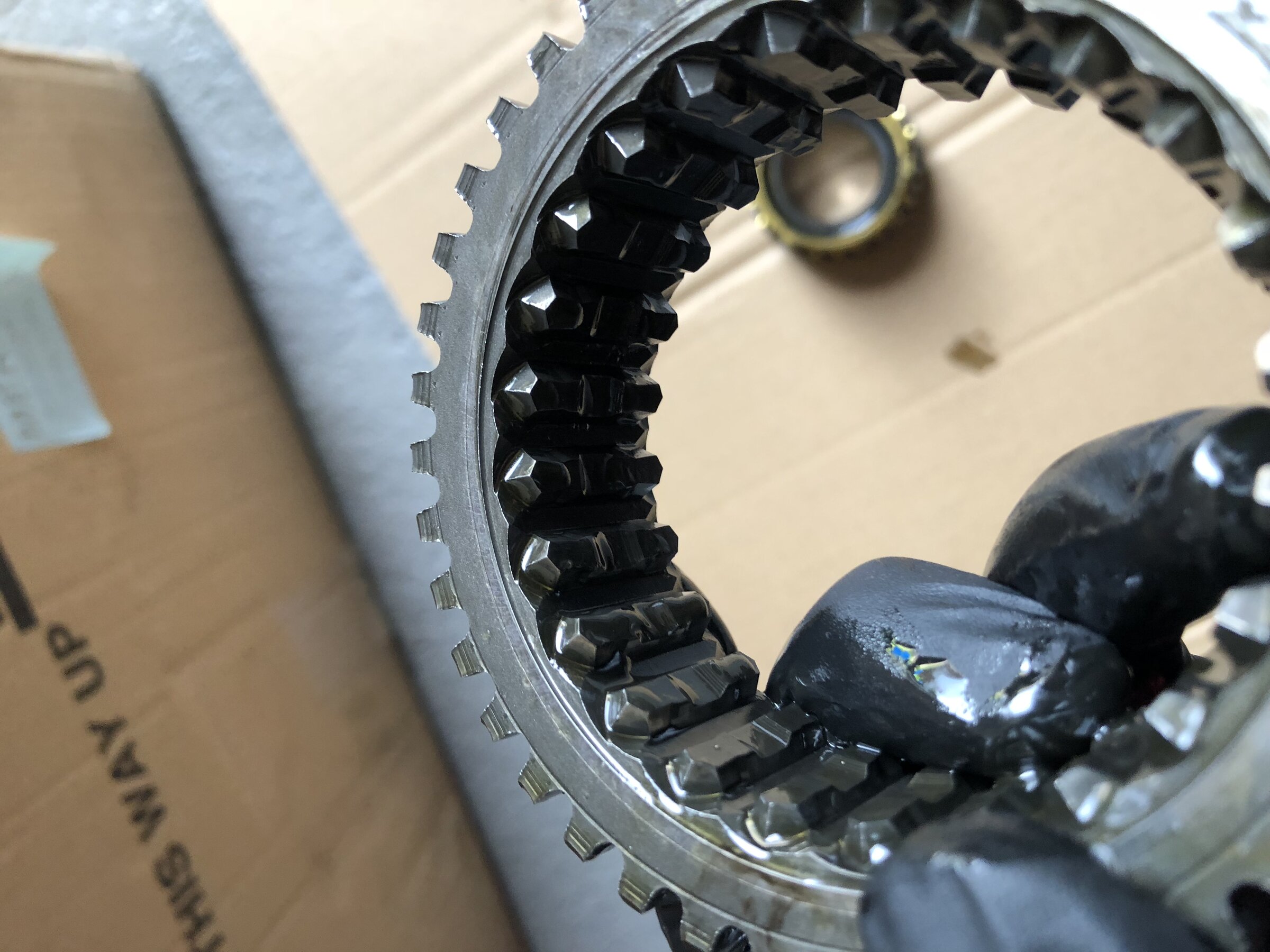

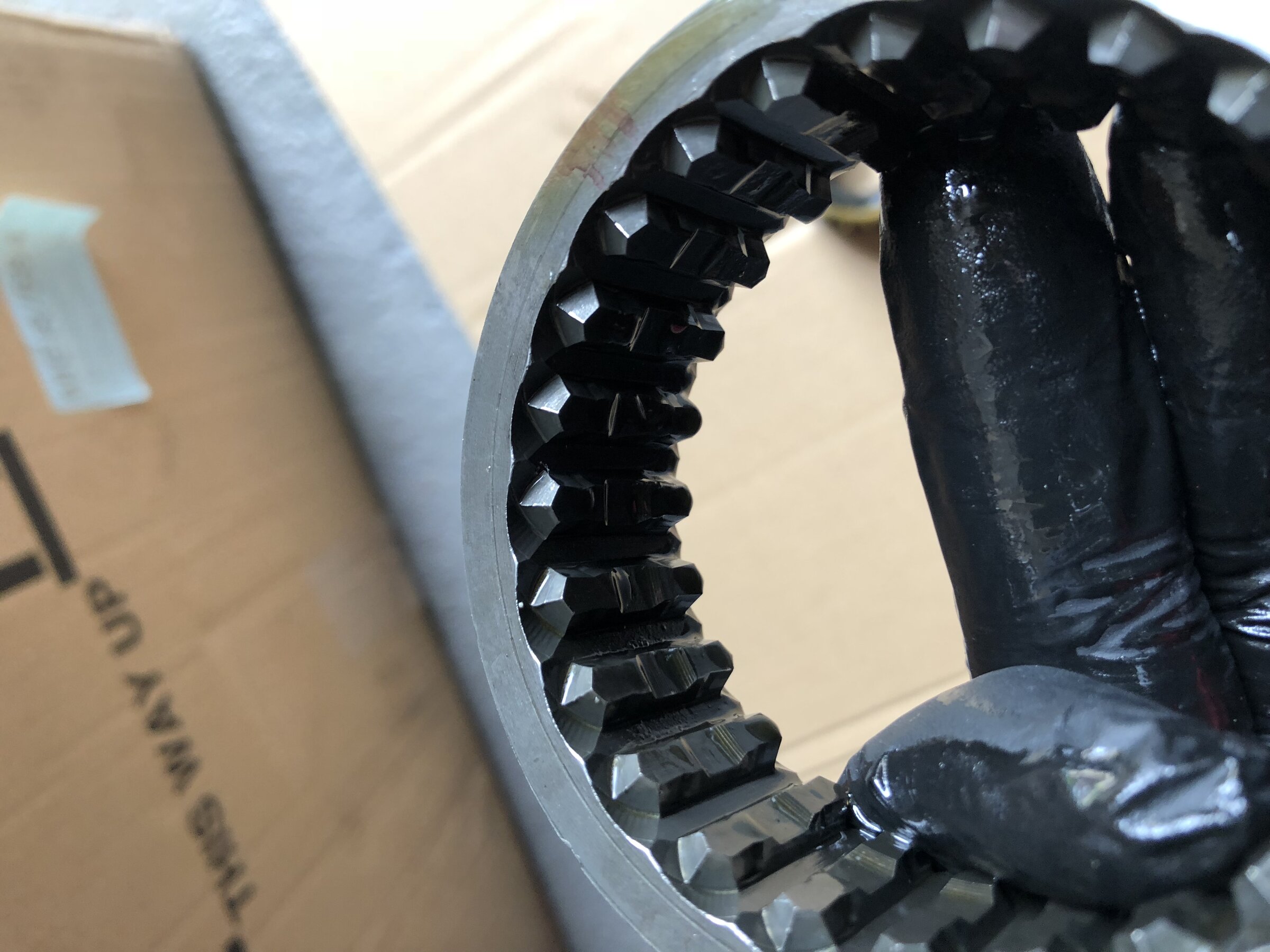

Well as I’m sure you all know, I rebuild quite a lot of jc5’s, so when I was asked to rebuild a box that had covered 165,000 miles, I was expecting the worst.
Oh how wrong I was!! This gearbox is THE best one I’ve ever seen, and when you consider the mileage, it’s a unicorn! Lol!
Here’s some pics of the internals:
Still got points on reverse gear
Still has points on the dog teeth for 2nd gear, and zero synchro wear

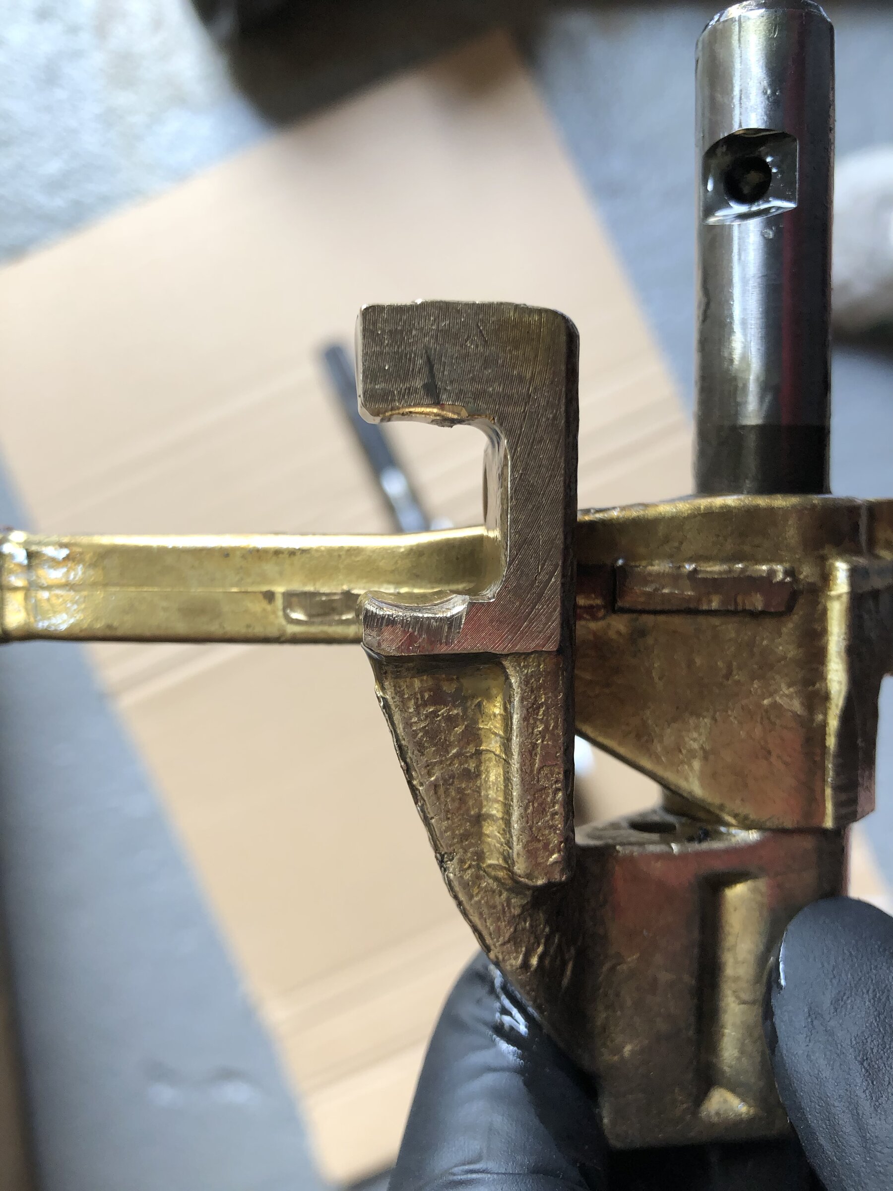

Minimal wear on the selector fork for 1st/2nd gear

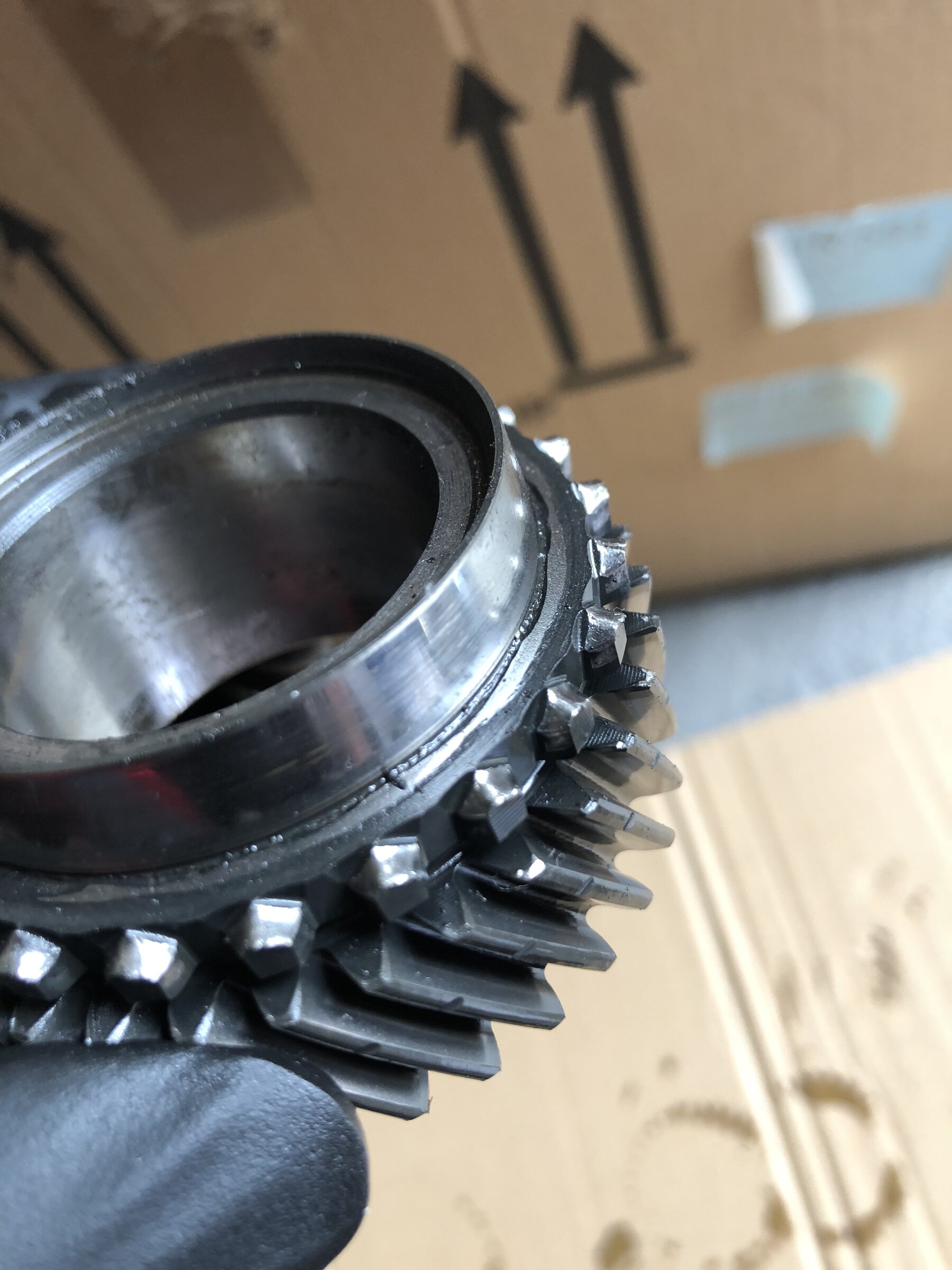

Nice pointy teeth on 3rd

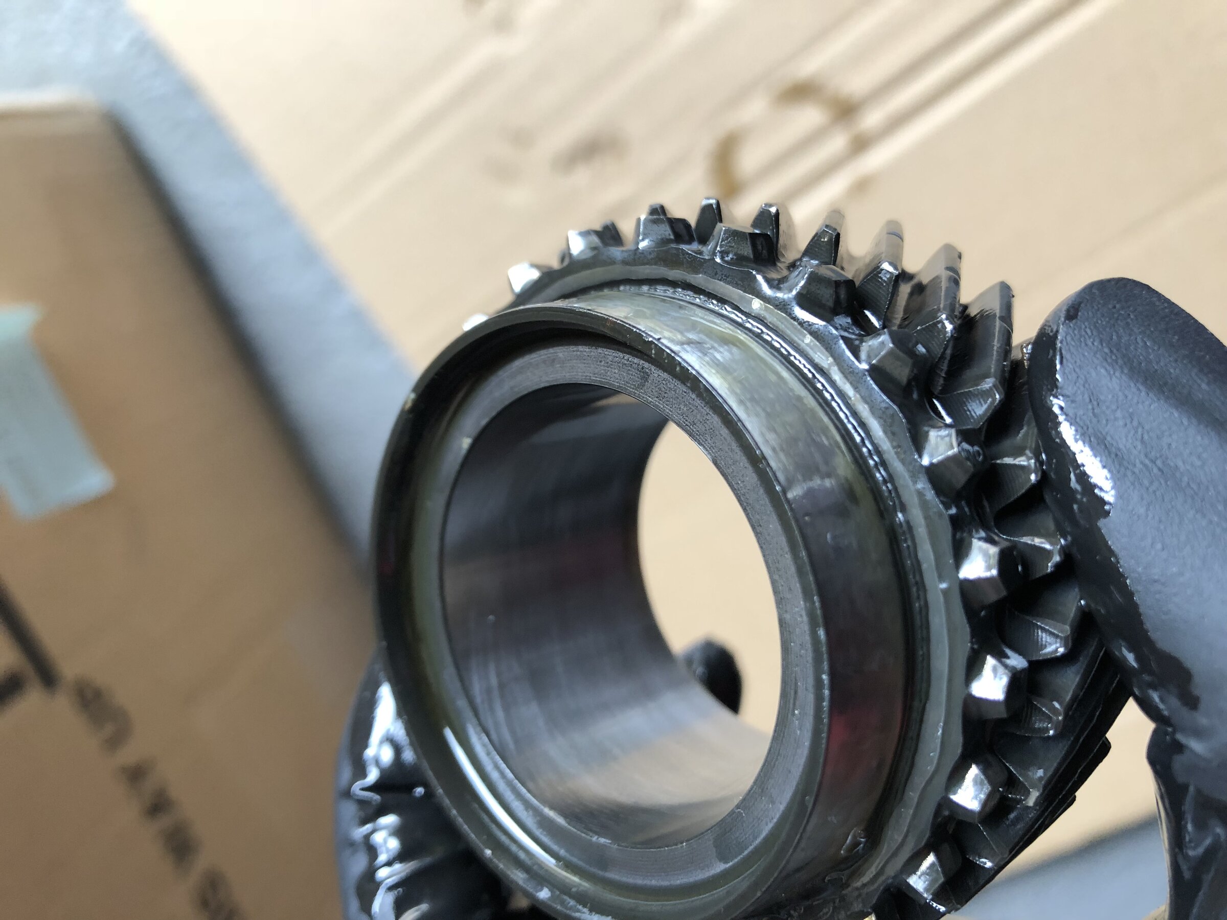

Same goes for the selector hub for 3rd/4th
4th gear as new

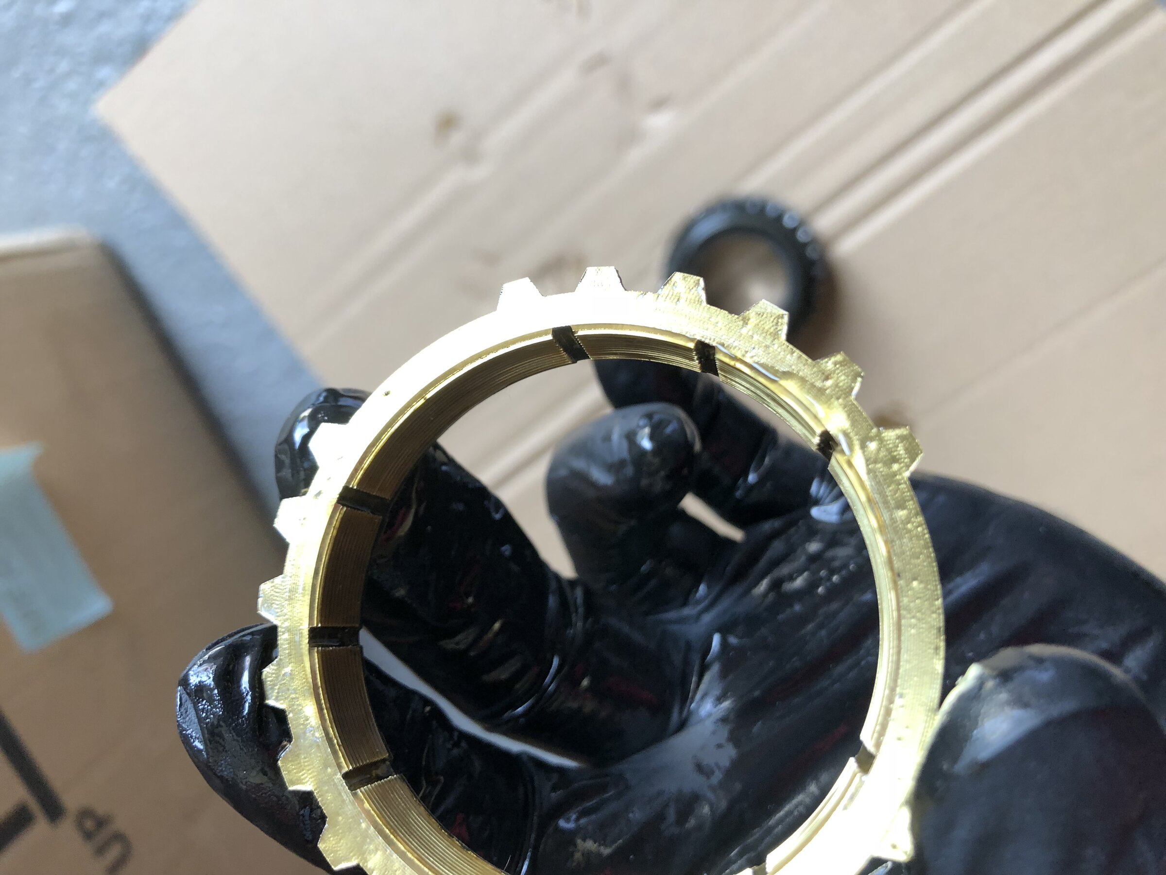

Synchro ring showing minimal wear
This just goes to show if you don’t abuse them, they can last.

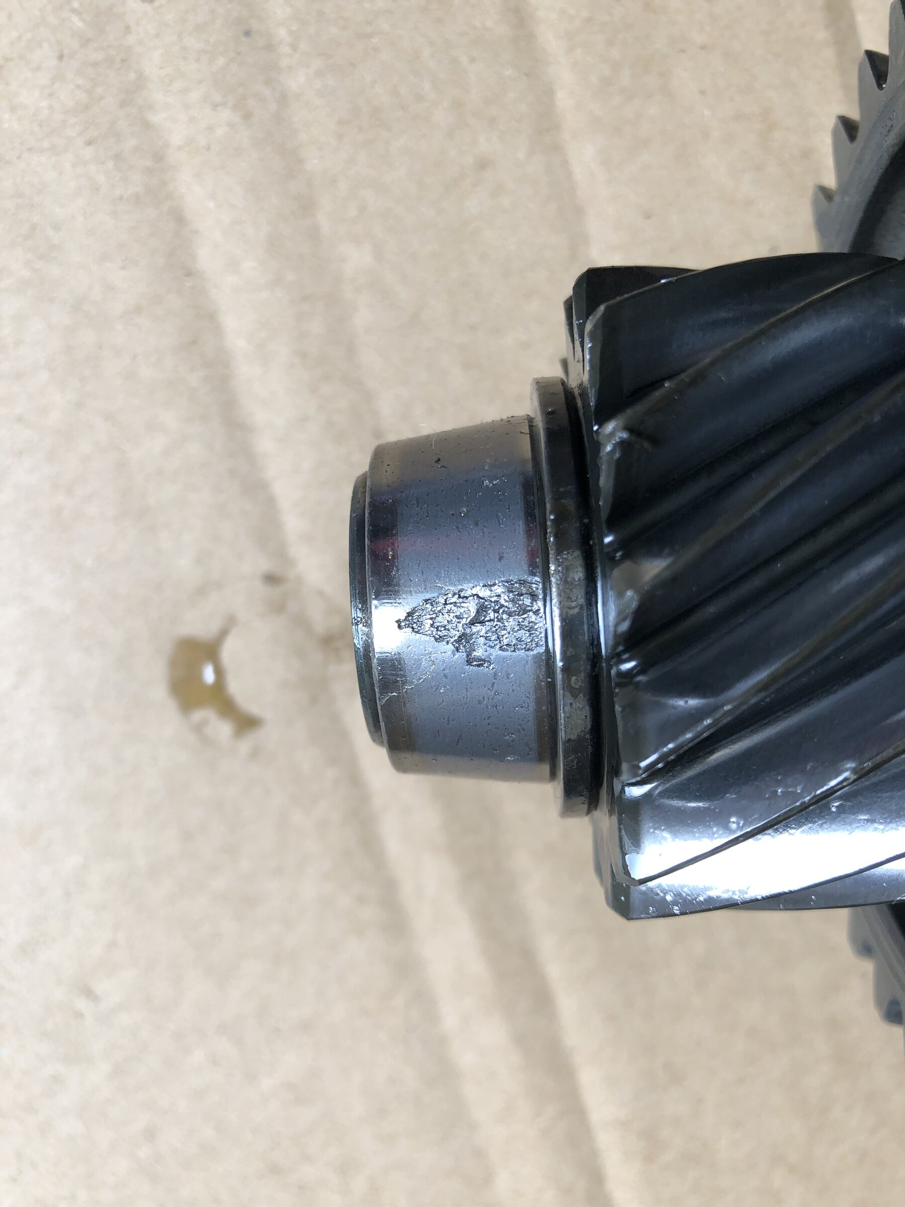

Next up the bits that have worn and require replacement!

It could well be @incy-spider - though I couldn't honestly confirm the oil without going through the receipts.
What I will say (and have said in the past) that dropping and replacing the oil in the gearbox as an occasional service item clearly does work wonders. Yes, it has never been on track in its life and I do have a fair amount of mechanical sympathy for cars in general - not just my own. I don't give it death everywhere and not changing gears like a F&F film seems to help too.
I'm thinking (and Mark would be a far better judge than I) - that what damage has occurred was directly related to the driver's side driveshaft going bang about 16 months ago. Even though it let go at sub 5 mph when pulling out of a junction - what issues are there could have been as a direct consequence of that?
It was definitely on borrowed time - the whining racket that came from it in any gear at any speed, kind of convinced me that it would be terminal without immediate help!
