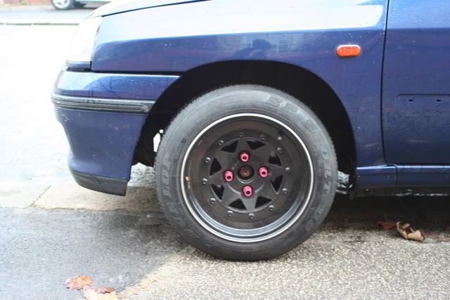

this is what i fitted to my 182, got the stud kit from ebay and the mcguard locking nuts from autosport show
and some threadlock from GPR

hi mate i have studs on front of my car, piece of pi$$ to do, locktight and two nuts locked together,
different lengths can be found here
http://www.priracing.com/section.php?xSec=92&jssCart=7a76c981ec1372f36c2f7f46316e9fea
they also do some lightweight nuts, i got blue ones they weight next to nothing seriously, but mine are lathed down so i can get covers on them
(reason for putting studs on front was the 25mm spacers didnt trust long bolts)
