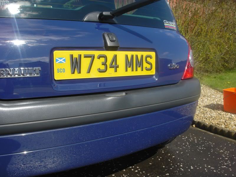

Fair enough it is 2 weeks old but it doesnt look much different when its just been applied, seems to just not work as well as when I first got the car (3 years ago). Do I need to somehow strip the old stuff off, if so how? Or should I change from AG Bumper Care?

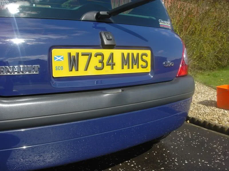

And my 1 other pic from today, just a quick clean and dry no polish or sealant or anything!

AG bumper care has been good for me over the years, might try that stuff from carwashnwax tho
Never had a problem with AG Bumper Care either. Clean them back to bare Plastic with AG Motorcycle cleaner to strip off all the old and re-apply, worked wondrs on the black trim on my old 205 GTi. Over time this stuff just builds up.
I don't know if the plastics are the same on a Clio but my Chipsaway guy uses a heat gun (paint stripper type) on mk1 Corsa arches where they fade really badly.
He doesn't do anything major, just lightly covers the whole area until it darkens. Works a treat.
I use AG Vinyl & Rubber care and it works fine with a nice protection and it brings it back to back too.
The AG Vinyl and rubber gives a great Gloss, just a shame it doe not stand up to rain better.
AG Bumper Care, allowed to cure for an hour then topped with AG Vinyl and rubber works well to.
