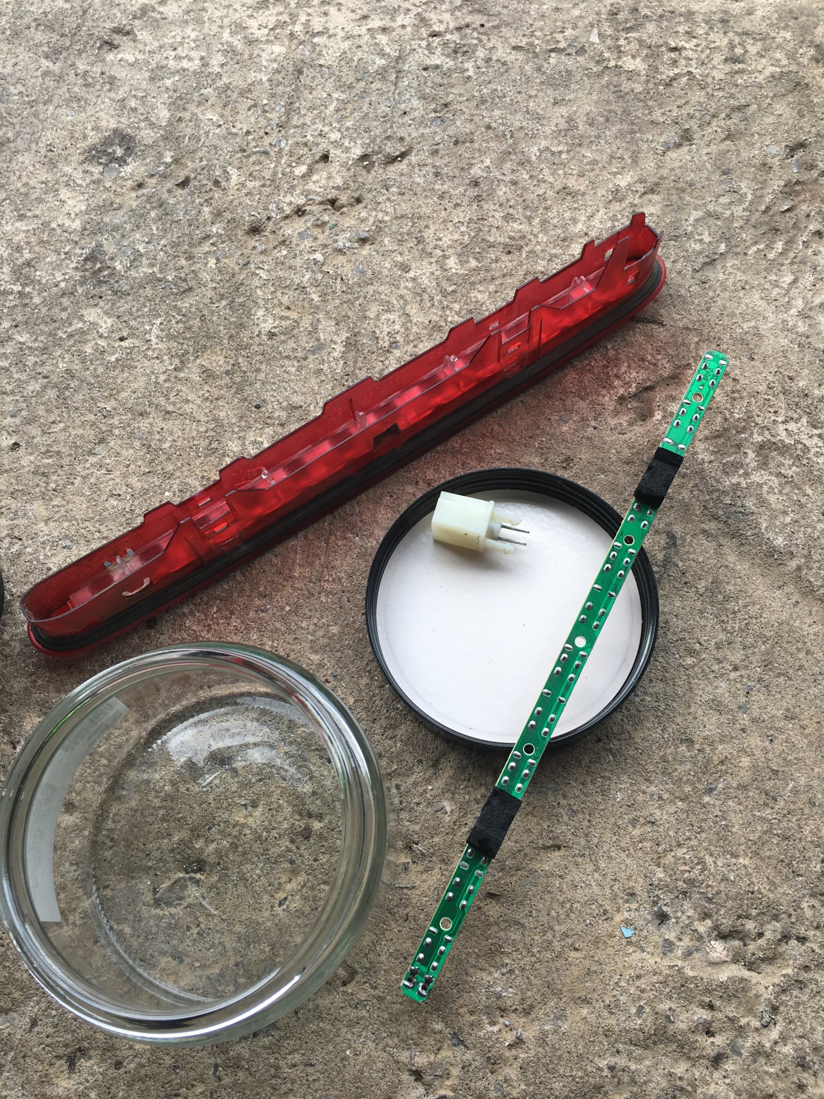

Just literally fixed my dodgy light! Got it out of the spoiler then split it all down.
The pins on the white connector and the sockets soldered on the board looked pretty corroded so I took my dremel and a wire wheel to then. I then wire wheeled the solder joints on the board. The internal pins in the white connector were hard to get to so I used a cylindrical file piece in my dremel to clean them up being careful not to catch the plastic. The sockets I pinched with pliers to increase the tension they lock onto the pins.
I used a tweezer to scratch the surface corrosion away from the sockets on the connector that was in the spoiler. The brushed it all down with acetone. Assembled together and hey presto, third brake light!
