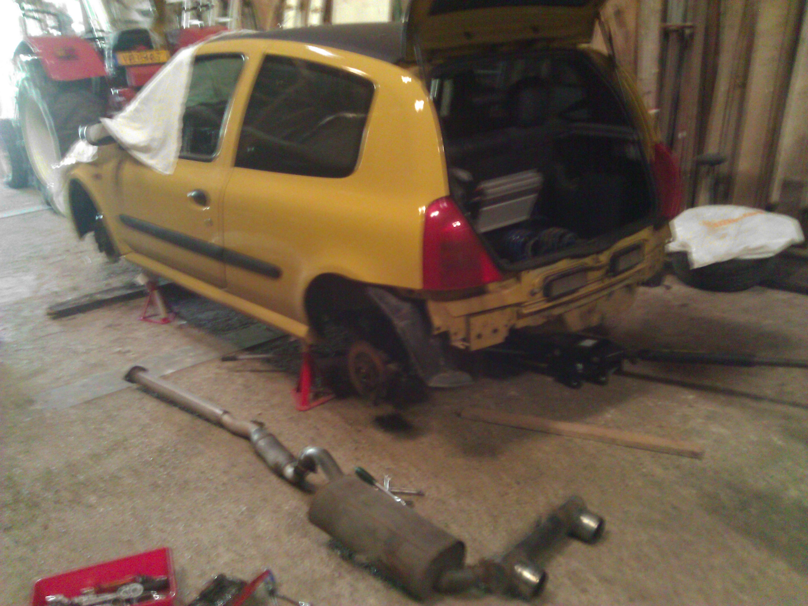

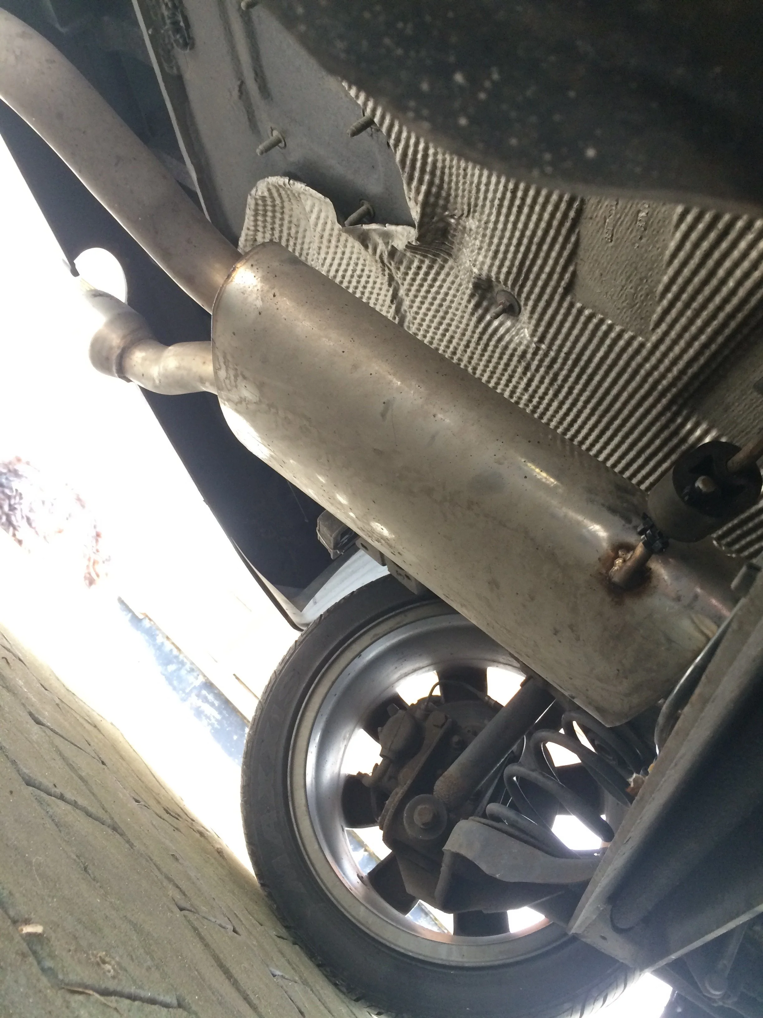

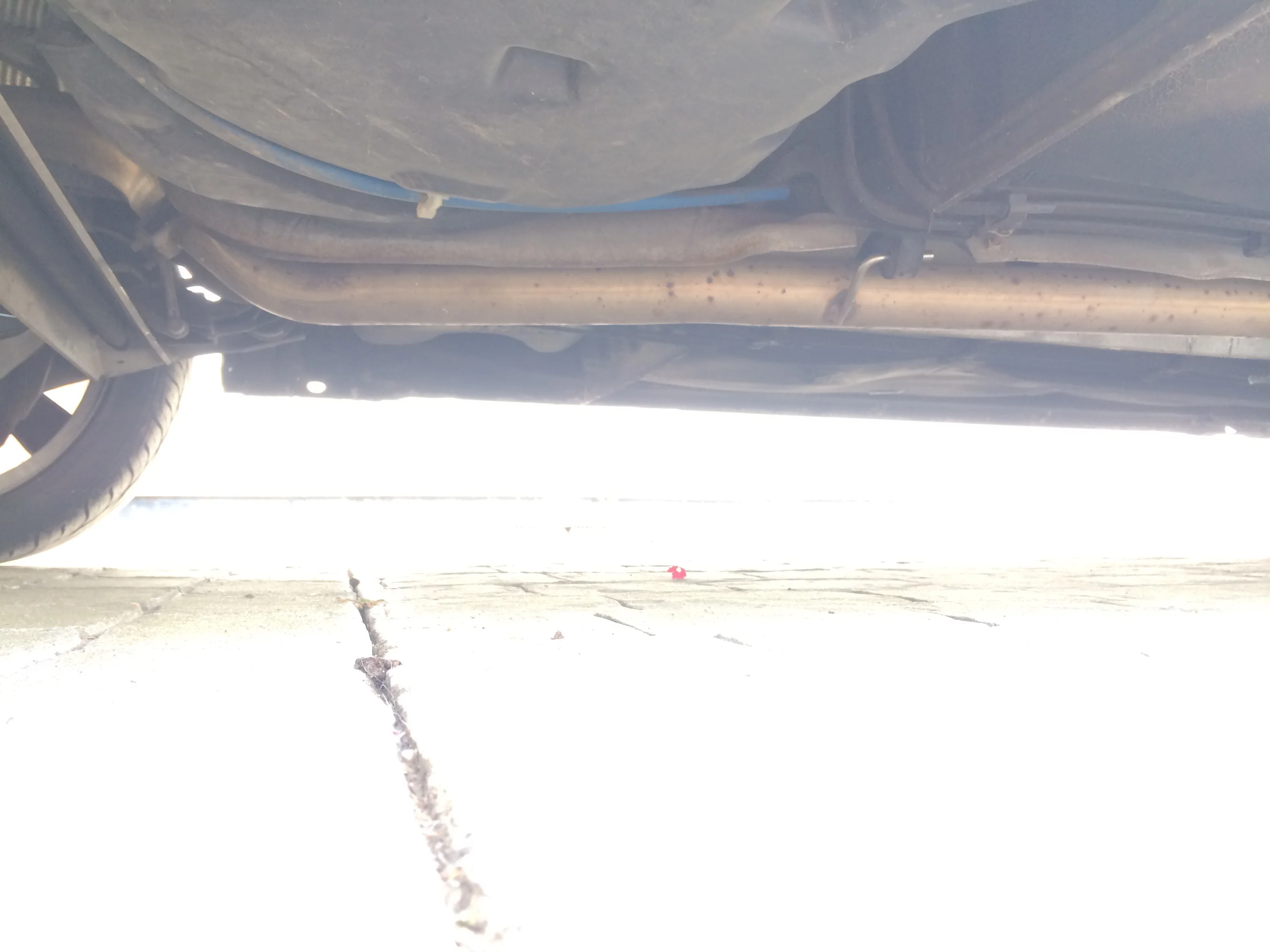

So looked underneath and this is what we have :
Yep that's right, a straight through all the way through! No wonder it sounds loud
I've got the receipt here which going off I'm guessing the diameter for the majority is 2.25" (57mm) :
So basically I'm wondering what I do next to make it quieter? Still want something that sounds good, just not quite as loud
Or am I better off selling this and getting a different one?

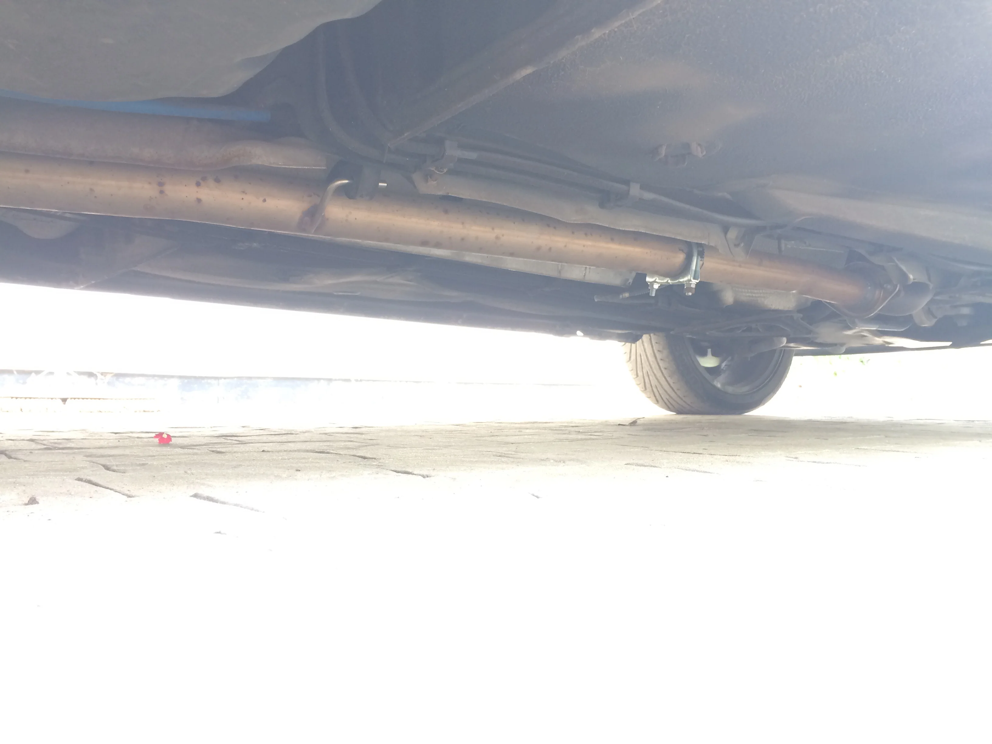

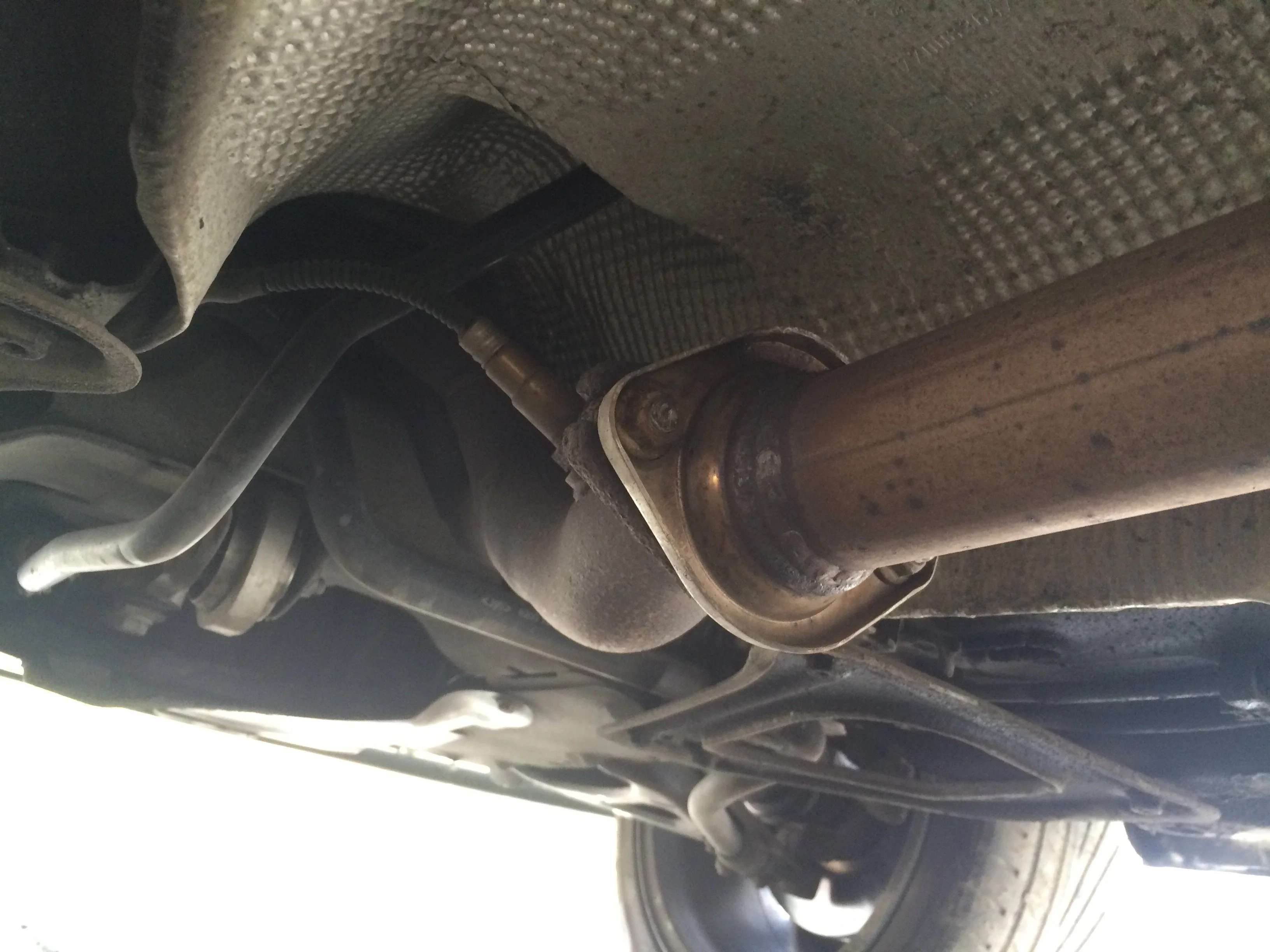

Here's a couple more photos of the system if it makes a difference:
Many Thanks

Either get a silencer, get ear plugs or sell it

Get it adapted to run with an oe cat
I'll look into that, Can you run a secondhand cat fine?

Yes, as long as it's intact
Perfect, I'll start looking!

Why would you have an exhaust made that couldn't easily have a cat put back in, bearing in mind you have to have one for an mot (yes I know there are 'those' mot stations but what if something changes?)
It's easy to cut in a silencer from anywhere...

have they done away with one of the rear exhaust hangers? i'm guessing those studs sticking out the boot floor is where it used to be.
if you just buy a cat and get some pipe welded onto the end of it and cut off the olive joint then it will just fit straight onto that system, i did the same with my clio when it had the cat on to get rid off the rubbish olive joint.
If I'm honest, I have no idea - I don't know what a standard clio 182 setup is like, so I'm not sure what should be where
Yes I know someone who is pretty good with welding, so might get him on the case!

Defiantly a dodgy mot, My 172 with a decat and no mid boxes is 7X over the limit. The results you posted are from something like a 1.0 Ecotec KA or similar. Not that its a problem... ;)
My car was the same when I bought it. Fortunately I had the OEM system to the back box. Putting the mid silencer and the cat back in makes a big difference. The back box still sounds better than OEM.
If you have a custom air filter that makes a big difference too. However the Cat makes the biggest change to the volume.
