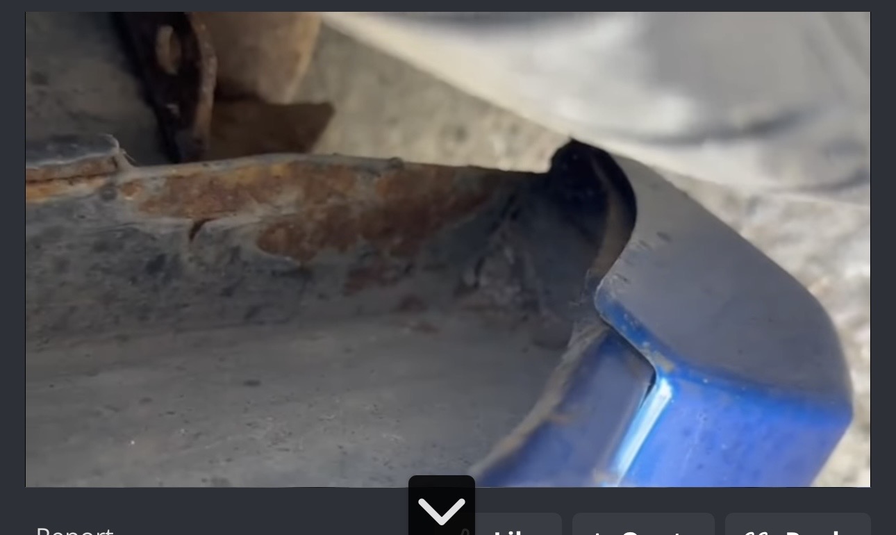

Just after some thoughts on these 172 Cup arches. I know the video isn’t the best but they seem pretty clean to me, is this nearly as good as you’re going to get?
Can’t really tell f**k all from that. What you need is the seller to pop the rear speakers out, move the foam aside and stick a camera down the 1/4 panel and take a photo. If clean you’re all good.
