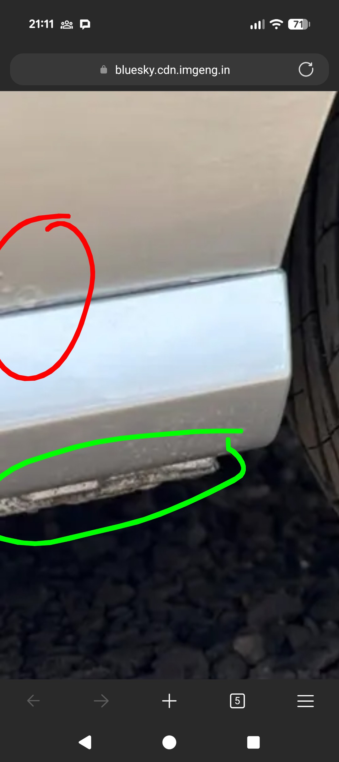

Not sure if this is a reflection or the sign of some corrosion on the left of the photo above the skirt.

Id want a good look at it as that red circle looks like the telltale rust bubbles and if you can see it there then there's probably no sill left.
And the green circled bits, those are never body coloured these days, especially not THAT bright, that's where the rusty water from what's left of the sill leaks out, someone's painted that.
However most need sills now so as long as the price reflects it, your happy to take it on and the rest of the car is good, I wouldn't be put off, but just be mindful of what your getting Into
