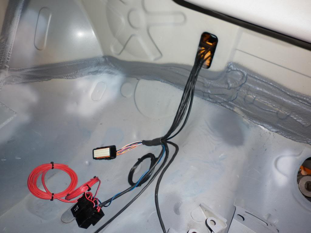

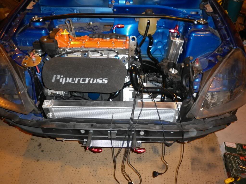

It appears to be more universal but will allow the ecu to be mounted internally which is a good idea with the 600 as its not waterproof.
I have 2 pics that I took when checking the fitment, any excess will be coiled internally and secured to bulkhead instead of in the engine bay.
And this was what was left inside with the same length outside in above picture.
The full throttle shift is aimed more at manual boxes really I think with a switch behind the clutch pedal which you won't use on up shift anyway with a sequential. It cuts the ignition basically or what Omex call scatter spark, the same way in which there launch control works, my launch control will be used as a pit lane speed limiter instead. The ignition is cut over a pre set rpm of your choice so that you can still keep the clutch depressed without stalling. Im sure the switch could be gear stick mounted to allow ignition cut when you want it. Speak to Omex, helpful bunch.
EDIT: I forgot to mention, I had relays wired in for fuel pump and fan at a small cost (included in the £600 I paid) which will allow me to scrap all existing wiring, can be seen in above pic. A small loom would be required for lighting circuit.
