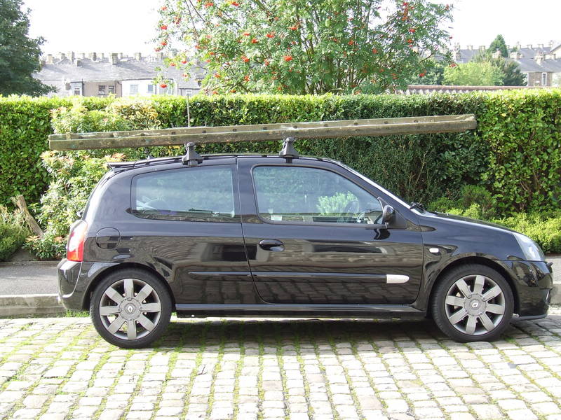

You'll find various pics showing where the rack should be attached in here or here

And another thing, I've found the rubber pads were scratching my roof, so I got some paint protection film (the stuff that can be fitted to the front of cars to stop stone chips, etc.) from ebay and stuck bits of it to the roof where the rack attaches. They're clear and although you can still see them, I'd rather have that than wreck my paintwork.
You can just see the edges of the film in this pic
Here is mine
