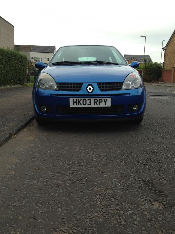

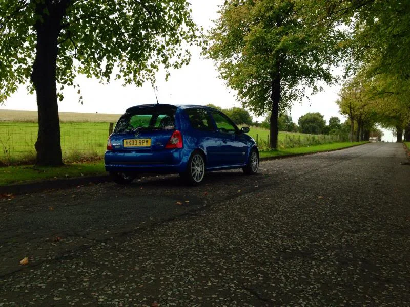

Cleaned her yesterday and by chance found a great location for pictures (that happens to be less than a mile from my house!)

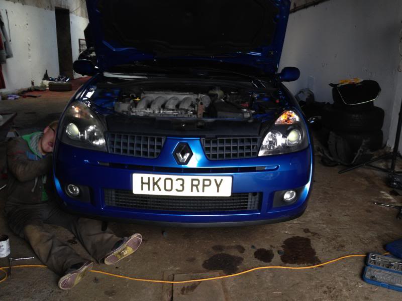

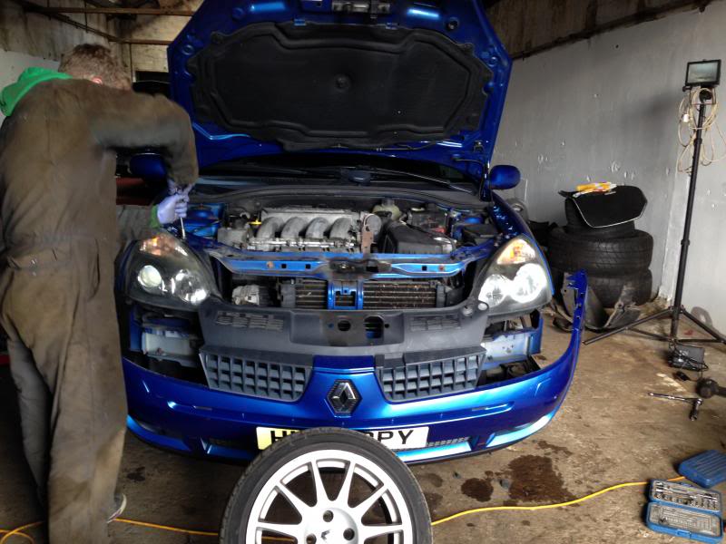

Since I got the Cup I always wanted Xenons so after scouting around for a pair around the forum since I got it I didn't want to have them posted as I know how fragile the clips are so waited for a pair to come up locally. Luckily, Stu & Dave got a Phase 2 in for breaking and it had the xenons fully intact. So after agreeing to clean both their steering wheels, they agreed to fit the lamps for me (Cheers Stu!).....
Stu getting busy;

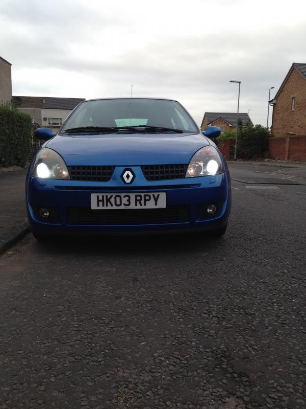

And the end result;
The offside front is a little misty but a light sand with the 1M kit will sort that out, i'll probably leave it until a warmer day (July/August) lol.

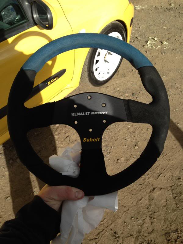

His steering wheel was in worse shape than mine and still came up pretty well!

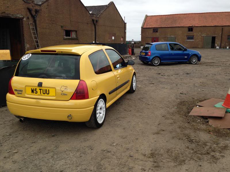

And one of the Cars!

Thanks again for my wheel, looks cracking! Going to give it another going over, what's the trick?

Fraz - no trick, just go easy on it! Really doesn't take much! I was pretty surprised at how well yours came up!!!

Warm water, soap, soft nail brush. Go at it easy, then rinse it with warm water and pat it down with kitchen roll - piss case!

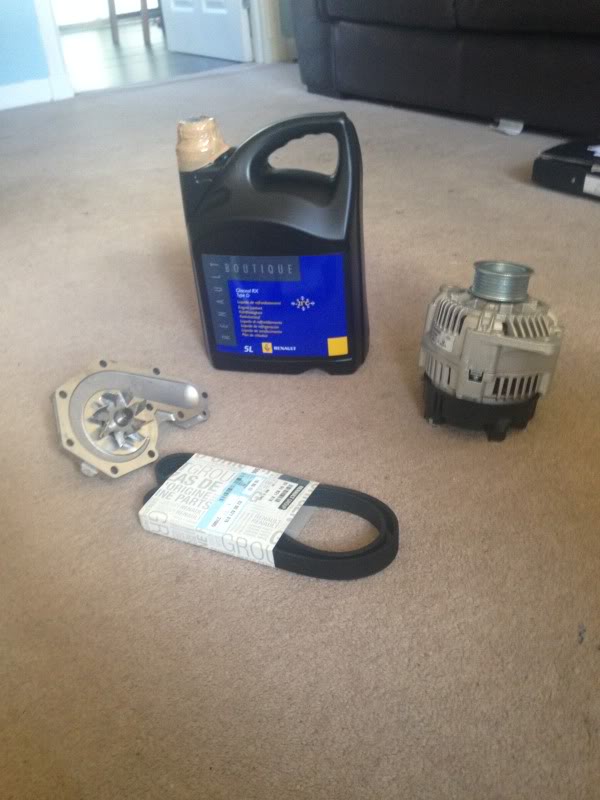

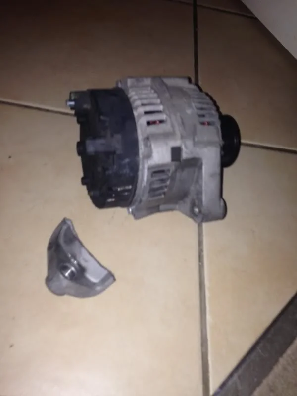

So anyway, last week i went to work as normal and the car was fine, finished my shift went to start the car and an almighty squeal coupled with smoke meant something failed. Had a look, the housing on the alternator cracked and so shifted about 5mm to the side causing the water pump pulley to foul the lower cambelt tensioner (i think?).
Anyway, bought all the parts and my mate shaun's fitting them tonight!

So anyway, my mate came over tonight to sort the cup out, stripped it down and found this;
There is a good chance that alternator was actually put on damaged, the way the nuts were arranged makes it seem so anyway!
The water pump was absolutely fine on tye car so didn't change it! Will be returning it tomorrow! Took the Cup a 40 mile run, what a car!

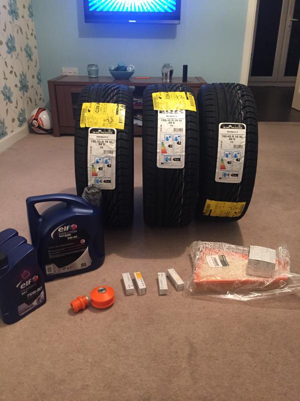

Bought a full service kit for the car, opted to go with changing the gearbox oil as the cars now on 93k and as theres no service interval, i thought why not.
I went for the URS3's tyre wise as i rate them highly! And at a decent price delivered from camskill i couldn't complain. The wheels are also being done on Tuesday by a company that seems reletively new but the reviews so far seem positive so i'll give them a bash!
