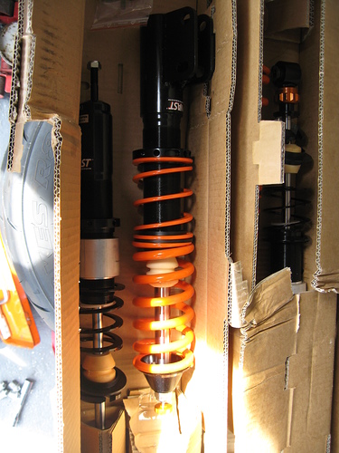

good lookwill be here tomorrow AM.
taken half day off work to get it fitted.

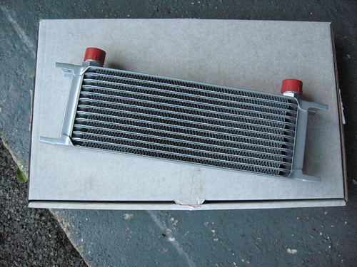

Right, havent updated in a while, not that i have done much!!
So....
Decided to mount the oil cooler, in prep for the engine to go in. Felt that mounting it to the front cross member would be best, as it allowed good airflow through the bumper, and was a solid beam to mount to.
I had to make up a small bracket to mount the right hand side of the cooler, as you cant get into the beam to tighten the bolts ( as i wanted it to be removable)
