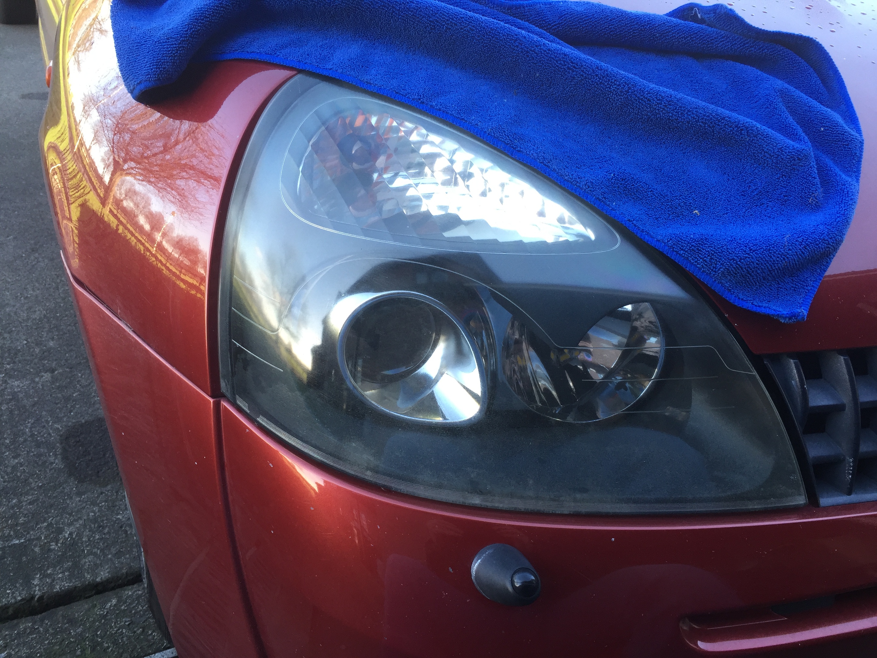

Had a spare hour, so cracked on with headlights.

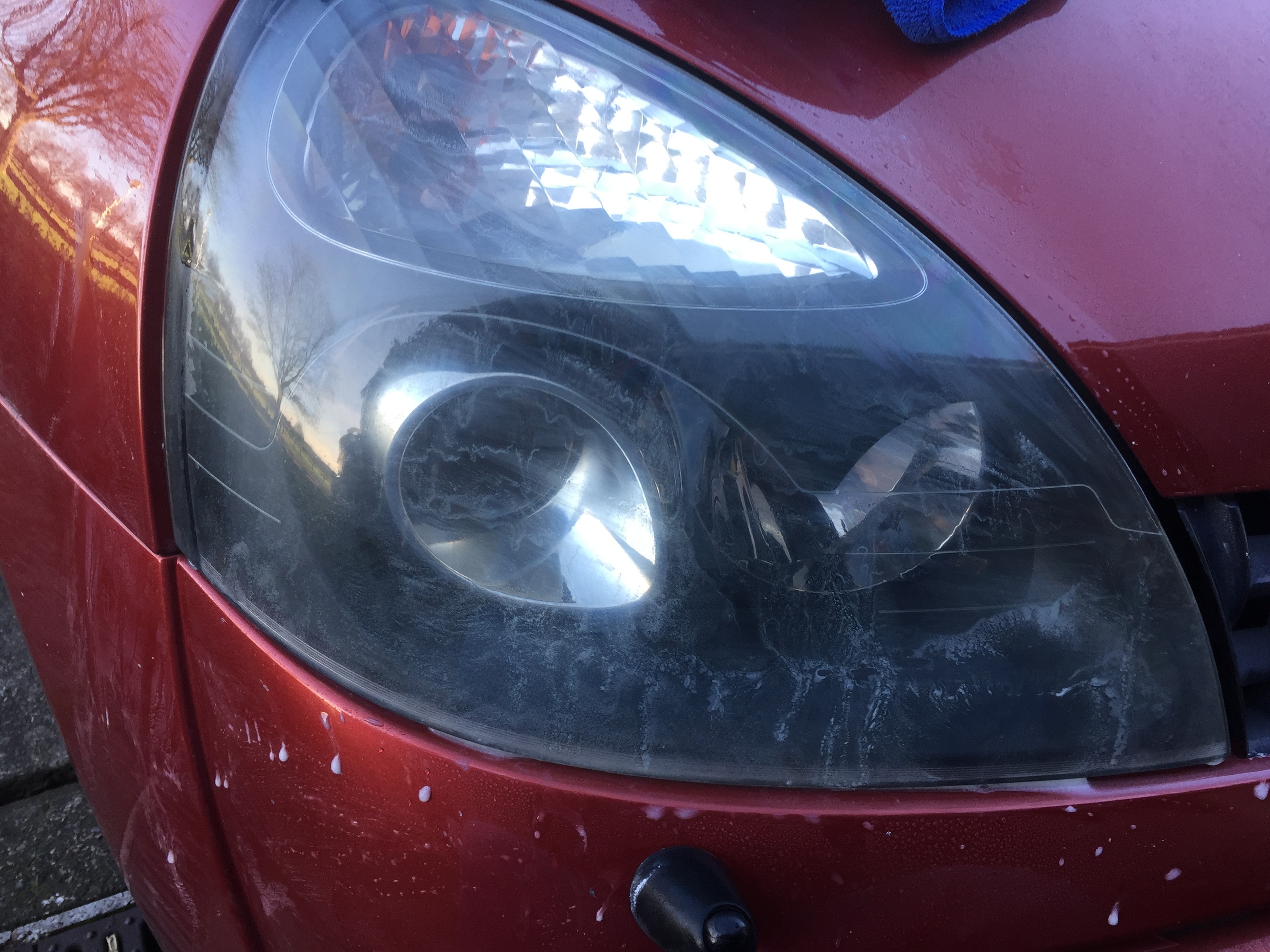

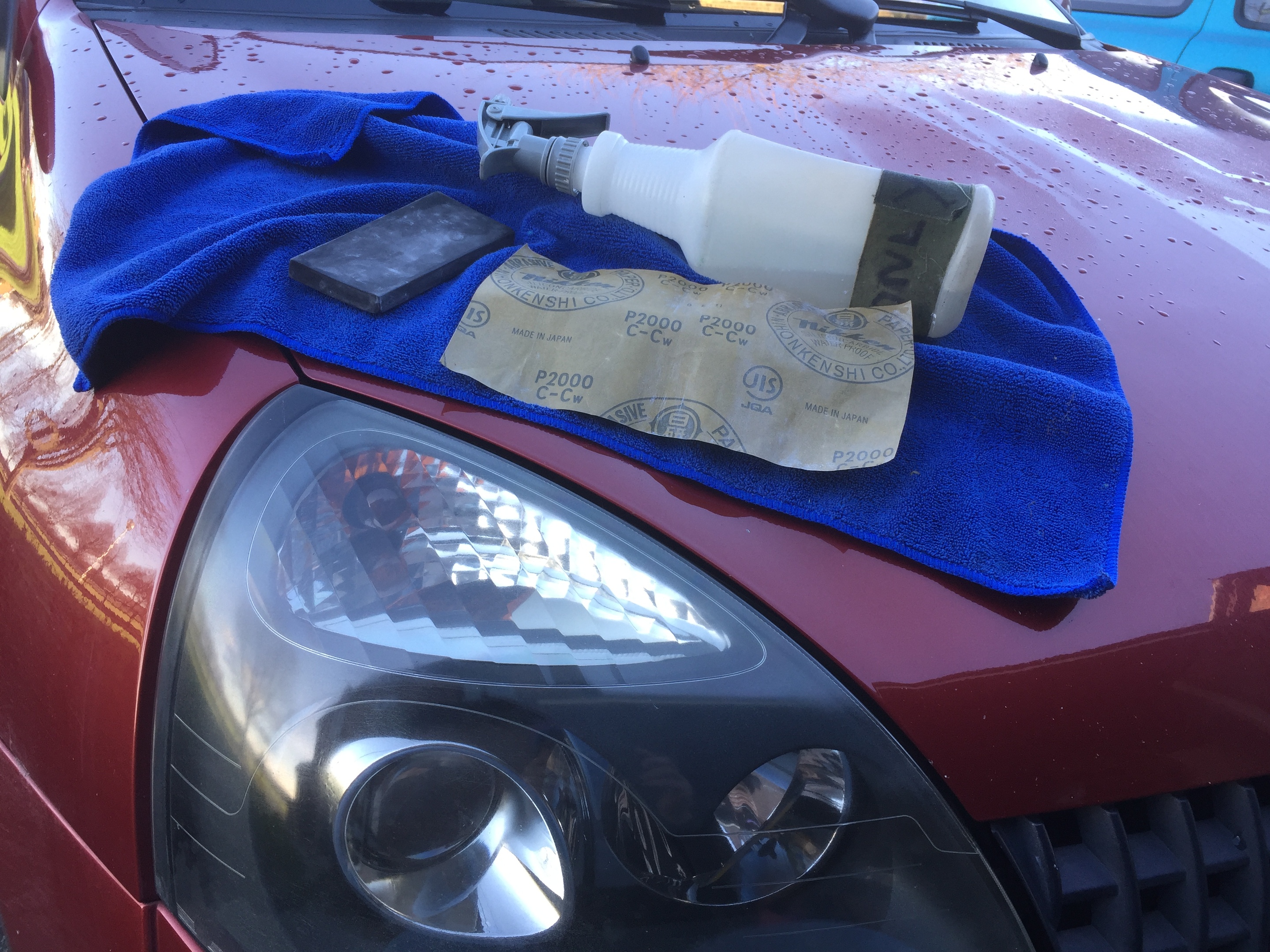

First sanded with 2000 grit. Just go for it! Have a good sandathon, then wipe clean with microfibre cloth.

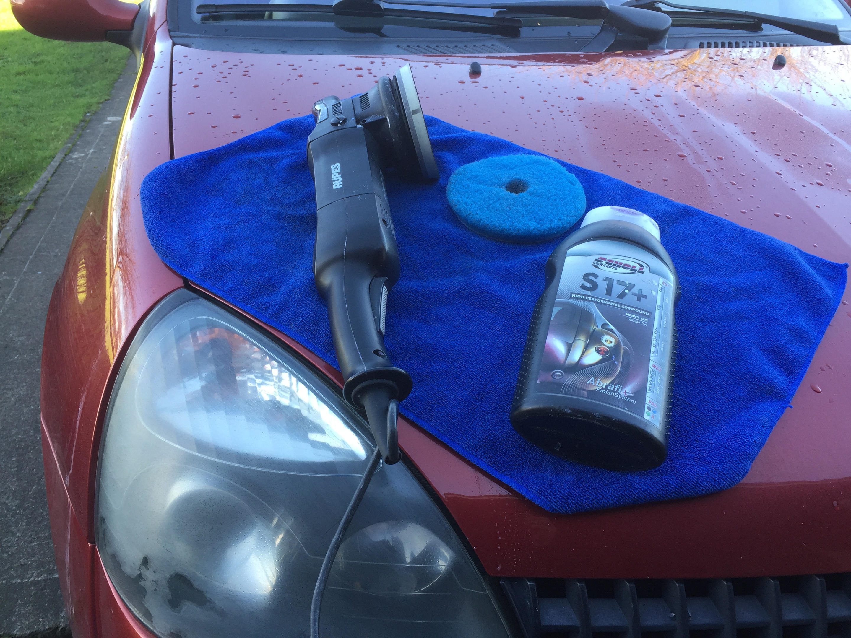

Then DA polisher with a good cutting compound and crack on, no needed to worry about paint heating up, headlights are plastic.

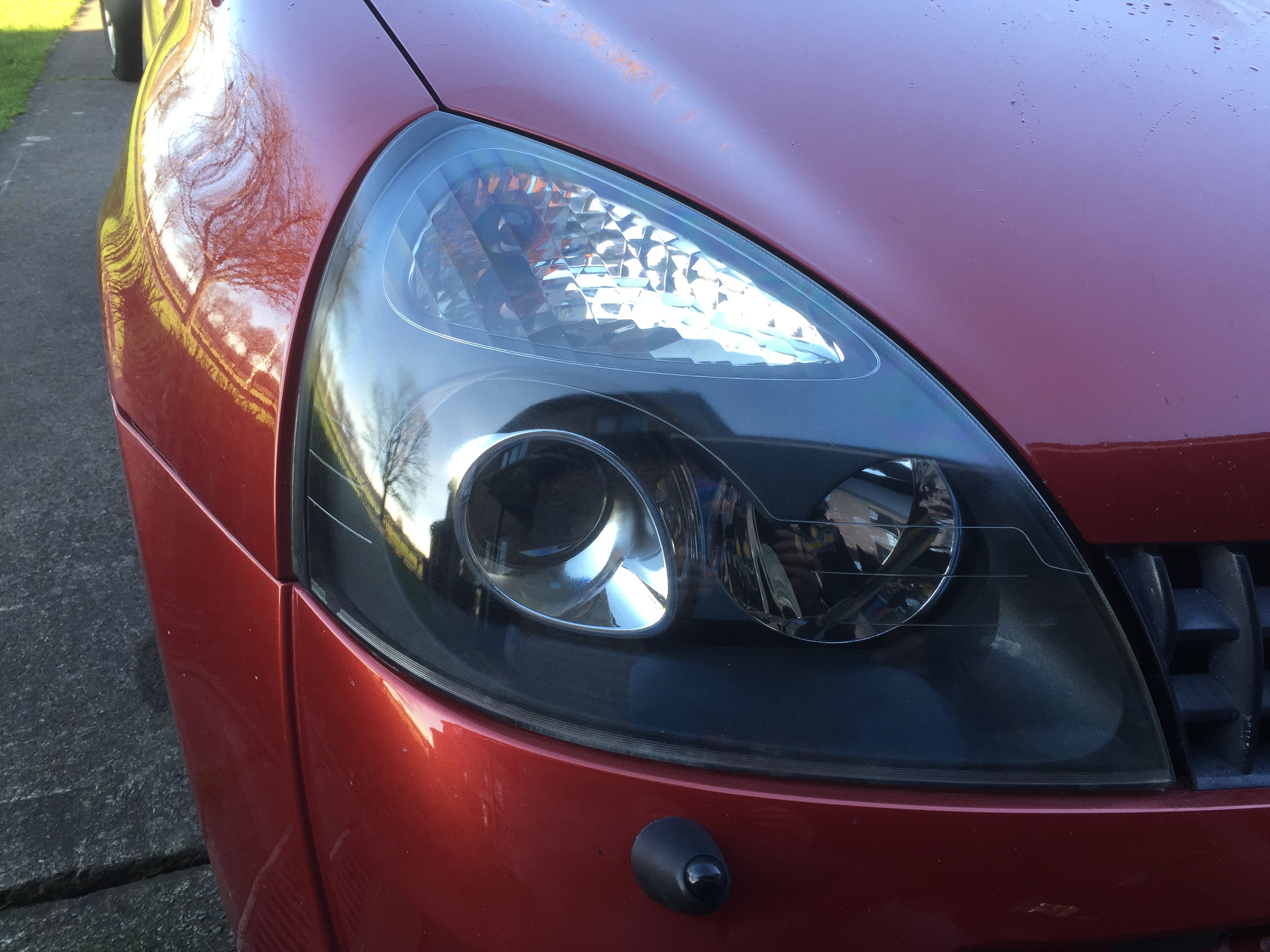

I'm happy with results.

Nice work..
