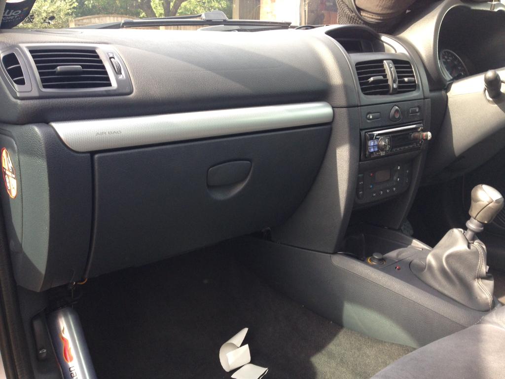

I already have a alpine cde-102ri with kce-400bt currently installed in the car

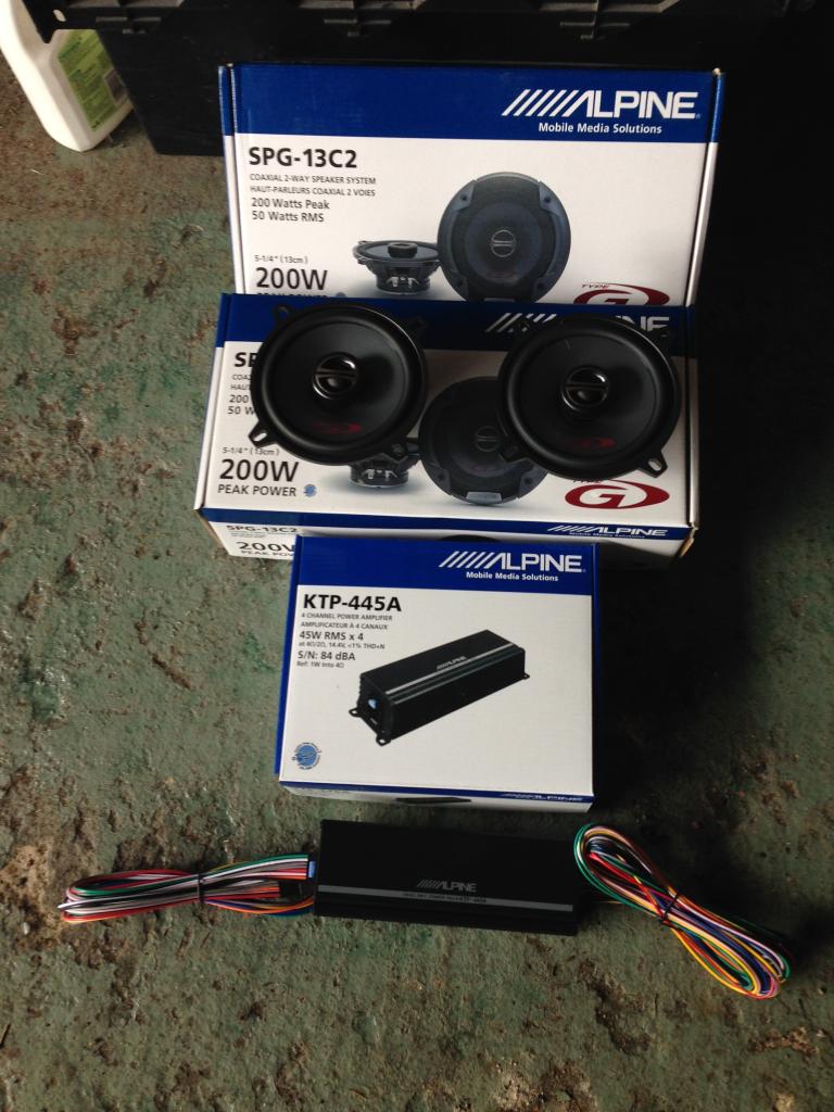

so I decided to match this up with:-
2x alpine spg-13c2 (200w peak and 50w rms) compared to the pioneer (180w peak and 35w rms)
full spec of both in links below
alpine http://www.caraudiodiscount.com/spg-13c2-200w-13cm-way-speakers-p-14393.html
pioneer http://www.caraudiodirect.co.uk/pioneer-ts-q131c-13cm-custom-fit-components
I also bought
1x alpine kpt-445a (4x 100w max and 45w rms)
link
http://www.caraudiodirect.co.uk/alpine-ktp-445a-power-pack
Before you ask, I didn't bother with components as my budget didn't allow expensive amps/excessive weight + this way I can retain the original tweeters too (a little less work)
so I actually bought these from my local http://www.caraudiocentre.co.uk/car-audio-centre-nottingham.htm and had them price match all of the above.
sadly nothing was in stock and the sales man told me he would have to get them from the warehouse, I wasn't happy as I wanted to fit it all today. he then told me the warehouse was 10mins away and he would fetch them now.:p
So off I went for a McDonald breakfast and before I'd even finished he called me to let me know they were there. winner!
So here's the kit

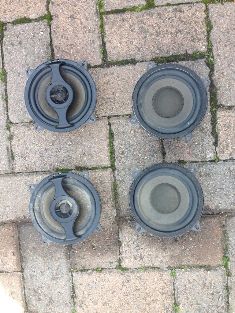

out with the old
If you dont already know its really easy, just pop of the covers with a flat head and remove the 4 torqx holding them in.

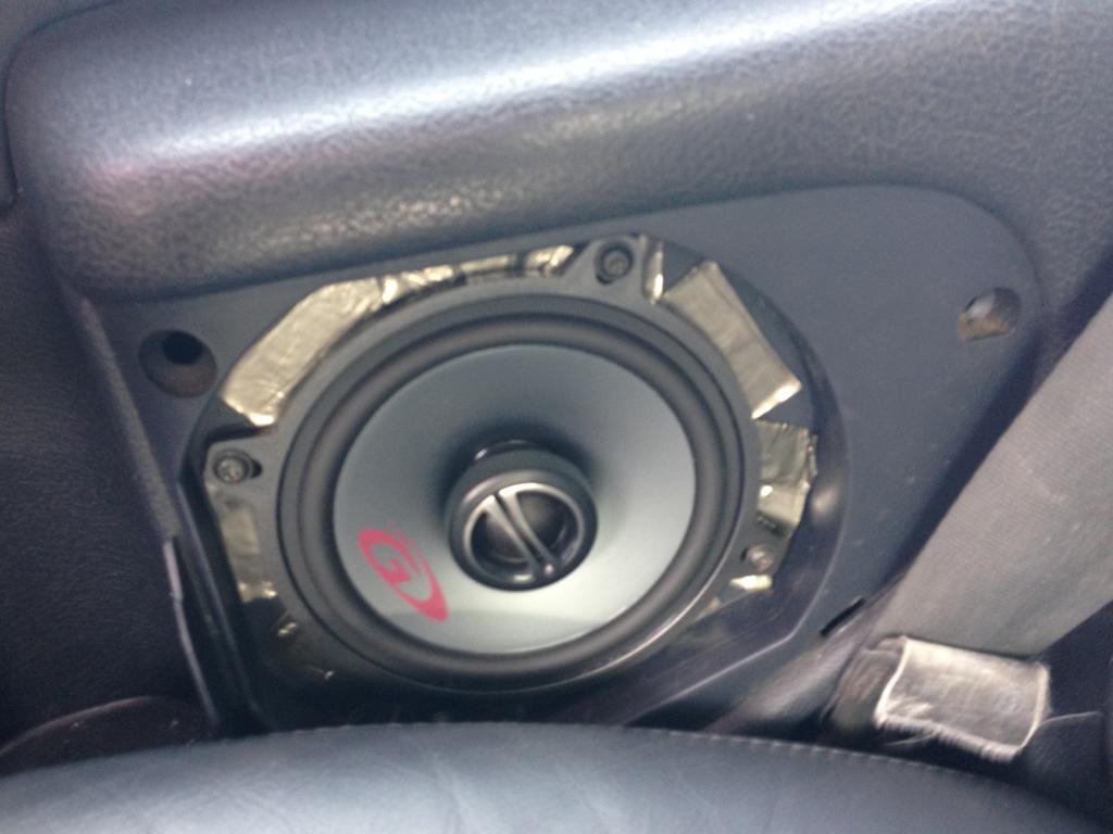

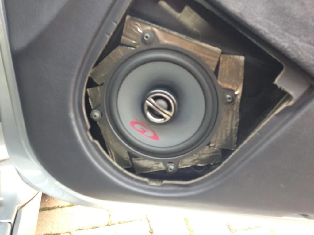

I then used some leftover bits of super-light dynamat, there's nothing worse than a farting speaker when you've got the volume up!
and here's the fitted pictures
wont let me add the 4th pic??
If you go with this setup I would always recommend fitting speakers before the amp to allow you to test them without putting to much power through them.
so at this stage i worked my way around the car at 25% volume to ensure I had the polarity's correct and that all were working correctly.

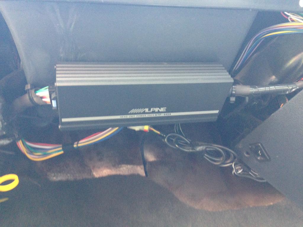

I then went ahead with removing my head-unit, unplugged the iso adaptor and fed the new cables to it (very simple just plug and play)

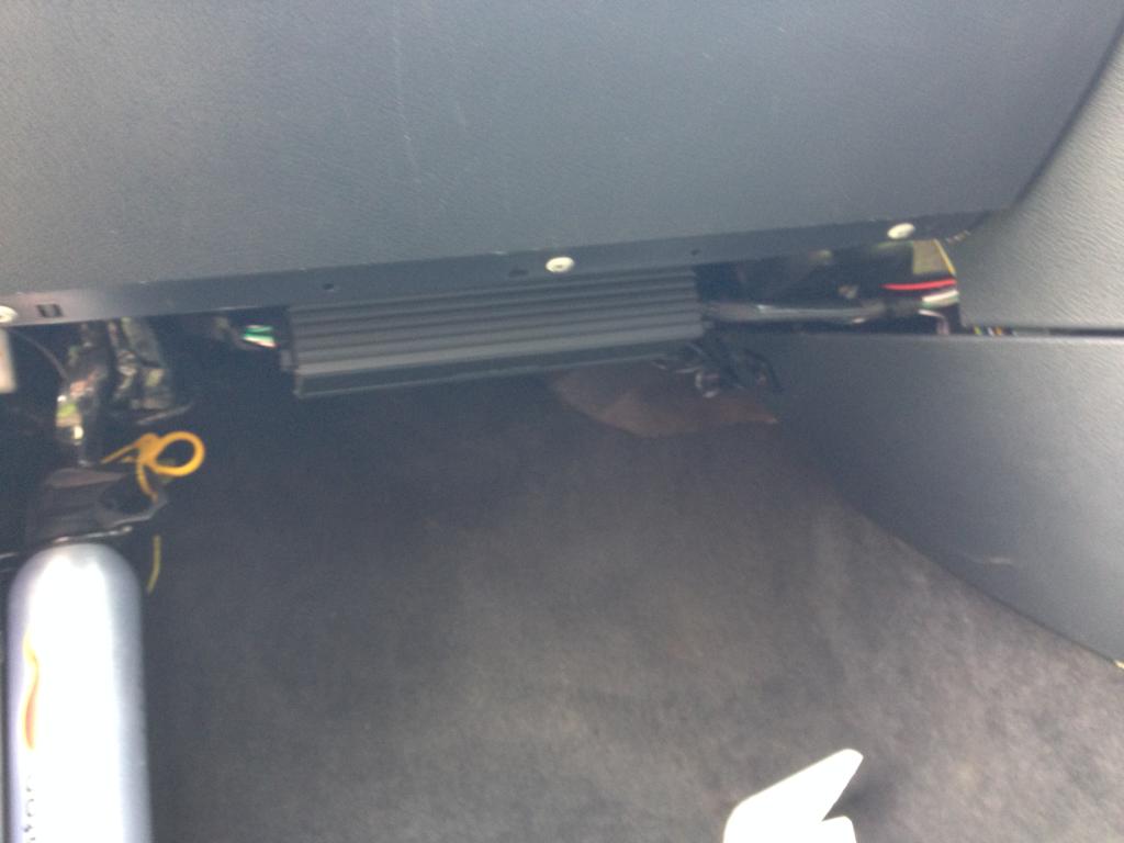

I had decided that the best place for the amp itself was going to be under the glove box (due to cable length and space) however there wasn't enough room to use the supplied bracket to mount it so out comes the Velcro.
I used some heat-shrink over the cables that connect to the amp in a attempt to get rid of the rainbow effect. minor fail the heat-shrink I had available was to thin and wouldn't go over the plug so I sliced it open and used cable ties to hold them in place.
so all in all this install probably took me about an hour, yes you read right 1 hour. This is a record for me! whoopwhoop. granted it wasn't the most demanding of tasks but all my prior installs took around 2 days pmsl. (several amps capacitors etc)
