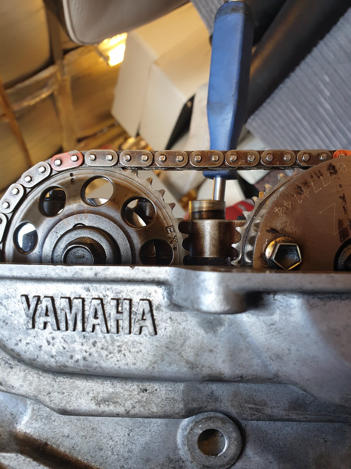

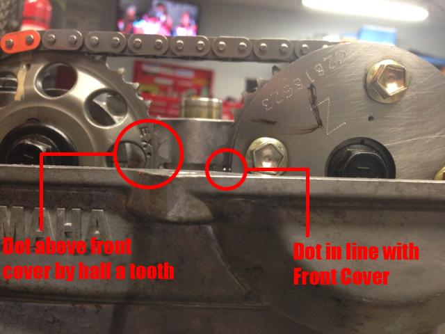

Here is a picture of how it should be:
Here is how I set mine:
Now I've blown the pictures up and looked at them side by side maybe the exhaust cam is slightly off, more like 3/4 of a tooth instead of 1/2 a tooth. It could just be the camera angle though.

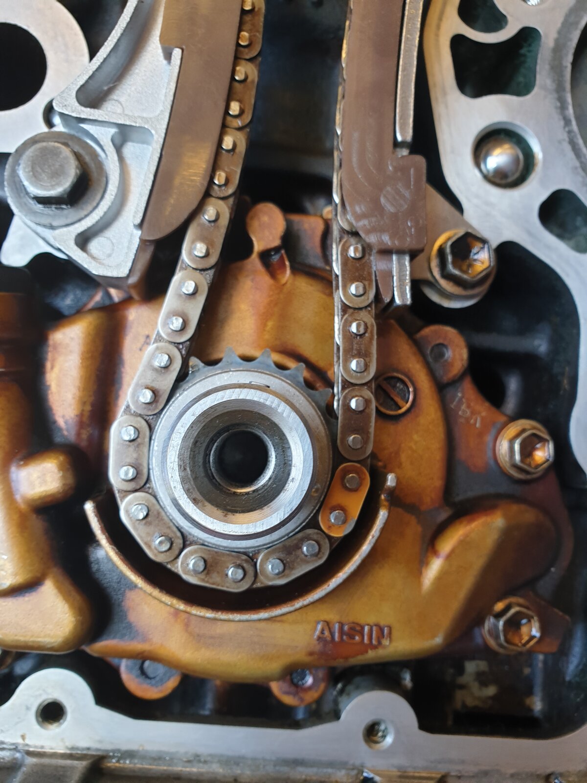

Not sure if 1/4 of a tooth out on the exhaust cam would slightly reduce lift (VTEC) though? If so it means I would need to move the exhaust cam down 1 tooth on the chain but with this the chain/cam marks wouldn't then line up with each other. Could it be a slightly stretched chain maybe? I used the 80k mile chain from the blown engine as the new one I purchased didn't have the correct timing marks so didn't use it.
Or could it just be souly down to the age, mileage and condition of the engine in particular the valves, valves seats, springs etc?

Is there a stretch gauge for the chain you can get for these?
Yes mate, Chain needs to be off the car though. I checked this chain with the new chain I'd bought and they where the same length. Saying that if manufacture of the new chain couldn't get the timing links in the right place there's no saying the chain was the correct length.
What you thinking, the chain has stretched by 1/4 of a tooth?

Possibly mate.
Hard to tell with the pic as it could be the angle like you say.

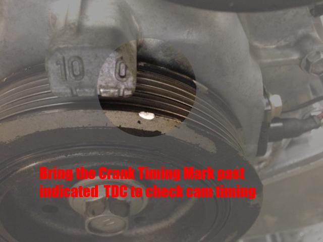

Are you doing this too as it says here?
Not sure why you have to bring it past TDC to check, but must be a reason...
