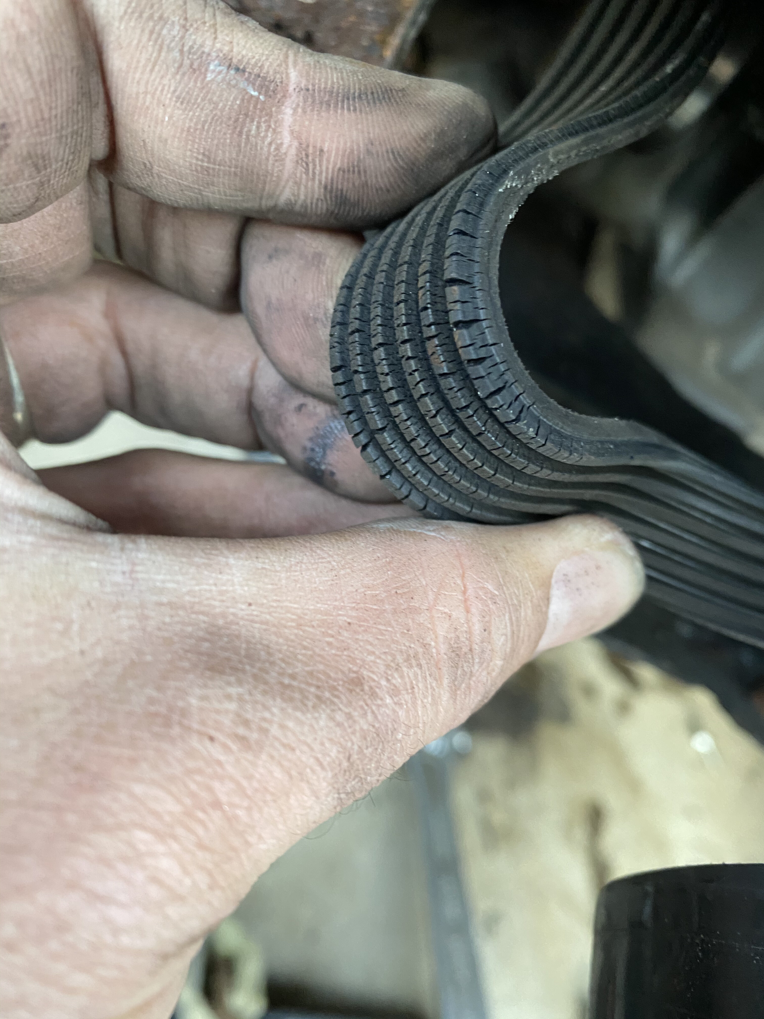

yeah, got no intention of selling any time soon so no problems there. On advice above I had the aux belt off today and that’s a totally different story....

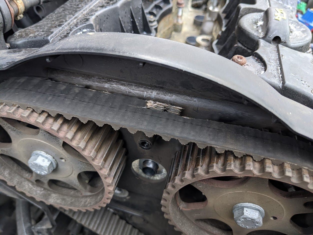

Jumped 2 teeth but didn't hurt anything (so dodged the scrap man for another day). I would be fine with 5-8 years on the 182 timing belt as long as the aux was done as per book (which they reduced from 5 years to 3 due to failures), however 8-10 years would be giving me the willies.

yeah the aux is minging but timing looks ok. No easily identifiable cracks.
