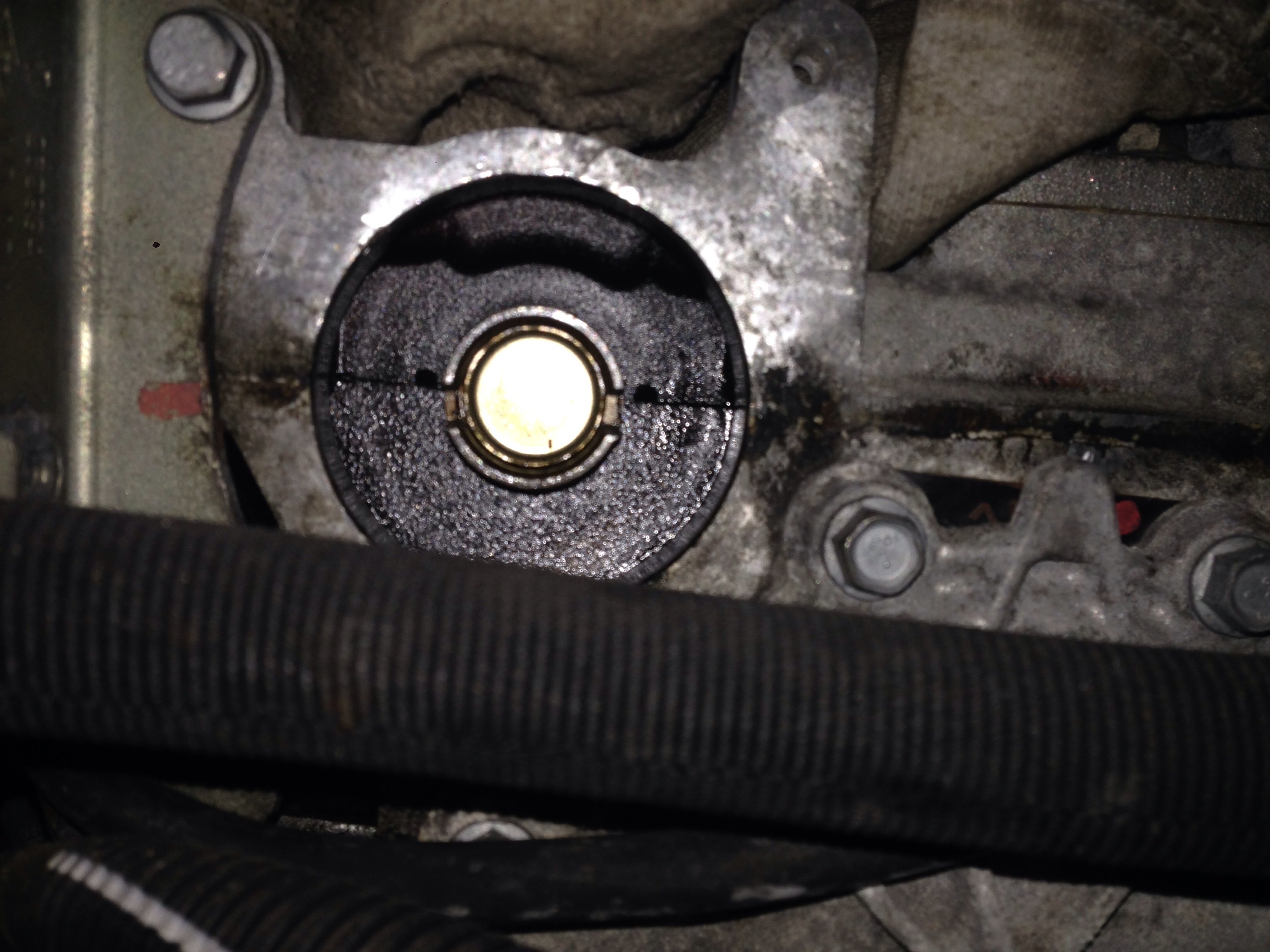

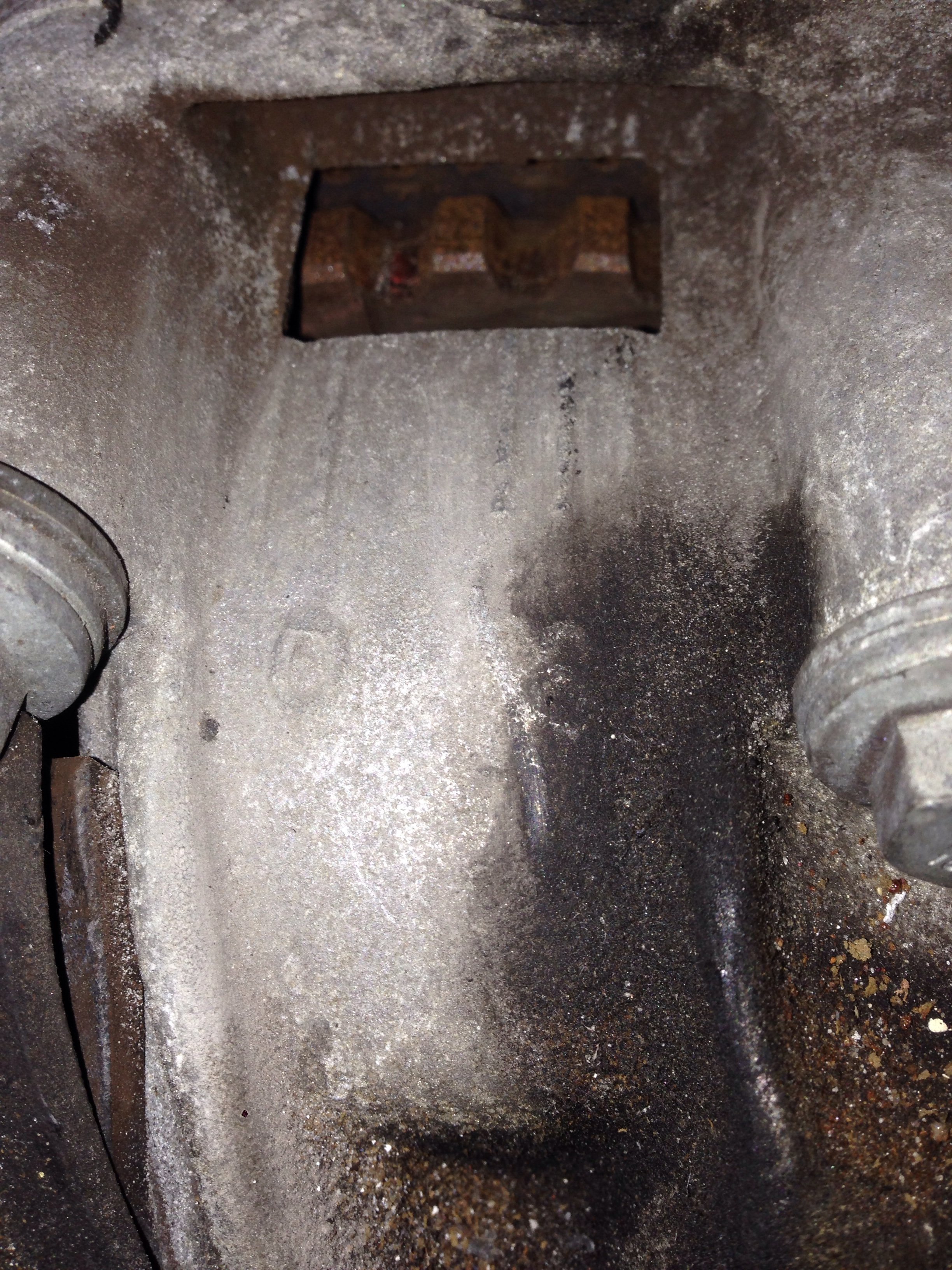

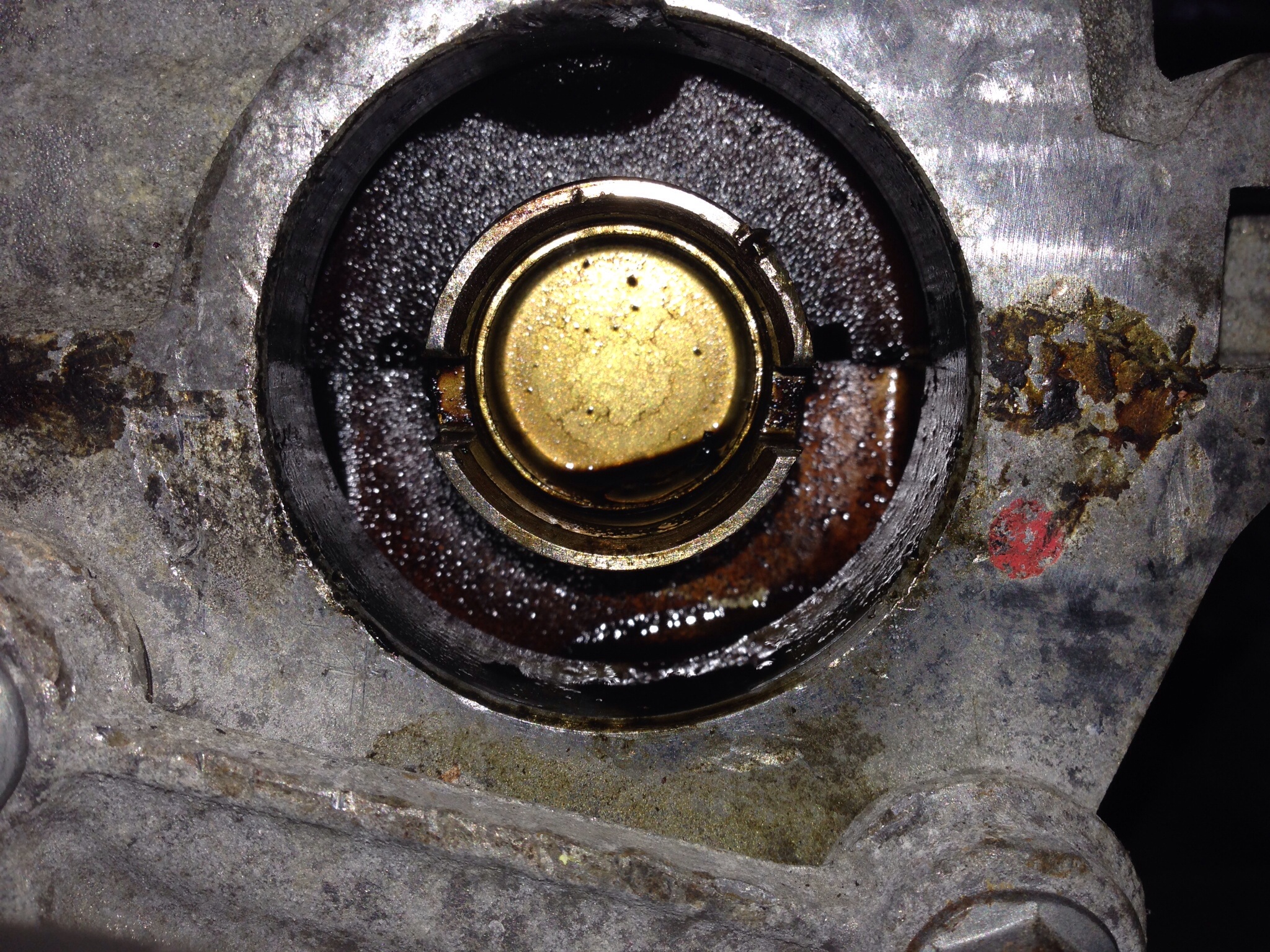

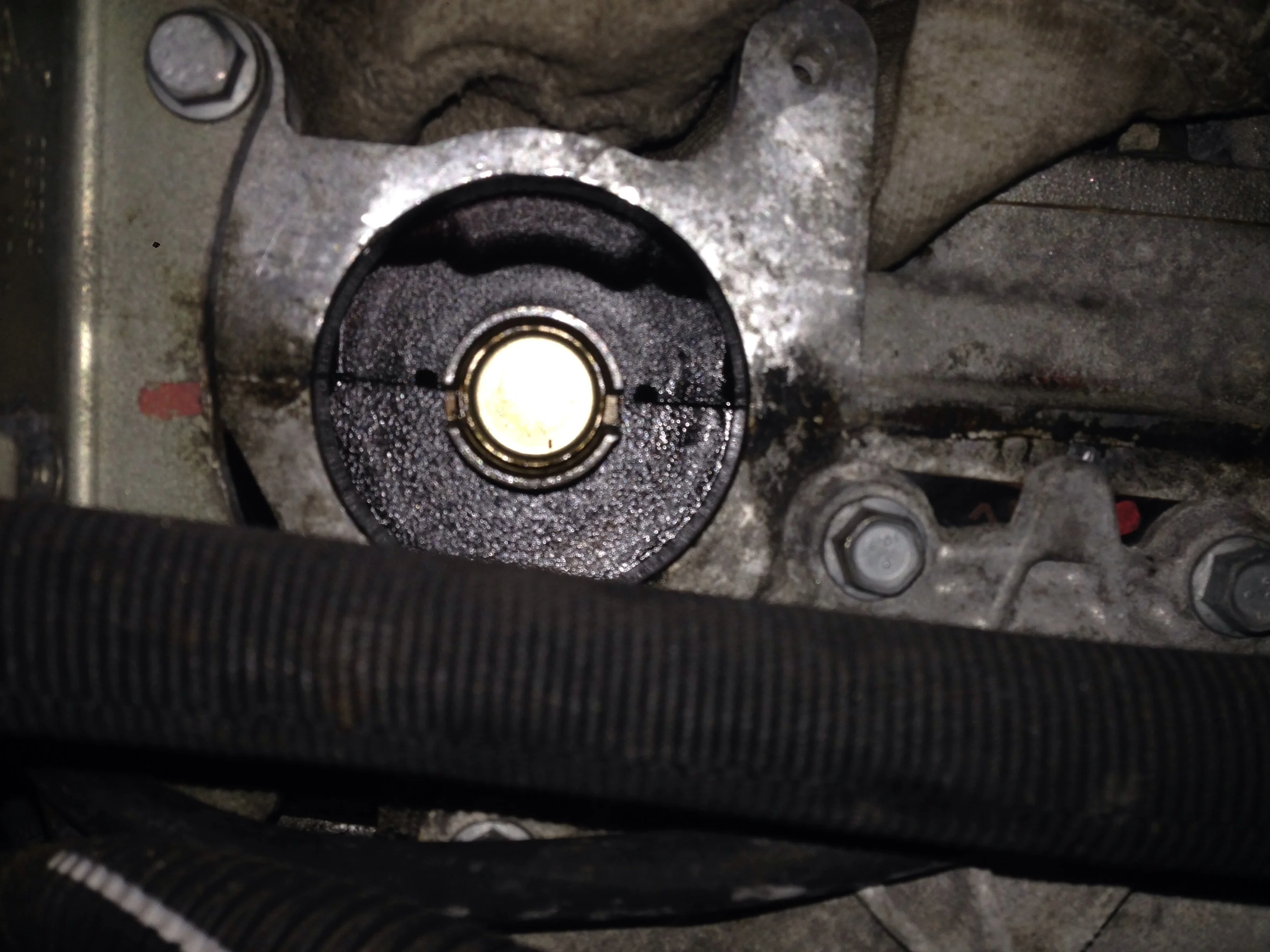

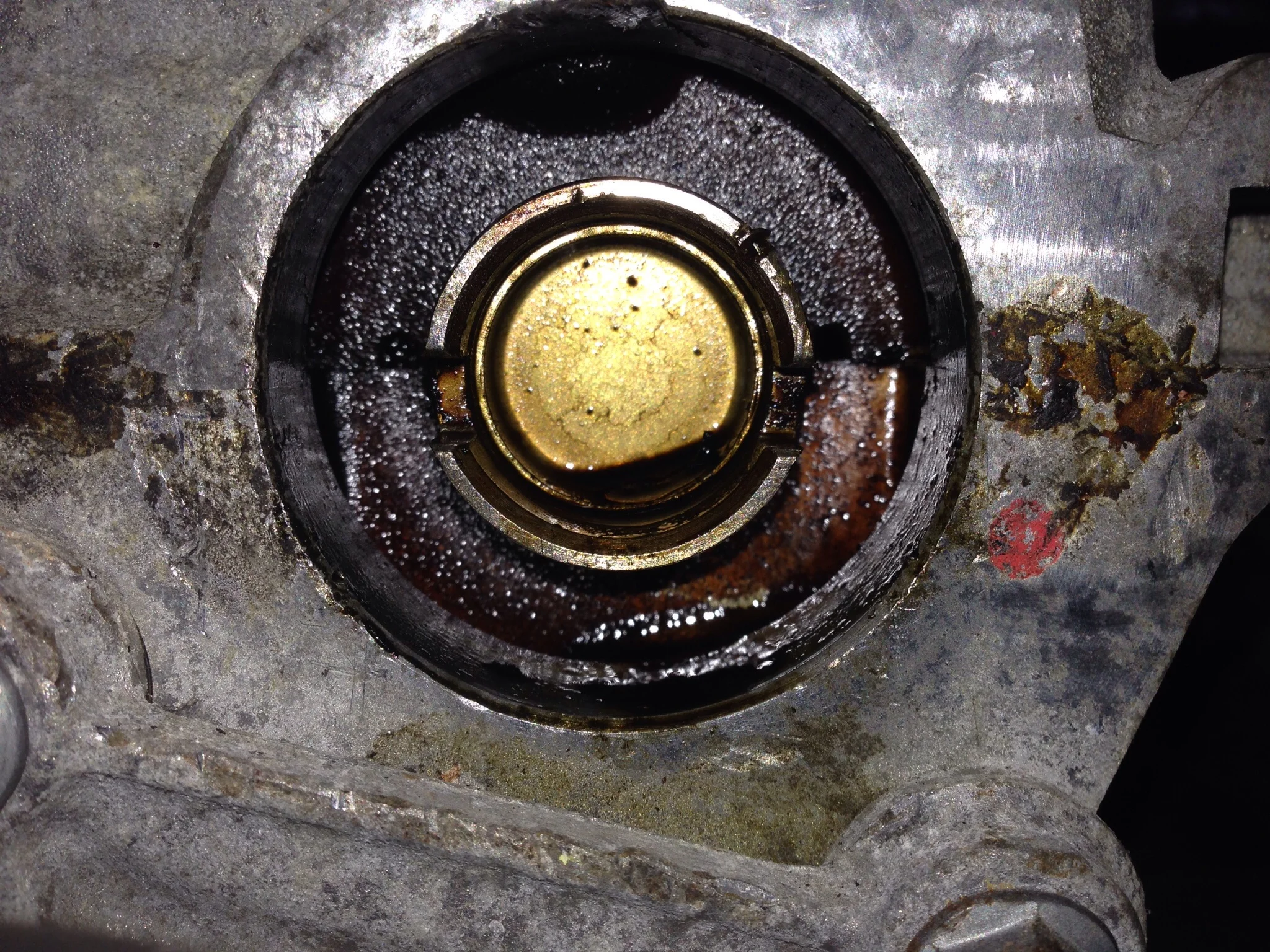

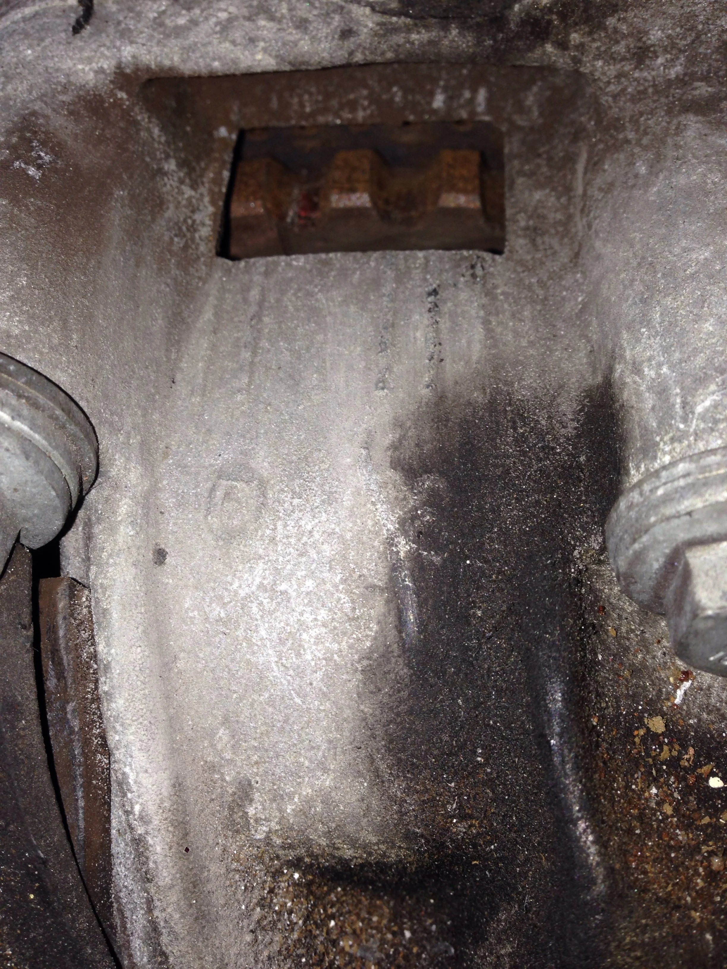

Hi all having issue with my timing am using proper renault tools, all the timing marks are line up inc the crank which is at the 1pm position, crank pin is fitted all the way in, ran a compression test she was showing 175 psi on all 4 cylinders any ideas??

Have you got the horseshoe that slots in the end of the cams?
Talk us through what you've done so far
  Clio 182 V6 Omega
Yes I have the horse shoe, that's fits in without any struggle, all belts and dephaser replaced, belts were rotated forward backwards before they were tension up etc, I read what I could find about timing on here but still cocked it up !!!! Thanks 4 the reply

So what's the problem mate? I might be being thick but I'm not sure what issues you're having? If it all times up ok, and the horseshoe slots back in no problem then you're all good?

Pics was to show the cam are lined up Yes locking pin was in place while takin them pics, I've just checked flywheel and that's at TDC too has the engine gone fubarred ??

If the pulleys are all tight and the marks like up you can't have gone too far wrong.
I would you had damaged valves you would get less than 175psi, and the cylinders would likely give uneven readings.
