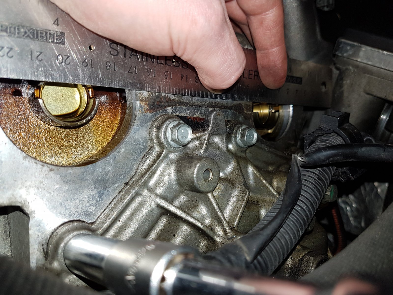

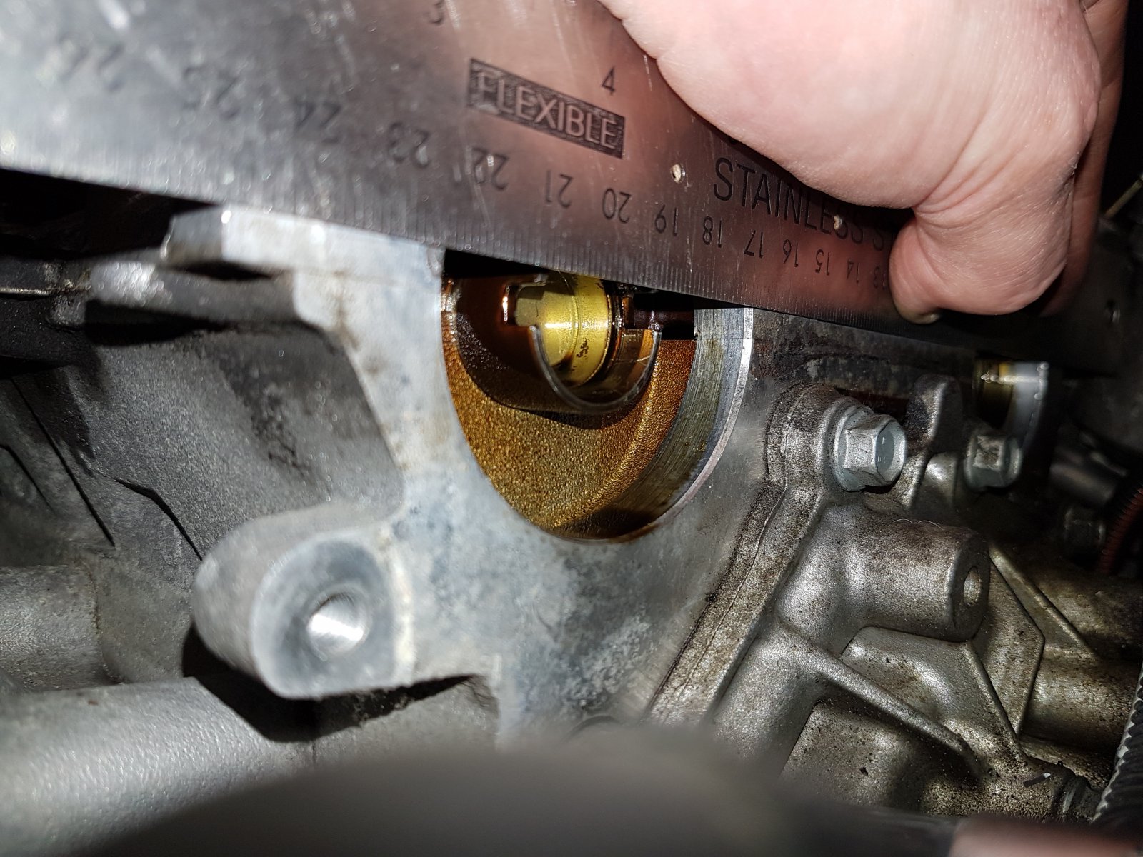

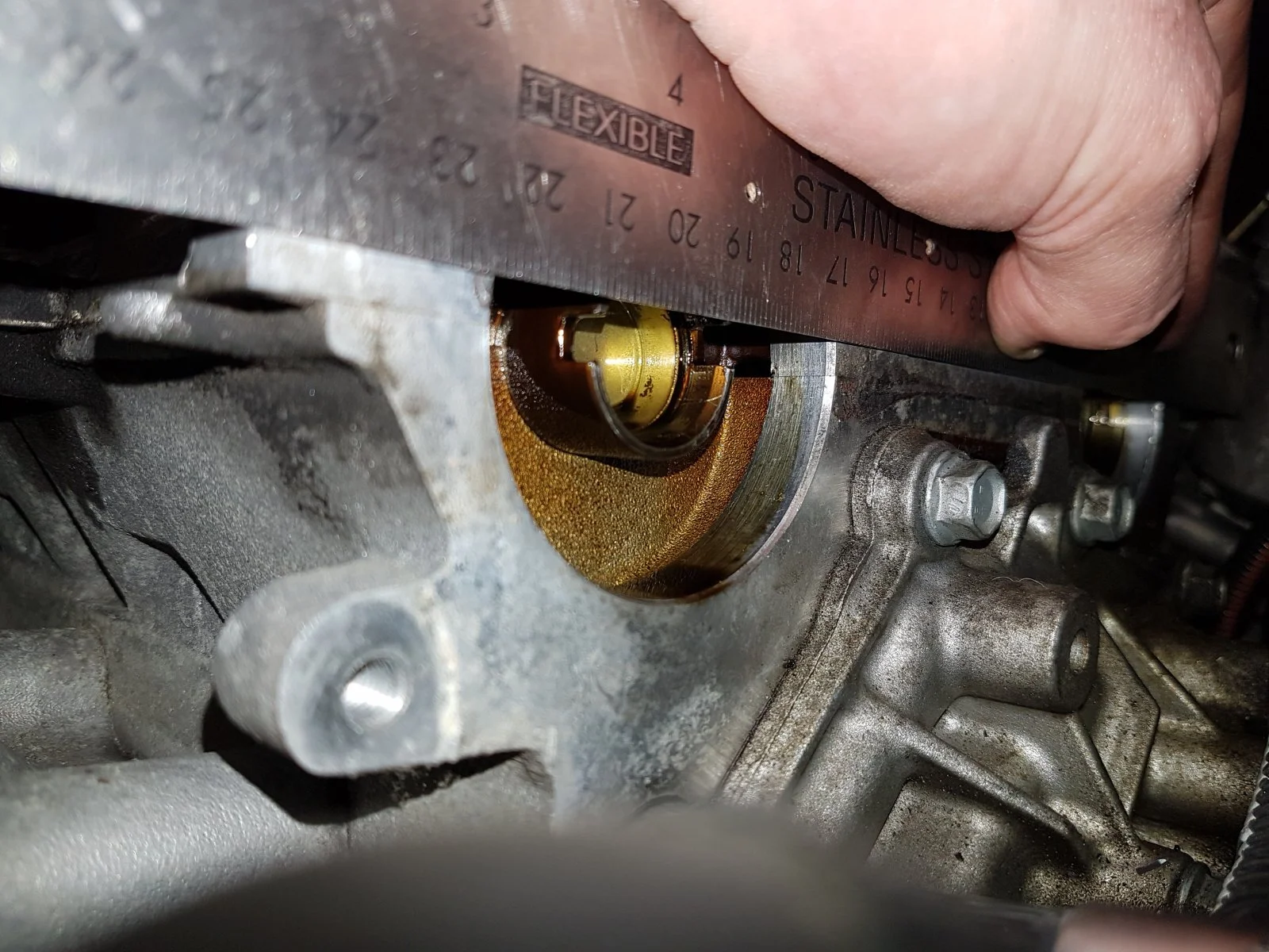

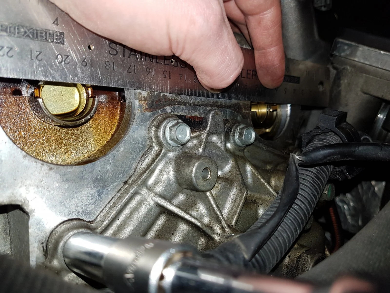

But I now have an idle that I would say is quite a bit lumpier, hard to describe. Still idles at around 1k RPM (Henk map) but its almost like how a drag racer engine idles, blurt...blurt....blurt....blurt. Fella advised that the timing was indeed out (from Renault :/) but, maybe this is just in my head....but I thought it was smoother before.....almost sure of that......anyway. I pulled the caps tonight and stripped down a bit to check.
I locked the crank with an allen key making sure it was in the locking hole rather than the gimpy recess on the crank.
Bear in mind, I dont have the locking tools, just my eye and a ruler.......buuuuuut, I think (and I hope I am wrong) that the timing is out on the inlet cam. I will be really disappointed if so as I was really hoping this was my super-duper-go-to-garage. Looking at it for ages......I just dont see how a cam lock tool would slide into this easily?
Would appreciate it if you could share your thoughts?

They are notoriously lumpy mind you. Could be leads or something like that if the timing isn't out

seen a lot worse than that but probably ok with the correct tools , cant see that making it run that bad would check other things to be safe.
No ones perfect and if that was me I would rectify free of charge, and I would strip and check first off without expecting customer to do it.
