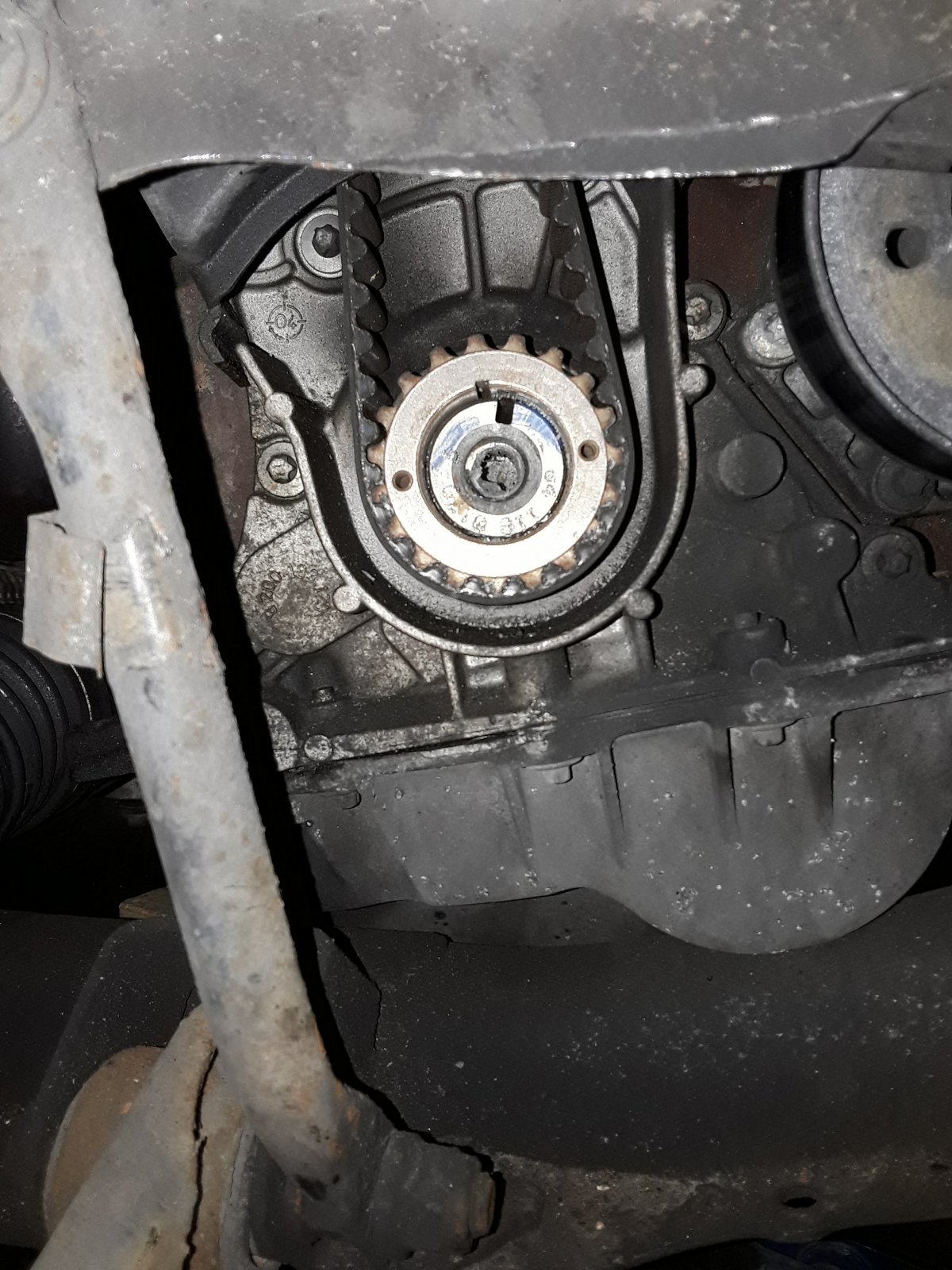

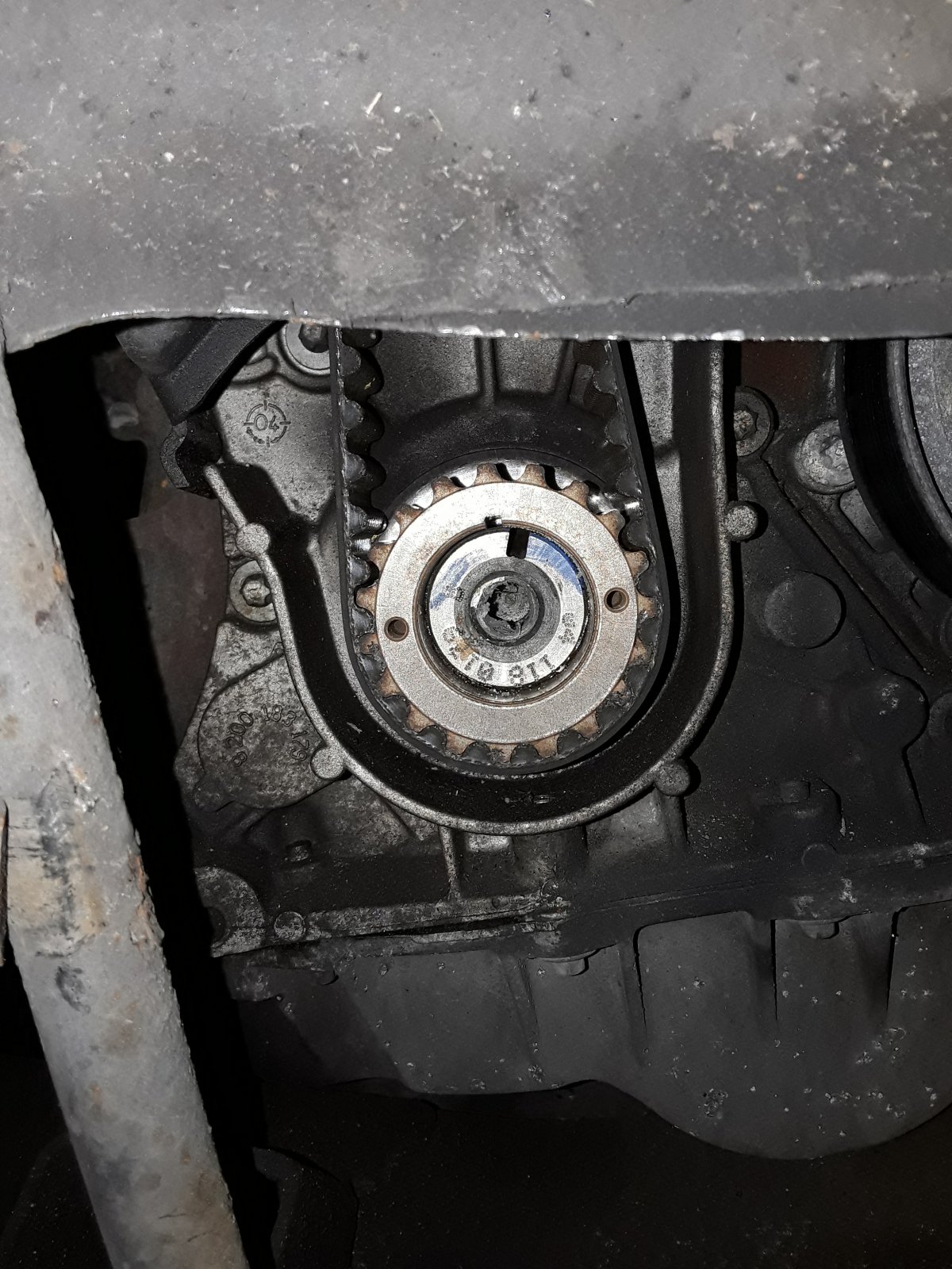

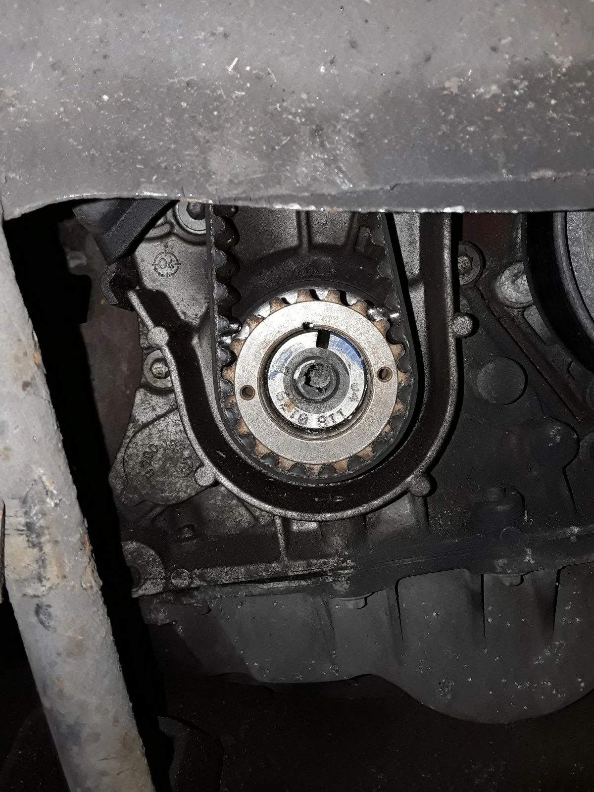

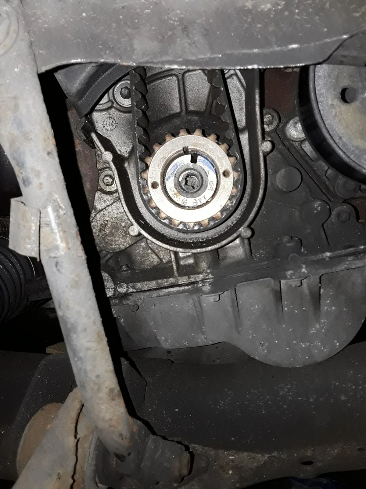

So i took the crank pully off to find this. Should there be a woodruff key here?
Yes mate the crank is locked at 0 but the cams are not, the belts still on atm, does it look right or is it out? Still trying to diagnose my tapping. The cams dont line up with the tool when the cranks locked through the hole in the block
if the crank is locked then it's ok but it's cam timing that's out. you 100% that crank is at 0 and locked in the right hole?
I would double check you're in the right hole there and not the balancing hole. The groove in the crankshaft should be at the midpoint between those two ribs above it in the right of the pictures.
Just noticed this, now that the crank pulley is off it it's likely the cams have moved.
