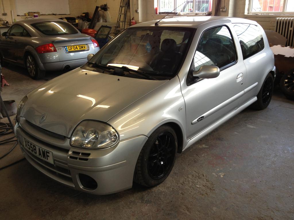

Thanks Craig, I had the paint done at An Illusion bodyshop on the Mandale triangle. Just needs Belts doing, a service and a few other bits and I should have it back on the road hopefully.
Thanks, its looking a lot better than when I first bought it, still quite a bit more to go though.

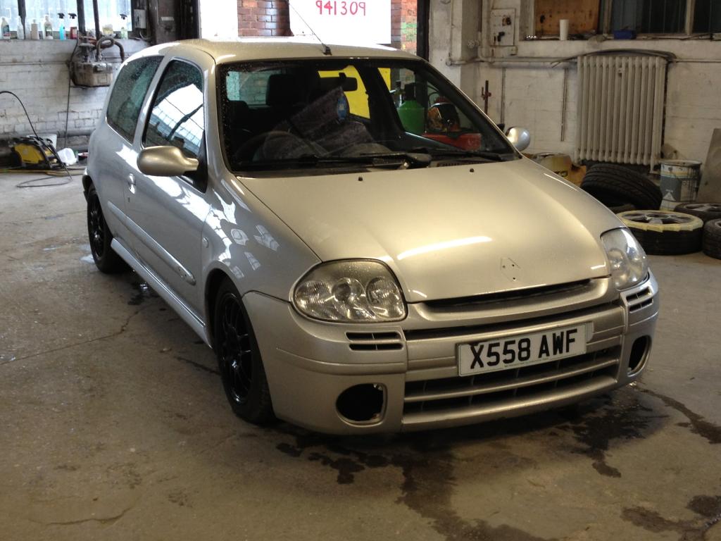

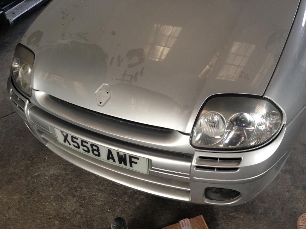

I had a go at restoring the headlights as they had begun to haze. They came up really well and look much better than they did previously. Could do with a bit more polish but its coming along.

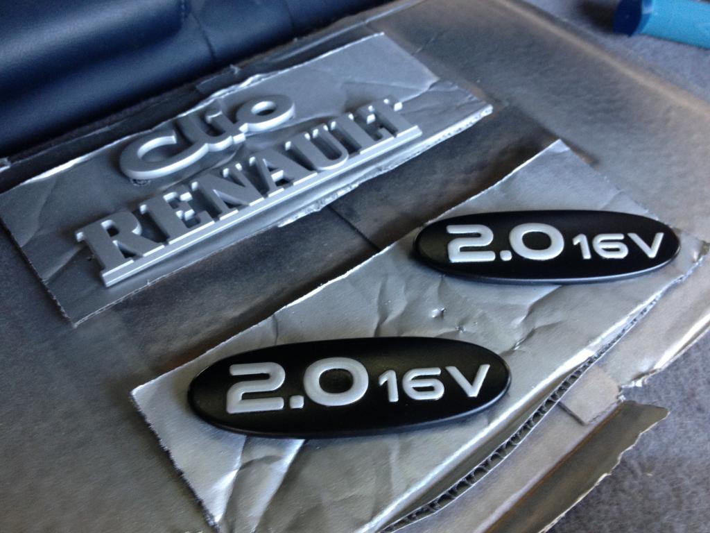

I also gave the badges a bit of paint just to refresh them as they had faded a little.

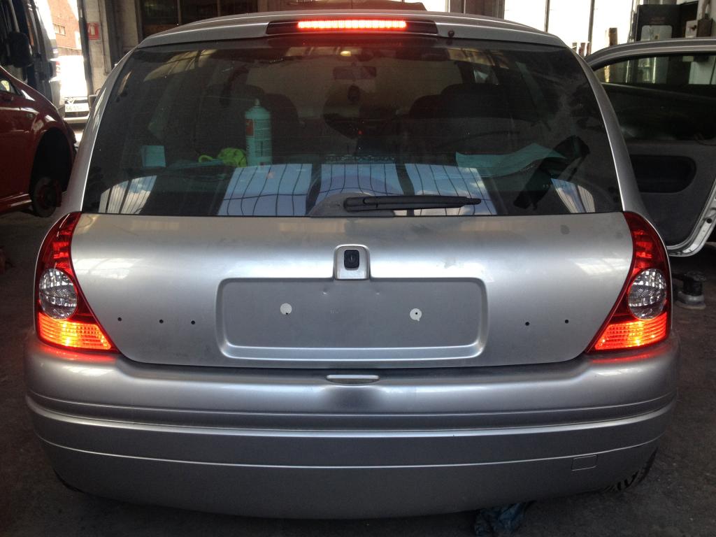

Managed to re-wire the rear lights today as they hadn't been working properly, mainly being the drivers side rear brake light. I also found that I have two different coloured front lights as one is a lighter shade of blue so will be looking to change to a matching set.

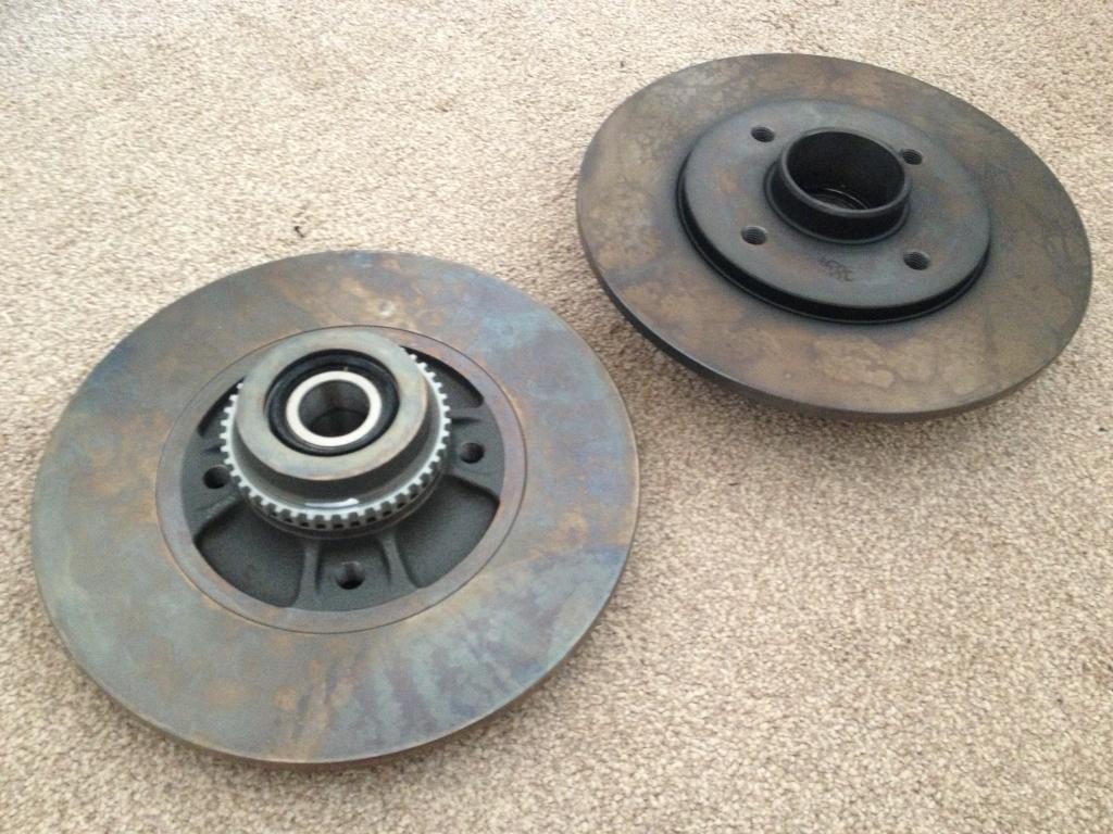

Some new genuine rear brake discs arrived from Renault Wolverhampton to replace the old ones. Also had a new oil filter arrive and a few other little bits. :approve:

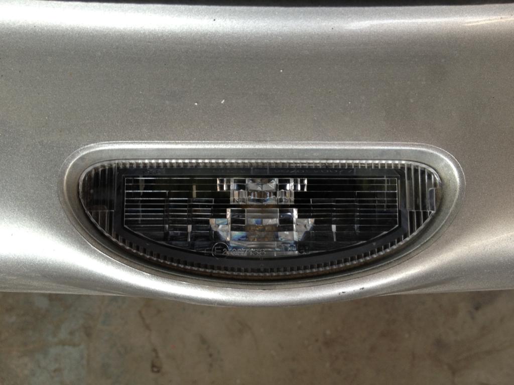

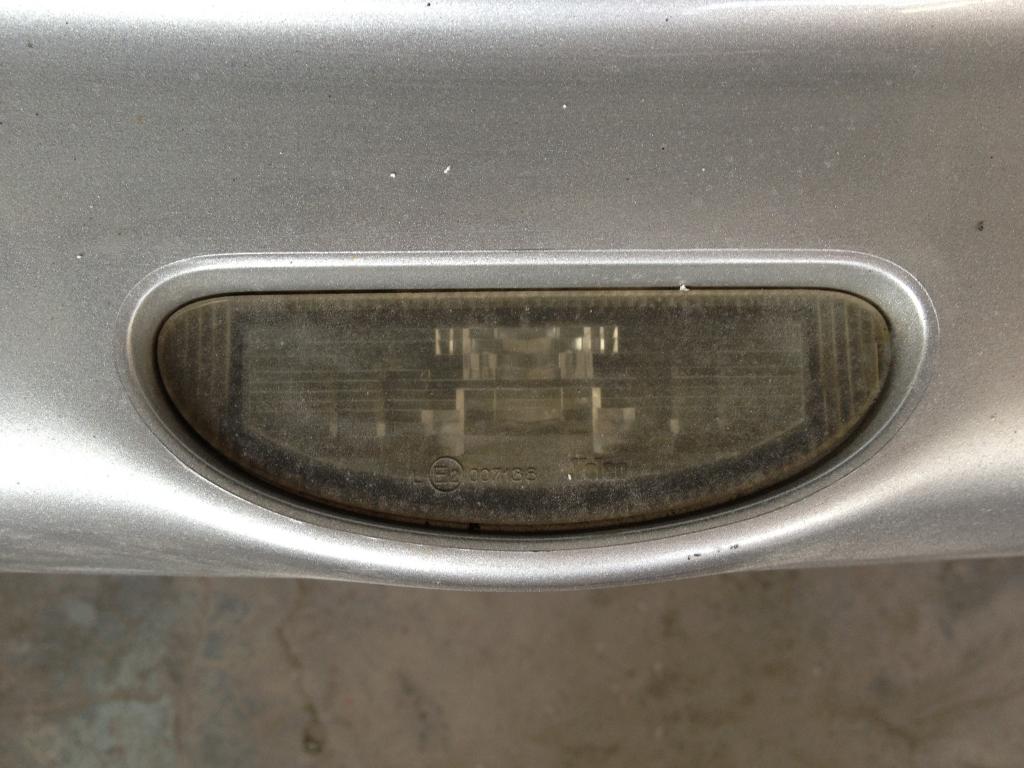

Not much of an update but the rear number plate light and indicators had seen better days so they have been replaced for new ones.
Old
New

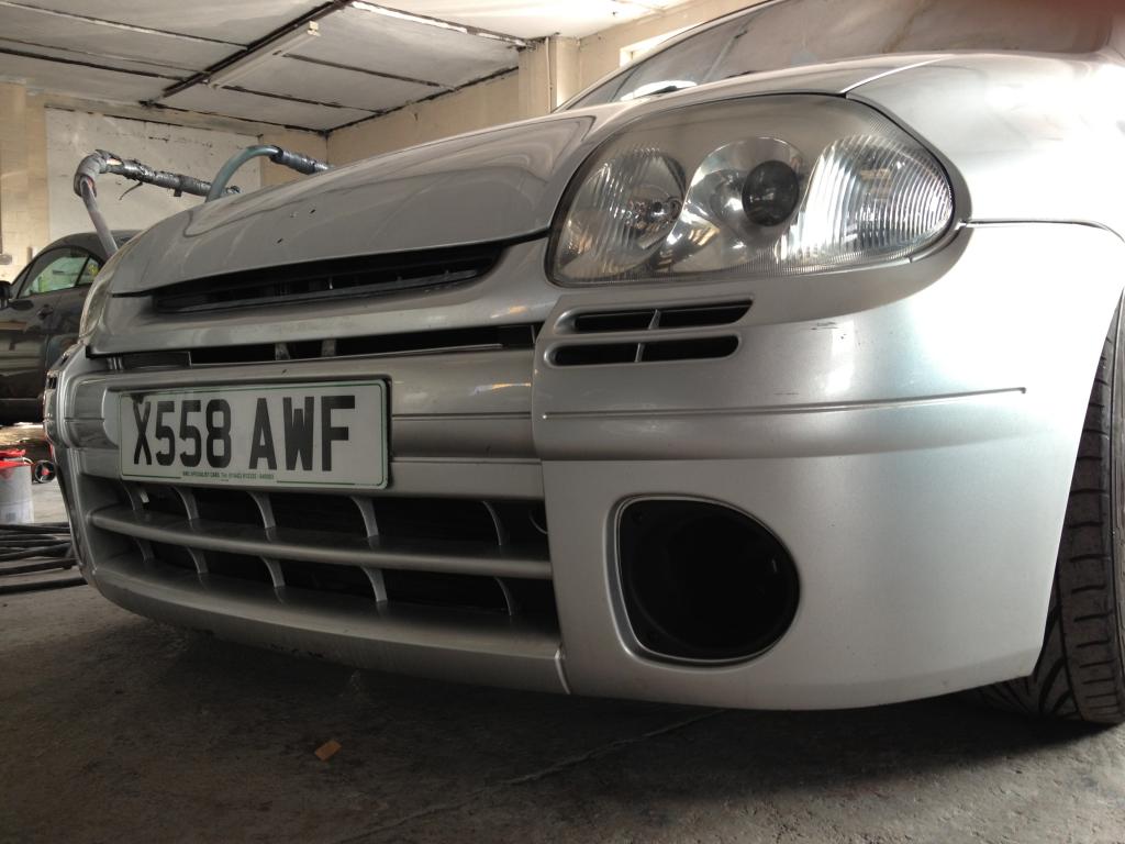

Has it got HIDs fitted then?
Thanks very much.
To be honest im really not sure. Its the inside bulb on both sides and they seem to be a small cluster bulb. One side is like a turquoise colour and the other a darker blue.

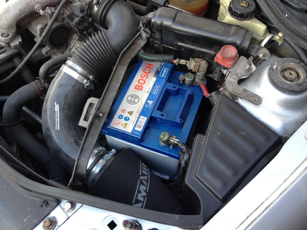

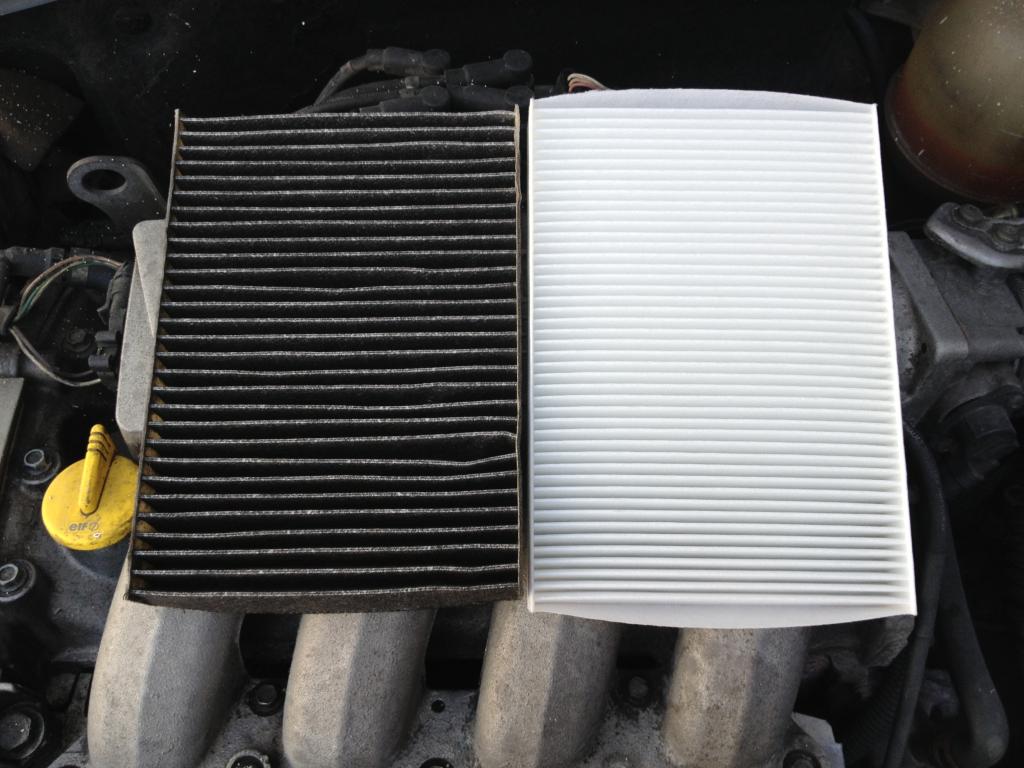

I managed to get a couple of small jobs done this morning and im hoping to have it back on the road soon. My battery kept going flat so I've changed it for a new Bosch one which im hoping sorts the problem and that it isn't anything more serious. I also replaced the cabin filter at the same time and gave the car a quick rinse as it had gained a layer of dust. Im really pleased with how it looks so far but still have quite a bit to go yet.

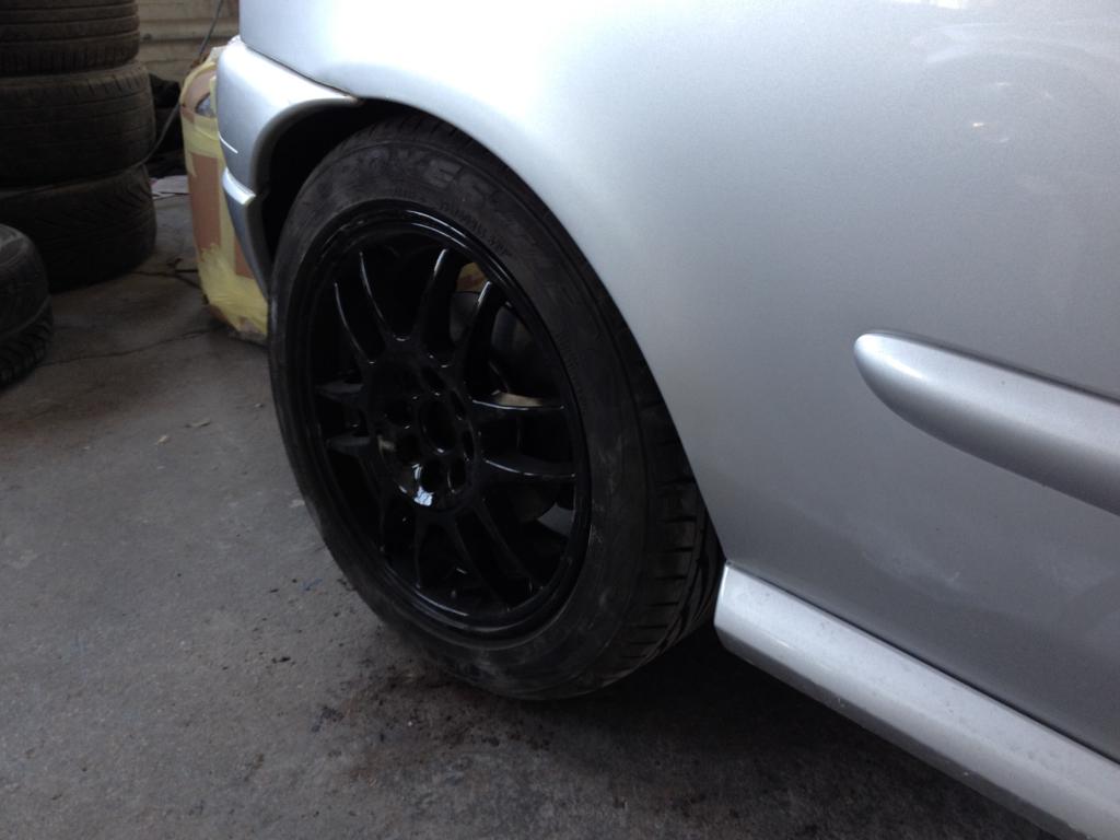

I think im going to get some spacers as the alloys look a bit far inside the arches. I still need to fit the rear brake discs, have the belts changed and service it. The interior could do with a bit of work too but its making progress.
Good work so far mate, id be getting that + side of the battery covered just in case it touches the ecu cover. I bought a new one from Renault it was about £10 or try and get a S/H one off of here.
Also if your going to fit spacers to the rear then its better to do while your discs are off as they have to be removed to fit them. :)
Thanks mate :approve: If im honest I didn't know it needed a cover but I'll get hold of one, thanks for the heads up. Yeah still have the rear discs to fit, there currently sat in the passenger footwell. Think im going to get some spacers for it shortly, was thinking of 5mm for the rear and either 10-15mm for the front.

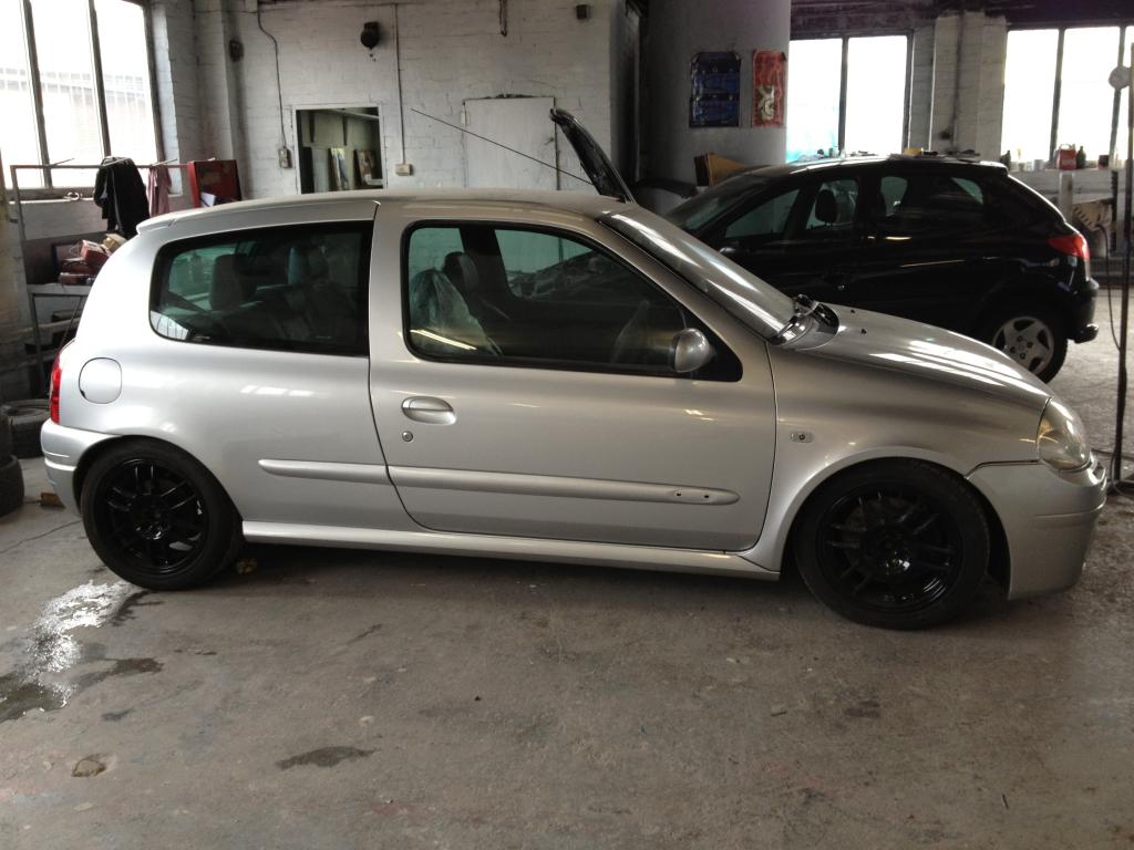

Had the Cambelt, Aux belt, dephaser & water pump changed this week. I also had to have the cam seals changed as they advised they needed doing. Hoping this will sort the oil leak issue I had. It runs a lot quieter now so cant wait to get it back on the road having confidence the belts have been done. Ive got a new oil filter as well so will give the oil a change and hopefully it should be running better than ever.
With it back in the garage I trimmed the back off the fog light surrounds and gave them a quick spray of black before refitting.

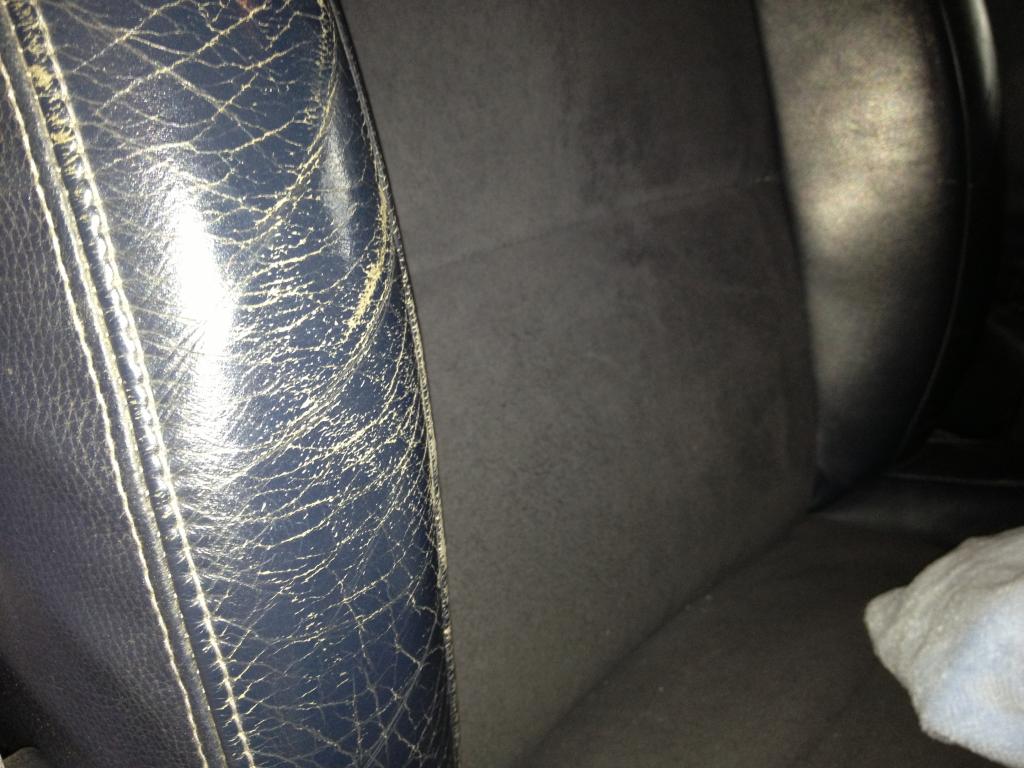

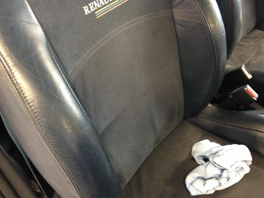

My front seats had started to wear on the sides and I had read another member using a scuffmaster kit to restore them so I gave it a go and was very pleased with the results.
Before
After

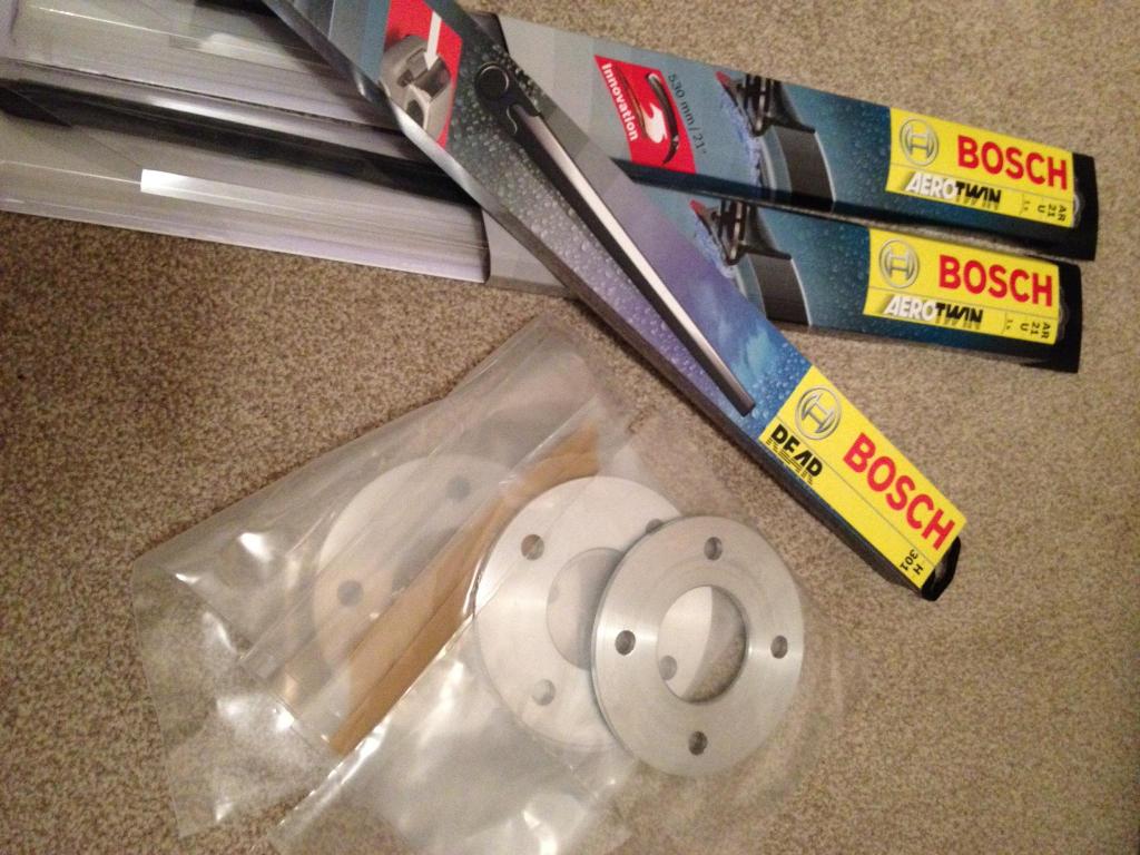

Few little bits to fit over the weekend hopefully, 5mm spacers from Myldan Auto Design and new aero wipers.

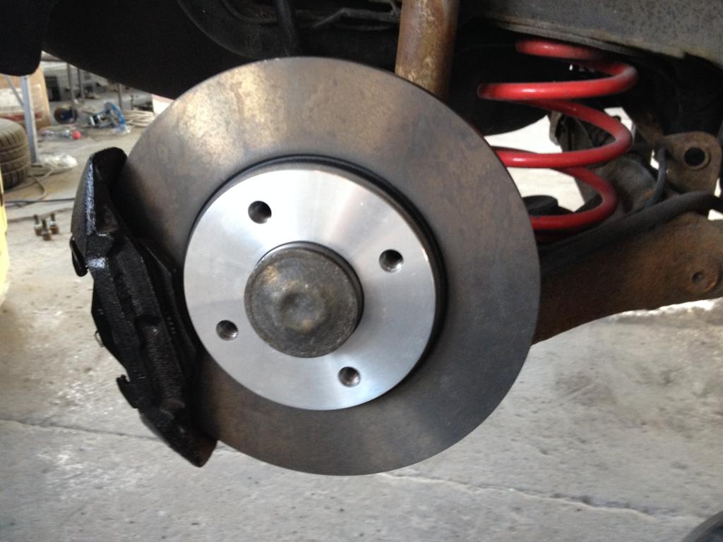

New rear brake discs now fitted along with 5mm spacers, still have the front spacers to fit next week. :approve:

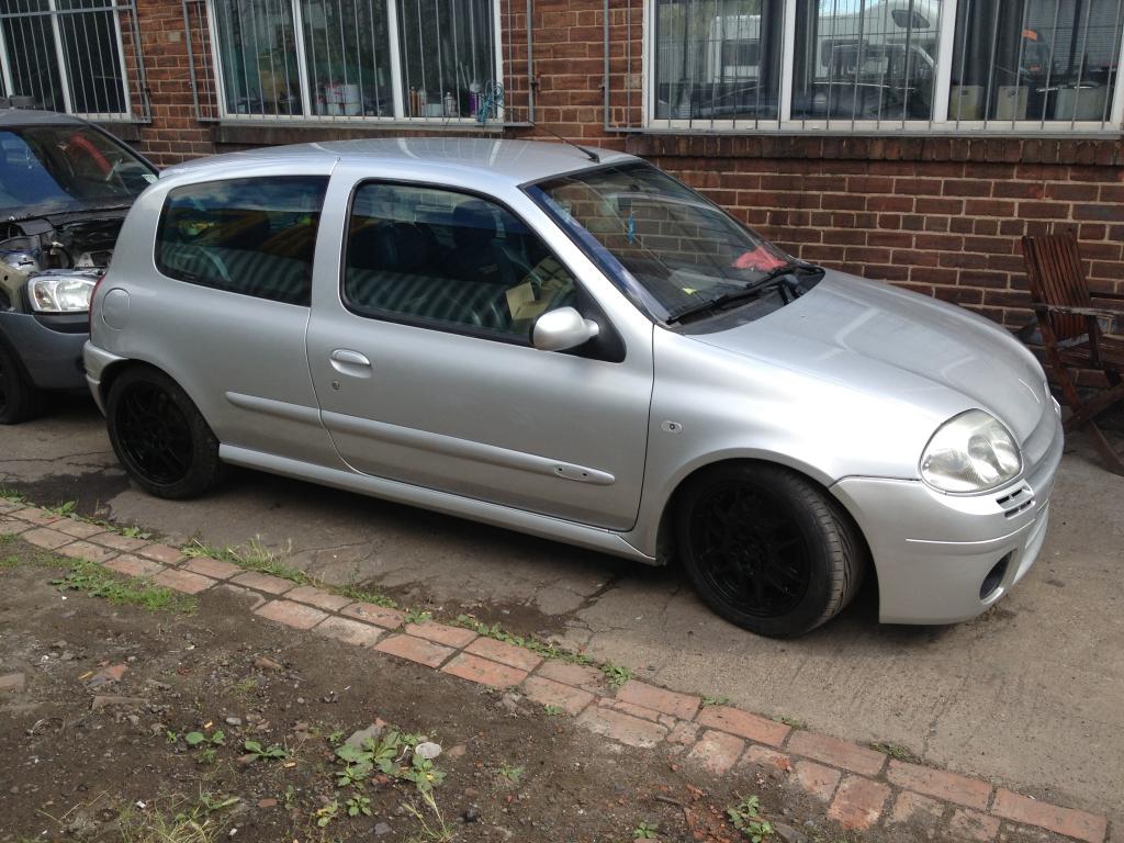

Back on the road at last.
I have found a few other issues which need addressing. The throttle still sticks a lot which is a persistent issue and giving the throttle body a quick clean doesn't seem to have cured it. I have noticed the cable isn't in the best shape so planning on changing the cable to see if it helps at all. Im also getting a lot of movement in the engine on idle so it looks like new engine mounts will be needed as well. The front brake calipers seem to be sticking but not sure if its just one or both. It had been doing this before it was taken off the road but think its gotten worse now its been stood. Finally I have found the speedo to be temperamental and seems to just stop working when it likes.
Hoping to start tackling the list of jobs asap and will probably find more along the way :S All that aside its good to have it back and it seems to be running okay.
