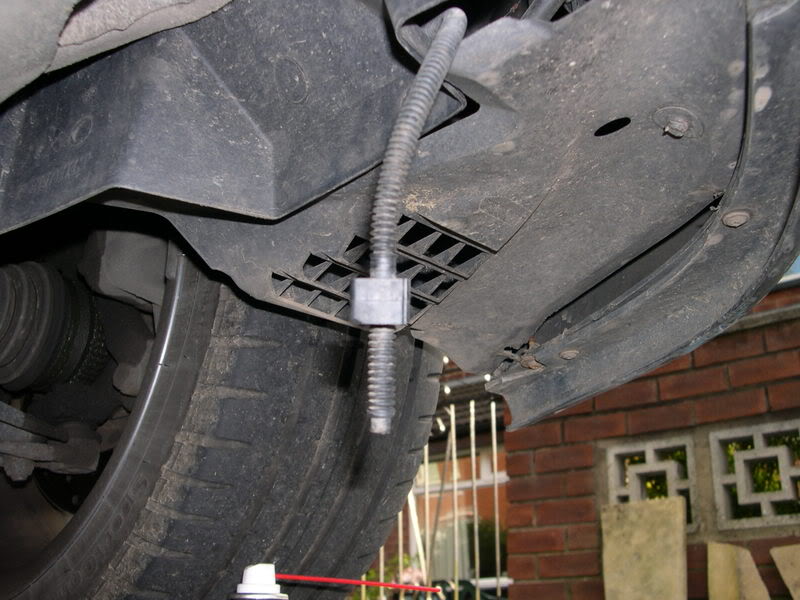

One thing I did notice, was this cable thing hanging down at the front. Any ideas what it is? Just up above it was a section that it looked like it could clip on to. I've put it back there for now - better than hanging in limbo, I guess?

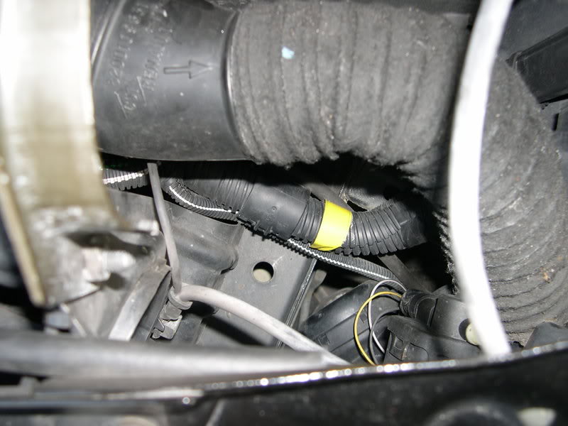

.....which when looked from above, came out from the cluster of tubes, near where the yellow tape is, near the air feed tubing. (I re-cliped that liner back into place as well while I was there ^^^^)

mine was dangling when i fitted a caf just clipped it onto something
