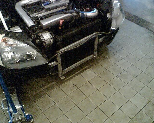

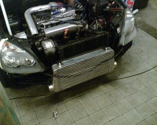

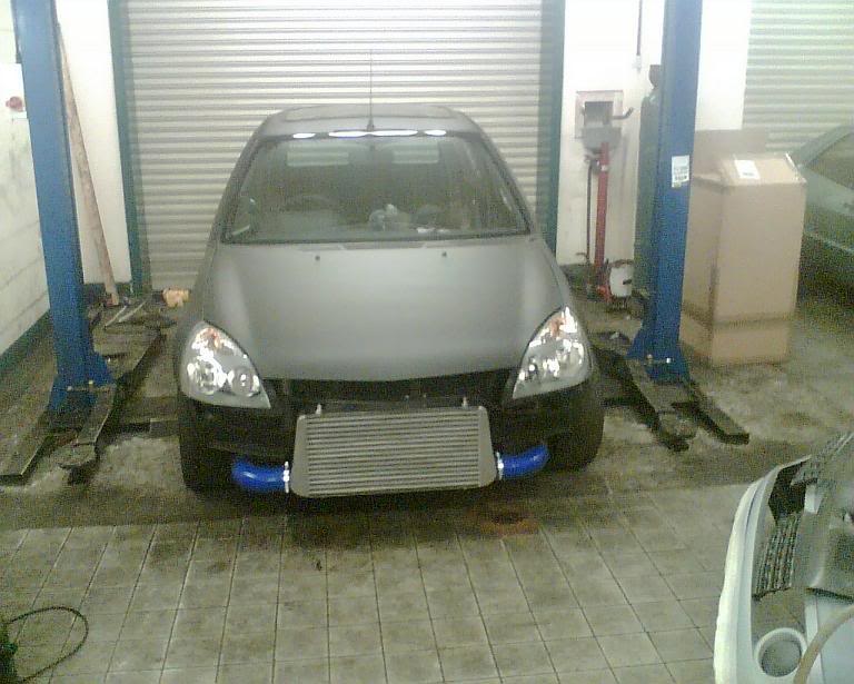

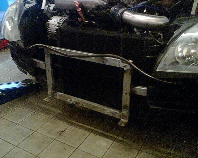

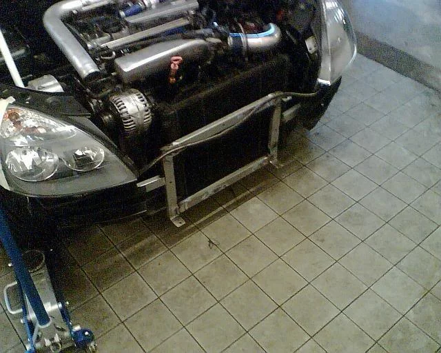

Cut your centre x member out. Make a suitable front mount for your cooler and then weld it onto the sections which remain on the old x member. Then strengthen the surrounding front panel.
