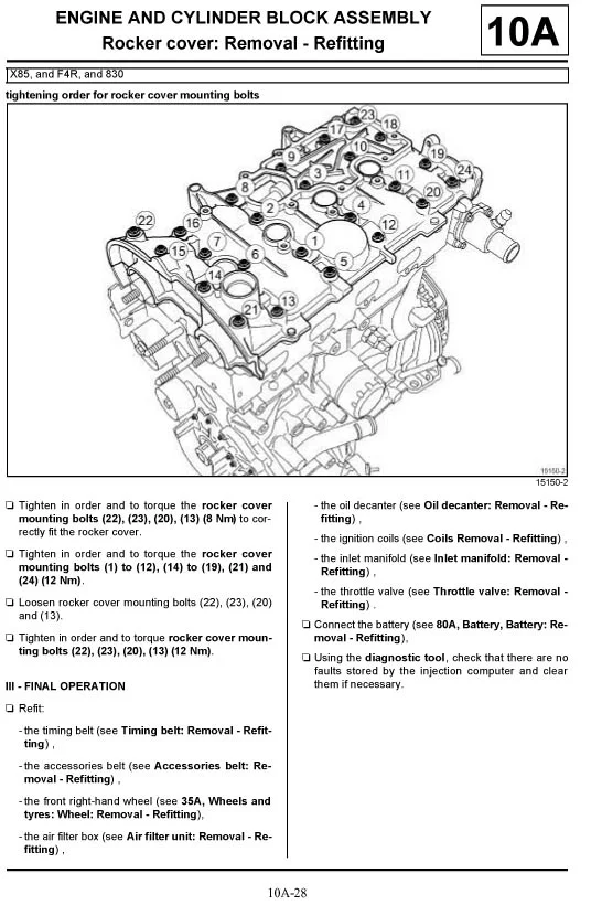

p@blo ClioSport Club Member Clio/A3 Apr 26, 2013 #10 Dunnerz5 said: Cheers. What is the sequence? Similar toheadbolts, centre clockwise working outward? Click to expand... Here you go mate
D Dunnerz5 Clio 182 FF Apr 26, 2013 #11 p@blo said: Here you go mate Click to expand... So 12nm then really. Where did you get the pic from? I take it if I was to want the rocker off completely I would need to remove the belt?
