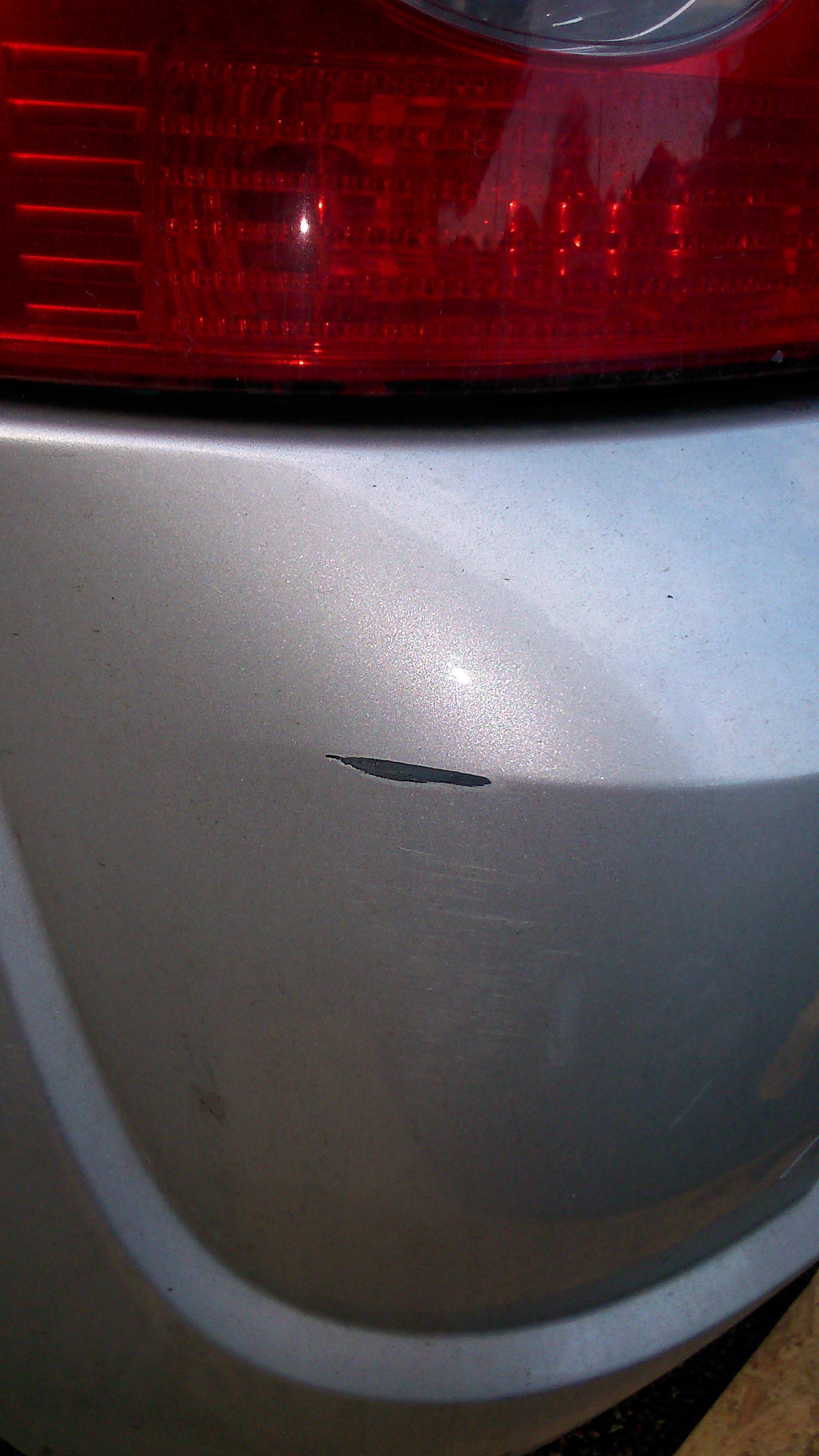

I have recently found a very small scrape on my rear quarter. I was wondering if anyone has used a touch up pen? If they blend in well? Or just plain not worth it?

Il get a pic on weekend thanks, I have polished it and reduced most of the scratches, but I have a minor 3cm by 5mm scratch
This is the black mark, not major buy noticable

Looks like that's down to the plastic. The slight scratches below will come out with polish. For the black mark, if polish doesn't shift it at all and its down to the plastic I'd get a touch-up pen, best way to use them is to layer the paint up and then wet sand it slightly so its flat, then polish it back up IIRC. Won't get it looking perfect, but could improve it and get rid of the black mark so it isn't anywhere near as noticeable.
