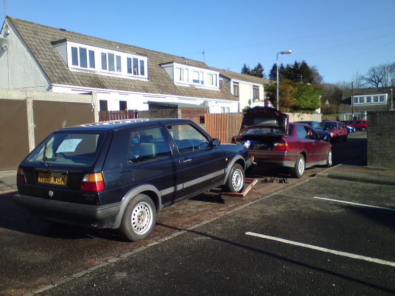

I used a towing dolly to move my standard mk2 golf, when putting it on the wheels did sit very low into the mouth of the frame causing the staps to damage the bumper when tightening up. You'd also need a yellow flashing light and a number plate board, but i'm sure you already knew that.
