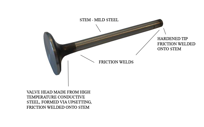

The OE valves are friction welded and the head has been known to part company with the stem when used at high RPM.
thanks alot for the info mate. I heard their 2 peice valves. But that has made me think a bit!

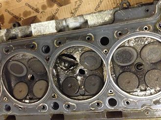

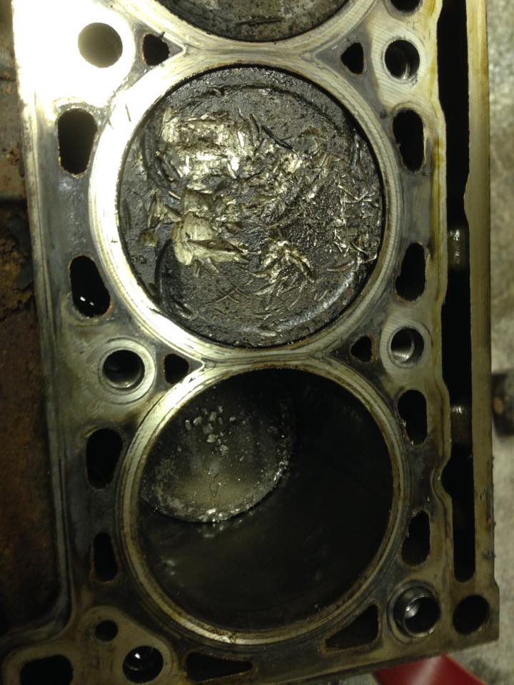

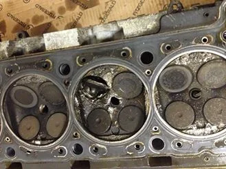

Dropping a valve is never pretty.
Did you not replace the piston rings?
If you're having the engine apart, replace the valves as a priority.
It'd be sods law that first time out the thing drops a valve and destroys all your hard work.
Valves arent that big of a deal, out of all the clios that get regularly abused on track is still a minute percent that fail by snapping a valve, and even then most of the time its a mis-shift and mechanical over rev, the super tech valves can fail under the same circumstances too, they arent indestructable, and at the price they are you could have a lowish mile engine as a replacement.
