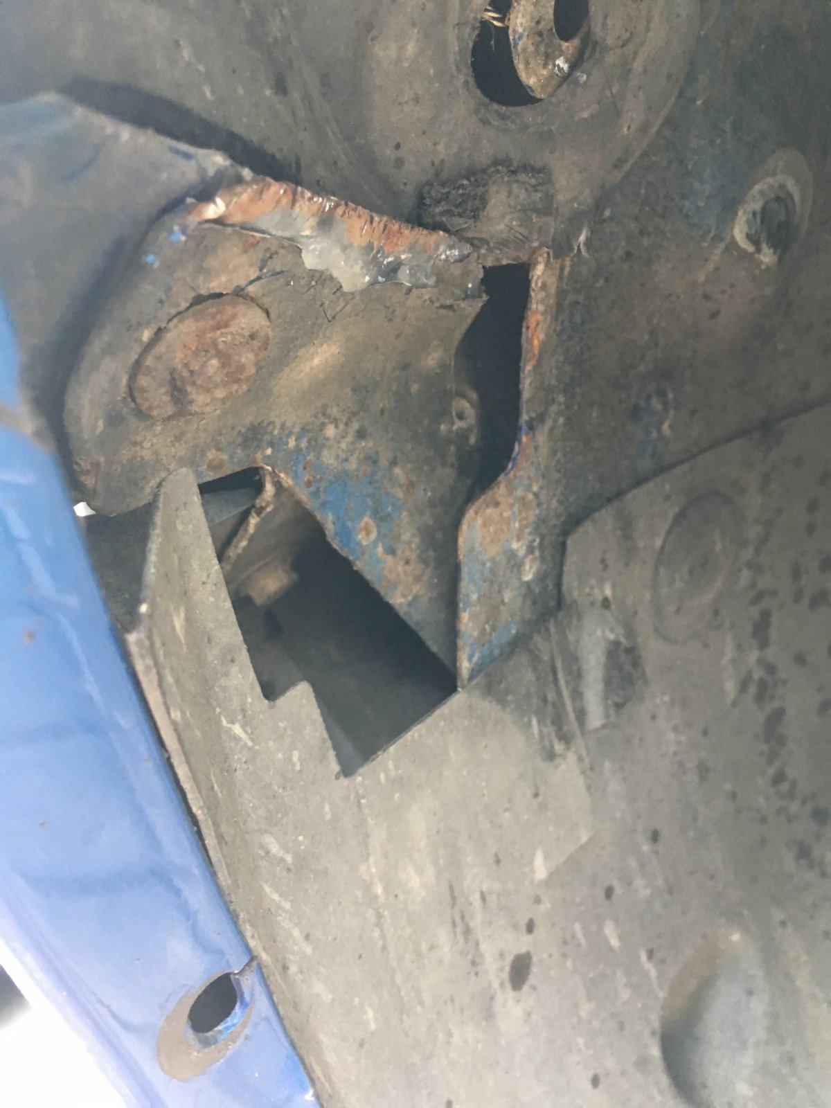

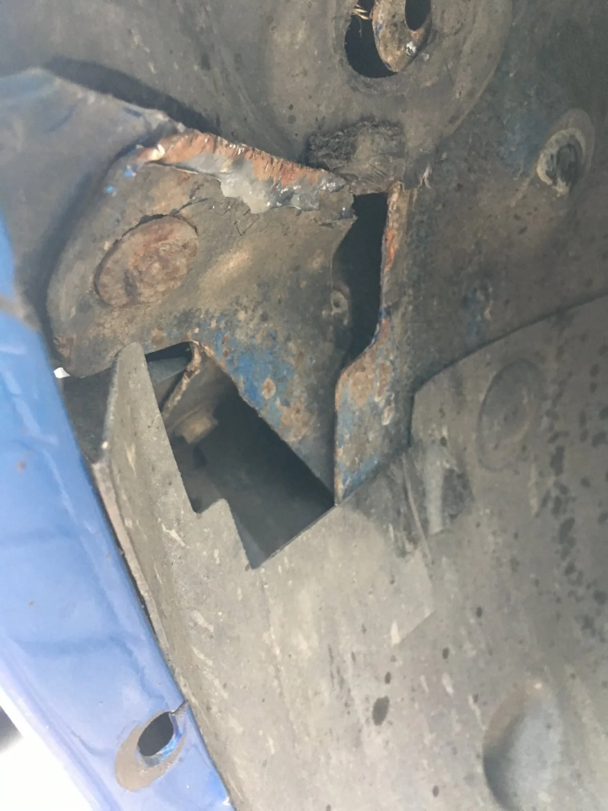

Yes I did, may just remove the wheel liner also.. I feel I need to bend it back further??.. just had yoko 195/50/16 fitted to make the situation worse.. I am going to increase the ride height

I reckon so and a bit more hammering, do you know what the standard ride height is measurement wise on the Clio cup 172 with Turinis ? If so, how is this being measured so I can determine how low she currently sits
We worked out the current ride height lowered must be 45ml low, this must be partly where the problem lies.. going to bash the bumper bracket even more tomorrow
