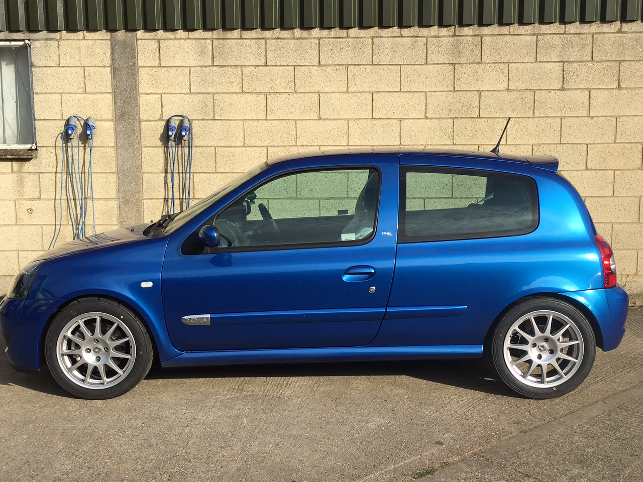

This is the new ride height, before we started the rear was at the lowest setting and the front was lowered 46ml from standard, we have risen the height another 20ml at the front and 18ml at the rear. Rake is still looking good, the car seems a lot more alive when driving, also with a combination of hitting the bumper bracket and increasing the height of the suspension it doesn't seem to be rubbing however the real test will be on track. New Pure rear anti roll bar is getting fitted tomorrow
