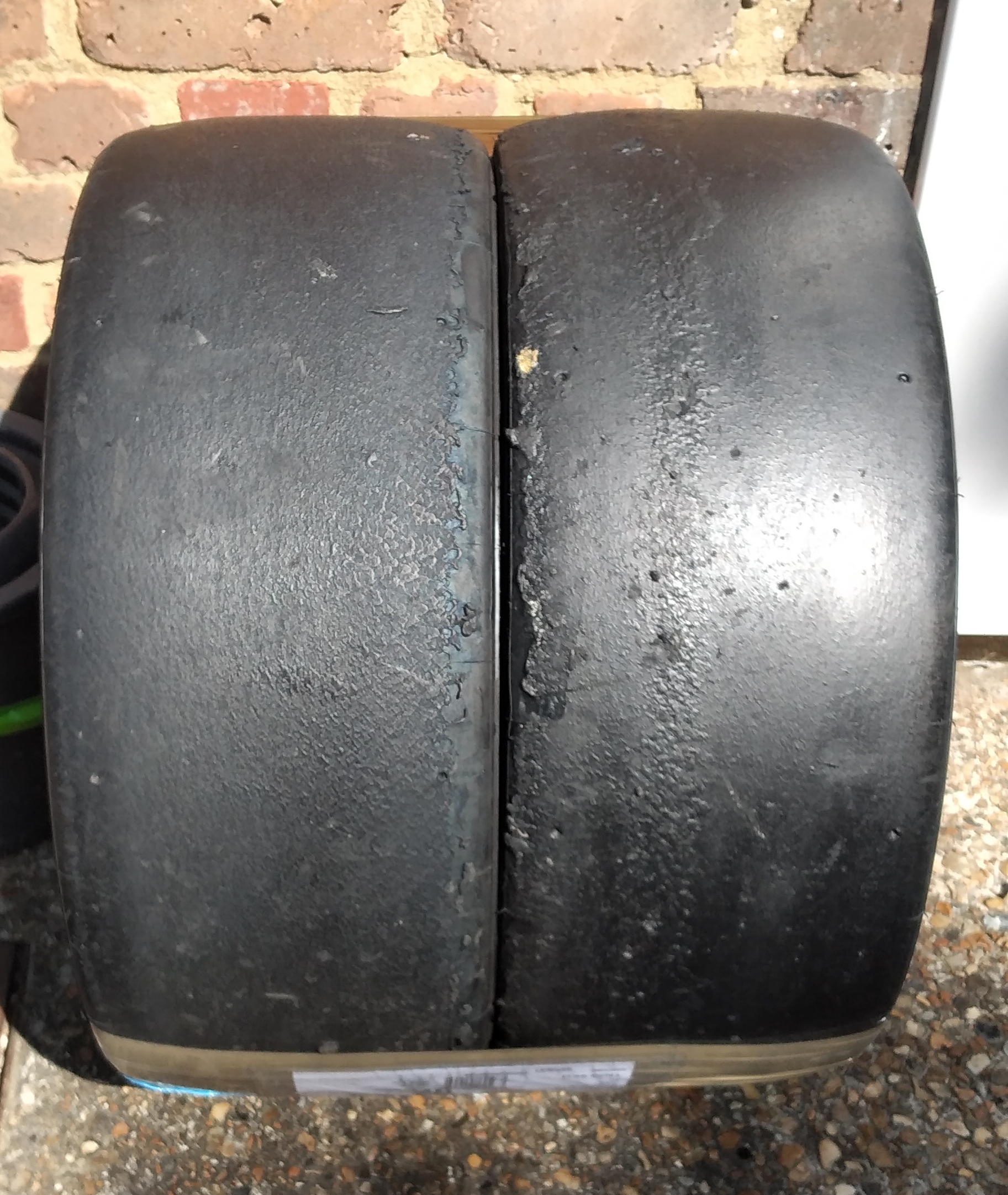

The slicks turned up a lot earlier than expected, and look in really good condition.
The only thing I should have asked was to have one from each side of the car, as they were originally run, but I got two from the same side.
As I want to use both on the front I can only spin one tyre.
It's no big deal really, but I'd normally fit them 'inside-out' to get the best wear, but I will have to fit one inside-out and one the way it was first used.
Great service and a good price so many thanks @JB21 for the link, this Forum has been so helpful over the 3 years I've owned the Clio.
Probably can't rely on the British weather quite so much, bet it pisses down on the 11th! But then hey-ho, I've got a brand new set of Rainsport 5's on 16" rims that I've never tried before, so it will be a new experience wet or dry!

I've ran them non directional mate with zero issues. Cant remember if they are marked inner and outer on the sidewalls? If not than you can fit them left and right going the same direction?
