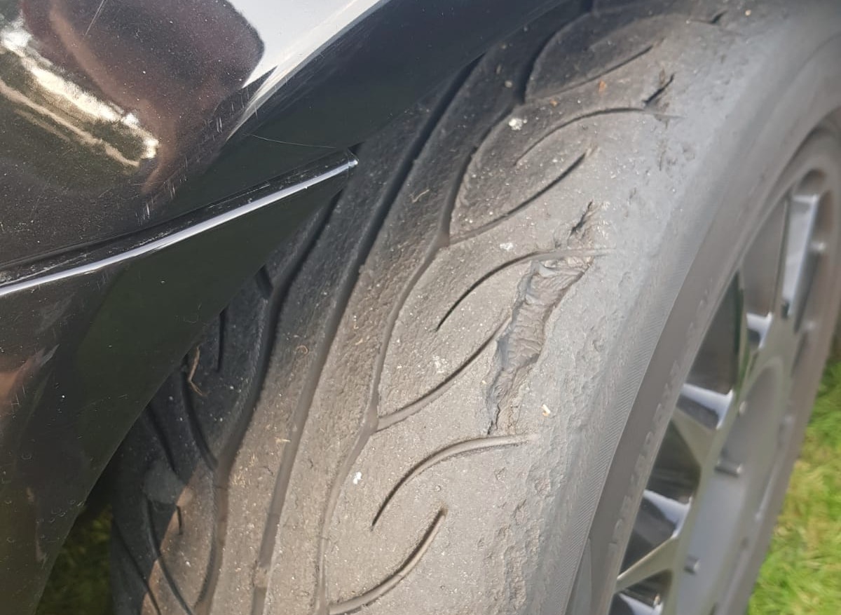

My 2 pence worth. I started my first season on Yokohama AD08R's, not the new compound. 195/55/15's on TD Pro Race 1.2 wheels.
Worth noting my Clio 182 is running a modified version of the Spax coilovers as used in 750 MC 182 Clio Championships. Stiff as hell.
On track i found them quite grippy for the first few proper laps, then they slowly started to loose grip and after 6 or so spirited laps they'd be sliding all over the place. At Croft i literally took chucks out of them before the circuit was resurfaced. A friend runs them on his half track/road Clio 182 with B14 suspension and likes them, although like me, after a few hot laps they start to slide about. I refer to them as a 10 minute track day tyre. Nice and cheap.
I also had them on my Clio 182 daily with 16" Turinis & 205/45/16 tyres. I found them useless in the wet or cold damp mornings and they made my car tramline something rotten. Switched to 195/45/16 Michelin PS3's and it's transformed the way the car behaves.

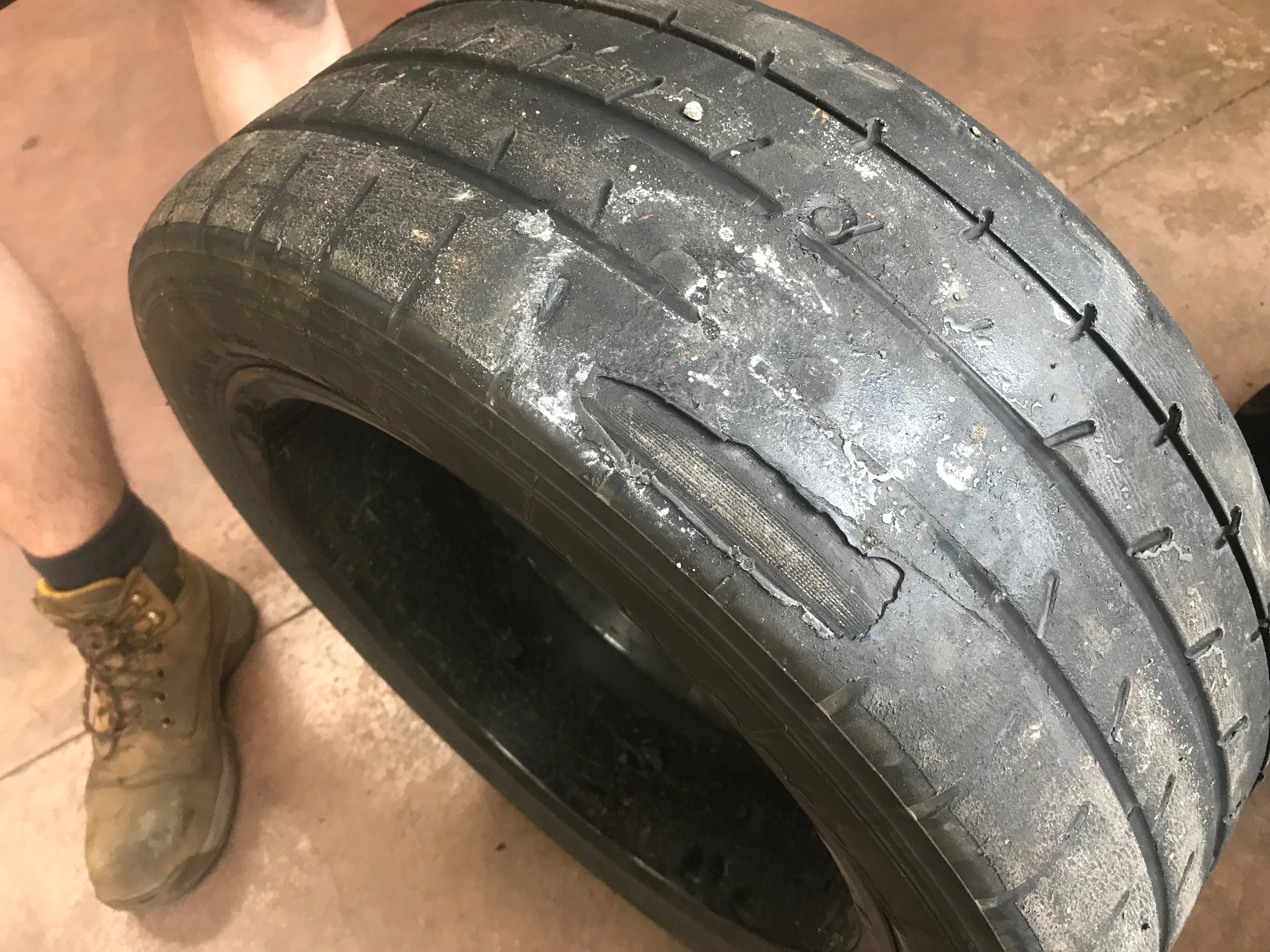

Yokohama A052's - i moved over to these after the A050's became difficult to find. I found them really grippy and set my fastest times on them. Despite the grip they move around underneath you a lot, but can withstand long stints (20 minutes) with little to no change in feel. They're also good on damp tracks, something the A050's are awful at, so you're not so much worried about the weather - unless it chucks it down of course - then you're fooked.
The downside for me was the degradation. I fitted a brand new set, did Croft and couldn't believe how much they'd worn away. By the time i got to Cadwell Park a month later, they'd literally thrown the towel in by lunchtime. Big lockup at the foot of the mountain and i was loading the car up shortly after lunch.
They're not cheap either at £135 a corner.
I have since discovered a few things about these tyres which would help with the longevity going forward.
1. They don't like as much camber
2. They have no under tread, so as soon as the tread cap is worn out .i.e. flatspot, the carcass belts are exposed and the rest of the tread starts to separate from the carcass.
3. They need slightly more pressure over the A050's, 32 psi front and less in the rears, so 32 psi as opposed to 35.
Overall i liked them a lot and have bought another set which i'll use for damper days and as a back up tyre.
Going forward i've now found a new supplier for the A050's so i'm back on those now. Best tyres i've used for track by a country mile and at £105 a corner i consider them a bargain.

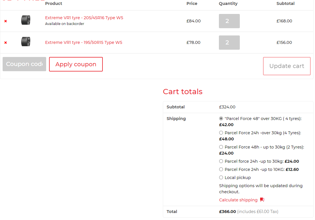

I was at Three Sisters last week competing in the Javelin Sprint Series, and the current class leader was running A052's. In the morning with pissing down rain I was leading on Rainsport 5's by near a second, as soon as the track started to dry he instantly started to get faster, by the end in the damp he was 1.2s a lap faster, and that was with me changing to AR1's. Its a lot of outlay for a tyre that would only be used in damp conditions though.
I'm now looking at Extreme performance tyres VR1 as the guys running these at 3S were miles ahead in heavy rain and the damp, supposedly the VR2 is also very good in the dry. They are remolds but they're getting rave reviews, and they're very cheap. They even do a full wet in the VR3.
EXTREME VR1 - Extreme - Tyres (extremetyresuk.com)
EXTREME VR2 - Extreme - Tyres (extremetyresuk.com)
EXTREME VR3 - Extreme - Tyres (extremetyresuk.com)
Mr Underhill
I agree. I'd already bought a new set of 52's as up until last weekend my search for A050's was fruitless. So already had them and will take them along to the next trackday's as we're starting to move towards Autumn and potential damp conditions. Got some Rainsports as well in case it chucks it down.
