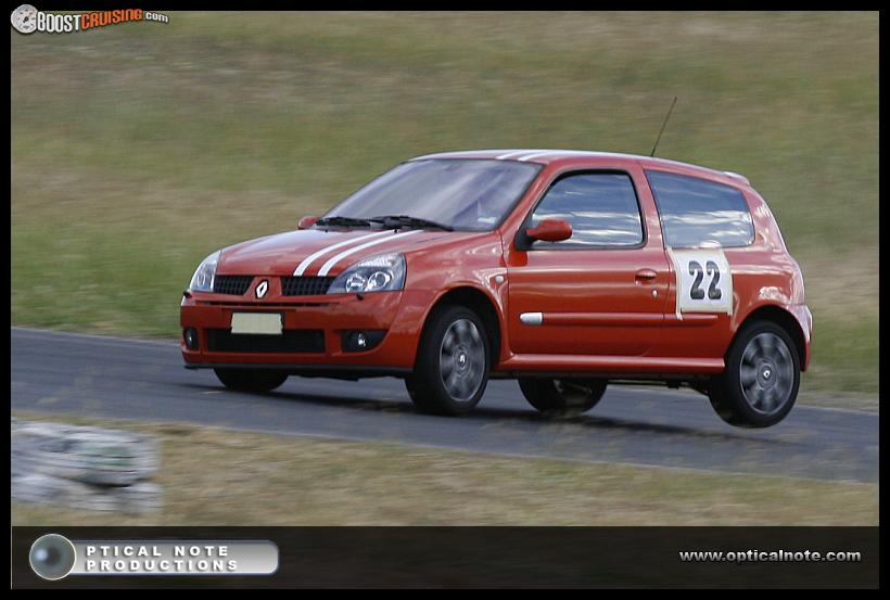

Me and some mates have narrowed down a track wheel and tire setup for our 182Cup's to one of the following:
a 205/50/R15 on a 15 x 6.5 rim
or
a 215/50/R15 on a 15 x 6.5 rim
or
a 215/45/R15 on a 15 x 7 rim
Anyway, im not too keen on just taking the suppliers word on the best setup so I'm hoping you guys can help us out.
BTW, The tyre we will most likely use is the Hoosier R6 slick.
3 wheeling Aussie style!
