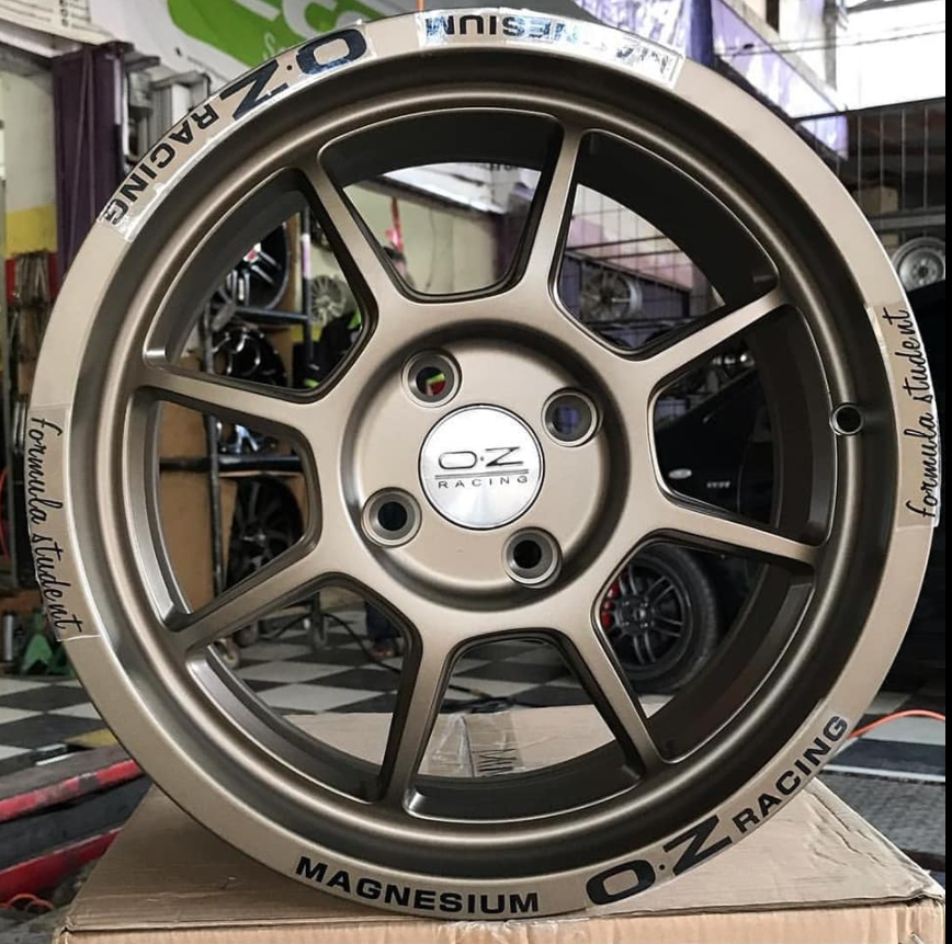

Hello All, I have a Clio 172 ph1 rs . I wanna change my wheels and i found O.Z. formula. But this wheel's ET value different my original clio rs wheel. Original 15" rs wheel's ET value 45.
if i make this modification , Will I have any problems with ET value? by the way new O.Z. wheel's ET value 35 and my tire 195/50/r15 ps3 .
Bu, jantın genişliğine bağlıdır, ancak benim 7x15 ET37 aracım 195/50 lastiklerle sorunsuz uyum sağlar.
hmm , my rim's value 7x15 4x100 ET35. I hope I can use it without problems. My only fear is that the brakes won't fit and touch against the rim.
