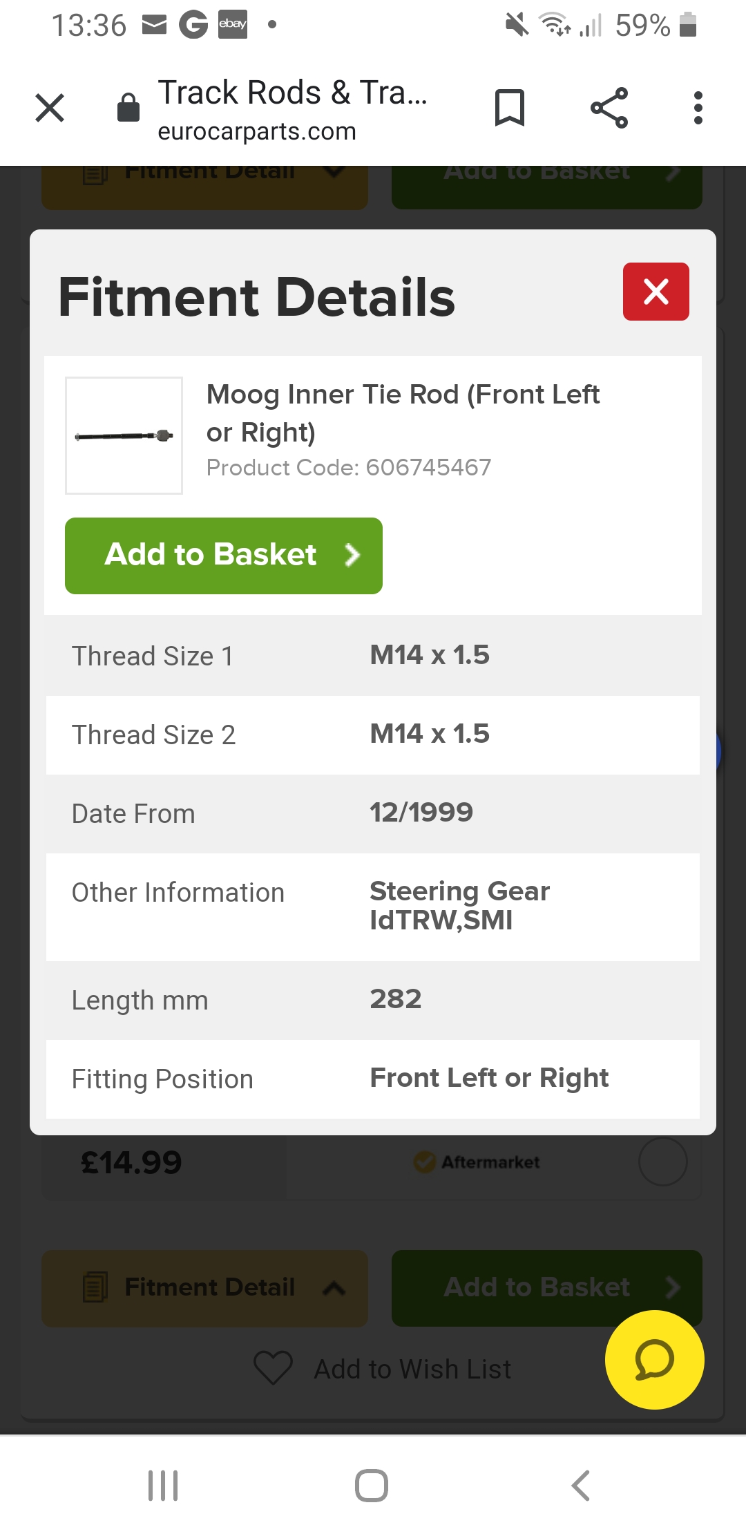

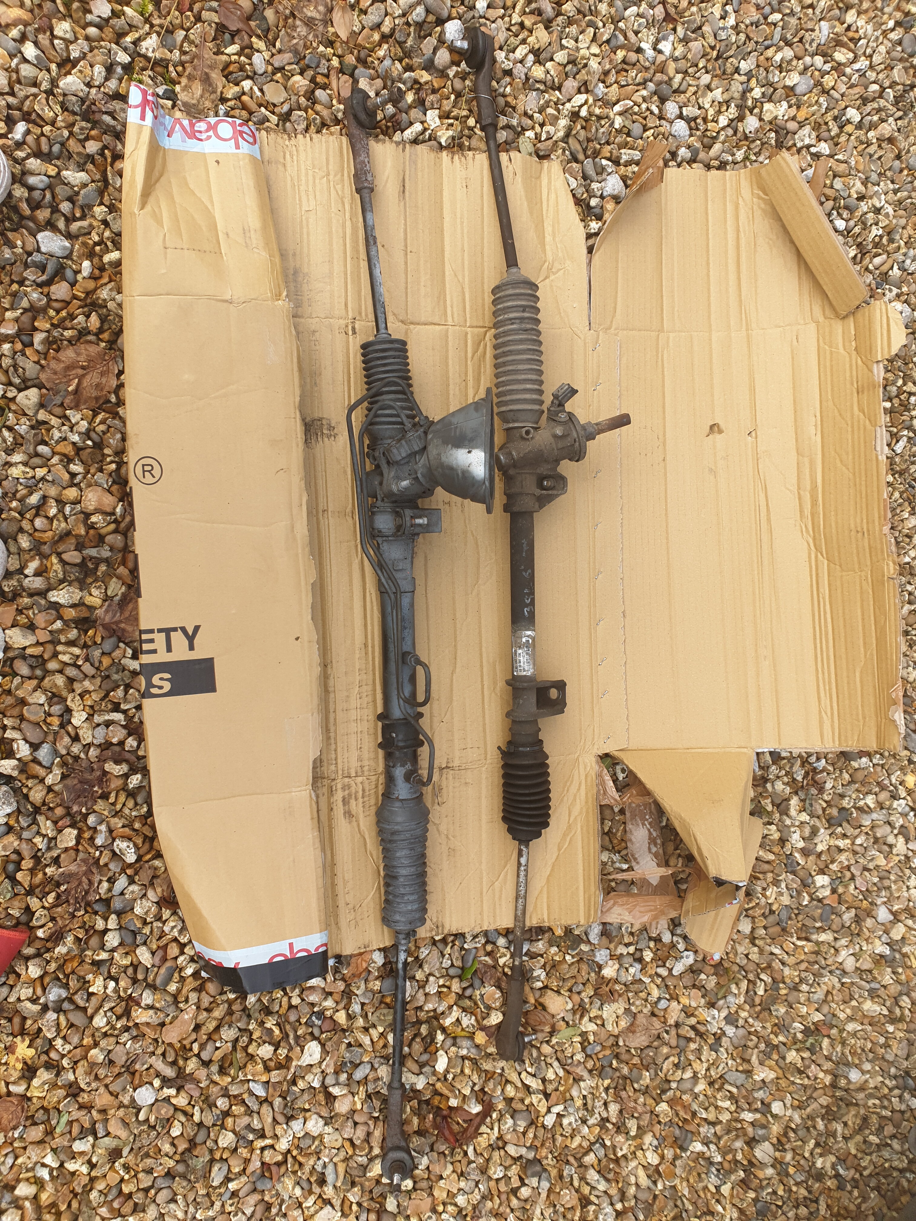

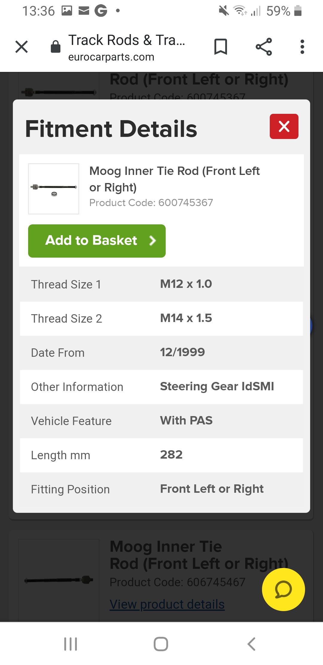

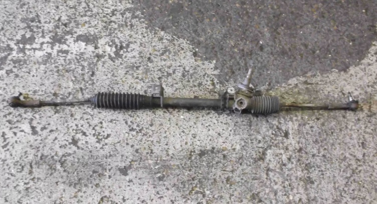

What trackrods do i need for EPAS conversion ? Do i need to remove the ones of dci rack for some 172 / 182 ones ?
  clio 172
Assuming i need to take the trackrods and ends of the 182 rack for the epas rack ?
  clio 172
I am going to put all new on ,thats why i was wondering if anyone knew which type os corrcect for epas rack before i dismatle it ha ha

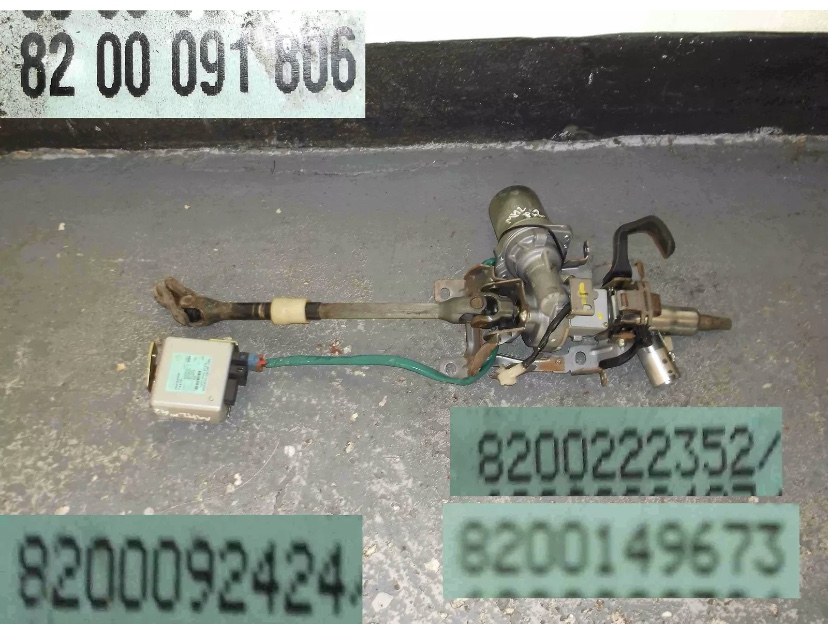

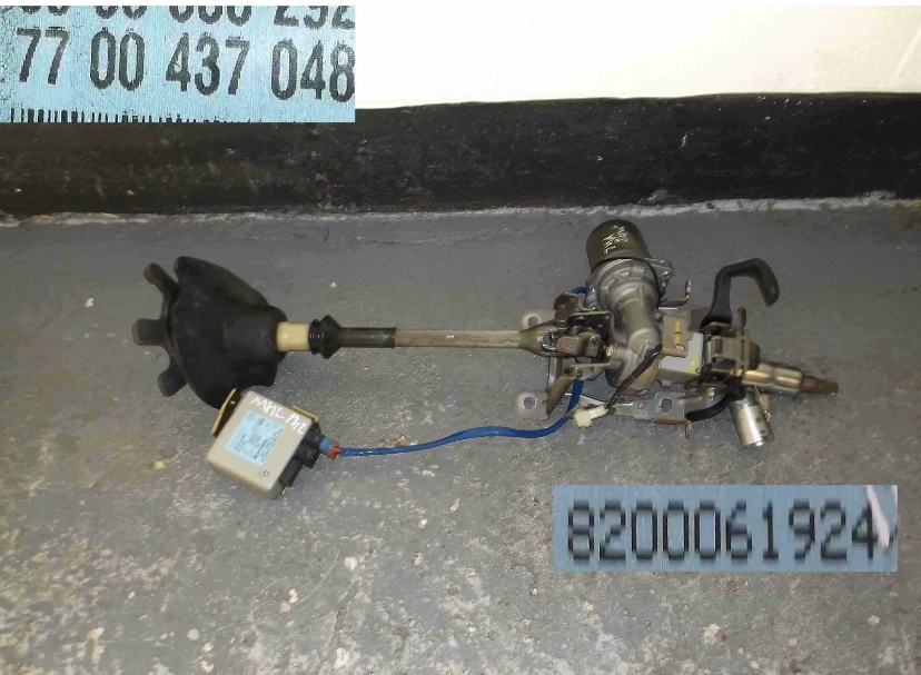

I’m gathering all the parts to do this conversion on my 2004 182.
Is there a difference between the blue and green wire?
Are there any other parts I’d need other than, the steering column, DCI rack, 182 track rods and a controller box?
Any advice would be greatly appreciated.
