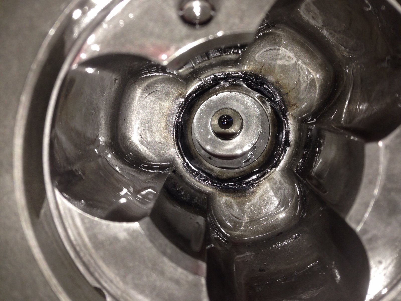

Gearbox is now out. The good news is:
- the expensive new clutch is 100% a-ok
- when the input shaft is spun the gear set can be heard rotating
What doesn't look so good is in the driveshaft cup on the box, right in the middle at the bottom there looks to be some kind of disturbance and it may have separated (see pic). I'm a mechanical r****d so just relaying on behalf of a mate
Thanks in advance for further comments -
Matt

Sounds like it's a potential diff failure then after all. Lifetime warranty!!! You'll need it stripped down first though.
