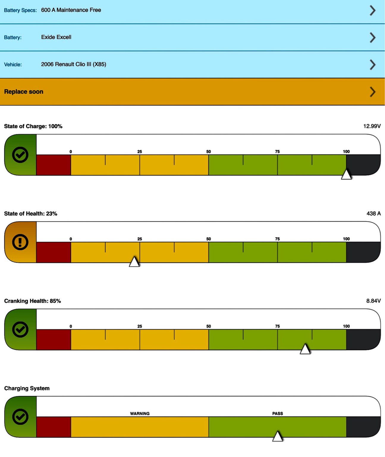

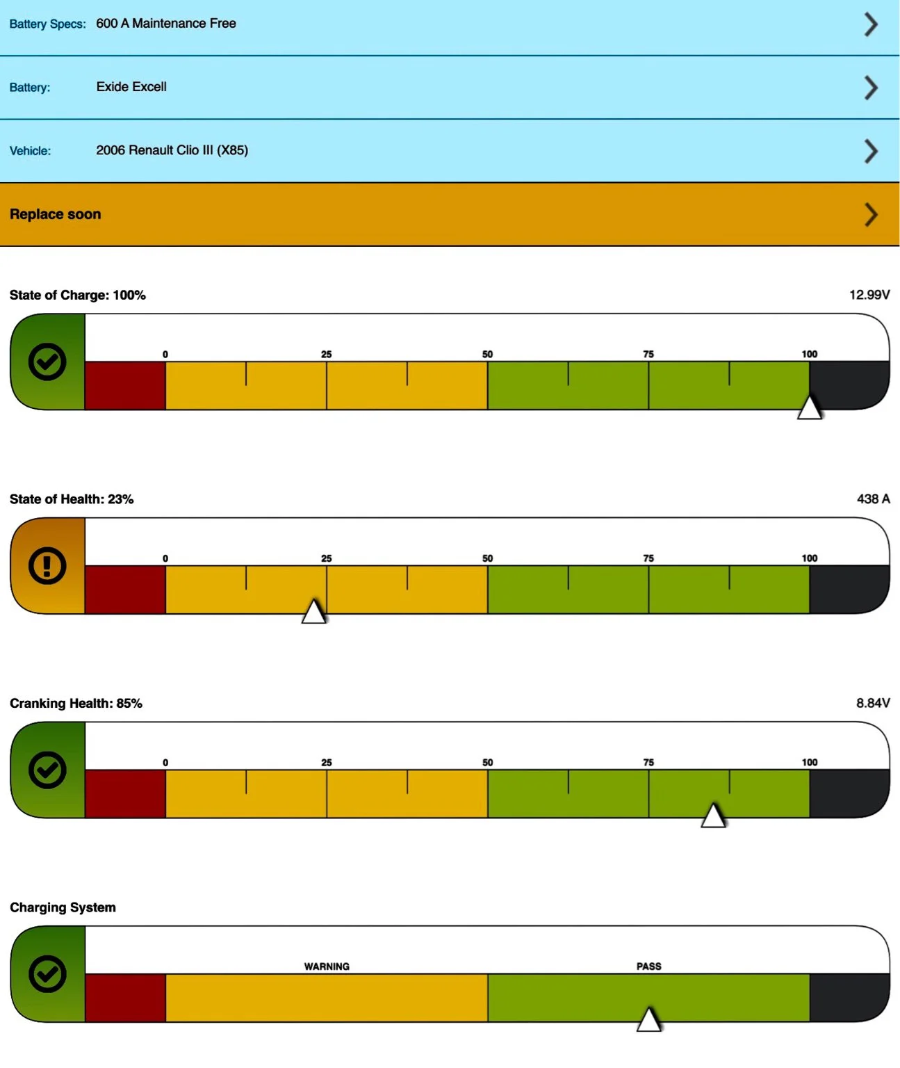

This is why we test the battery on every car that comes in...
