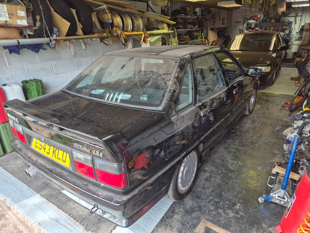

@Paule78 decided that I didnt have enough on my plate and dumped a black K-Reg on my drive recently, it started and ran but was blowing like a cheap hooker around the turbo and had been sat for a long time (in the netherlands, oddly) so needed a bit of a recomission.
In it comes (at the back)

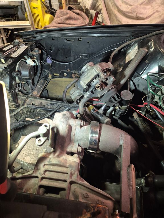

Heatshield off...and oh look.
Vband gone. Great! Nice easy fix right? RIGHT?
Well. No. Obviously. Little did I know what was in store. We'll get to that in a bit.

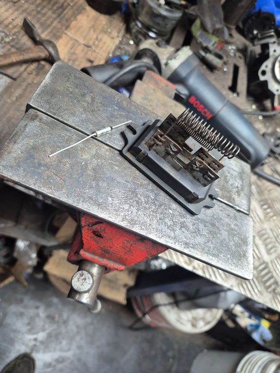

Heater blower was inop, motor was seized and the thermal fuse was popped, so replaced the fuse and freed off the motor as best I could. Its very noisy though and will need replacing.

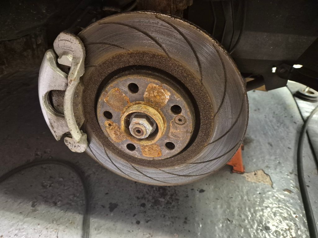

Front discs look.... sub-optimal

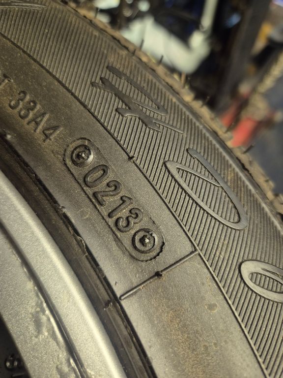

Tyres from the stone age. (Well, 2013, but still old).

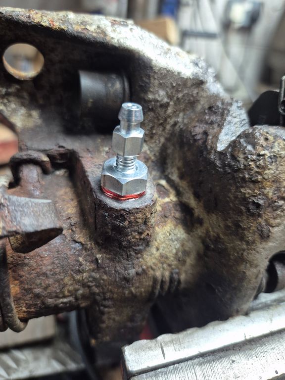

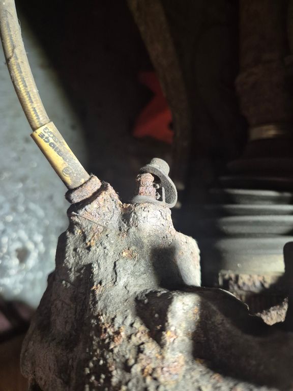

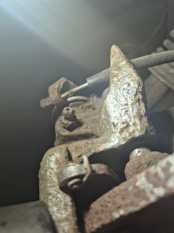

Bleed nipples with auto-rust function
I managed to free off 3 by filling them with GT86 overnight. One snapped.
So I had to drill and repair it.

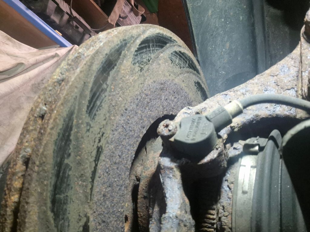

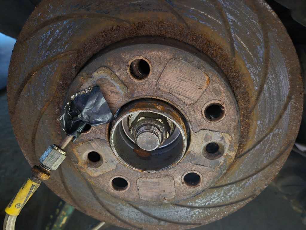

Torx screws missing from rear discs - FFS. I have run out of spares so now the car has one in each disc instead of 2.
Rear discs are crap too but I cant currently source any! Worrying.

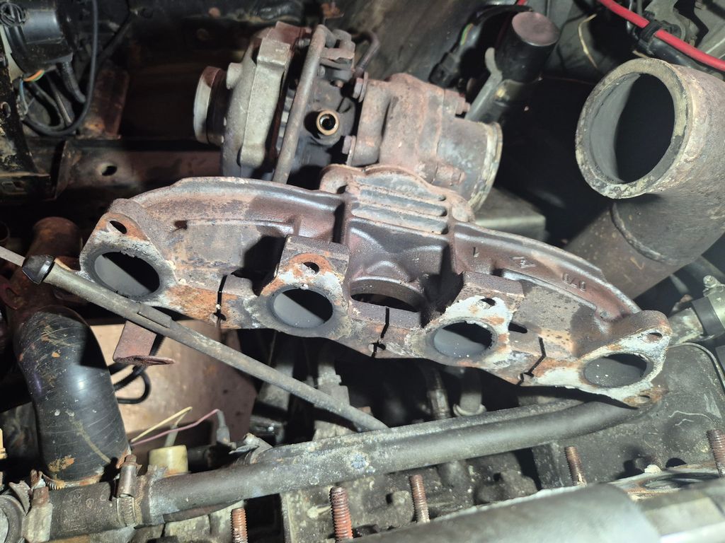

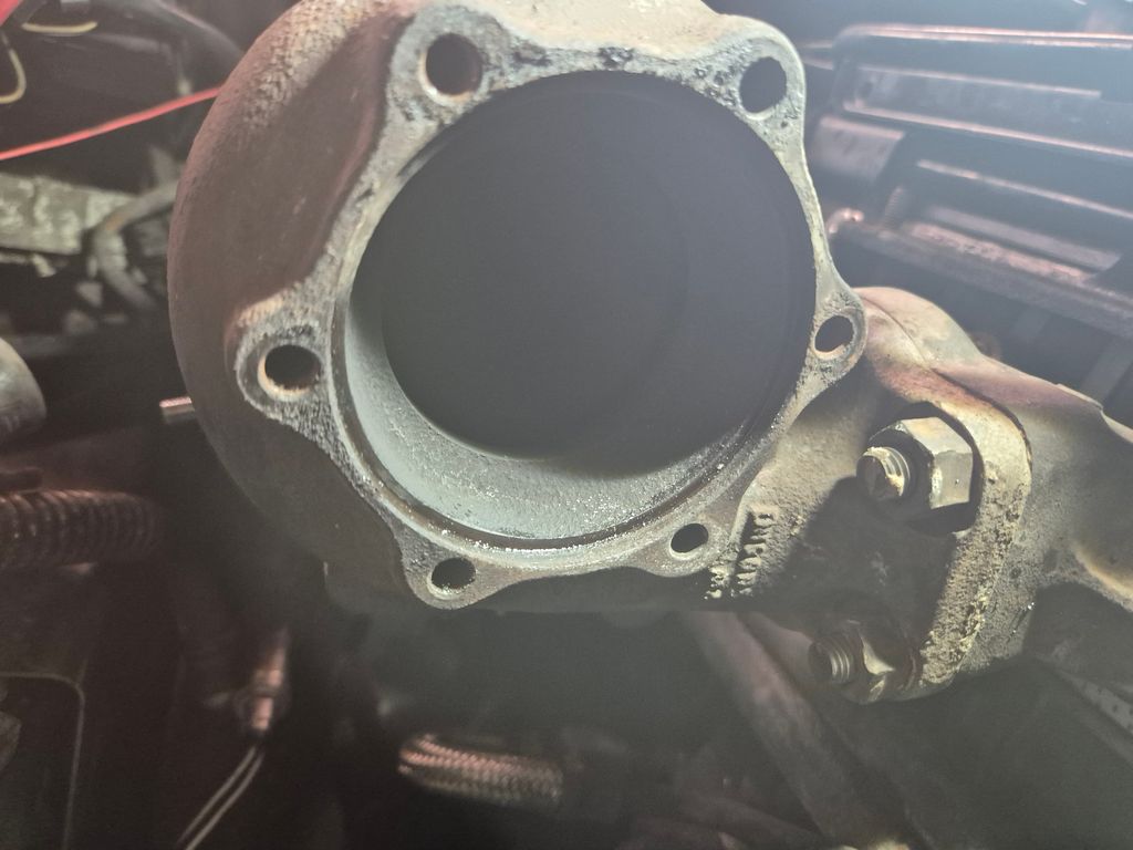

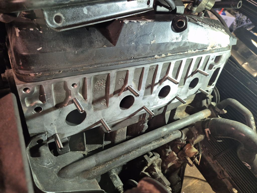

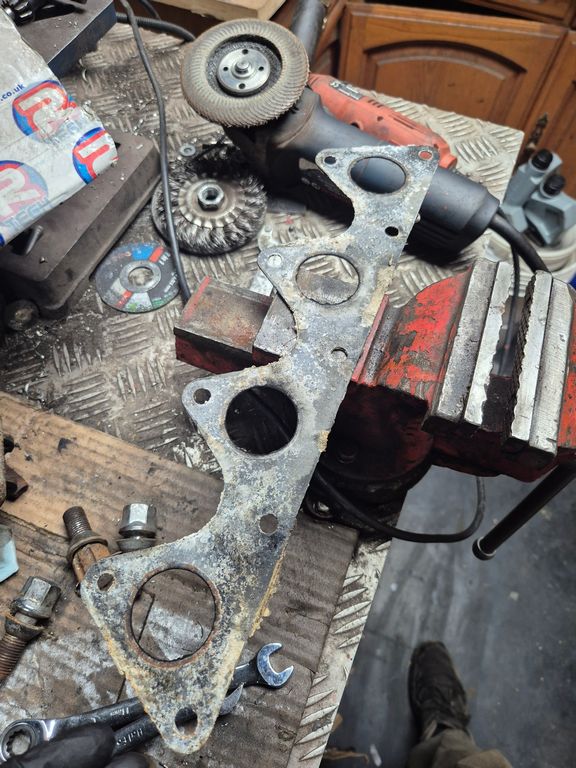

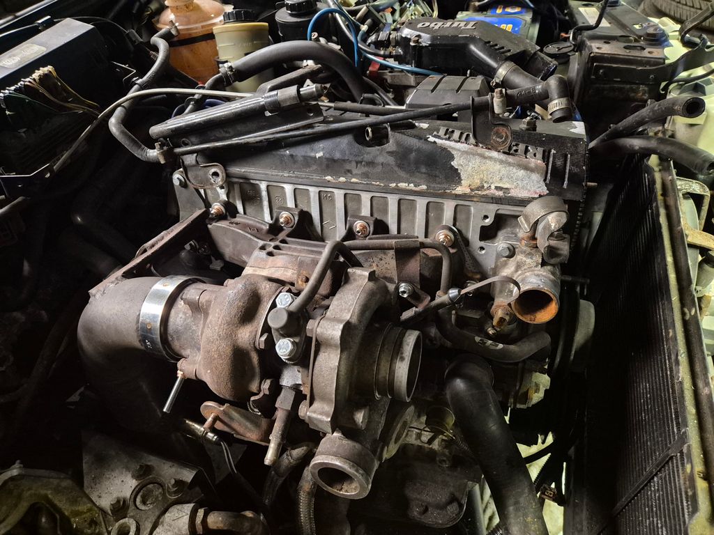

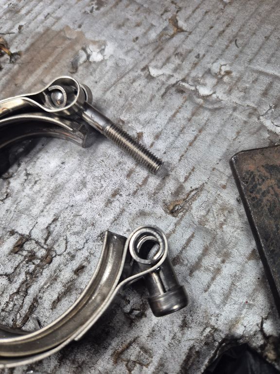

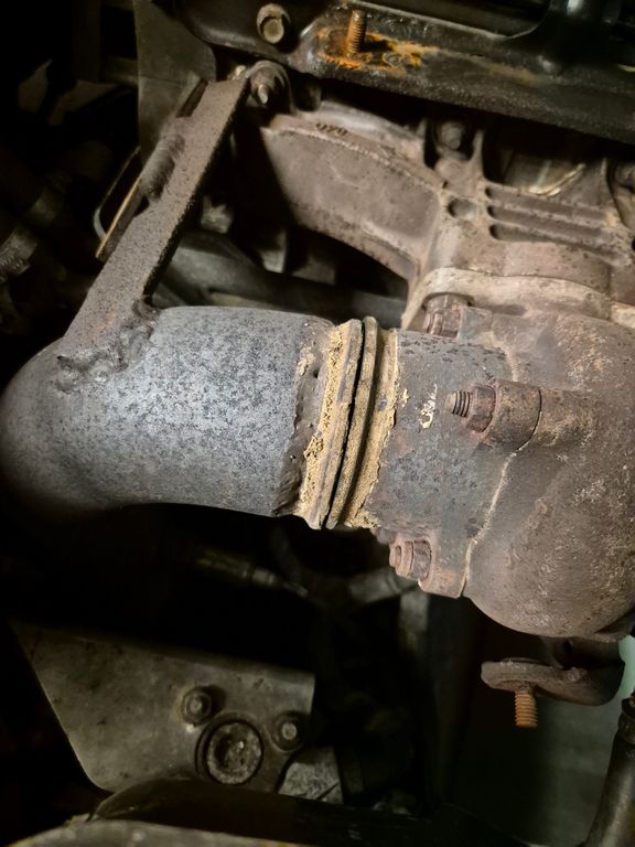

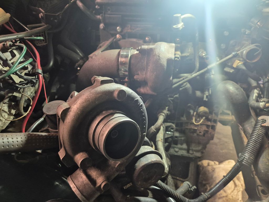

Now on to the exhaust - well the vband turned up and I fitted it. Still blowing - as bad as before. Investigated further and - oh dear. We had 3 broken manifold studs, plus another that was drilled out to M10...but only for about 5mm below the surface. So...manifold off :( You can see the stains from the blowing and what looks like an attempt to seal with paste... FFS.
Even better the new vband snapped the thread when I removed it. Filed for a refund and bought another.
I managed to get most of the rest of the studs out with heat and care, one more snapped though. This meant the welder came out for stud extraction, sadly it didnt go well this time. I had to (mnanaged to) drill and tap a couple.
The M10 one I drilled out properly, and managed sink a helicoil in to it. This has held fine when reassembled.

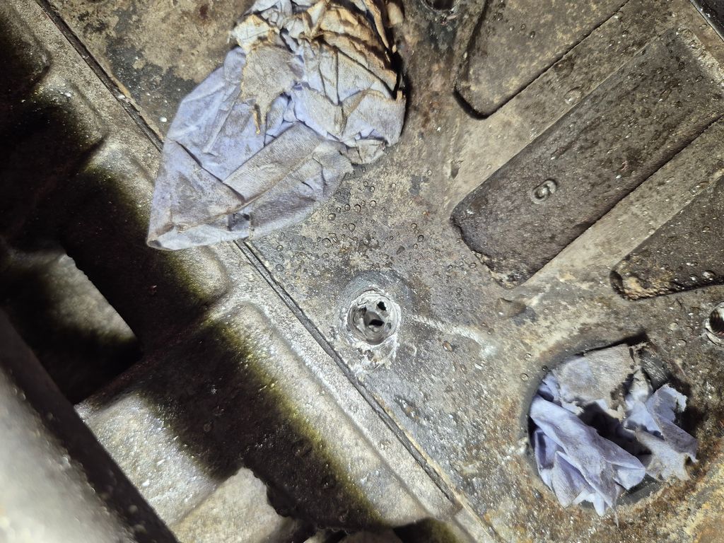

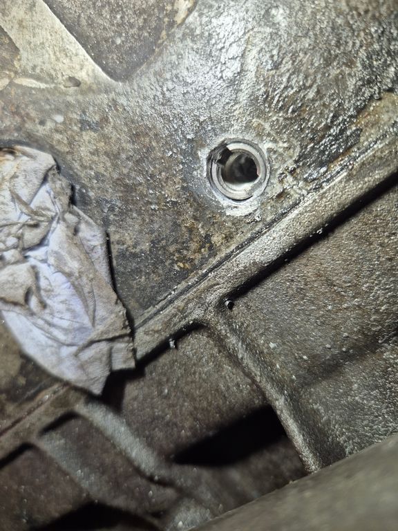

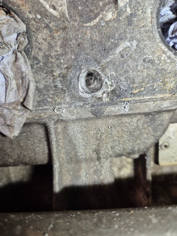

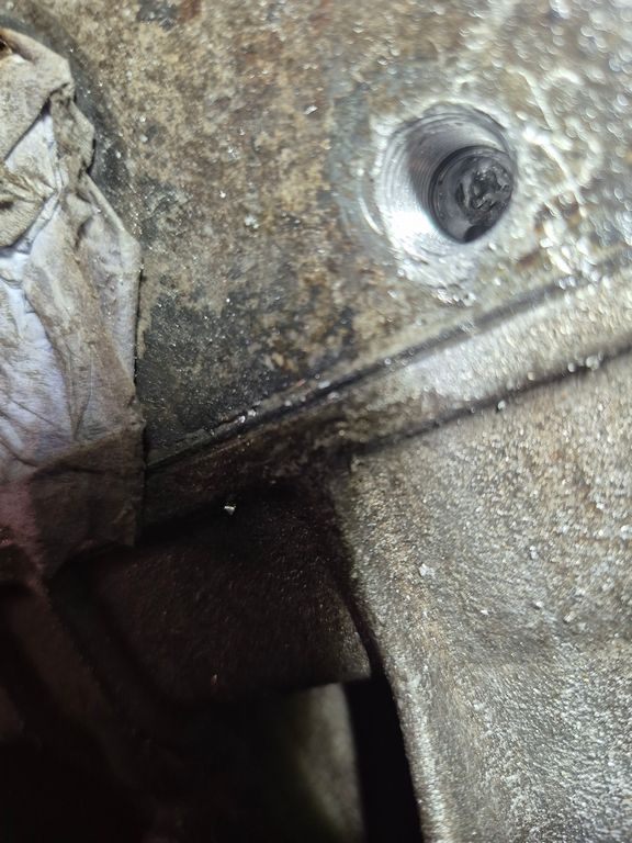

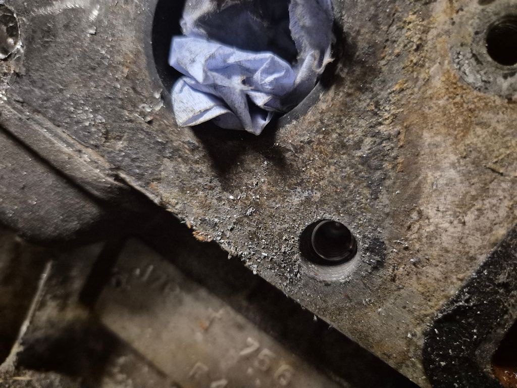

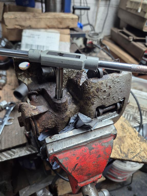

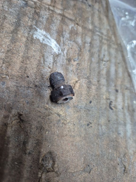

I got to the last stud which I was struggling to drill out, it blunted a couple of bits and had me puzzled. I dug around it a bit with a dremel and...
Can you see what that is? Its a broken tap in the hole :( :( :( no wonder it was blunting drill bits! Normally this would be head off, and spark erosion.
DaveL485
  21T, 9T, Meglio, V6

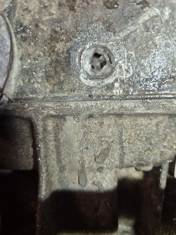

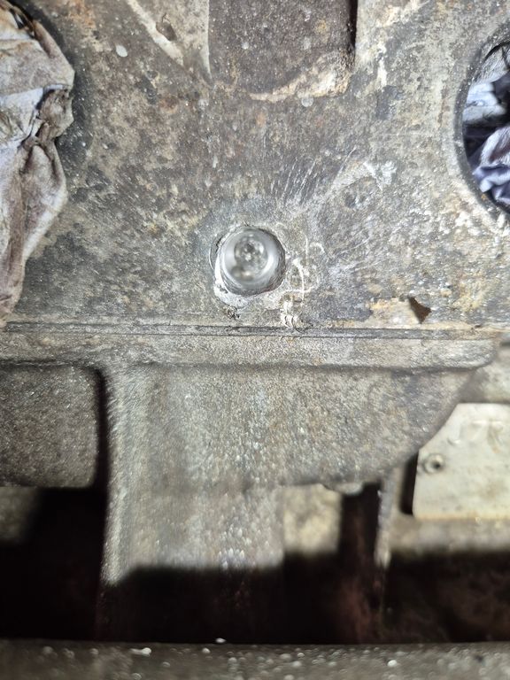

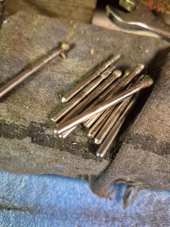

HOWEVER, not wanting to ring Paul up and be like "Yeah you know I spent a shitload of your dosh well now im taking the head off too" I tried to get the tap out with a dremel and diamond tipped bits. Basically, grinding it down from the top. It took A G E S. Over 3 or 4 days I think I must have spend 6 or 7 hours and pretty much every dremel bit in Coventry trying to get rid of it. I had to dremel with one had and squirt water in with the other to stop it burning the bits out in 10 seconds. I must have used 20 or 30 of them!
Close to the bottom, you can see the dimple in the end of the tap
Finally

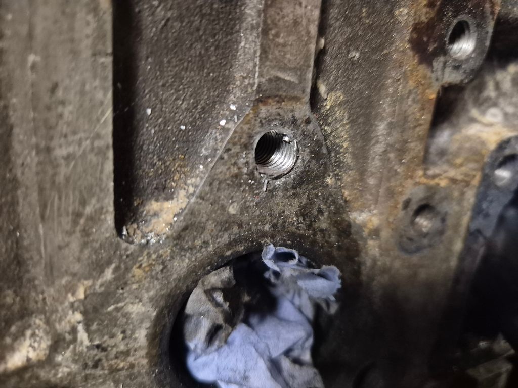

Of course the hole is now completely monged, so I went for an M12 timesert, with an M8 inner. Threaded...
Timesert in with loctite.
Cleaned up and new studs - what a palava.

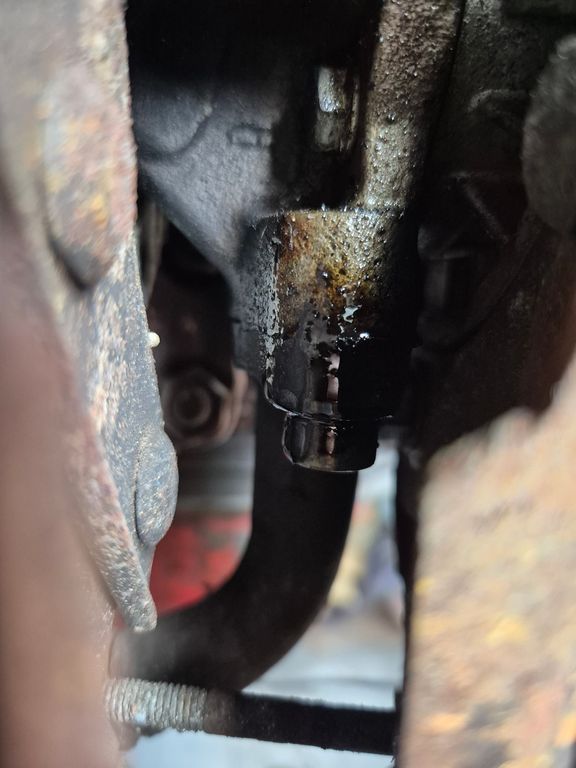

Found a turbo oil return leak while I was there, so fixed that too.
Back together
Guess what?
STILL BLOWING. Not as bad, but too much to ignore. What the actual hell.
DaveL485
  21T, 9T, Meglio, V6

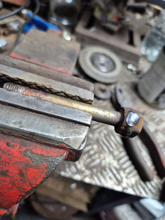

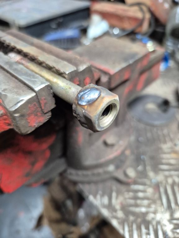

Sooooooooooo further digging and poking and listening and I found a missing bolt in the turbine housing, that bolts the core to the turbine housing. Of course, you couldnt get a bolt in there with it fitted because of the position of the castings...OF COURSE. Had to take the turbo core out!
The missing one was the one at 9 o'clock. Made a bolt for it (shortened an M8) and rebuilt it.
After this there was still a blow from the vband so I had to flatten off the mating faces and then, finally, it was acceptable for use. What a trial!

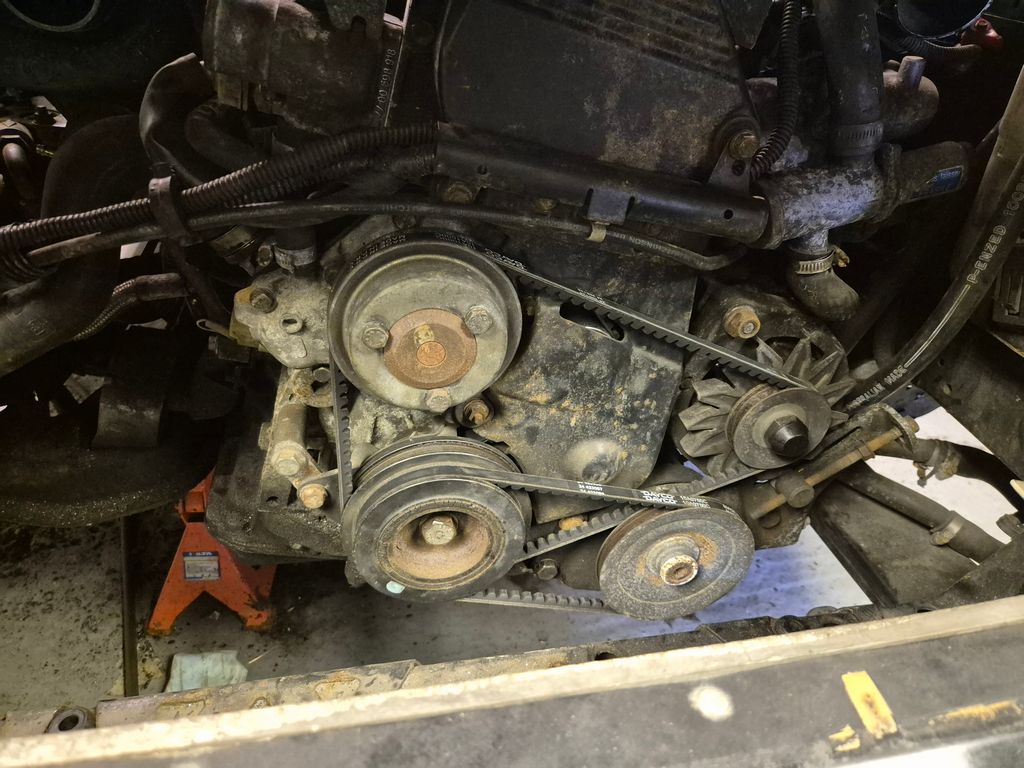

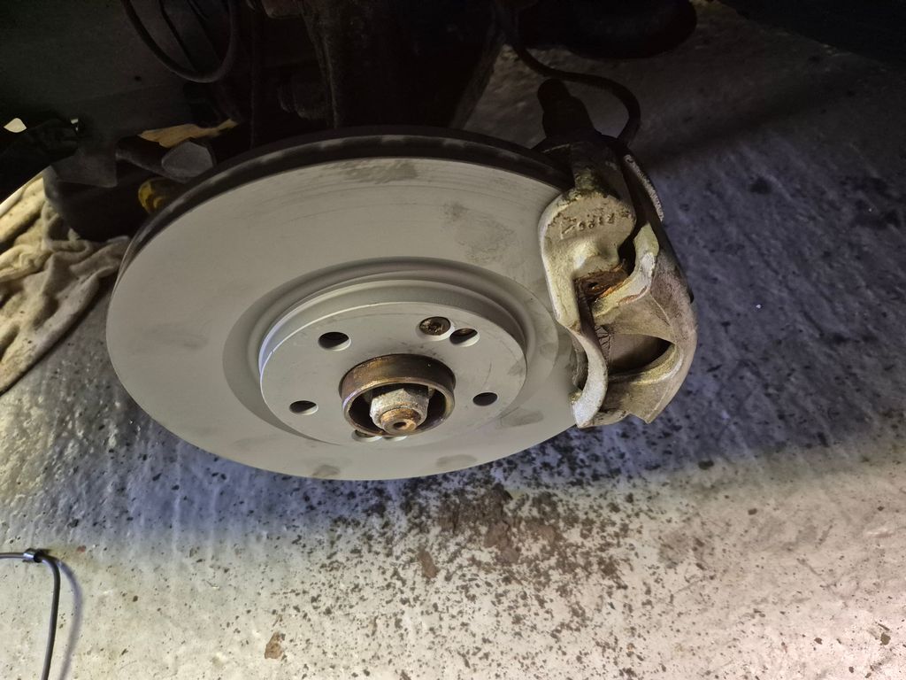

Oil, oil filter, air filter, PS fluid, brake fluid, gearbox oil, coolant. New discs and pads up front. New tyres. Belts (Cam, Aux and PS) and cambelt tensioner.

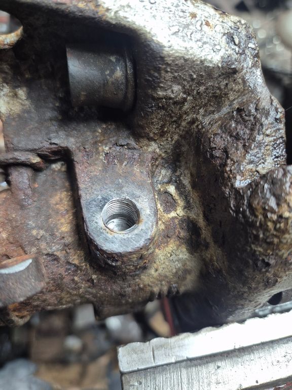

The torx fittings in the caliper hangers were f**ked as per usual so I modded them with 17mm hex's for easier future use.

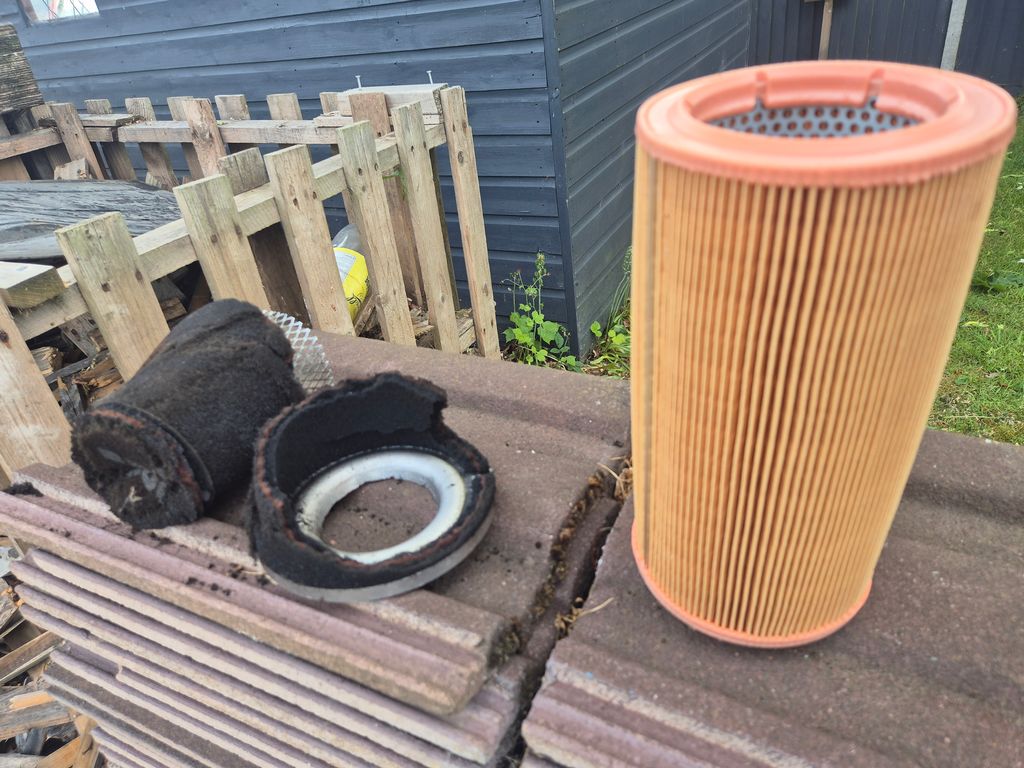

The air filter was a shitty tiny cone filter, why people fit these stupid things over the enormous OE air filter is beyond me. You need a BIG cone filter. I refitted the airbox and an oe filter.

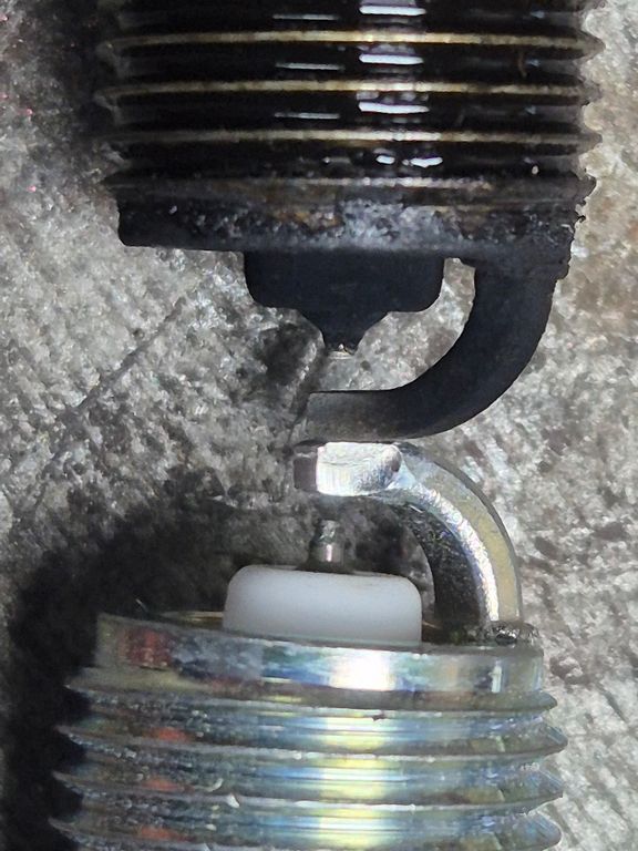

Plugs, NGK TR7IX gapped to .55mm
I didnt take any pics of the belts save this one when it was all done

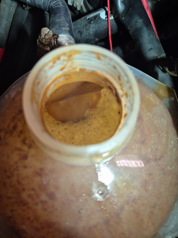

Cooling system is horrific, full of rust, its been left with no coolant in for some time by the looks of it. Bought some flush for it.

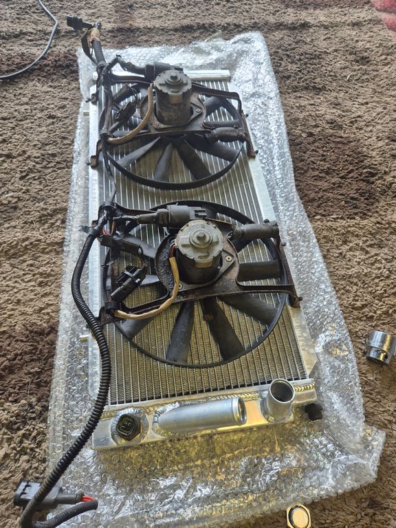

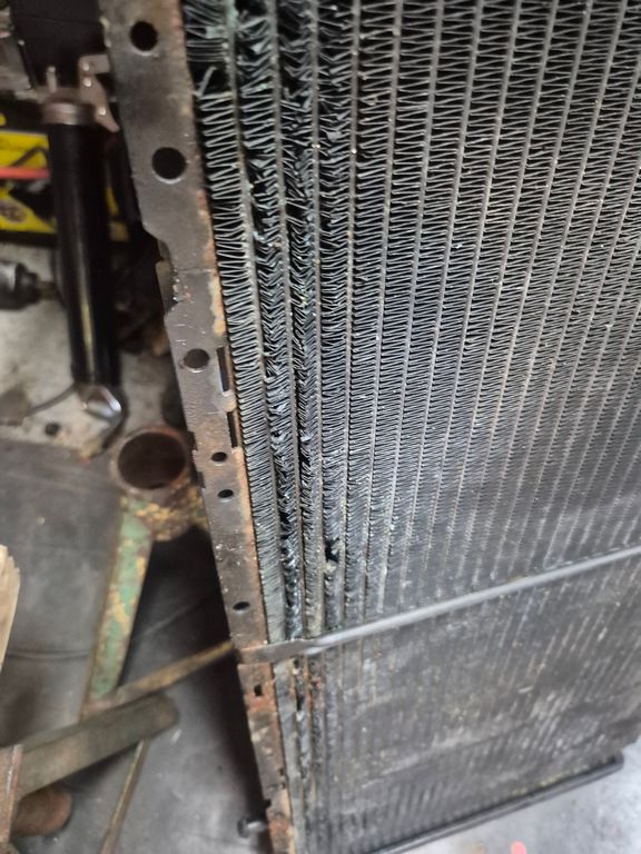

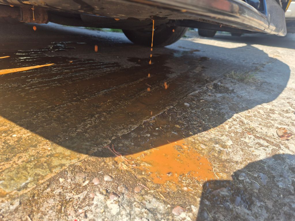

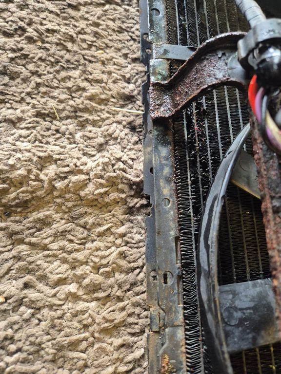

I got most of it done, then got the car outside to flush the rad, which went well. Ran it with the flush in and no thermostat. FLushed it through a few times and ran it up to temperature, the fans were due to come on, and in gratiture for all my efforts, it decided to burst the radiator. Brilliant.
Another call to poor Paul with the news, and we decided a new ally rad was the way forward so that was ordered.

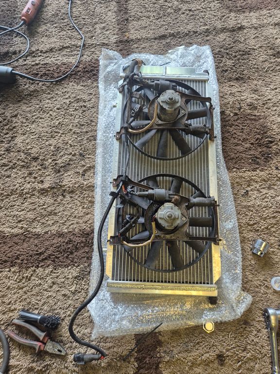

It showed up from China about 3 weeks earlier than expected, which was nice!
Spot the mistake.
DaveL485
  21T, 9T, Meglio, V6
Spot the mistake.
After i'd swapped the fans to the correct side (front) of the rad (lol), in it went.

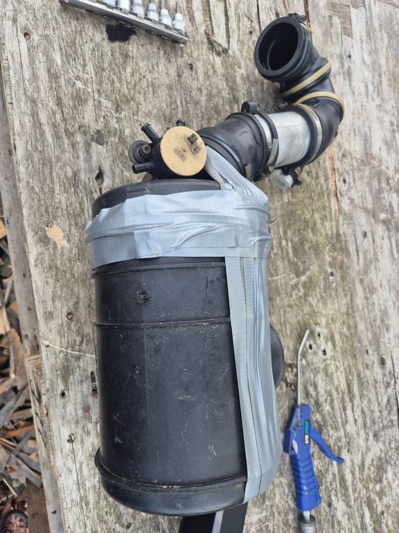

The old air filter box was in the boot, so I used it, the clips were all missing though so I gaffer taped it for now until I can get hold of some
Better

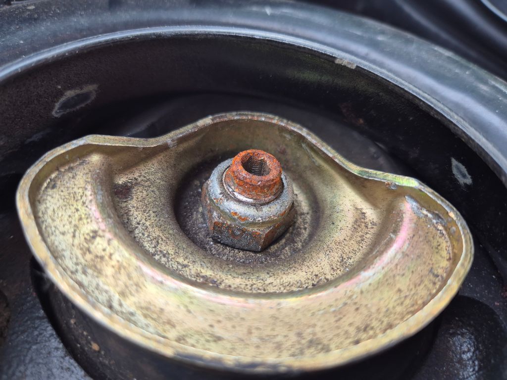

Brief test drive resulted in a very flat engine with no boost - someone didnt refit the actuator clip (duh) so resolved that and also found the source of the nasty knock on the passenger strut...loose topmount nut!
Before
After

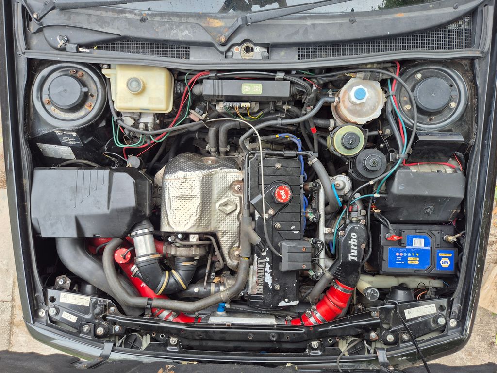

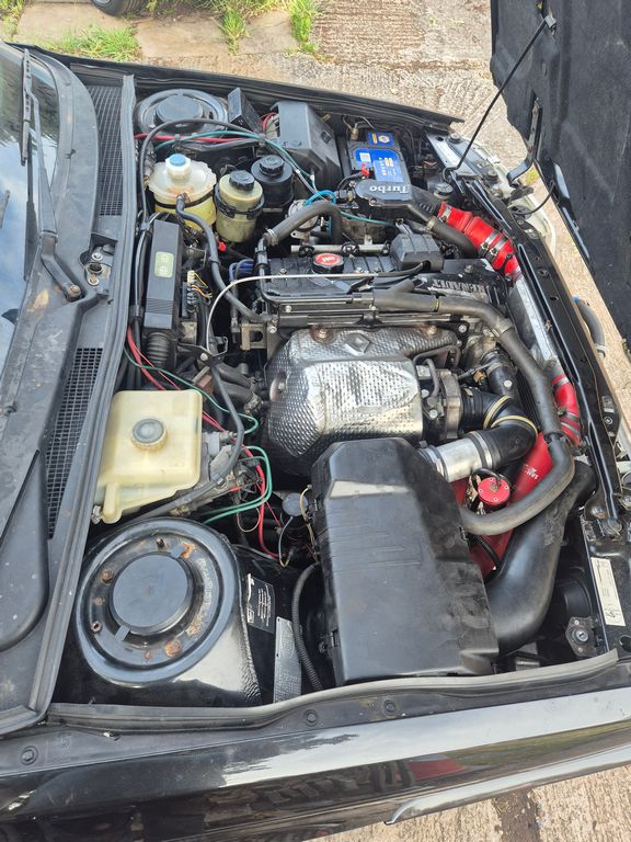

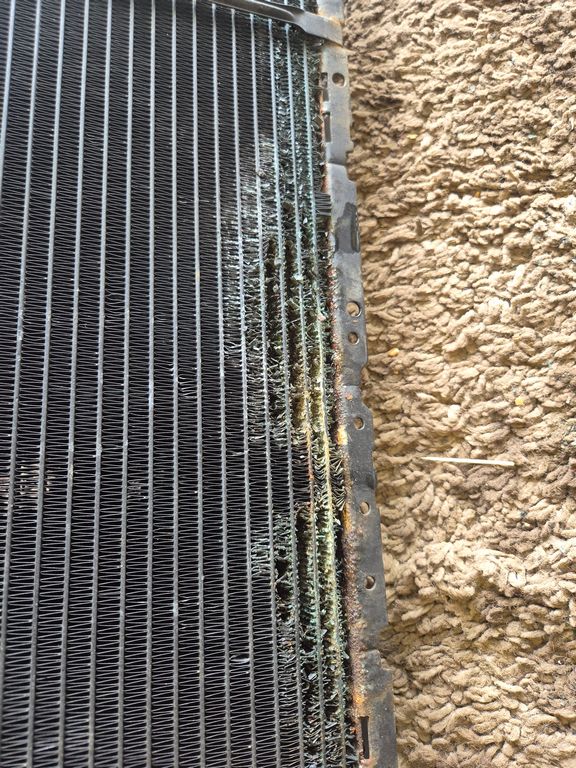

Ah, forgot, I had to trim the rad top down to fit the chargecooler too, it wouldnt quite fit. Not convinced on the chargecooler, it gets hotter then I would expect. More like a chargeheater!
DaveL485
  21T, 9T, Meglio, V6
Does it have an intercooler or a chargecooler as stock?
The OE car has 2 intercoolers, a fat one sat low in the OS front wing getting a nice cold air feed from the front bumper. The second one sits above the rad at the front. On this car, the second intercooler has been replaced with a chargecooler.
R3k1355
What's the heat exchanger like for the chargecooler? Vast majority of the time when people try to do an aftermarket chargecooler conversion they massively underspec the heat exchanger, think using something similar to an oil cooler will be sufficient.
Its basically an oil cooler thing. I'm not keen, but its not my problem tbh, i'll leave that to the owner to sort :)

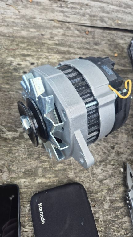

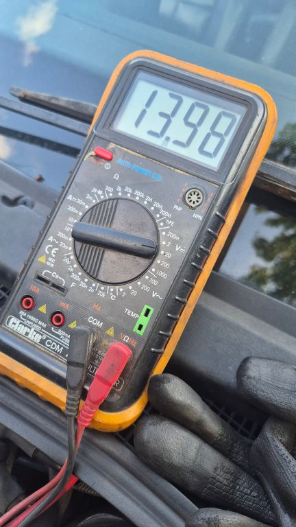

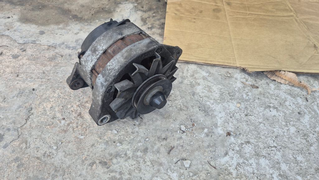

BIBLICAL rain on the way, and had to turn on lights, fan, wipers...this revealed a sickly alternator! It passed the MOT though so i've ordered the alternator, once thats here it can go home :)
DaveL485
  21T, 9T, Meglio, V6
Alternator done

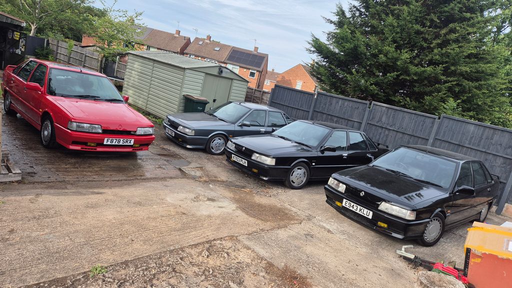

Before it goes home I lined them all up for a quick snap
Of course, not forgetting my Quadra which is the only one of the 5 that doesnt run and drive on the key.
