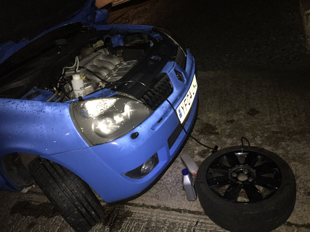

It's been quite a while since I updated this thread as I walked away from fixing it up for a while. I found myself under the car, bleeding brake lines in December, in the dark and cold. There wasn't much fun to be had skinning my knuckles by portable floodlight so I quit for the winter.
After trying half a dozen times to bleed the air out of the brakes using an Eezibleed and failing it turns out the RStuner module for bleeding the brakes via the ABS tuner is awesome, albeit not the cheapest option.

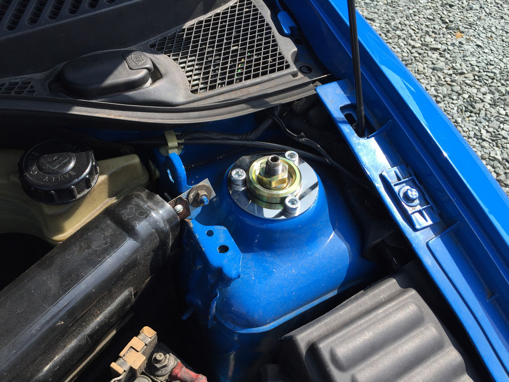

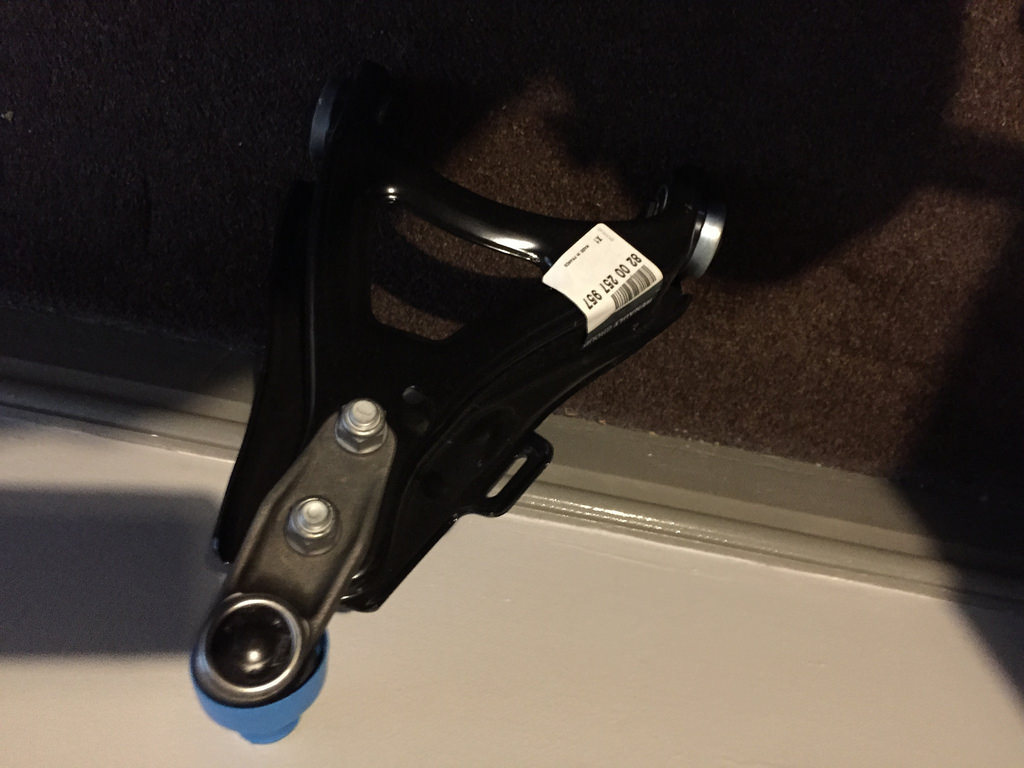

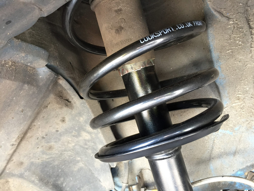

I started again in the summer - time for a suspension overhaul.
The steering has always been vague in the centre and replacing the steering rack bushes hadn't cured it. As the car is intended for track days (if it's ever roadworthy enough..) it's now fitted with PMS top mounts, standard Cup dampers, new wishbones and Cook sport springs.
The car felt better but not quite there. The only thing left was the Anti-Roll bar bushes and it looked like a nightmare job. My local garage fitted them for me (he sweared a lot when I picked it up, muttering about access and clamps..). The steering is now awesome, much more connected to the road.

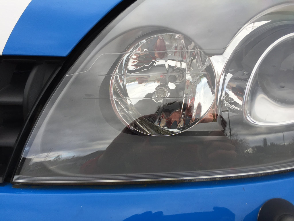

Front position lamp incorrect colour (nearside and offside)
Headlamp not working on dipped beam (nearside and offside)

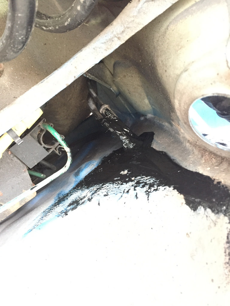

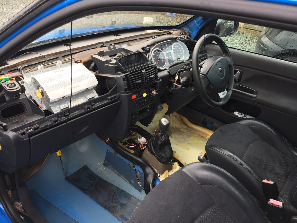

As the car has persistent leak problems that were getting worse (the passenger footwell was full of water), the car was stripped down on the drive - carpets and underlay out, dash top off.
It was a nightmare sourcing the leak - water seems to go wherever it feels like - so it's tricky to find the source. In this case it was multiple leaks, mainly the bottom of the windscreen and a bad grommet on the rear windscreen washer pipe through the bulkhead. The windscreen had developed a bad crack anyway so that was replaced by Autoglass. As a precaution I put tigerseal around any entry to the cabin I could find. Not the neatest job but so far it seems to be working! This is just behind the scuttle drainhole on the near-side:

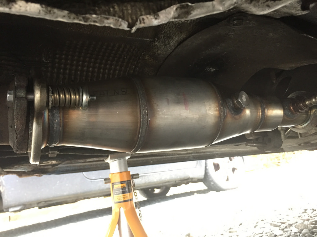

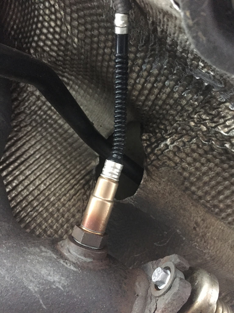

Next job was the emissions. The cat that was on it was put on just before I bought the car but was a cheap ebay one. Still seems like it should have lasted way longer so this is a bit concerning. I installed a KTR sports cat and a new Bosch lambda. This is my biggest worry now for when it goes for a new MOT. The engine runs sweet but does use a bit of oil.
Getting the old lambda off ranks up there with the most hated jobs this car has to offer. The neighbor did not seem impressed with the language coming from under the car.

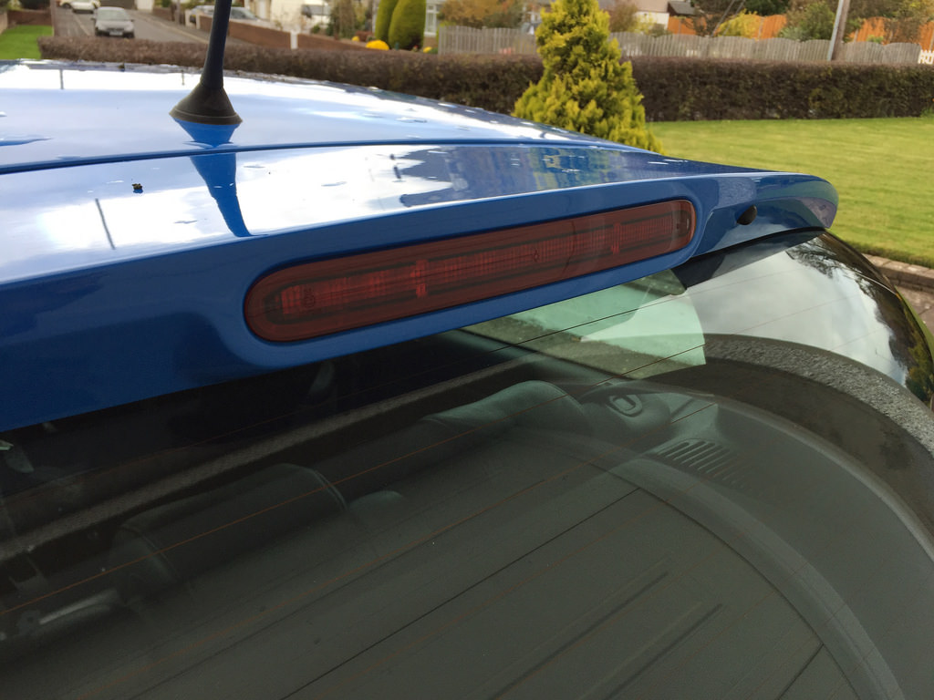

And a new rear spoiler brake light unit:

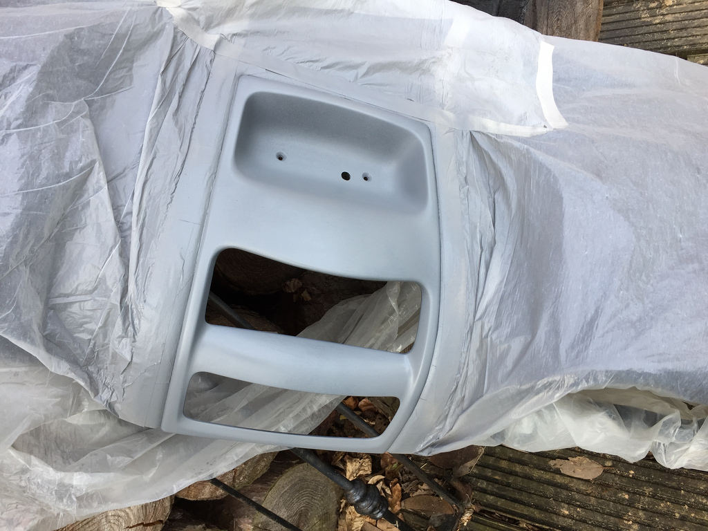

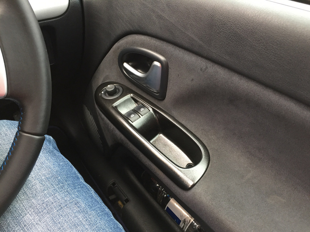

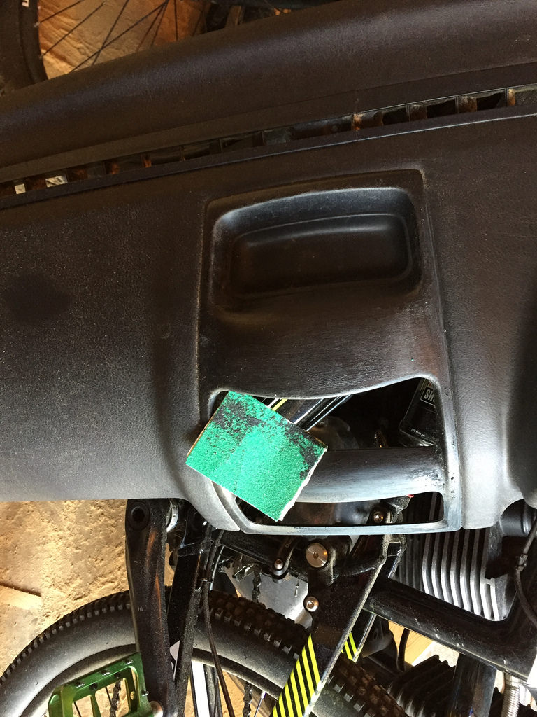

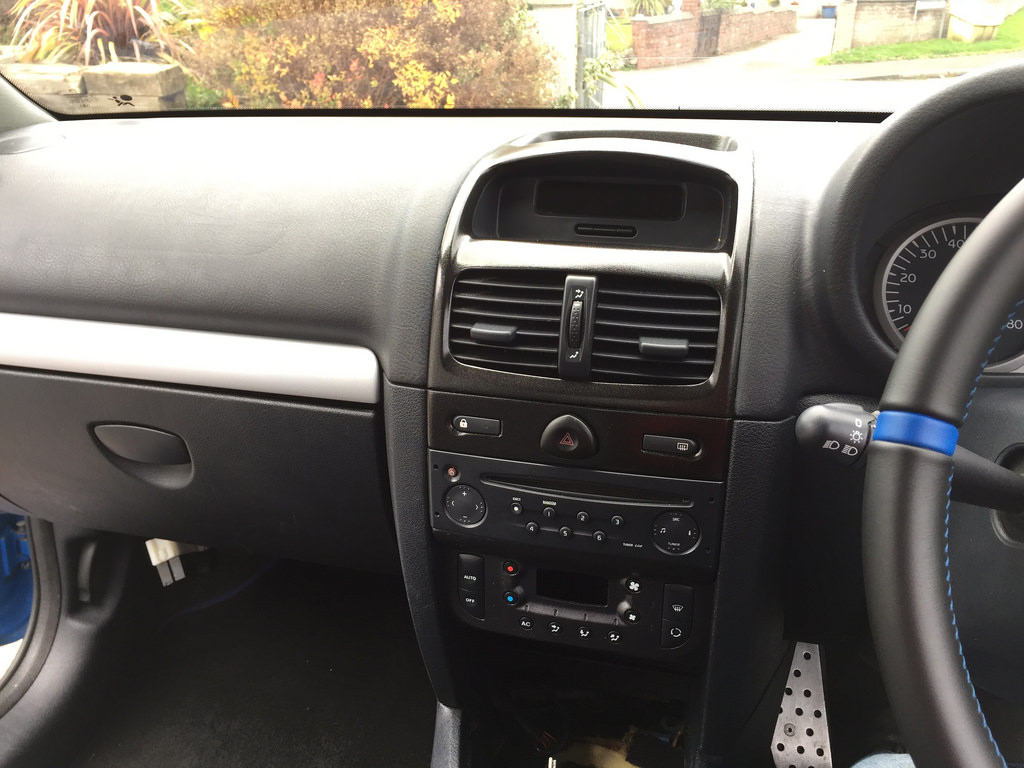

As the dash was out it felt like a good time to sort out the paint on the dash and the door handles. These have gone sticky with age so I attacked it with 60 grit sandpaper first:

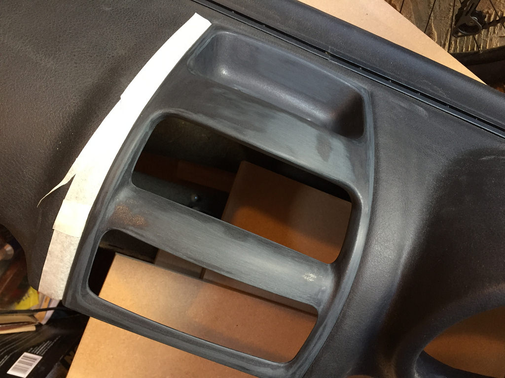

This did not work at all, the paper just gums up straight away. After a bit of googling people seemed to recommend tar remover so I tried this. Much better although it still took a fair bit of time. I also thought the centre section of the dash above would have been removable but on mine it seemed to be fixed so I had to mask off before painting.
Bit of plastic primer:
And back in the car:
The colour is not the same as standard but it's as close as I could find. There's a few coats of lacquer on too so hopefully it's be hard-wearing enough. I'll be putting a new stereo in soon so the colour clash should hopefully be broken up a bit. You might also have seen the relays hanging down on the passenger side. The leak from the windscreen had soaked the UCH module that controls the lights/indicators etc. This had been repaired once already and is under warranty but I wouldn't think water ingress would be covered - it's not the repairers fault after all.

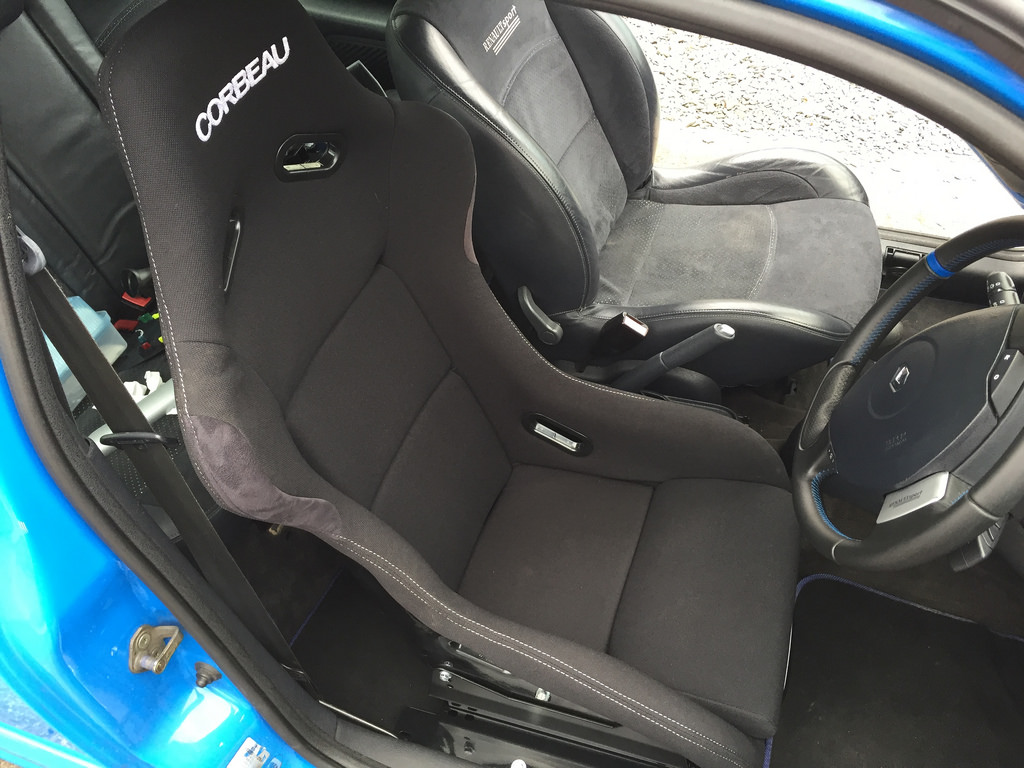

A Corbeau Clubsport seat was installed (drivers side only as I have to give a couple of mates a lift to work sometimes so the passenger tilt seat is still needed) with one of Jon Foz's subframes. Superb piece of kit the subframe - no issues at all installing and very well made.

  Titanium 182 FF
Looks ace!
What paint did you use for the grab handles/dash as mine are in a state but want something oem'ish looking like those! and secondly how do you find using the clubsport's with standard seat belts?
Lovely looking car. Same as my old one with the stripes, but much more care and attention on yours than mine ever got!
  RenaultSport Clio 182
Looks ace!
I used this stuff:
It's hard to get a picture to show how the colour looks. The photo above of the door release and handle shows the difference between the original colour and the paint but it's not that close a match. The dash picture (hazard light panel and the stereo) shows the difference more accurately.
The Clubsport seat is the standard size, not the large and the belt sits snugly across me just fine. I'm a 32 waist and the seat is a snug fit. It may need to be routed through the hole for the MOT, I'm not sure yet.

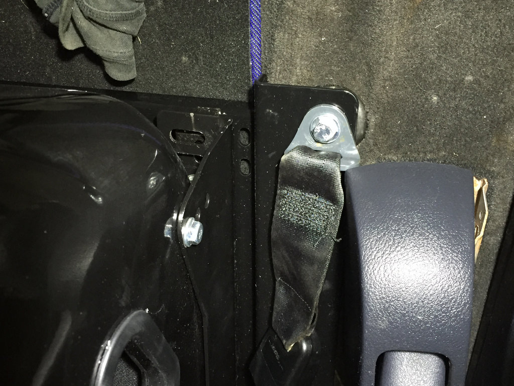

Picked up a Peugot 106 rear seat belt buckle on eBay. It's held in place on the rear subframe bolt, I'll post a pic up tomorrow when there's some light. It lies flat on the floor when not in use so you do have to reach down a bit further to get it but it's not much of a stretch.

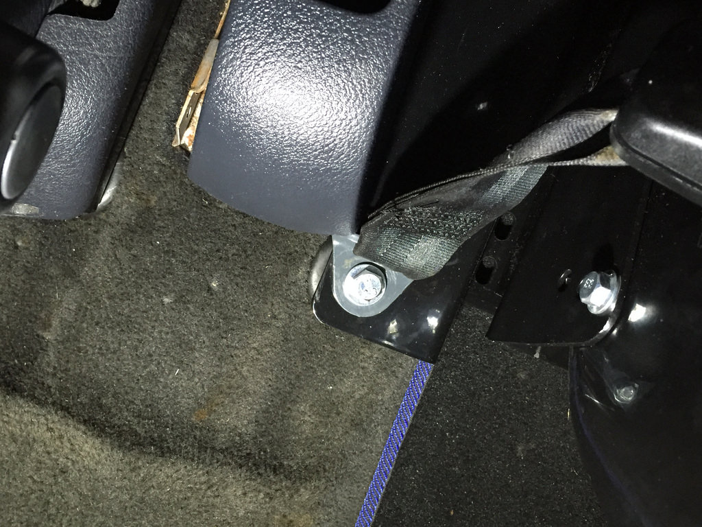

Took a couple of pictures of how the 106 rear belt is attached. Poor quality sorry as it's so dark out at the moment - they are took under portable floodlight!
This angle is from the back looking forward - it's attached to the rear subframe mounting bolt and the rear of the (not fully attached) handbrake surround can be seen to the left of the bolt:
This is looking straight down the back of the seat facing the other way:
The belt will just stretch to fit in the seat harness hole but when sat in the seat it's such a snug fit you can't easily get the belt to the opening. It does clamp you in still by fastening the belt over the top of the seat however.
Hope it helps.

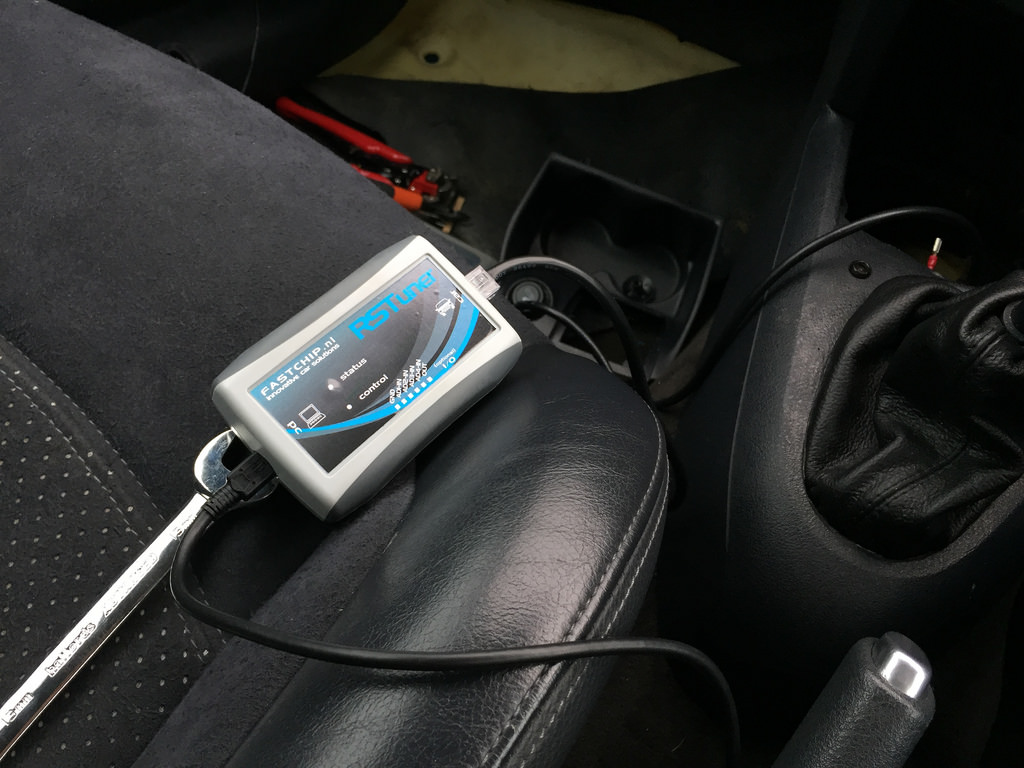

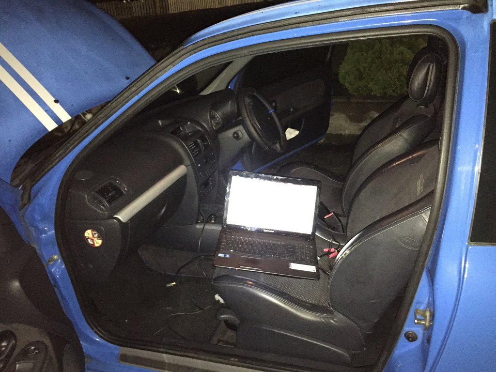

Finished the small MOT jobs today (checking lights, horn etc..) and cleared the code for the Airbag warning light since changing the drivers seat using the RS Tuner.

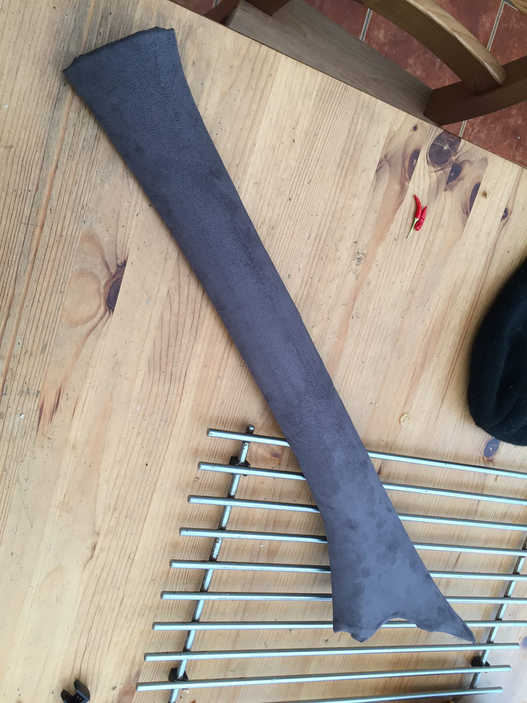

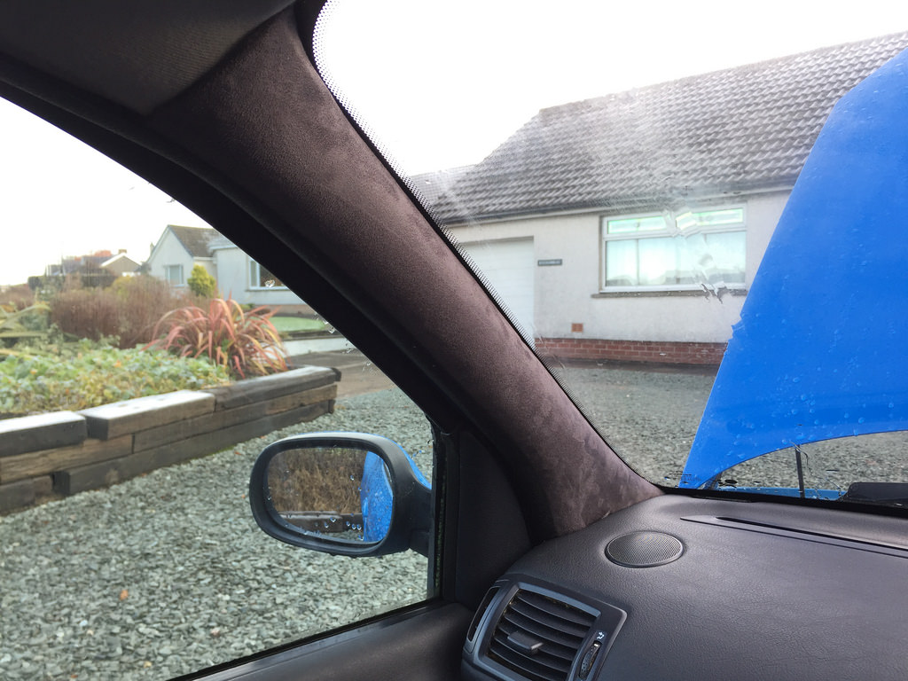

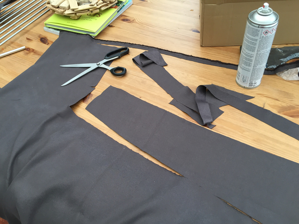

Also trimmed the A Pillars. Didn't use the genuine Alcantara but the cheaper version worked pretty well. Definitely fancy doing the roof lining next.

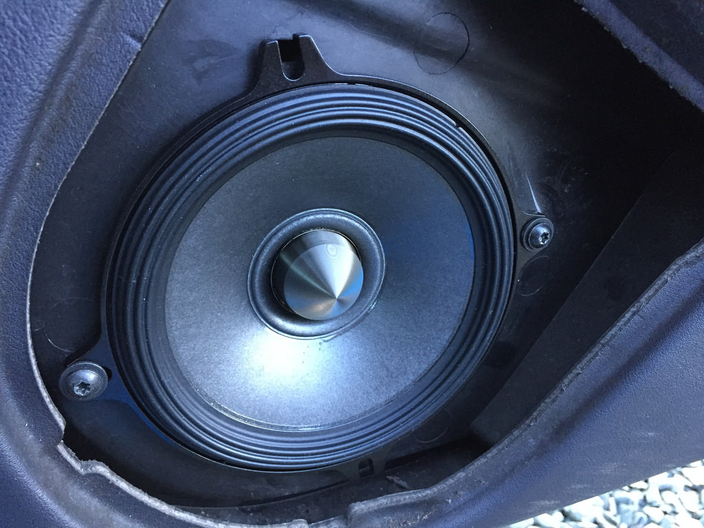

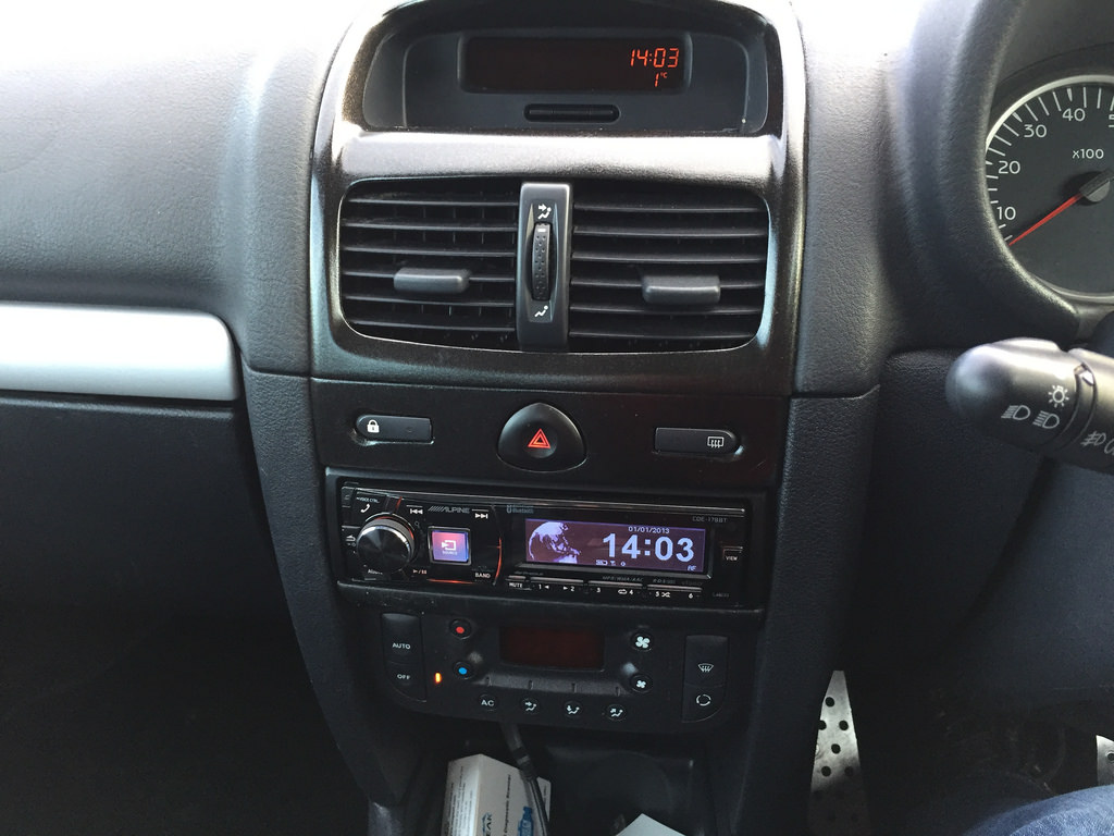

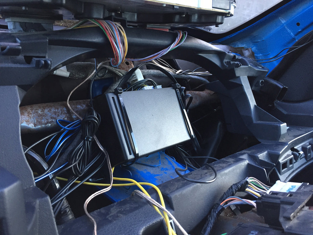

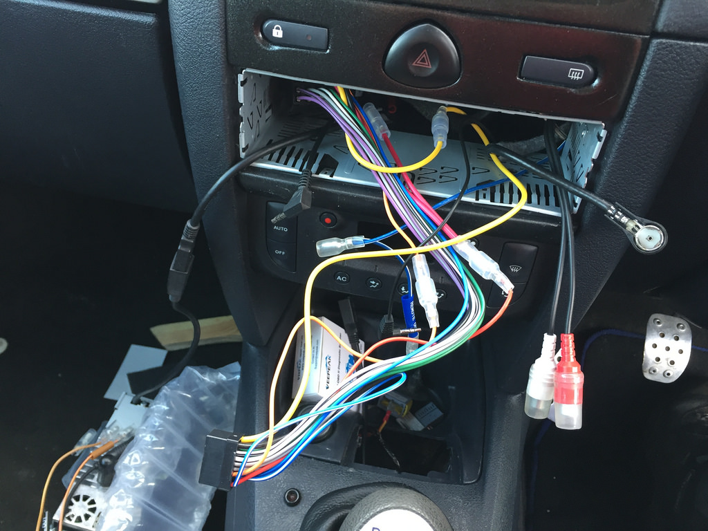

Then installed an Alpine head unit, front speakers and subwoofer from an excellent thread I saw on here. Didn't go as far as that one (no rears changed or in-line amp used) but the sound already is loads better. There are no more rattles from the doors and now have bluetooth to save carting loads of CD's around.
The subwoofer control box fit nicely behind the clocks.
Although fitting all the leads (including a Connects2 lead to retain the steering controls) was a challenge.
The cables do push over to the left of the head unit so it eventually all fit in nicely. The Connects2 lead hasn't worked with the display and steering control however, so I still need to check that out (got the update '005' version so it should work?)

Did the RS Tuner clear the SERV and airbag lights?
What else does the RS Tuner do? Not really explored it before...

The RS Tuner did clear the SERV light that was caused by the airbag although you do have to purchase the airbag add on for the module from the website. I also used it with the ABS add on to bleed the brakes. It's been a brilliant bit of kit and I haven't even loaded the remap from it yet which is what most use it for I think.

What suedette is that mate? Got a link? Looks a really good colour!
I bought the material on EBay. Ive just looked for the link and can't find it, I wish I could though as I want more to do the roof lining! I'll keep searching and post it up if I recognise it though.
