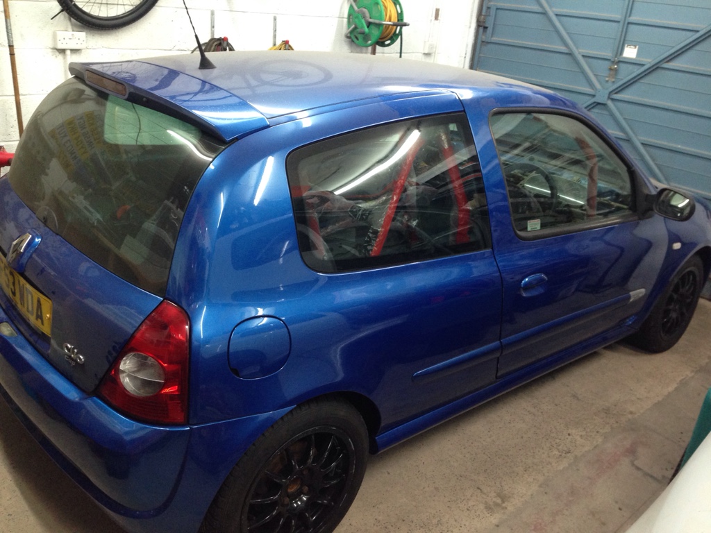

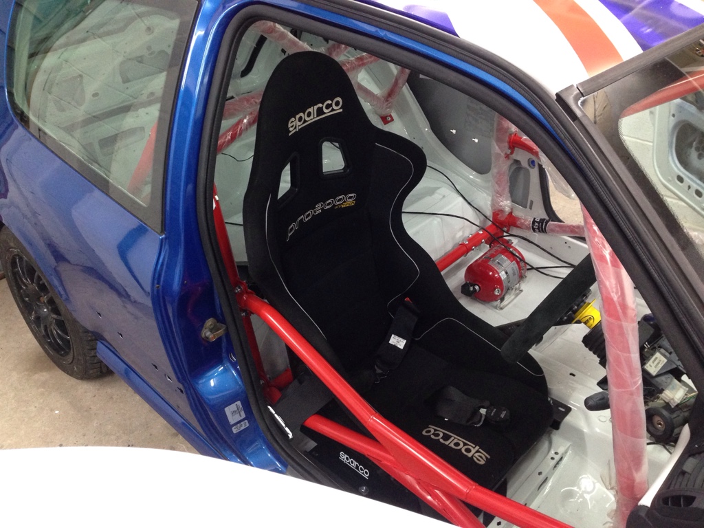

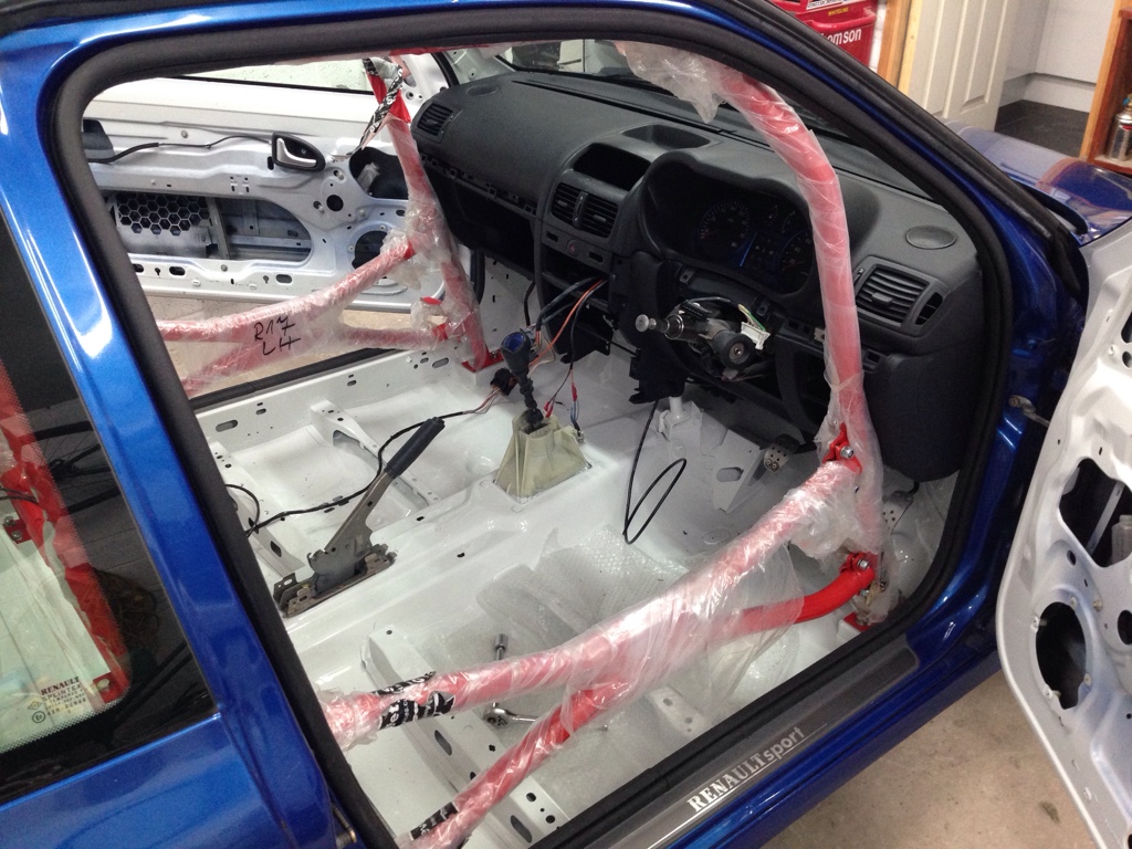

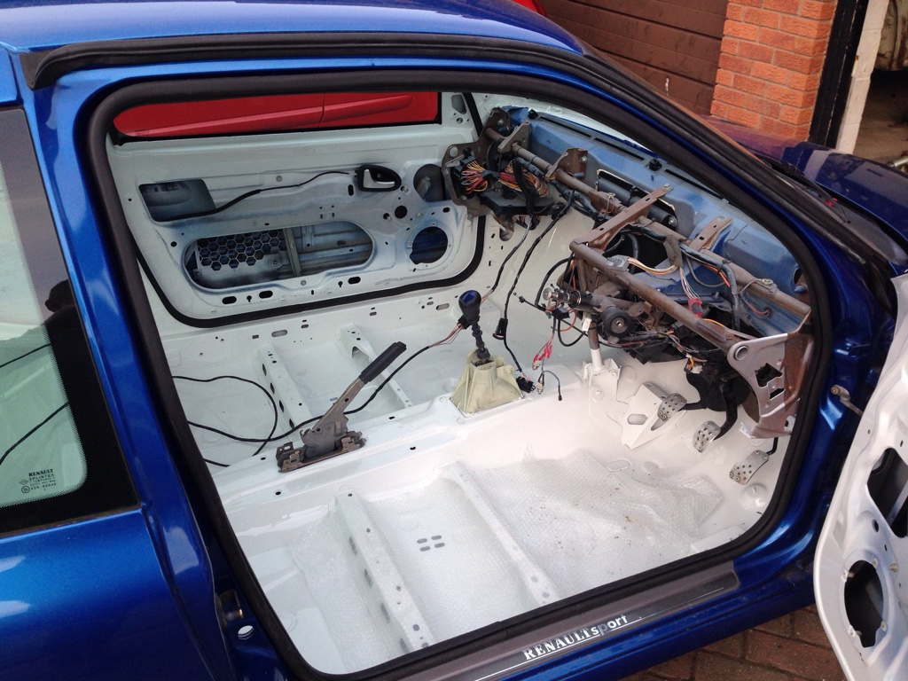

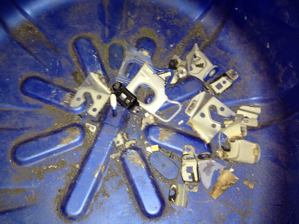

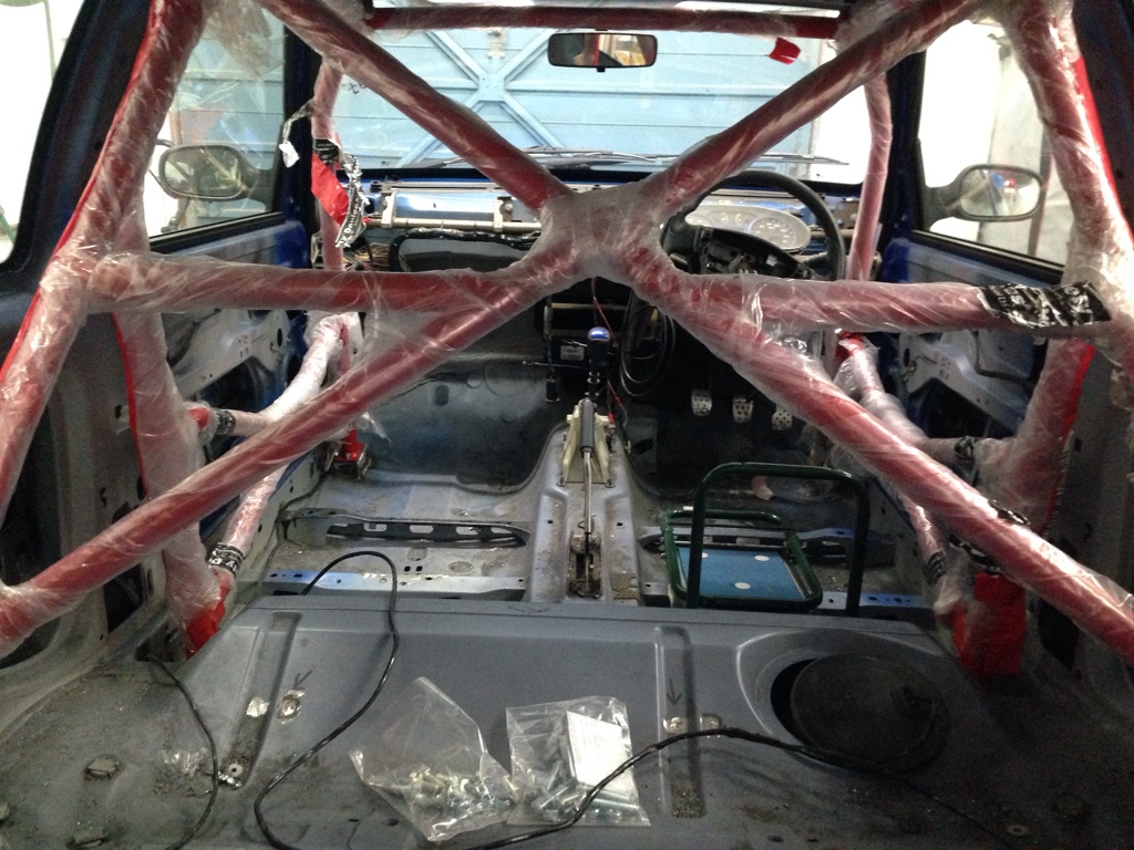

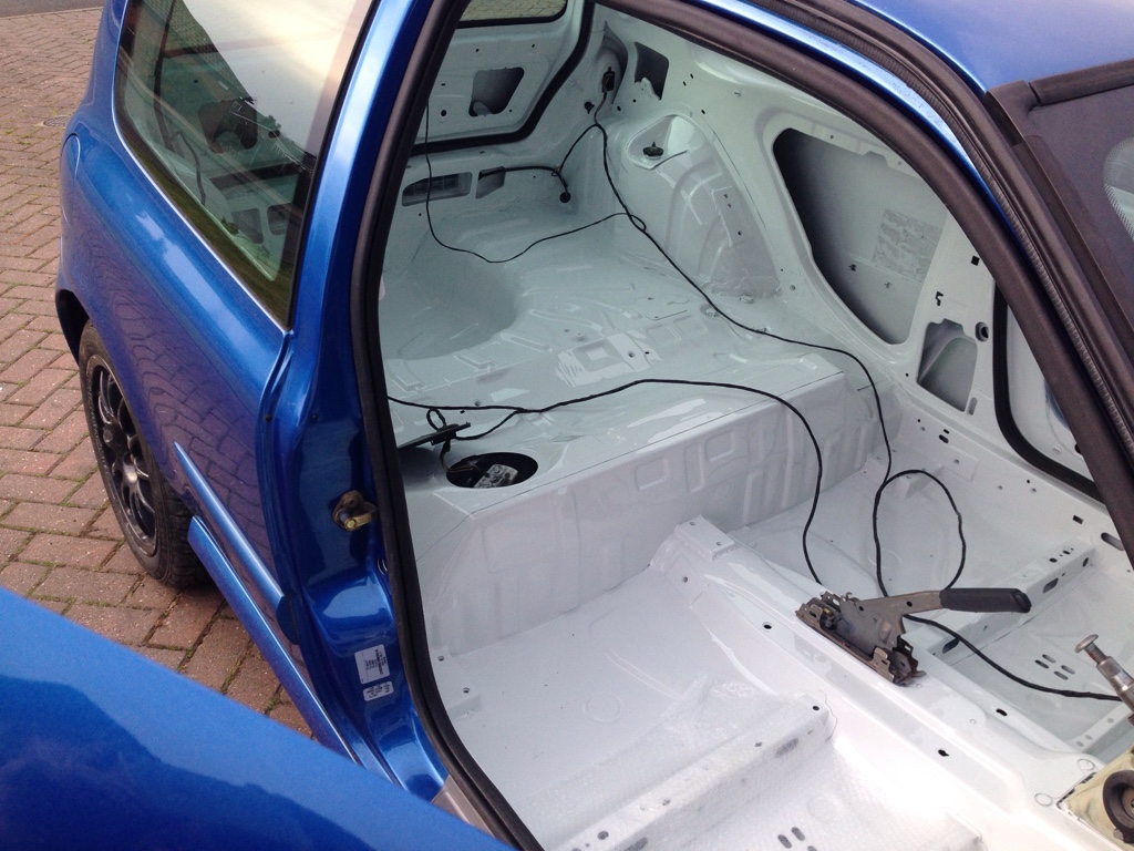

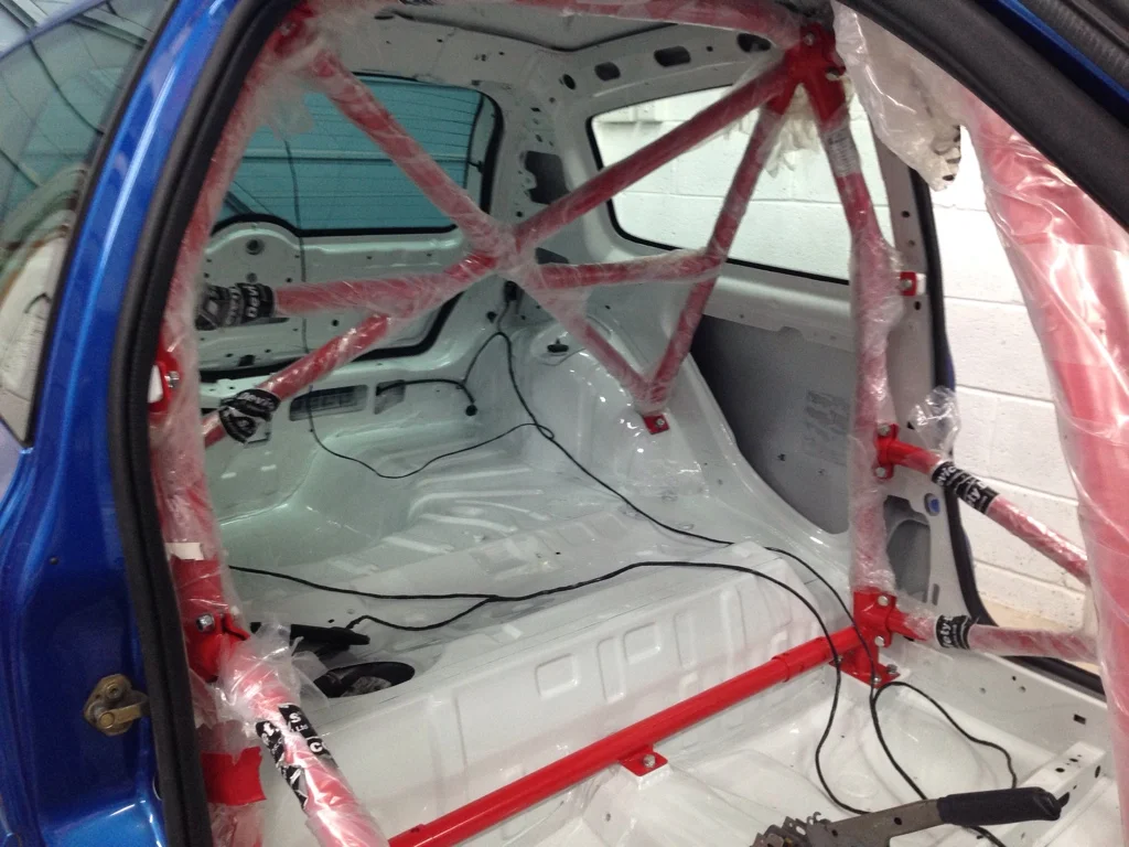

Got the car back with its cage fitted, it does need to come back out to paint the inside next week but all the welding is done including the harness plates.
I'll get it out tomorrow and give it all a clean up and stock some primer on the bare metal. Removed the rest of the brackets too.
Just have a couple of small pieces of sound deadening to remove and it's ready to paint.

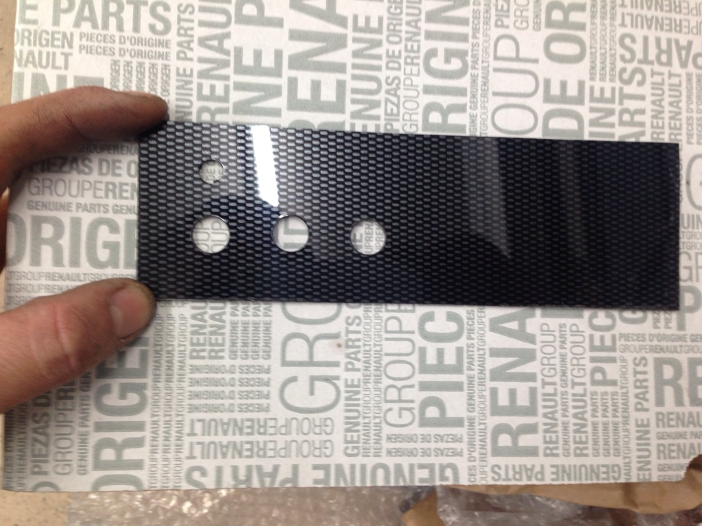

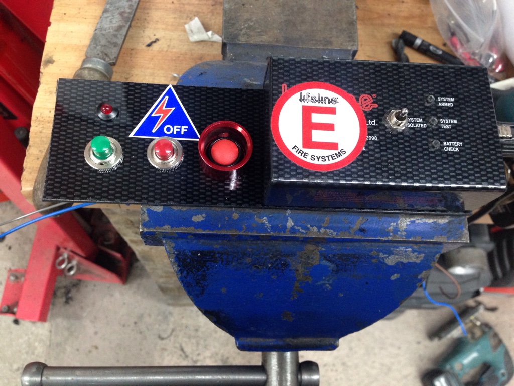

Managed to make a blank for the radio hole in the dash as well to house the electric extinguisher box and internal button + the controls for the battery cut off.

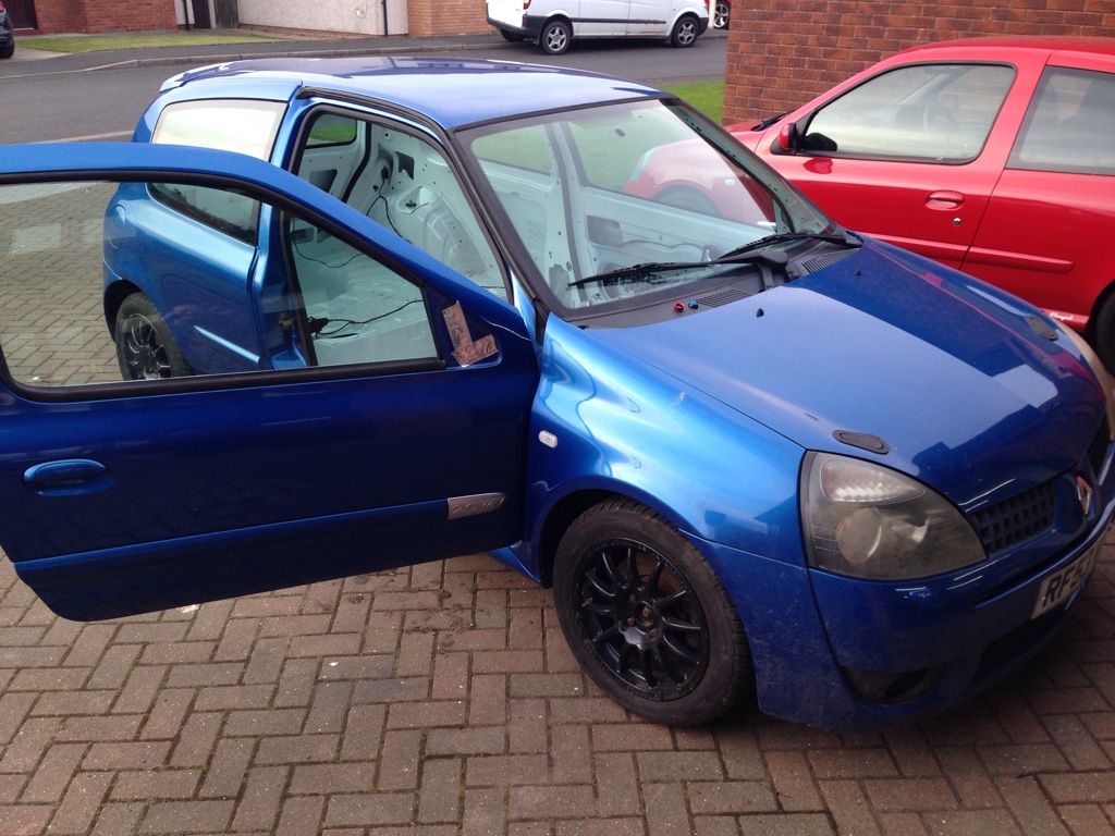

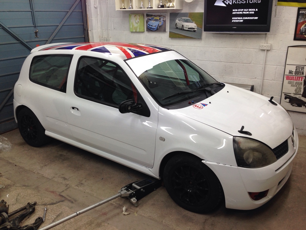

Have had the car back for a few weeks from paint but been too busy to do anything with it.

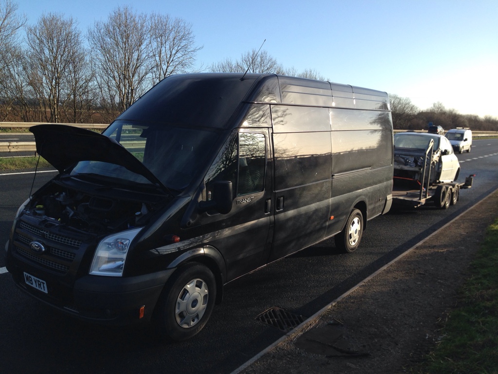

Was supposed to be spectating at the opening round of the Tricolore Trophy yesterday at Snetterton but my new van decided to blow its self up on the A64 just outside York.
Unconfirmed atm but it's not looking good, can't fault AA recovery for the van and trailer back to Carlisle. Was supposed to be dropping a shell off at Snet as well hence the trailer.
Anyway, thought I'd cheer myself up by getting some jobs done on the 172 seen as its all painted.

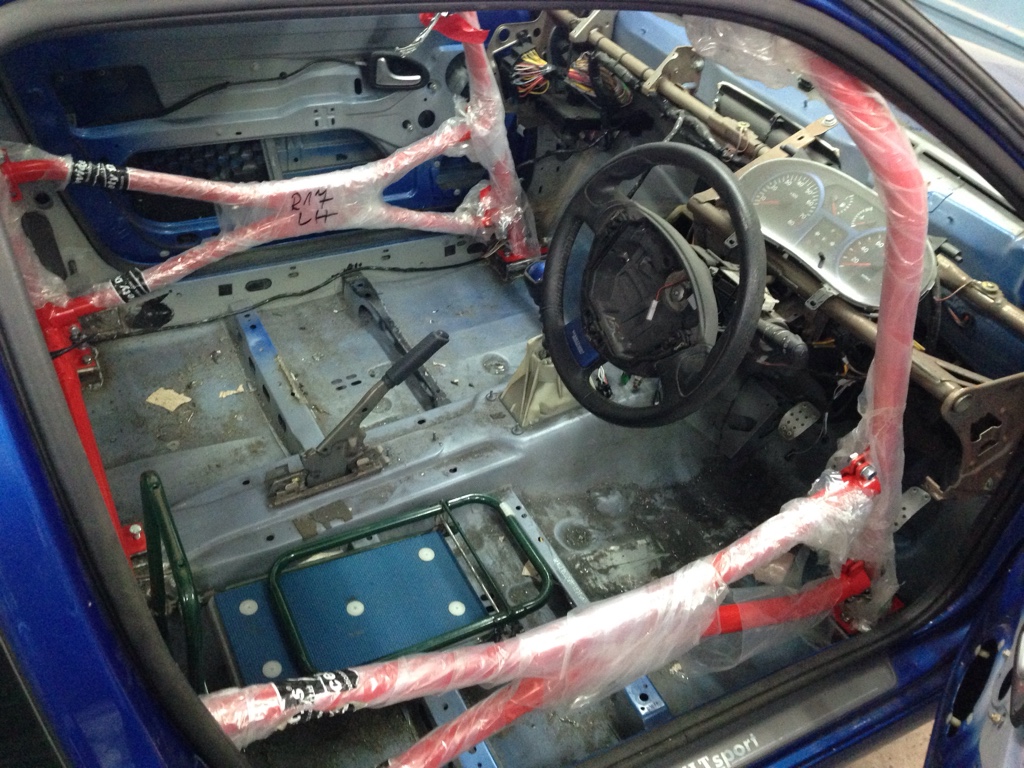

Got the dash put back in top and bottom and started refitting the cage. So much easier to fit than the 197 one.
Just got all the bolts to torque up and the 2 sleeves on the tunnel brace to drill and bolt and it's done.
Should hopefully get part of the car wrapped today too so we're getting there, oh and I've bought another Honda too, more details on that coming soon!

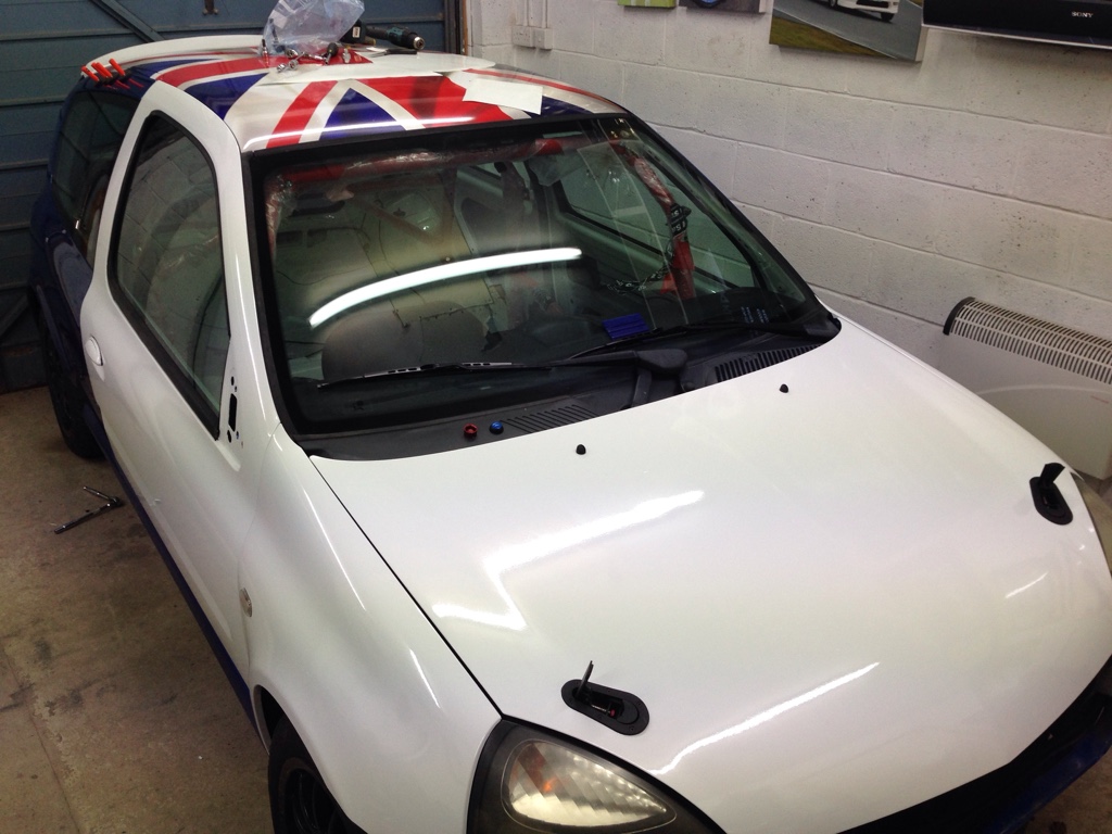

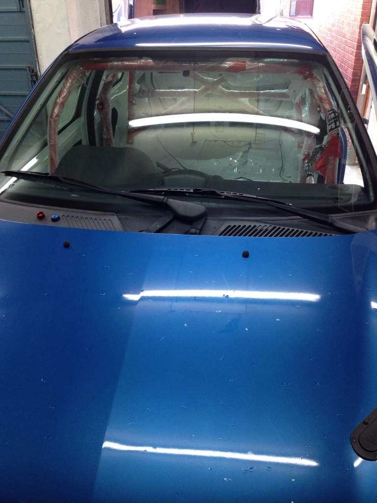

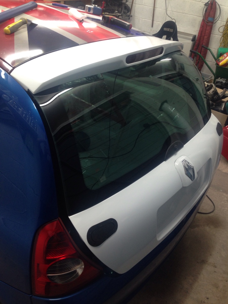

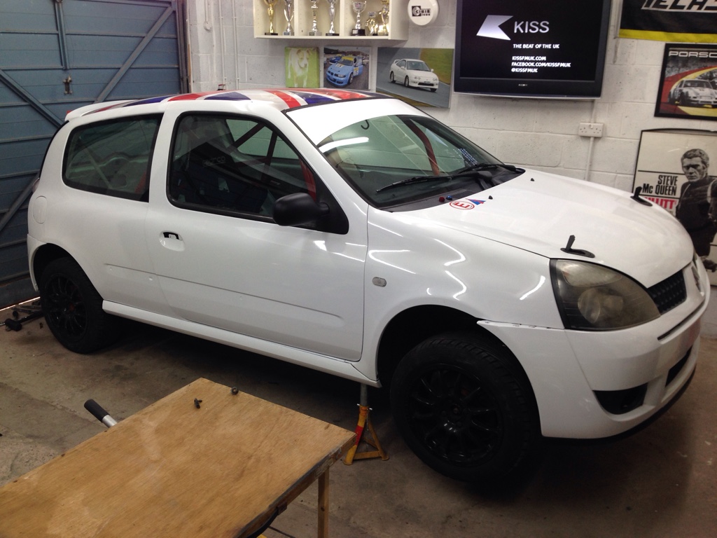

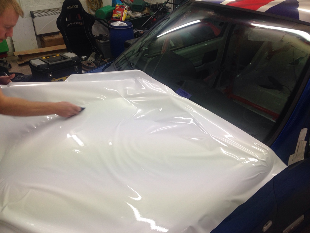

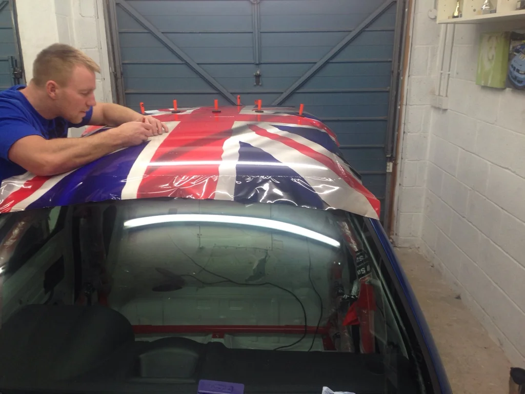

Got a fair bit done, bonnet, boot, roof, both front wings and drivers door.

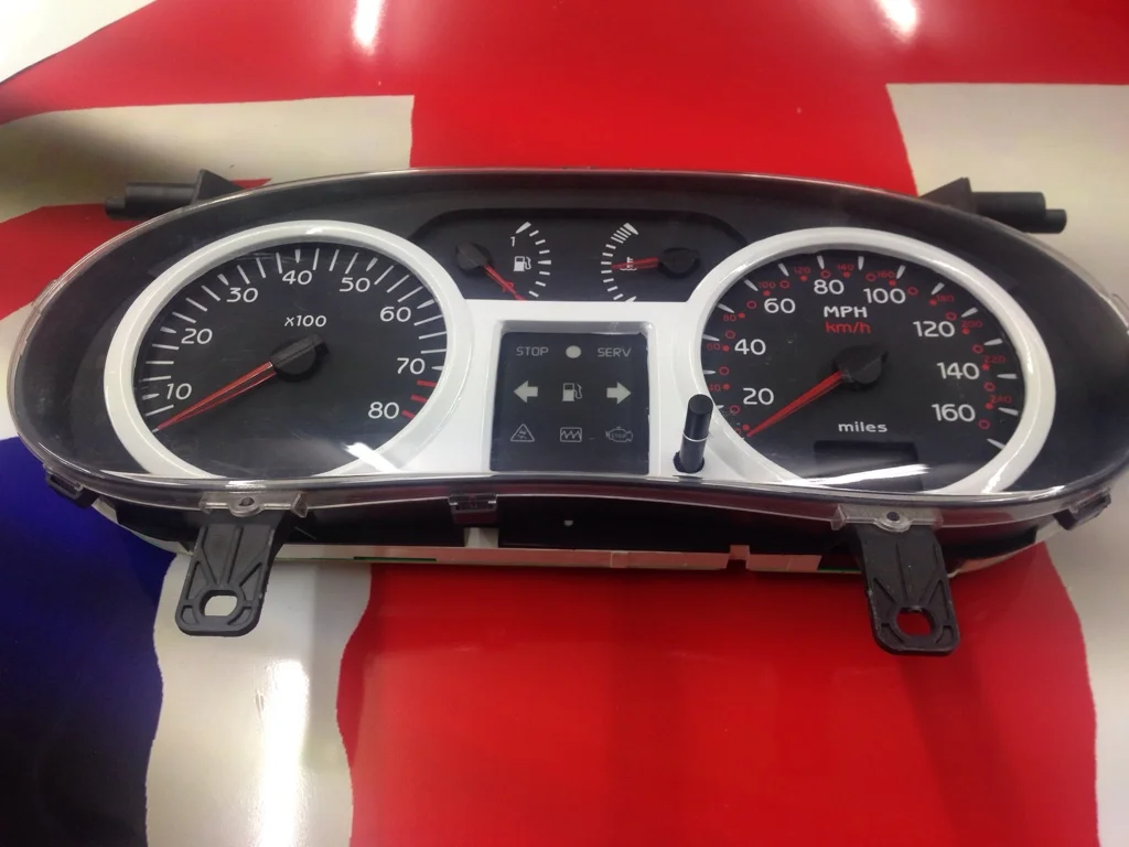

Also wrapped all the blue 'Cup' trim inside. Both dash strips and the instrument cluster trim.
Just on with finishing inside now and will get the rest wrapped this week when my mate, read professional, is back to help!

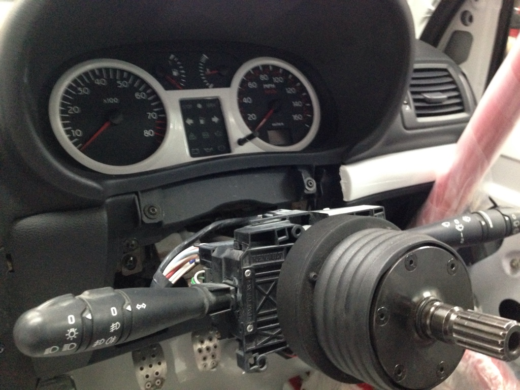

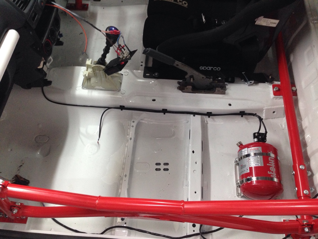

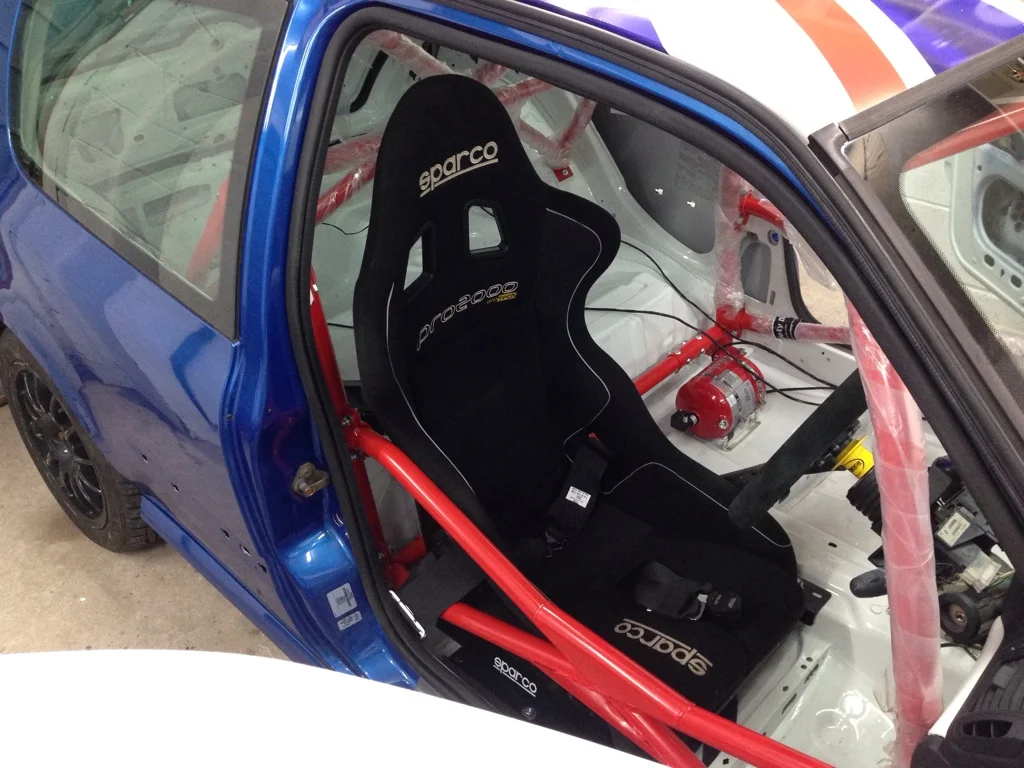

Got the seat, subframe and harness fitted before I called it a day.
Jobs for tomorrow are fit passenger side subframe, bolt down extinguisher and finish plumbing. Will try and get the wiring routed and the dash panel fitted one night as well.

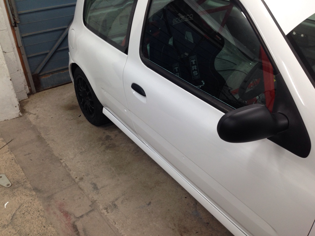

Finished wrapping
Need to get the side trims, handles and mirror backs painted and refitted.
Got the extinguisher mounted and plumbed, just got some of the wiring to finish.

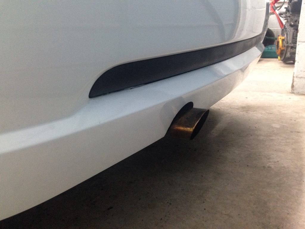

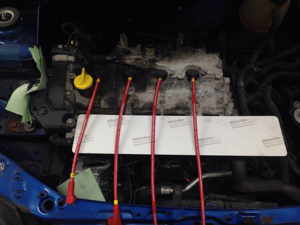

I'm currently fitting the exhaust, I'd forgot what an absolute sh1t job that is with a 172 manifold, if I ever find the person that designed that they're in trouble! I did manage to fit a new set of genuine injectors, plugs and lambda sensor along with a set of magnecor leads I had from my other car.

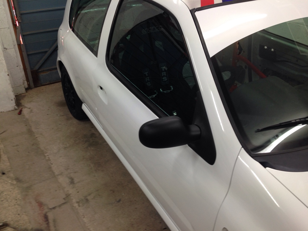

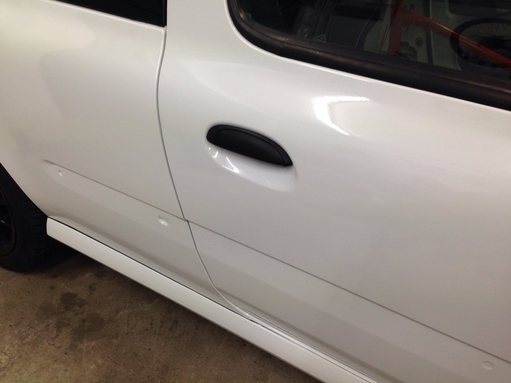

Not a lot to report, in the process of painting my side trims and door handles matt black.
Got the mirrors done and fitted.

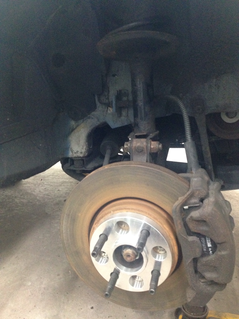

Managed to find a spare set of front shocks and springs to keep it mobile. While swapping it all around I put the PMS front wheel spacers and stud kit on.
Fitted my Evol lower engine mount and PMS shifter kit then fitted the rest of my PMS exhaust off my old car with new 172 specific front pipe. Got the bumper cut out to suit and doesn't look too bad.

Oh and the van is properly dead, turns out it's not an injector fault, suspect one of the Pistons is cracked/holed and the cylinder is full of oil. Common issue apparently, new motor required.
