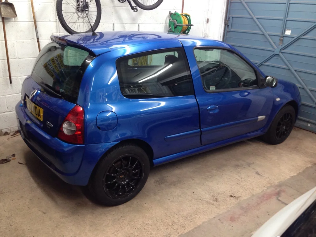

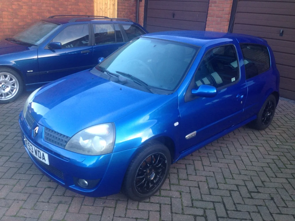

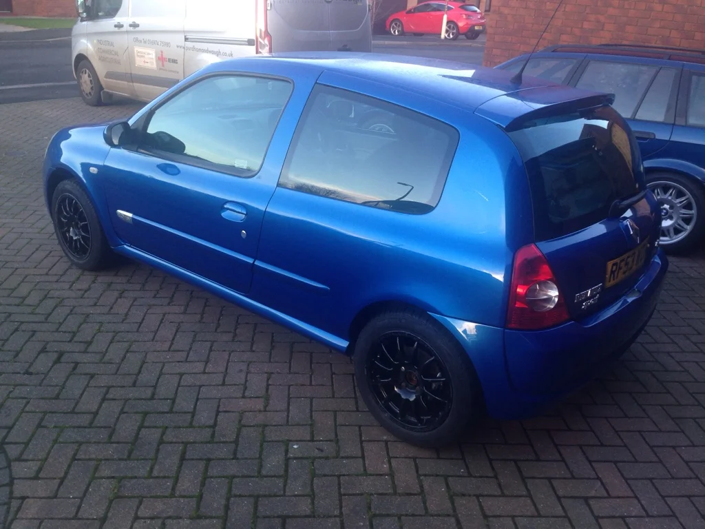

The car itself I took in part ex for my other race car and was essentially a nice standard 53 plate 172 Cup with low mileage, perfect!
First things first was the sale of the turinis, I kept 3 out 4 sets of wheels from my other car so chucked a set of Pro race 1.2's on for now.

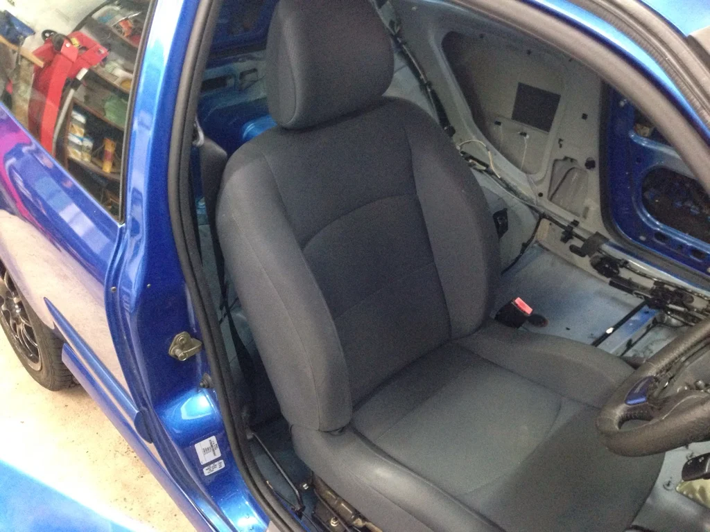

Safety devices multipoint cage is on order eta middle of January. So main jobs for now are interior prep, wiring loom strip down etc.
Had an awful job to sort first though, heater matrix replacement, worst job in the world. Got the dash all stripped out.
After an eternity got the heater unit out and the core changed. Stripped all the sound deadening out from behind there too.

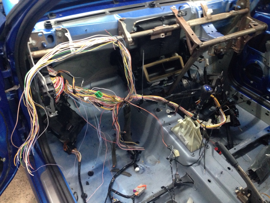

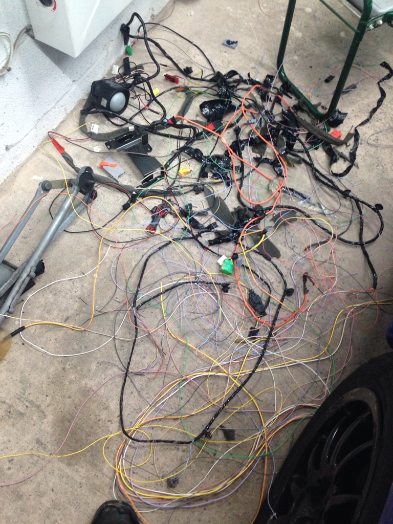

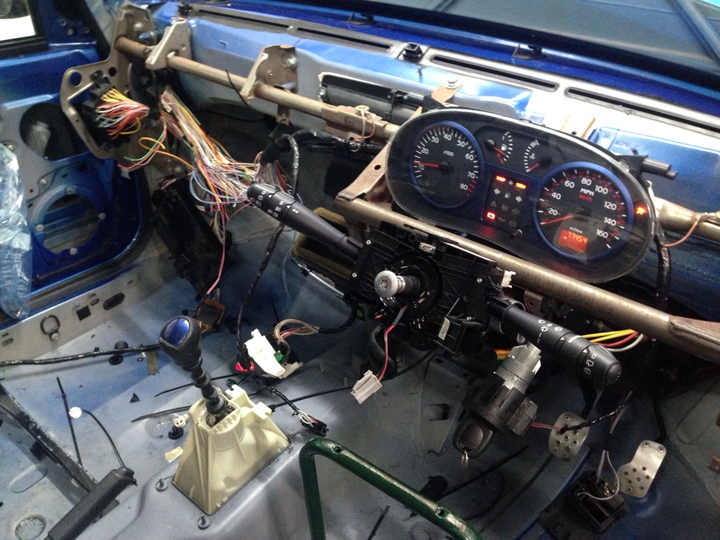

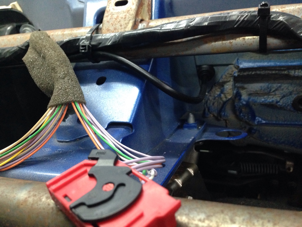

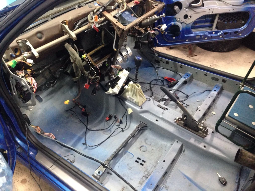

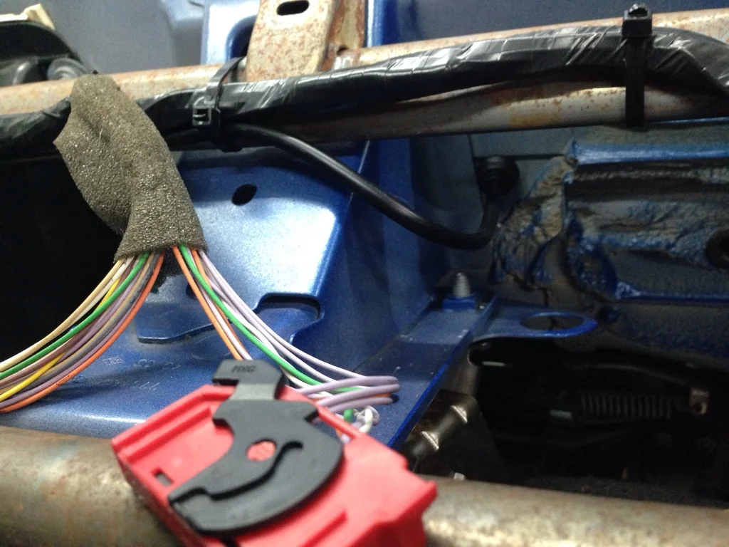

Got some wiring done today, it's 75% complete. Everything behind the dash is done, airbag wiring removed, all redundant circuit wiring removed, audio, electric windows, mirrors, central locking and alarm all gone. Just finishing the rear loom which won't take long then a couple of bits to strip from the front end/under the bonnet.
Gave it a test run to check everything still worked and it would still start/run. It did/does so all good.
Once that's all done I can mount the battery and sort the wiring for the battery cutoff and extinguisher + a permanent feed for the transponder.
Basic stuff, but modified the ignition switch to remove the steering column lock to comply with msa regs.

Looking good Russ I've been at it with the loom today pretty much removed the same as you, Airbag,Audio, all door wiring and central locking
Tomo3292
  Clio 1.6 K4m
Good work, Id love to remove all that just for the simplicity reason but would 100% end up removing I shouldn't!
Did you follow a wiring diagram I take it?
Russ has done it all before remember, but I personally follo diagrams, worked for me. Find a device or connector then trace it all the way back to the end point. Test at the end for clarity!
Russ Rallye
Like Tomo says you've got to have a logical approach, it's easy for me as I'm an electrical engineer by trade but if you're careful there's a lot wiring you can strip from the oe loom on a track/race car.

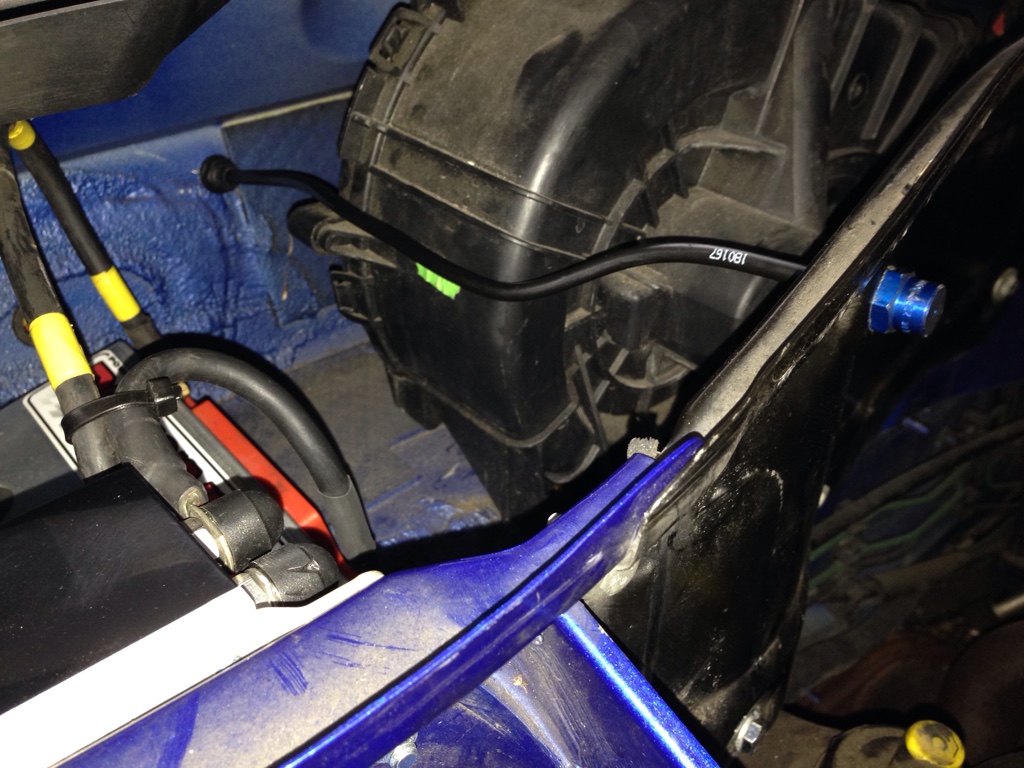

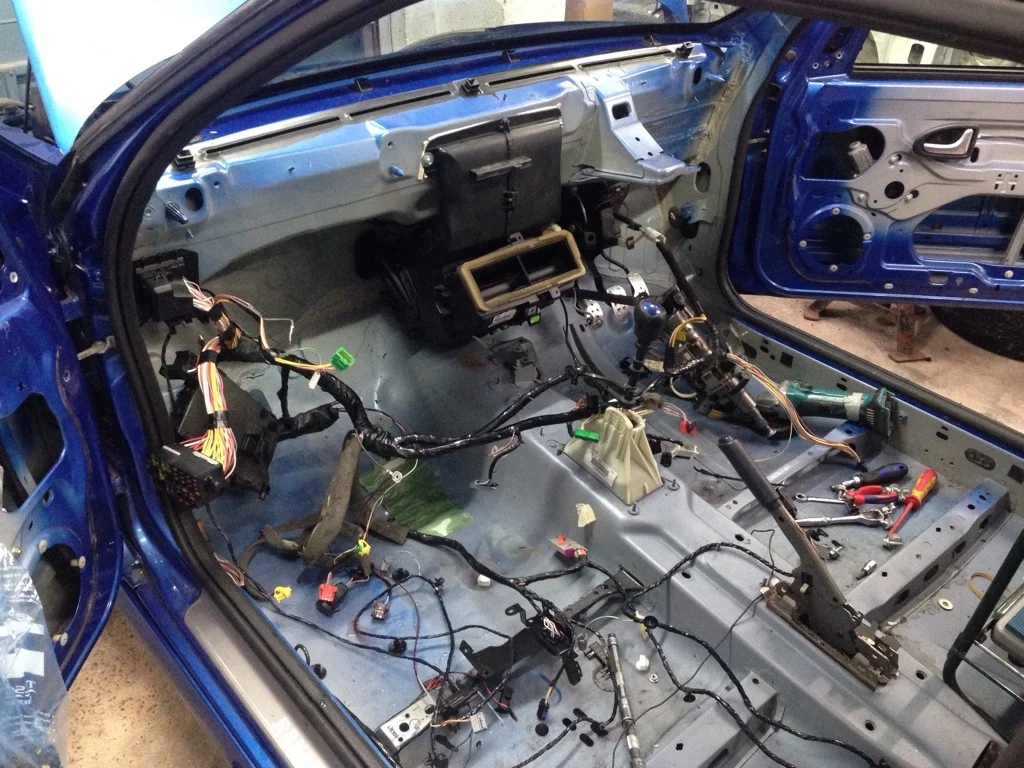

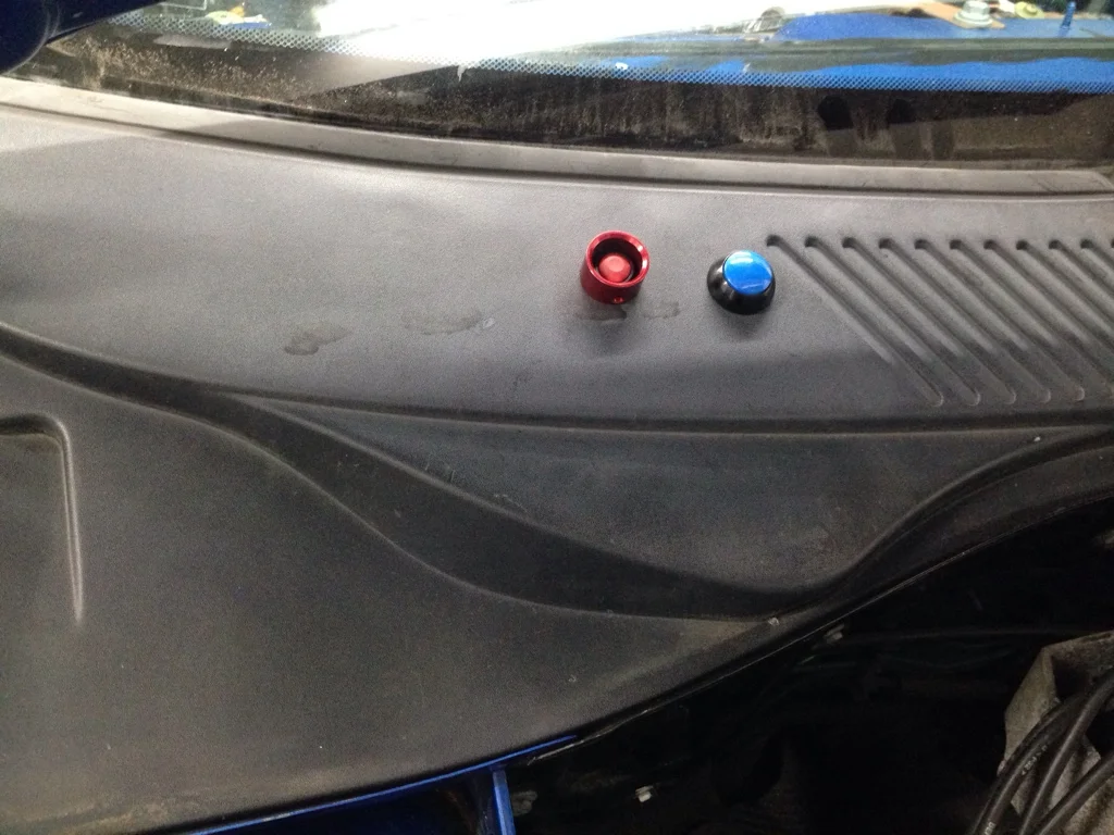

Got all the wiring done now and it still works lol.

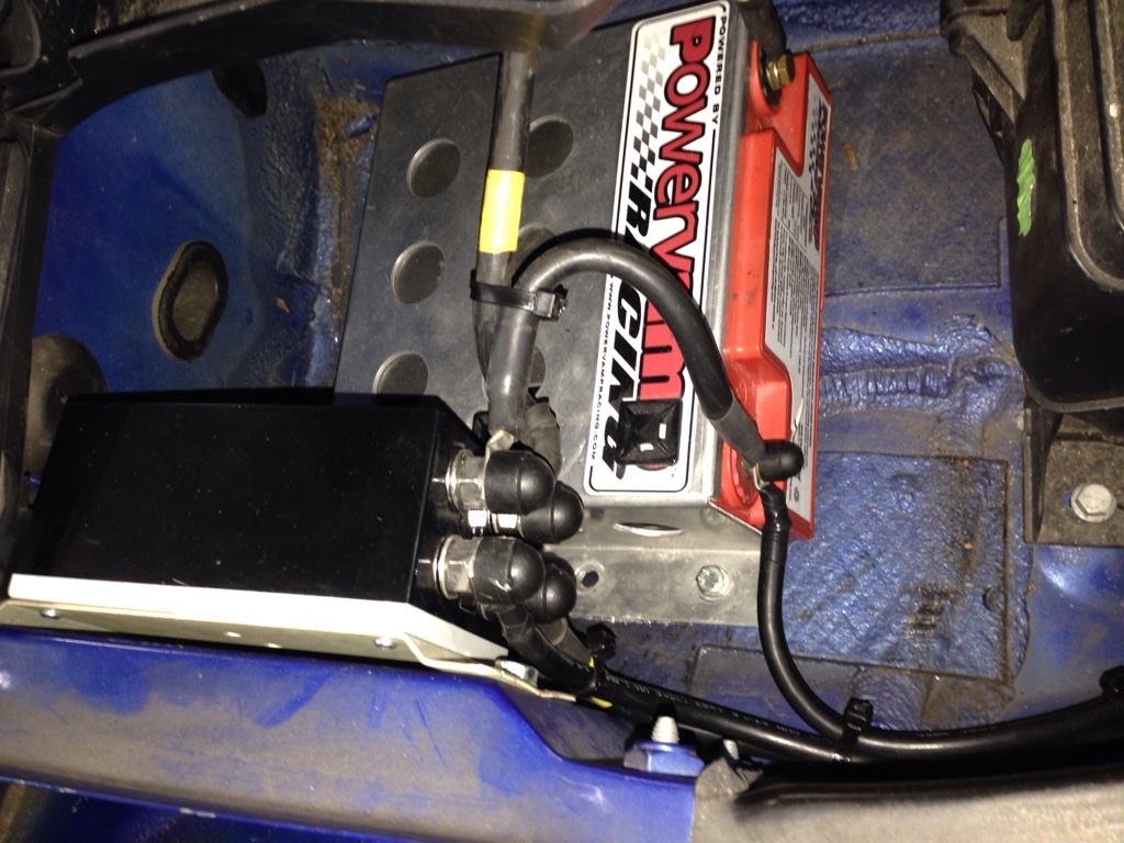

Got the battery and cut off installed yesterday too. All tucked away in the scuttle.

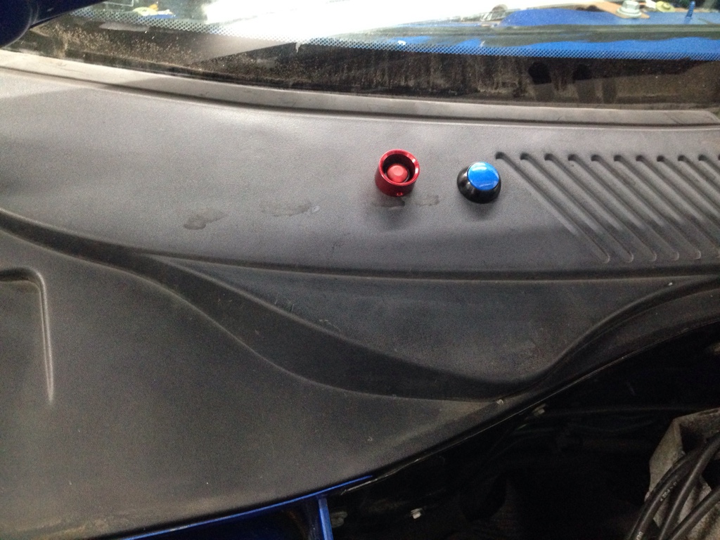

Cutoff and extinguisher buttons mounted and wired.
Extinguisher nozzle fitted and piped.

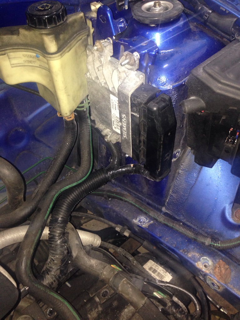

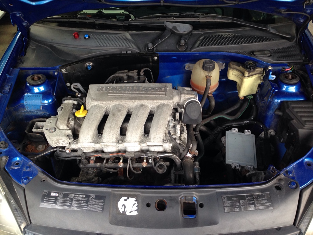

Couldnt be bothered to start scraping sound deadening off and taking brackets off today so decided to do the easy stuff first, fitting all the shiny bits.
Got the oil cooler fitted under the front bumper bar and tidied some bits up under the bonnet, removed the carbon canister and wiring.
Still have the ecu to mount and an air filter/box to make.

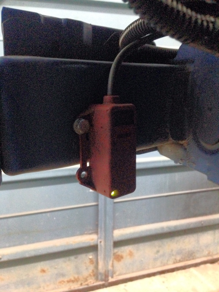

Got the transponder fitted and working.

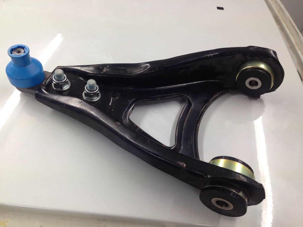

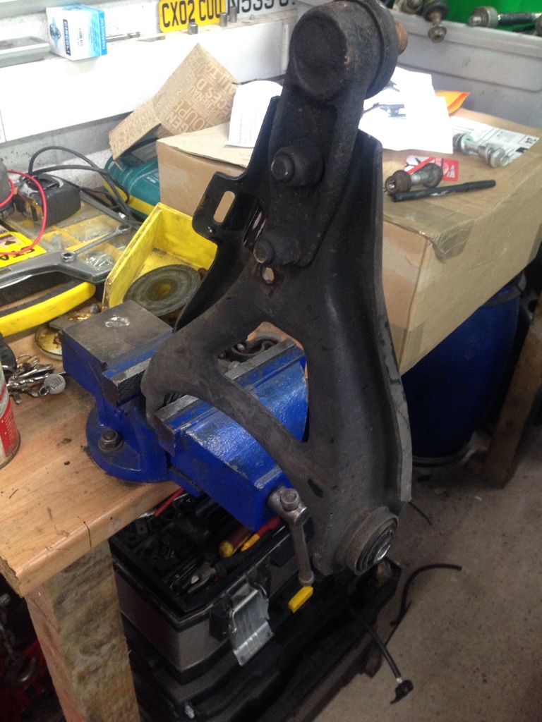

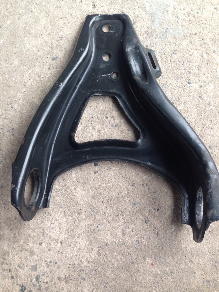

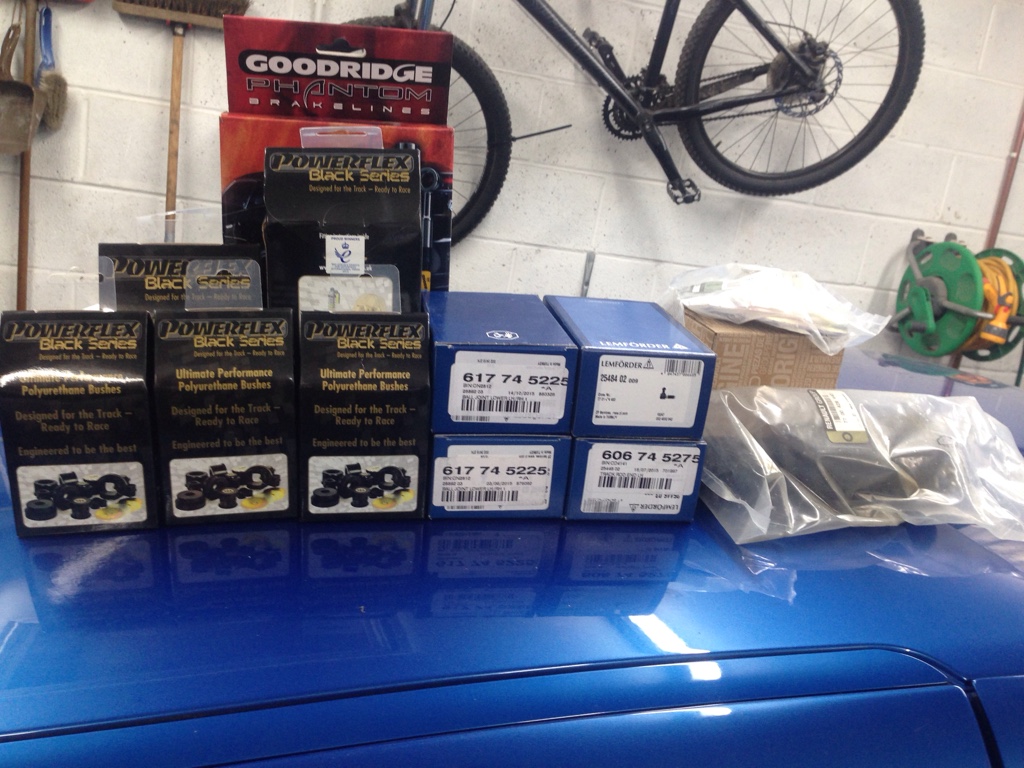

So onto the easy stuff, or so I thought! Going through replacing all the front and rear suspension for new components including bushes, ball joints, arms and ends + shocks and springs.
The standard Renault top mounts, I'd forgot how epically sh1t they were! Much messing around to get them sorted with the new shocks and springs. Also camber bolts are god awful contraptions, hence why I modified the struts on my last build so I could use standard bolts but still adjust the camber. Unfortunately Class F says I can't change so in stuck with standard top mounts and camber bolts.
Managed to get one side done including re-bushing the standard wishbones with powerflex black bushes. Also new lemforder ball joints fitted as well.
Before
Stripped, degreased and cleaned up.
Fully built up, sleeves and bushes pressed in and ball joints on. No need to weld these in now like the previous ones.
Upto date again, hopefully get the other side done tomorrow and get started on the rear.

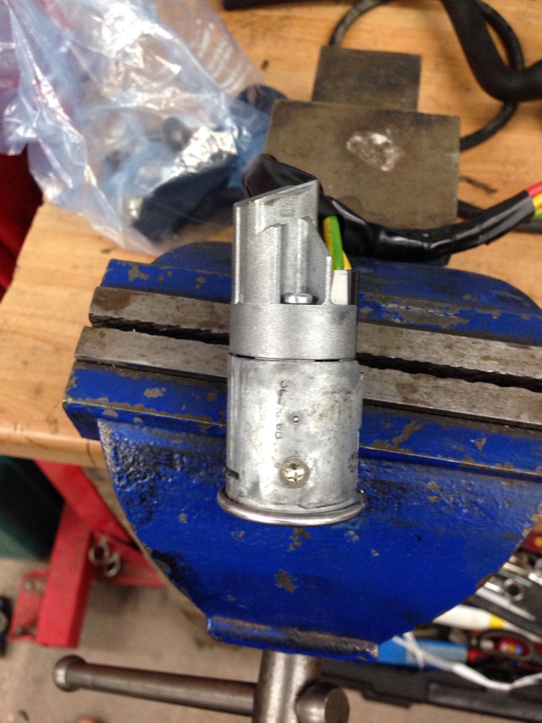

Russ what isolater are you using? And also what needs to be done to remove steering lock? I don't have a friendly scouser ;)
Russ Rallye
Russ what isolater are you using? And also what needs to be done to remove steering lock? I don't have a friendly scouser :wink:
Isolator is the armtech one mate, came from my other car, they're the only one I use now after having the cartek one fail on me.
You'll see when you take the ignition barrel out the 'pin' that sticks out when the key is removed. Take the shroud off the bottom, think it's just 2 screws and you can literally just cut the pin off, shroud back on and refit.

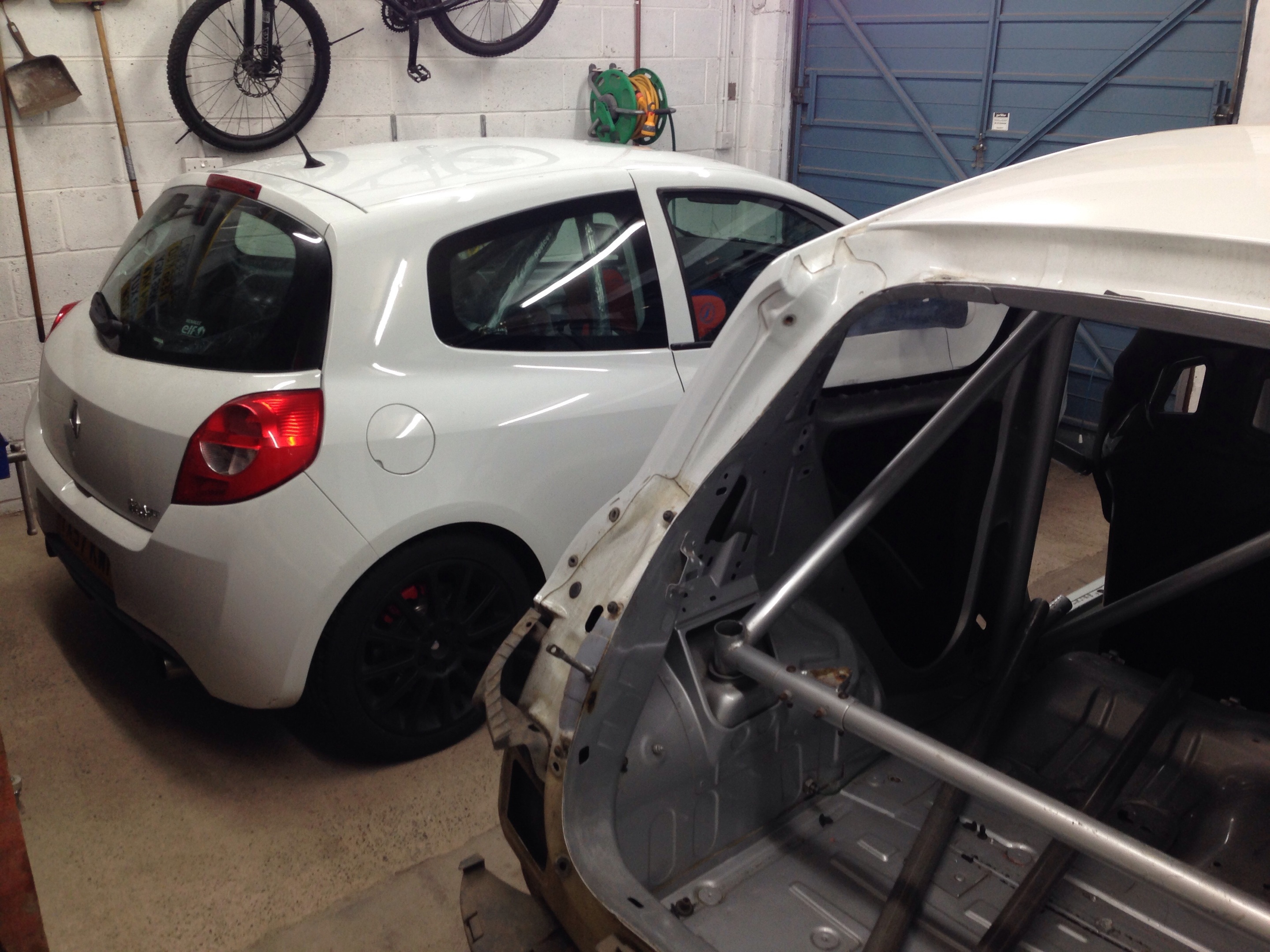

Russ Rallye

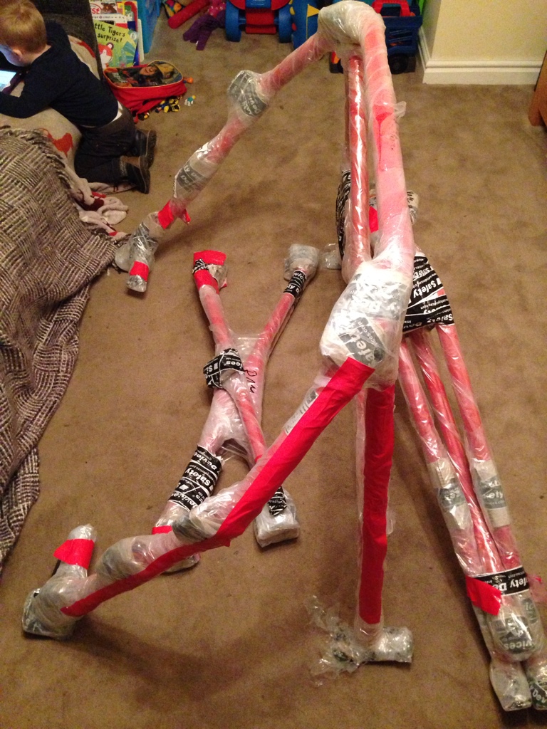

Not done a lot as I've been too busy with Paul's 197. Had a delivery today though. No prizes for guessing what it is!
Great service from Graham at @markfishy thanks.
My welder is going to fit it next weekend hopefully and I can get it all painted and built back up.

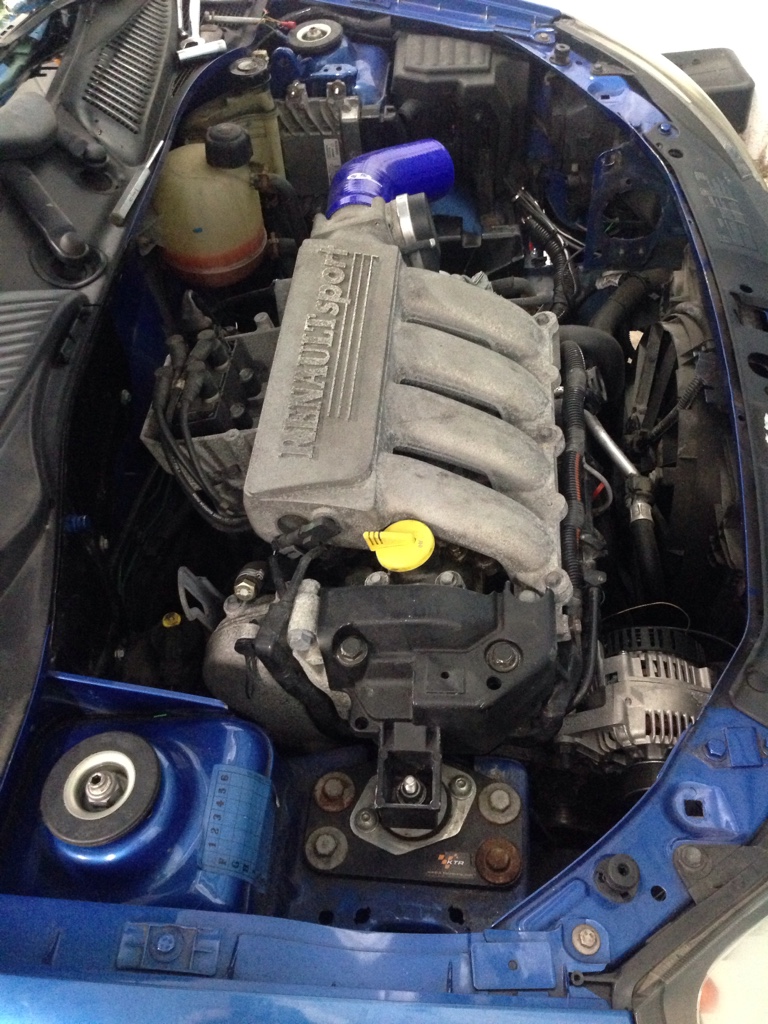

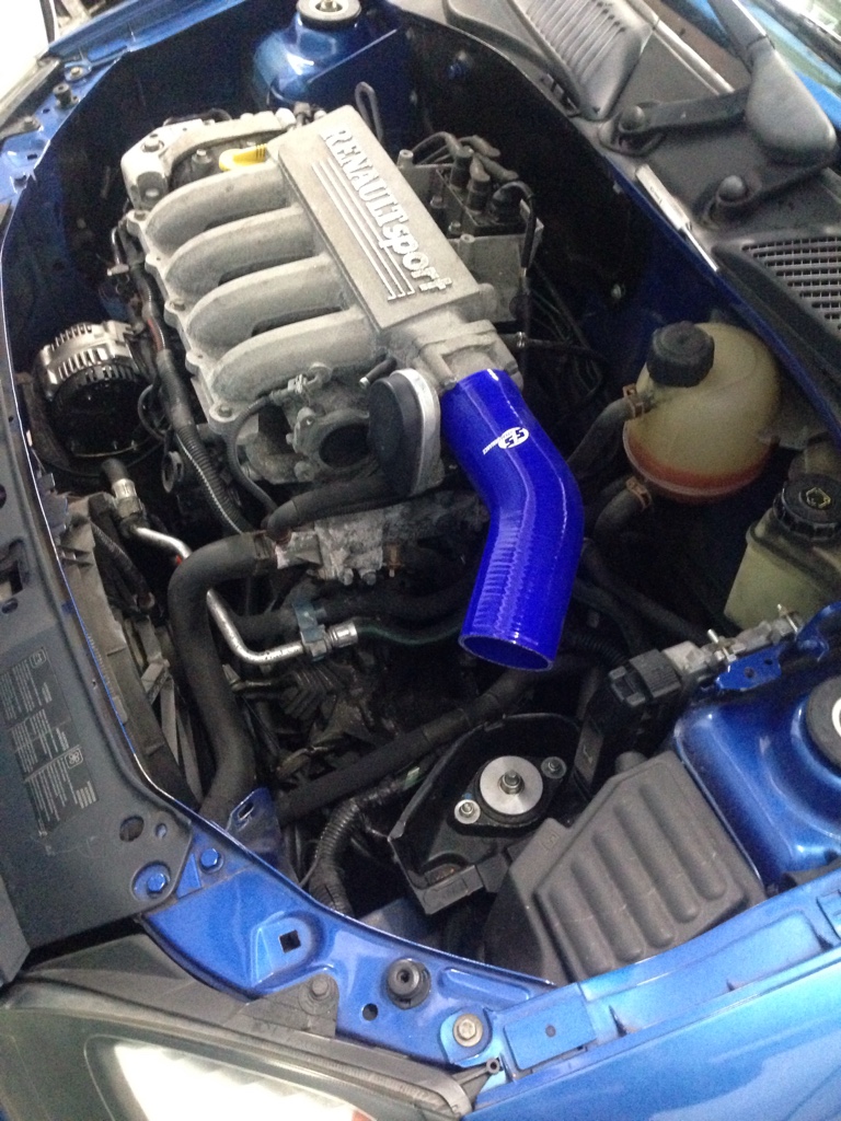

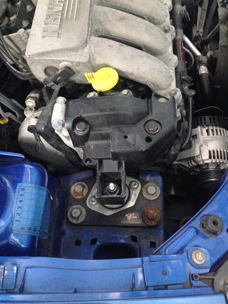

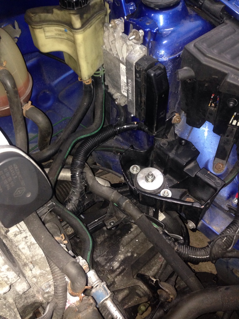

Wanted to get some unfinished jobs done under the bonnet so started of relocating and fixing the standard ecu in place. Decided it was neatest on the side of the strut tower and still allows access to everything else, fuse box, gearbox/gearbox mount etc.
Needed to swap the engine and gearbox mounts over from my other car so did the gearbox one while mounting the ecu. As seems to be the norm the rear fixing on the standard mount had snapped off.
Other side next.

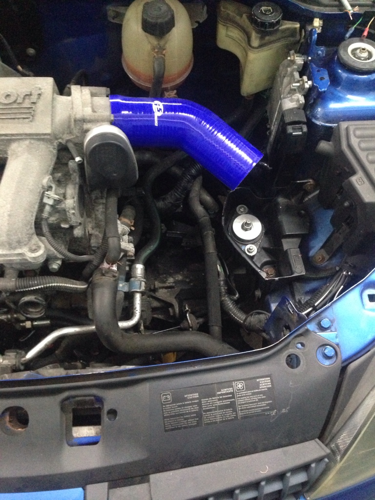

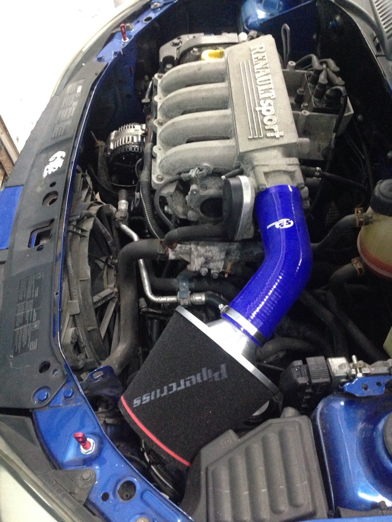

That was pretty much it apart from sticking my induction hose on that turned up today. Will fit the filter when that arrives tomorrow.

They're not solid and contain no spherical bearings they're still damped and bushing materials are allowed to be swapped for polyurethane. Doesn't say anything at all in the regs specially for engine/gearbox mounts and it's not like it's a performance improvement, it's a reliability improvement, they're actually heavier than standard too. Standard mounts don't last 2 minutes on a road car never mind a race car.
Russ
Russ I didn't think Production class were allowed solid engine mounts or did that change for this season?

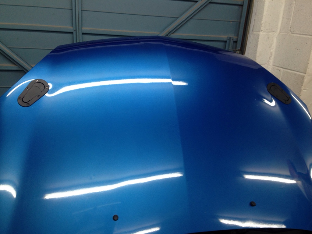

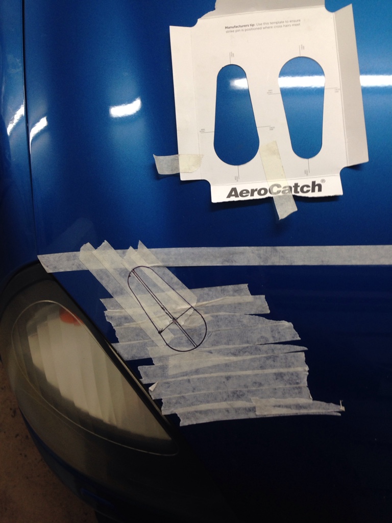

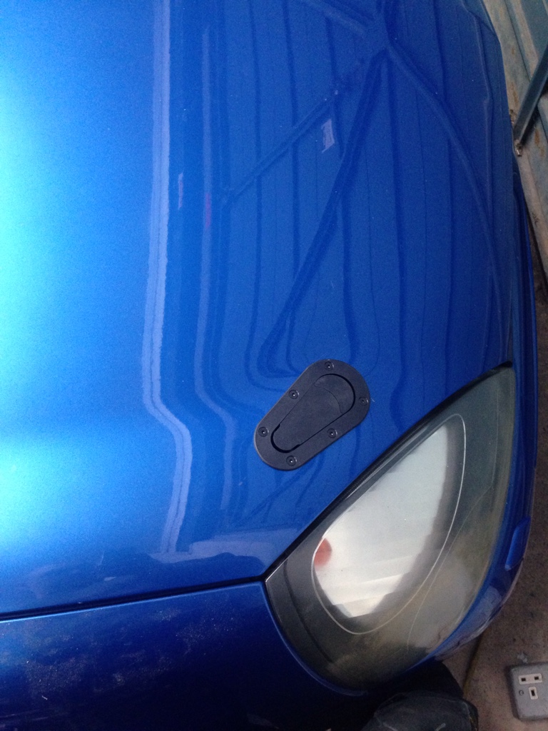

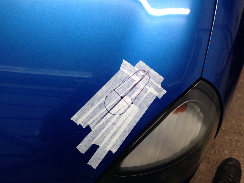

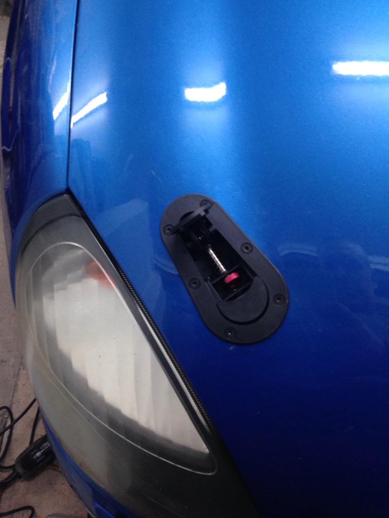

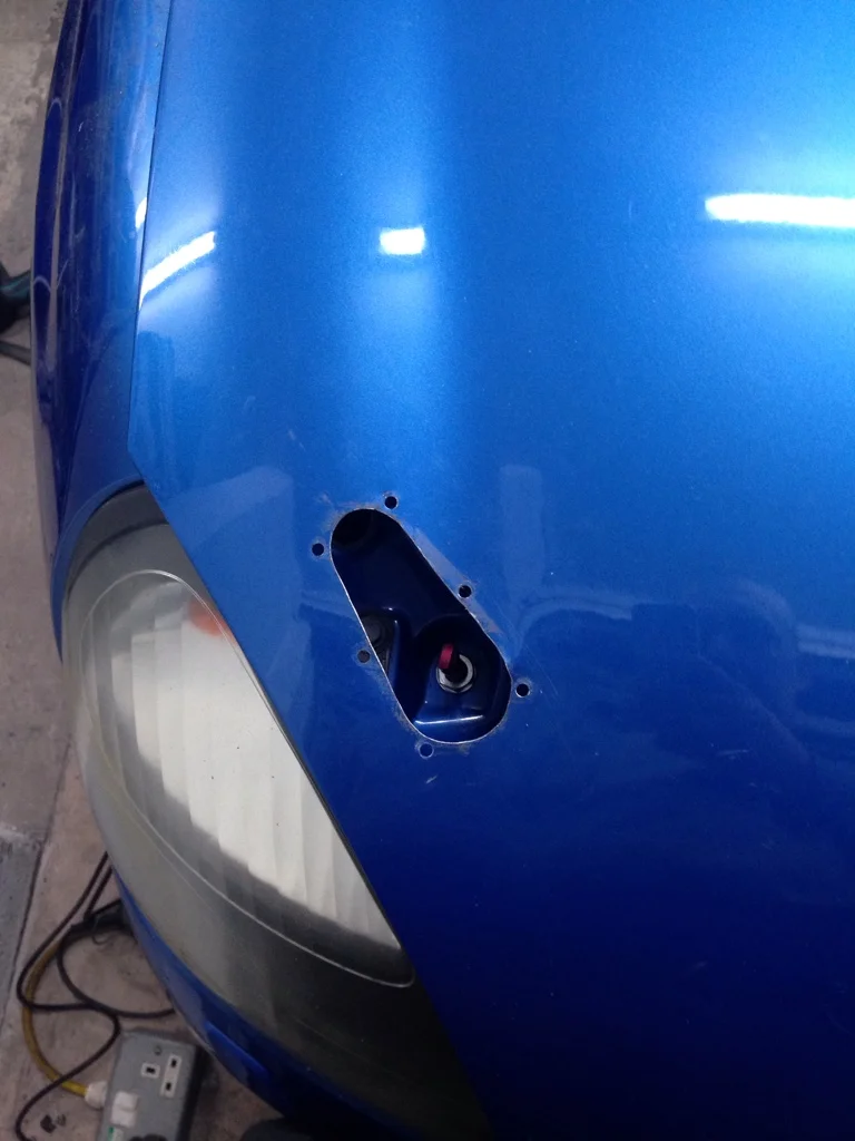

Bonnet catches tonight, got the aero catches finished, much prefer doing them on fg/carbon panels than steel.
Got them measured up and marked out.

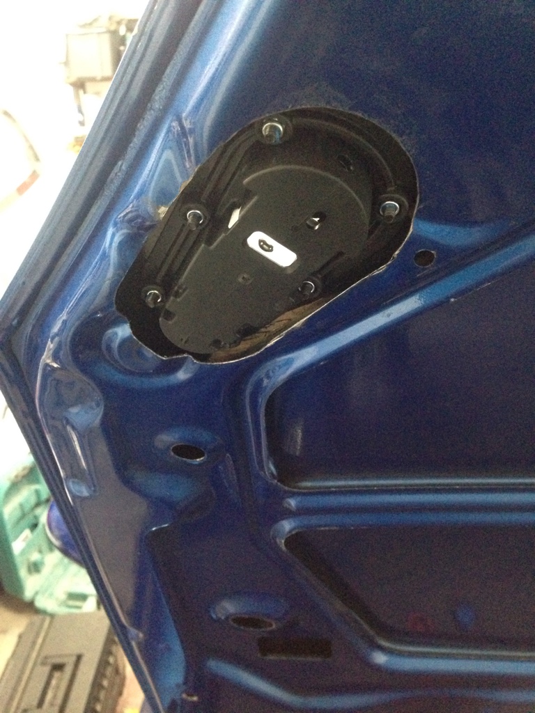

Hole cut on drivers side ready to fit
Fitted

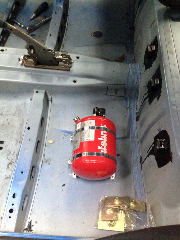

Got the extinguisher positioned and the holes drilled before it gets painted inside.
The air filter turned up today from pipercross, er it's a bit big, it certainly won't be restrictive!

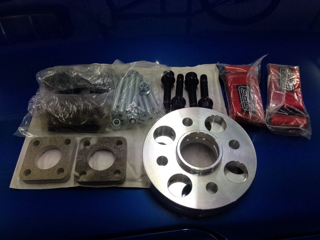

Some more bits from Nick at Pure Motorsport turned up, front and rear spacers. Also a stud kit and front and rear tow straps arrived aswell.
