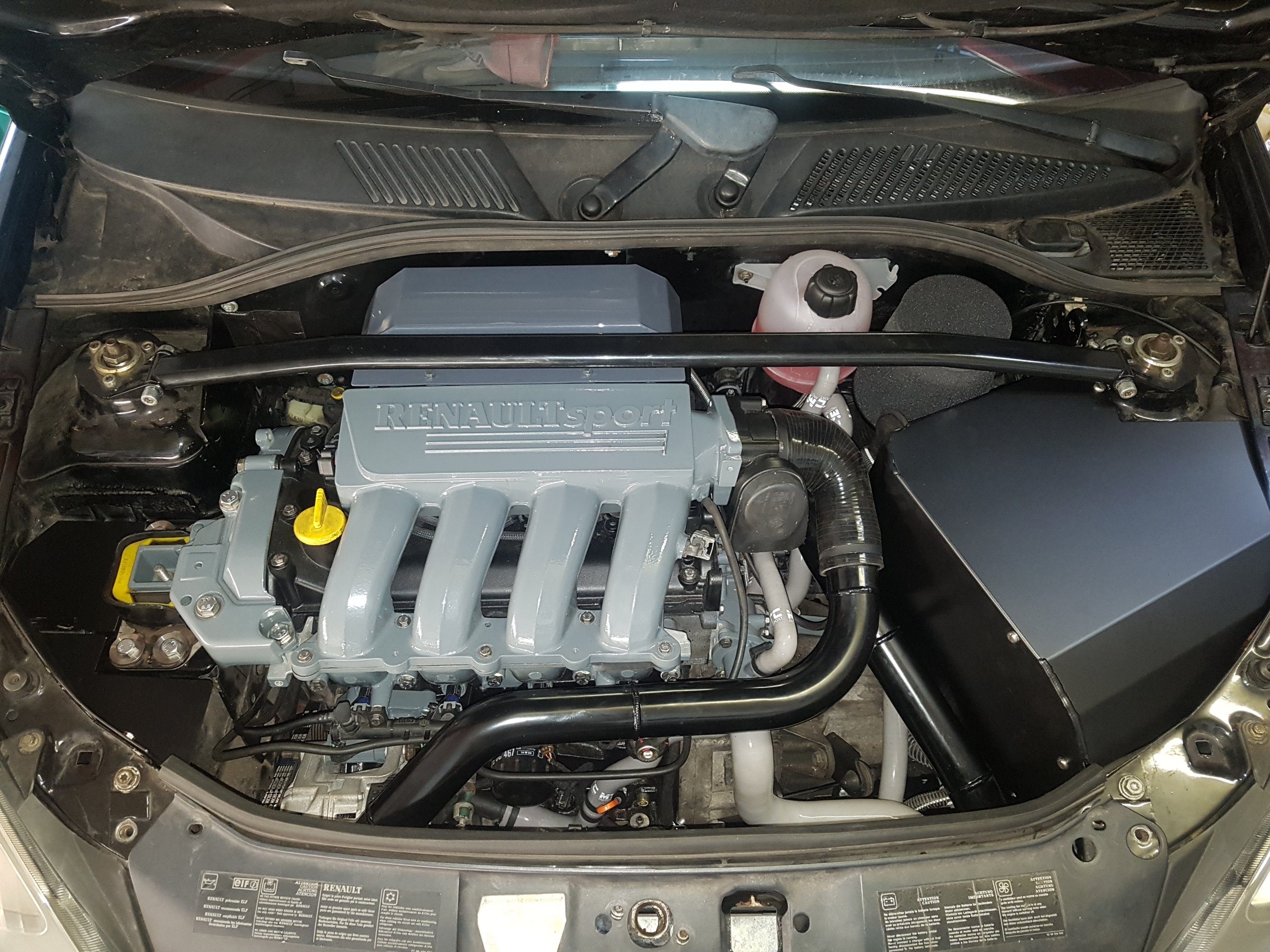

Having just bought a 172 cup, I have a long list of modifications planned.
The car is starting it’s modified life with the following being ordered next week.
182 manifold
182 manifold compatible ktec sports cat
Ktec Cat back recessed system
HC front discs and race pads

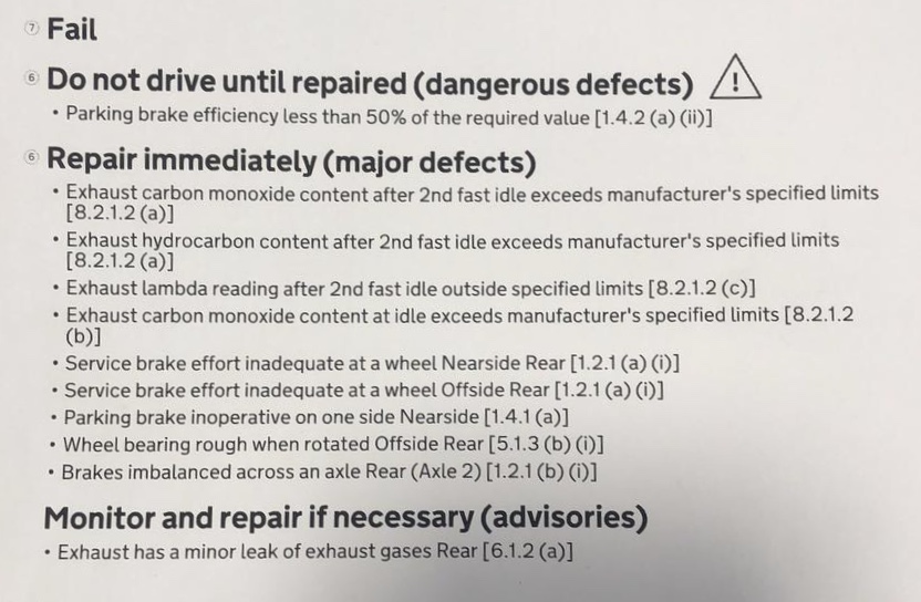

Needs an MOT but basically stuck with a problem. (Failed on emissions)
Cat is goosed, so looking to replace with the ktec sports Cat then recessed pipe back box.

without seeing figures i'm guessing they chucked the probe in and started the test? had plenty that take a minute or two for everything to settle down for the test.

fucked lambda sensor is a common issue causing MOT emission failures, would replace that first before doing the cat and manifold.
