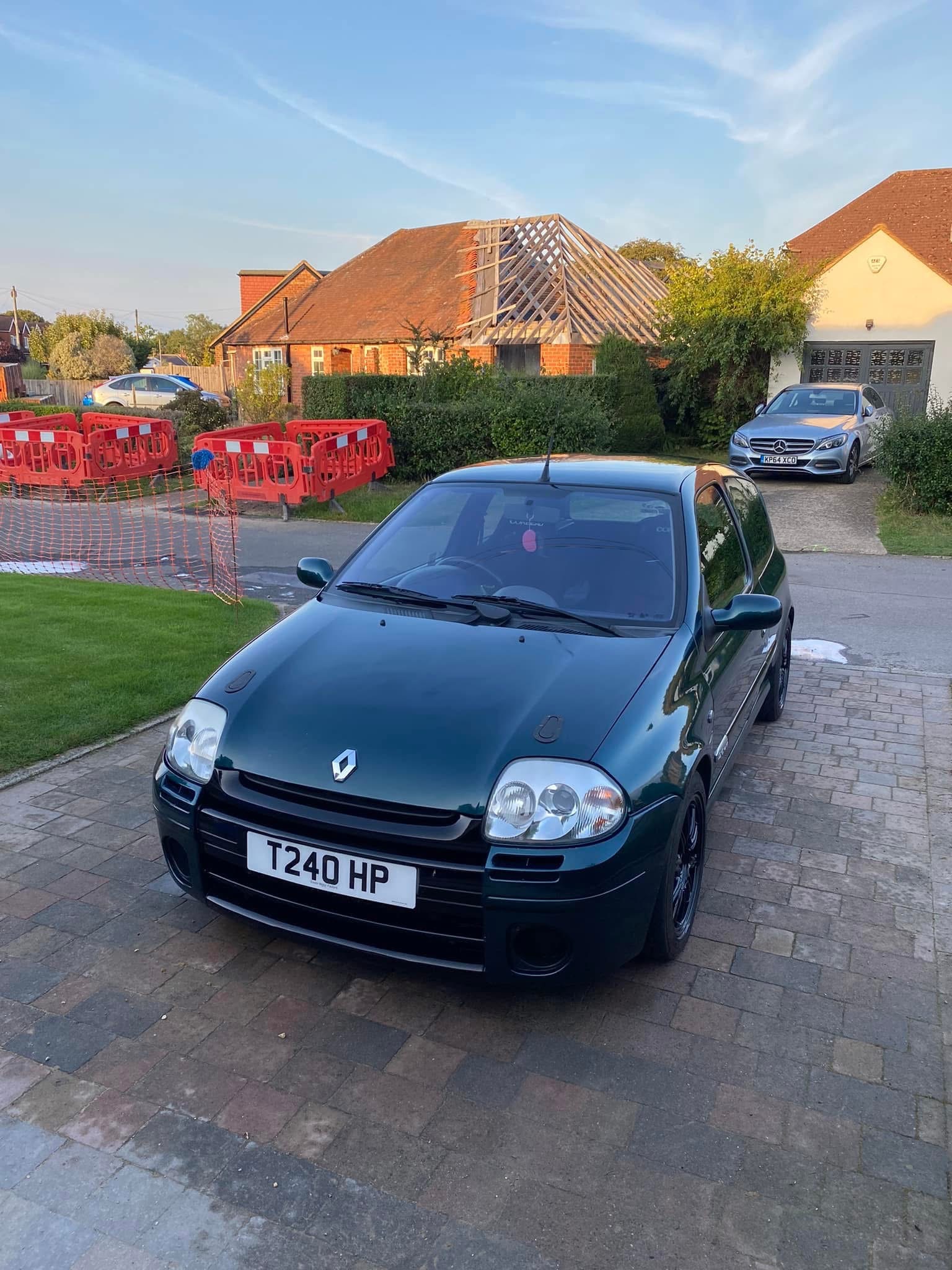

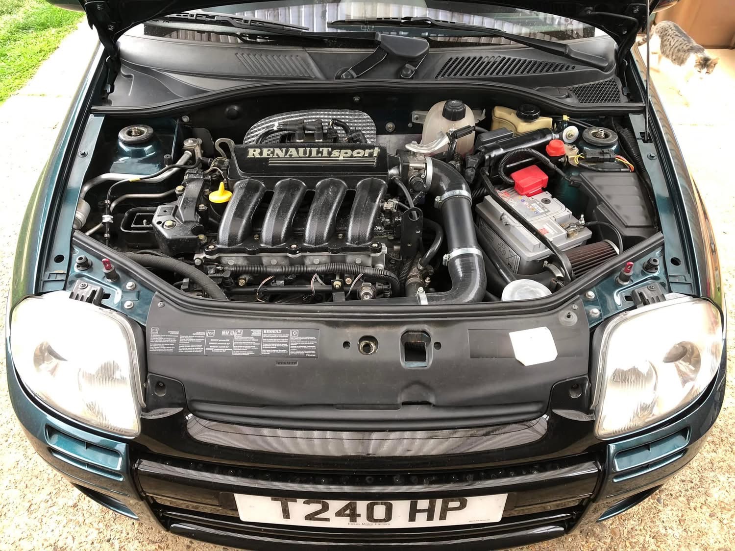

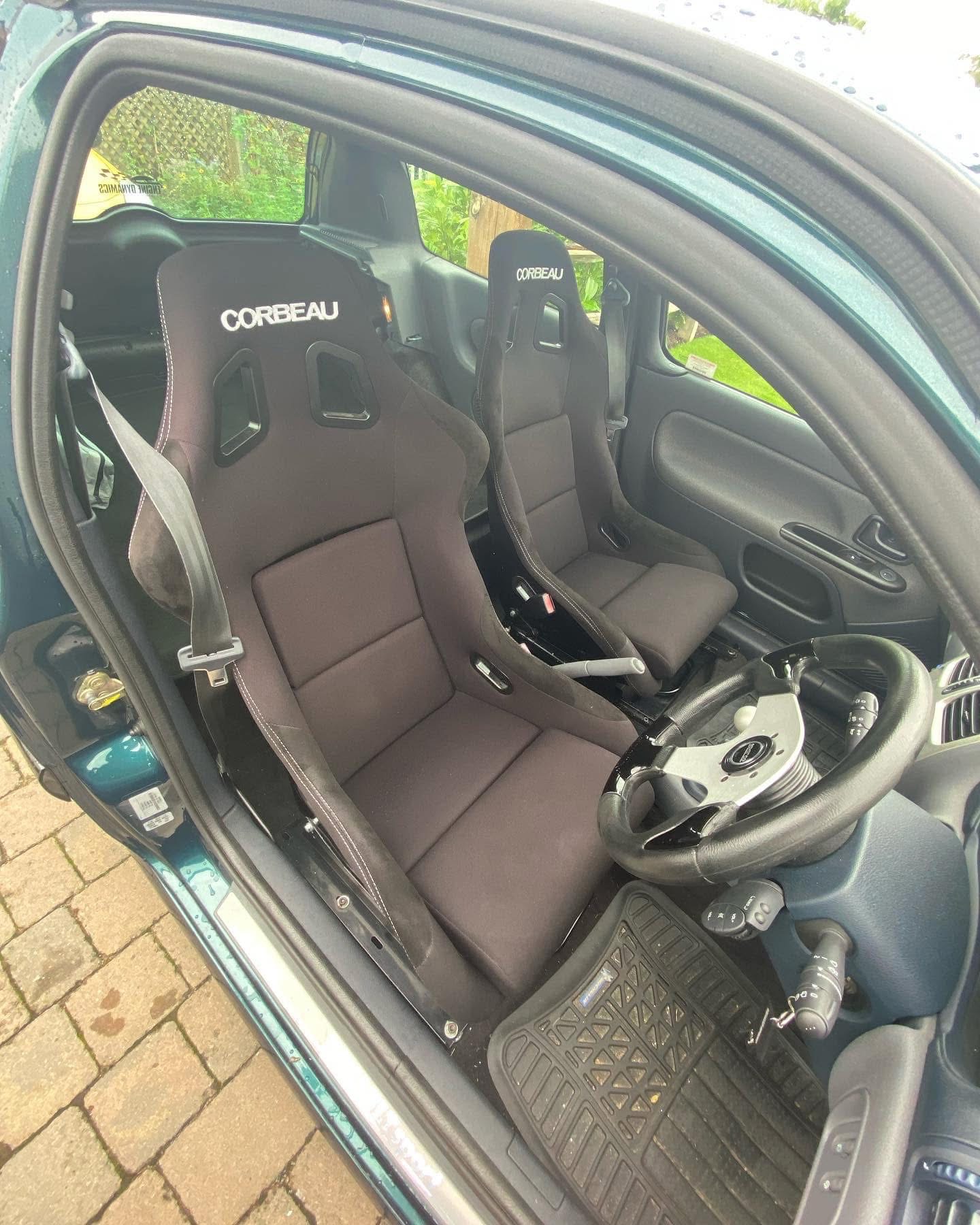

Thought I would start a wee thread for my 172 exclusive, number 95, think the old owner was on here as well. Bought the car in January this year and here’s some pics of the advert when I got it with the following details:

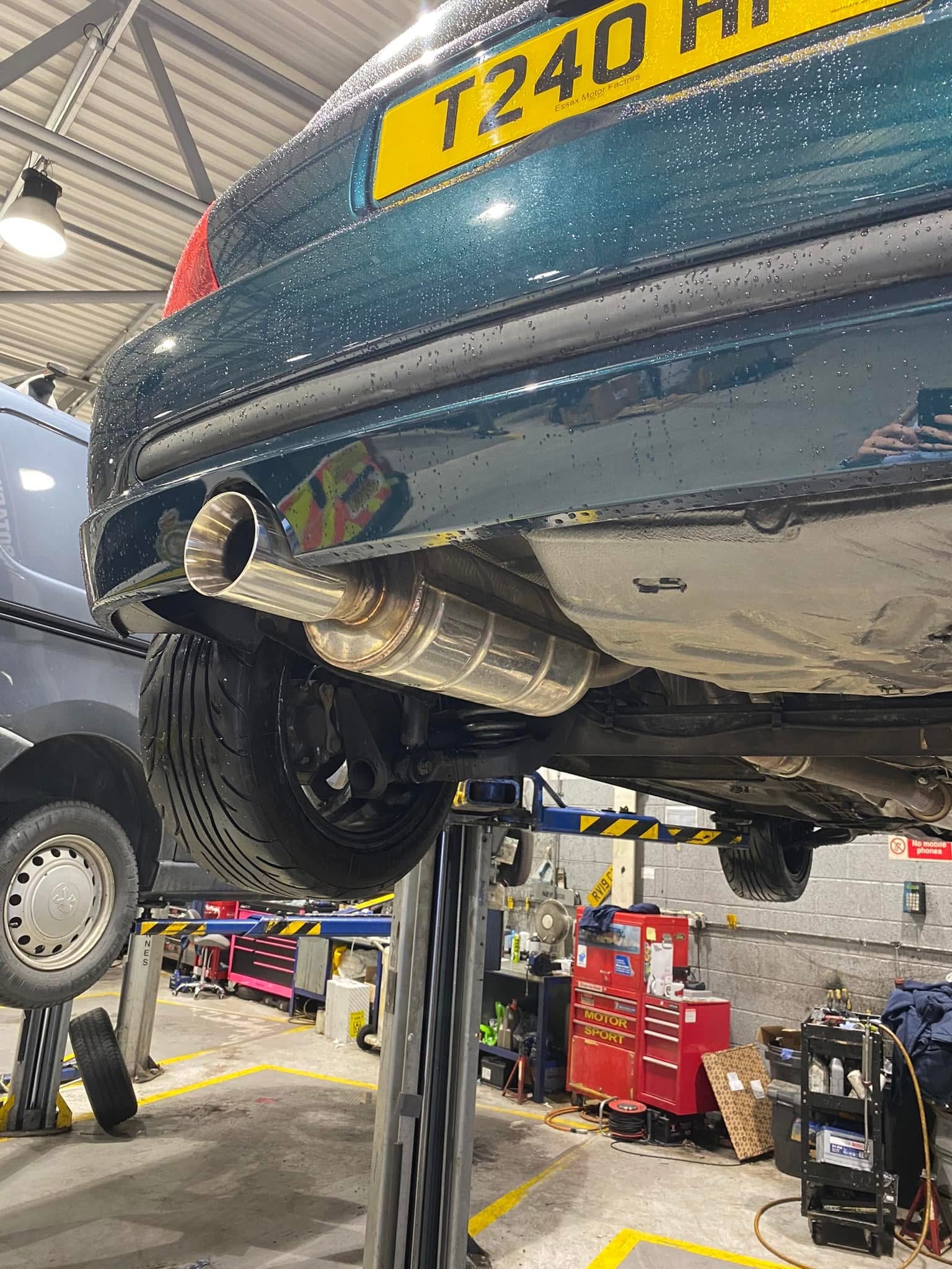

Engine & Exhaust:
Low Boost 230/230 turbo kit.
Gt28 turbo
ED Log Manifold
Turbo Oil Feed pipe
Turbo Oil Drain Pipe
Turbo Exhaust Manifold
Turbo Exhaust Downpipe Kit
Turbo Intercooler kit with black silicone hoses
JR Cone Air Filter with our Intake Kit

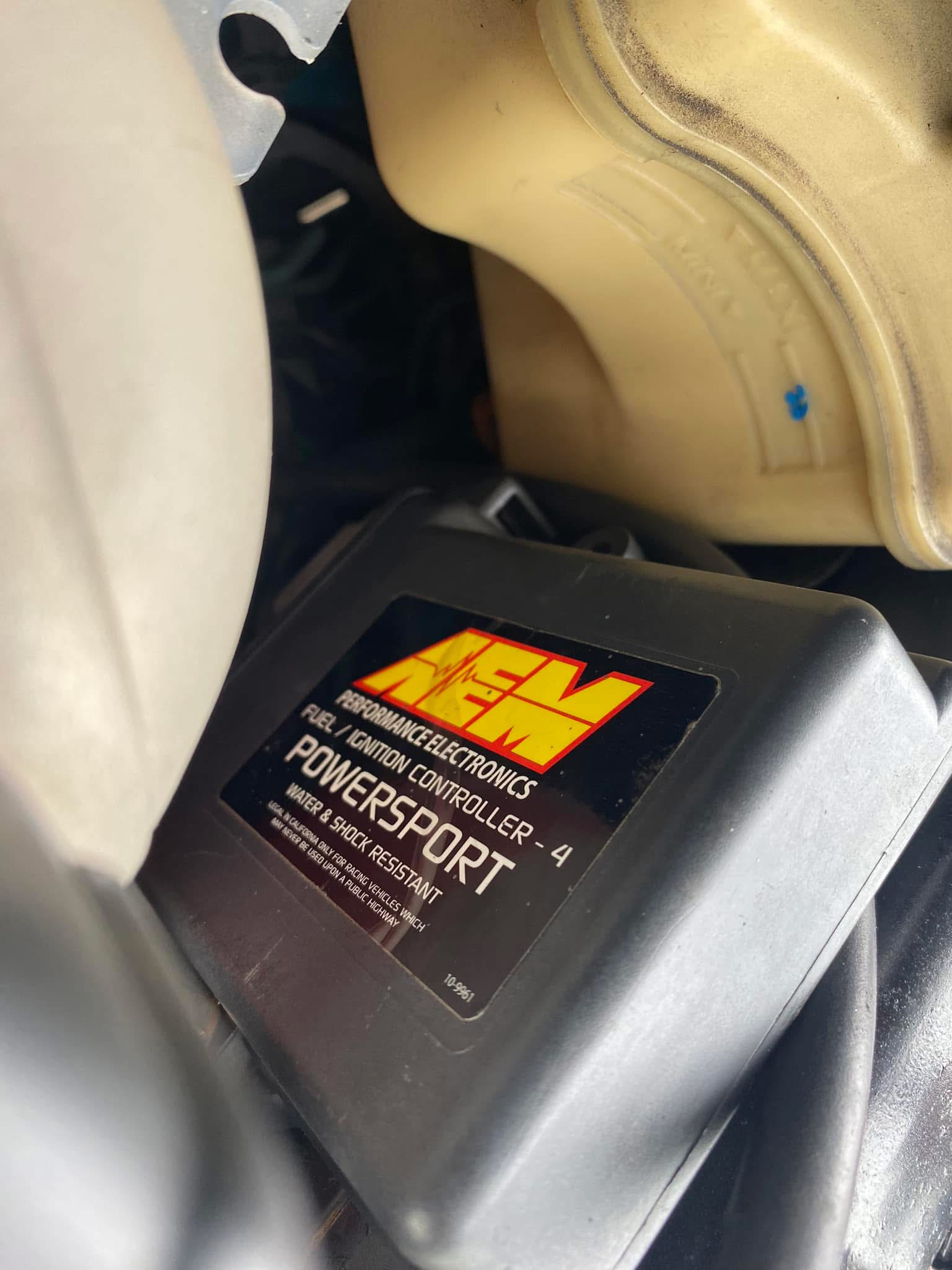

Forced induction ECU Module
Turbo Map Sensor
630cc Injectors
Alloy Turbo Heat shield
Full Custom 2.5 inch exhaust with 200 cat
Custom backbox
Uprated clutch
Fully powerflex polybushed
Exterior and Interior:
Phase 2 rear bumper and tailgate
Exclusive alloys powder coated gloss black 172 cup shocks and grams 20mm springs
Bonnet Catches
LED rear number plate bulbs
Corbeau clubsport XL seats with Jon foz mounts and adjustable sliders
Sparco steering wheel
Custom boost gauge and fuel pressure gauge.
Rear wiper delete
Cup spoiler
Rear seat delete with boot mat
OZ Fl spare wheel and tyre
Upgraded Alarm and Immobiliser
Weekly washed by myself and monthly deep cleaned (wheels off etc). Sills are spot on as Engine Dynamics dry-stored the vehicle for 18 years.
Being honest wasn’t particularly looking for a turbo one but it seemed the better value for the mileage compared to any other exclusive for sale at the time, as I had almost about number 3 ages ago and always liked the exclusives looks wise.

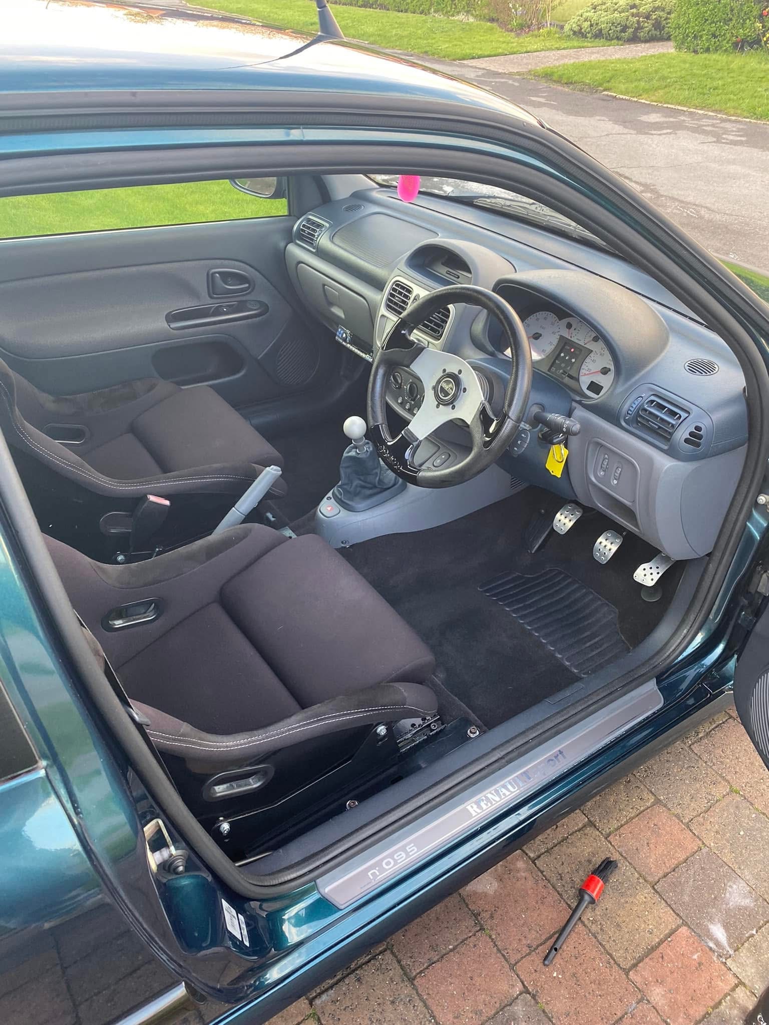

So far I have:

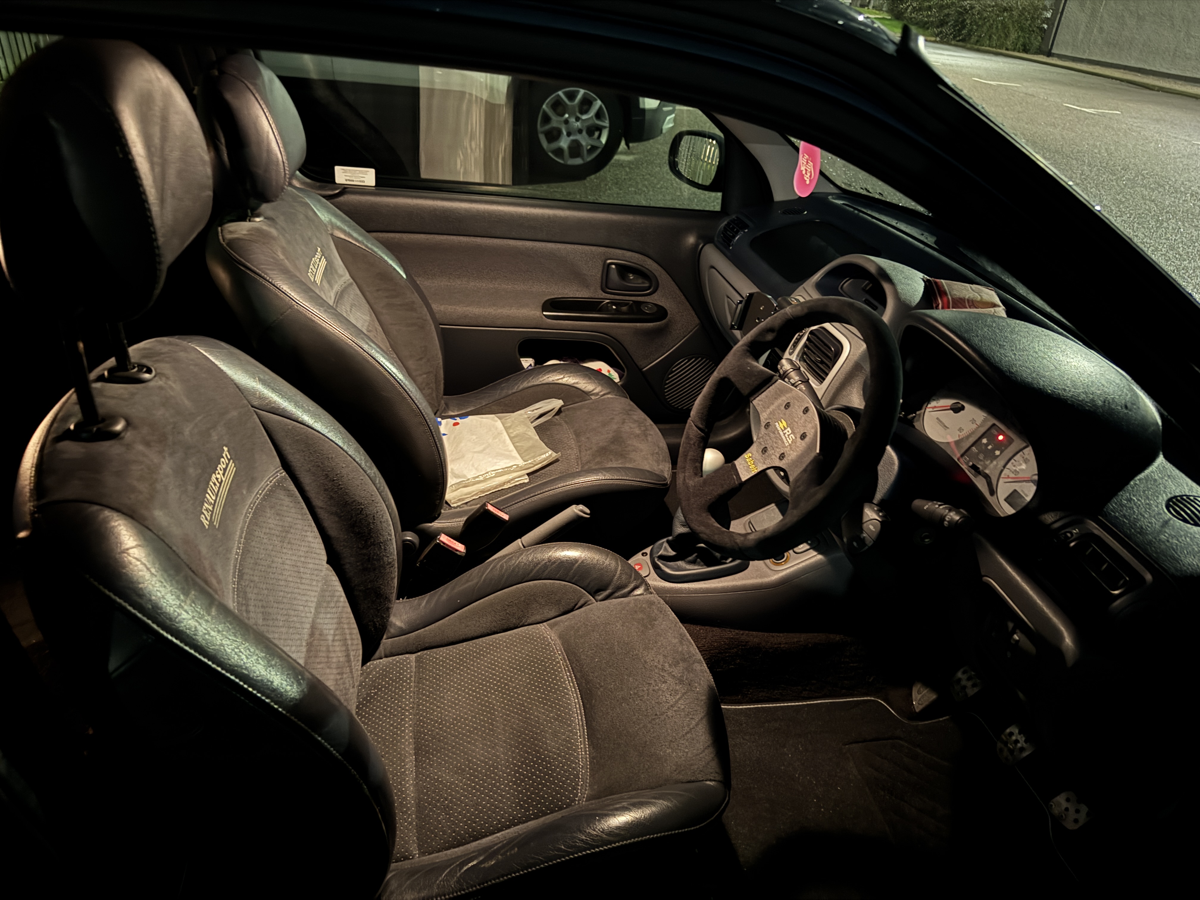

Put in standard interior, ongoing as belts I got have locked the inertia reel or missing boltsor gotten damaged for the rear
New Michelin pilot tyres all round, the semi slicks are not ideal in Scotland!

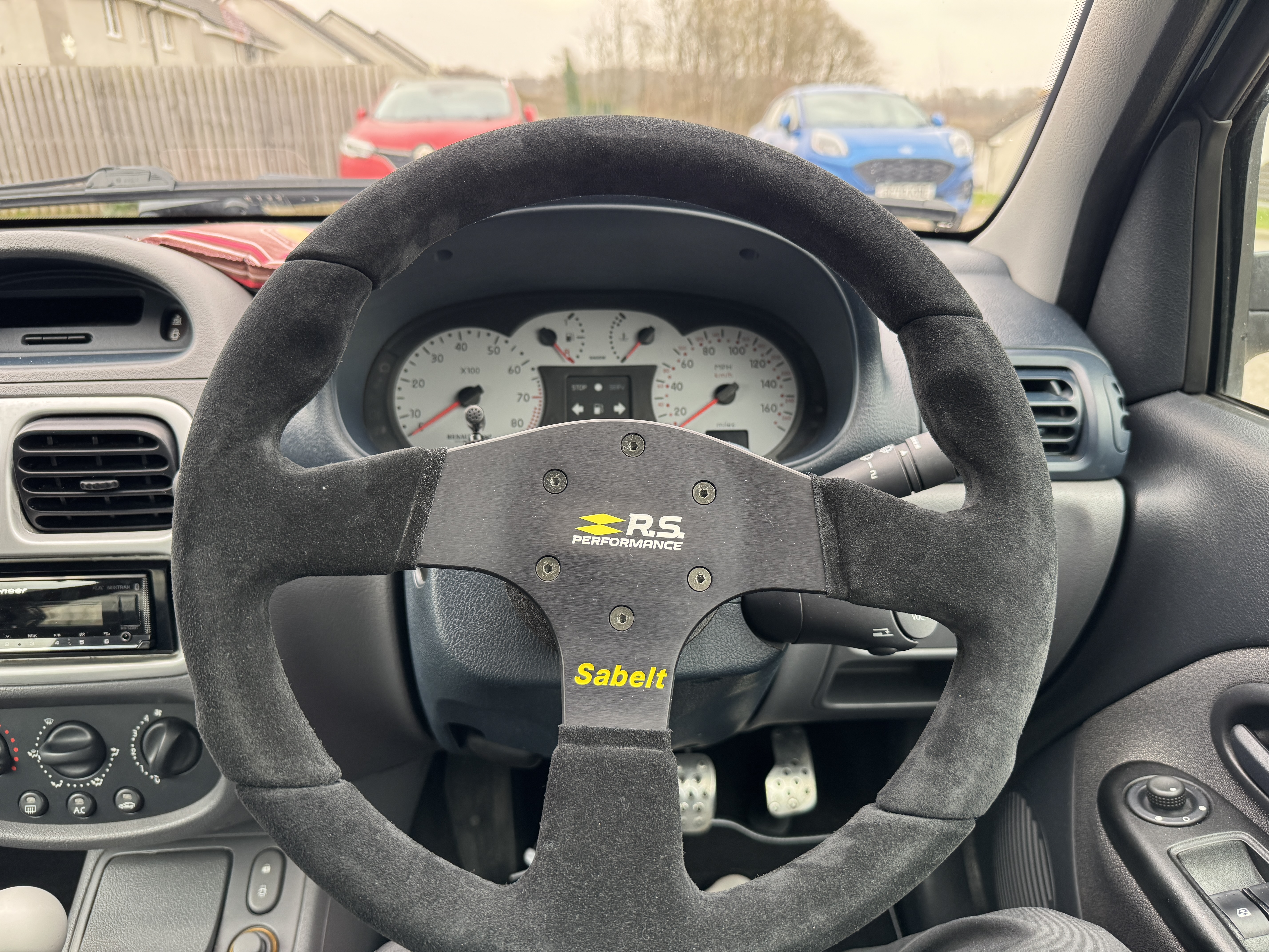

New Sabelt Renault sport steering wheel

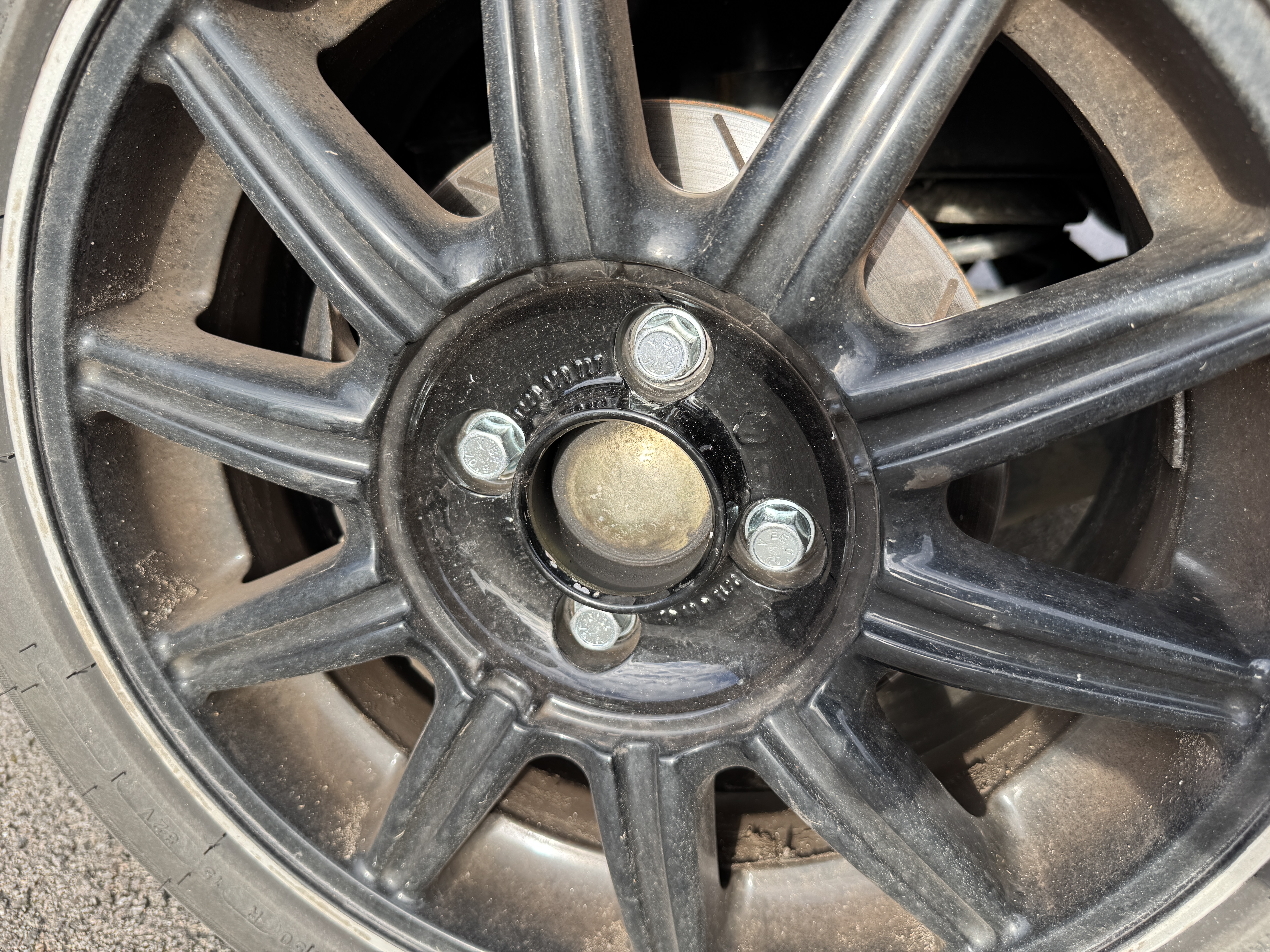

Removed spacers
New wheel bolts
Dump valve, not massively keen but I don’t like the thought of not having one
New Renault sport mats

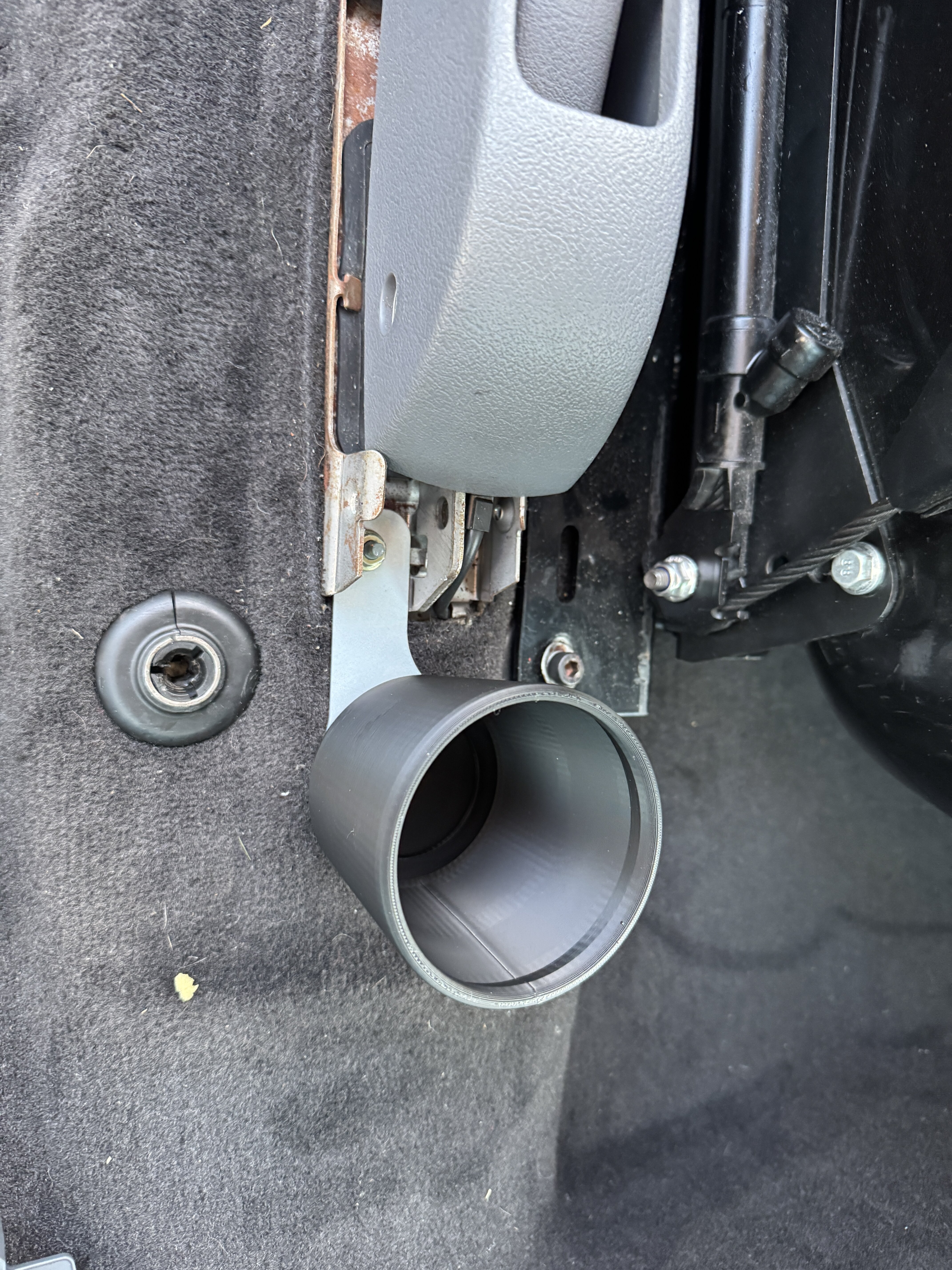

Cup holder
Relocated the head unit to normal position and moved the gauges to the cubbyhole bit

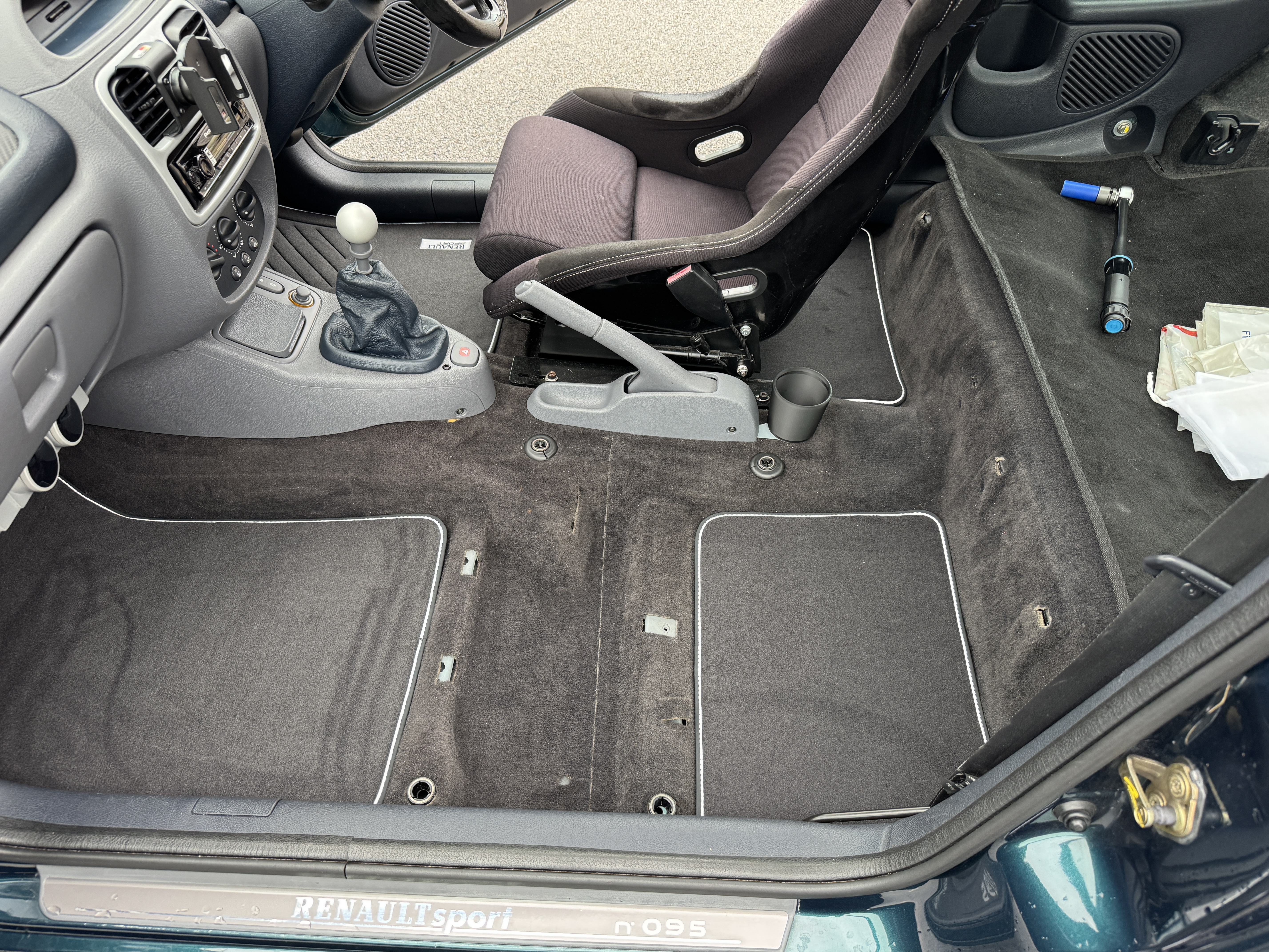

After putting in the rear seats and lifting the carpet I saw this:
with those marks around the bolt and it looking filled in I would guess the bolt snapped so have shelved the idea of refitting the isobar, wish I had known before and I wouldn’t have bothered buying one 😂🙁
So with that being the case and it looking like this with an annoying looking gap
I decided to trim the full length carpet to fit it to fill in the gap

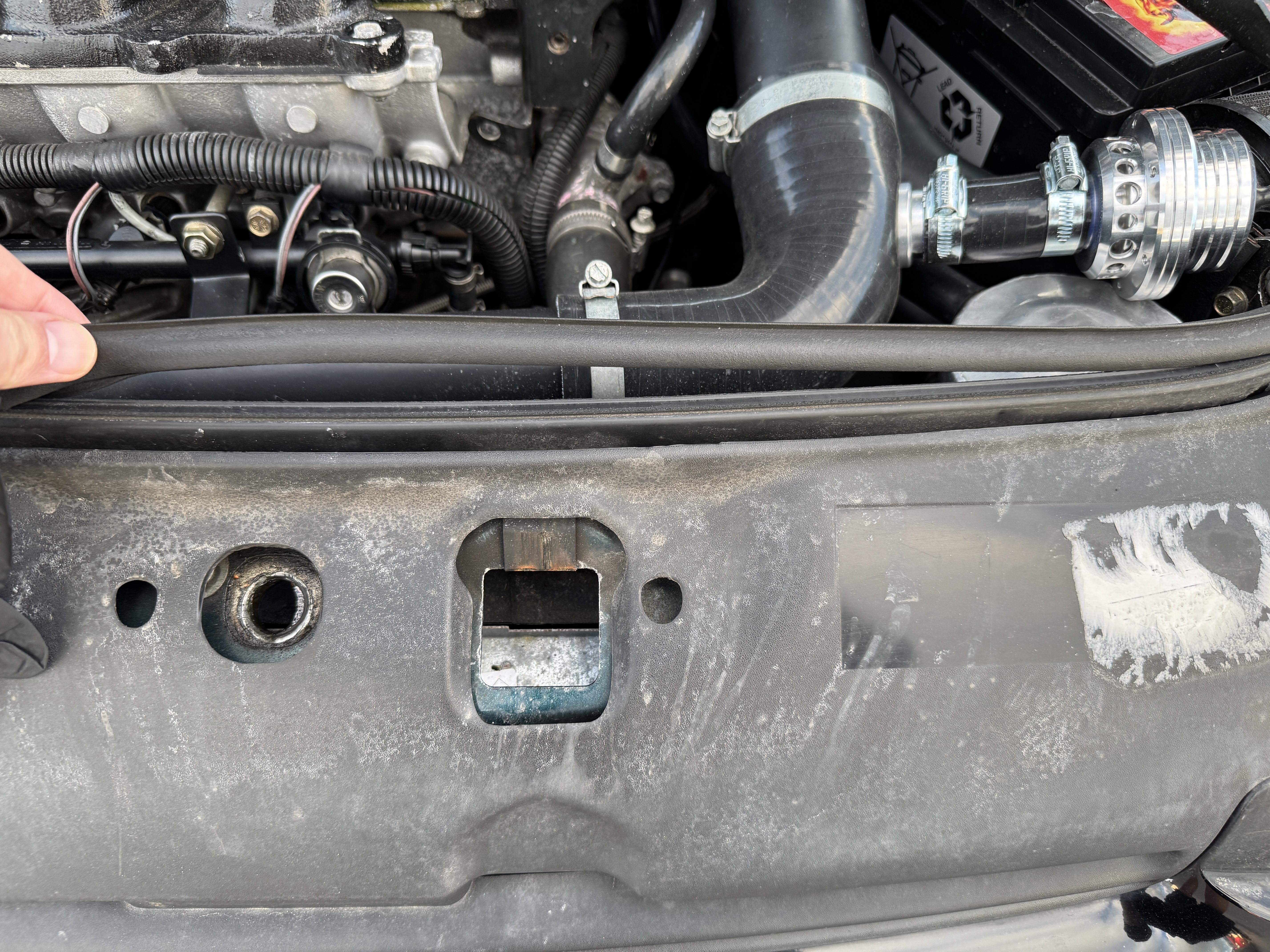

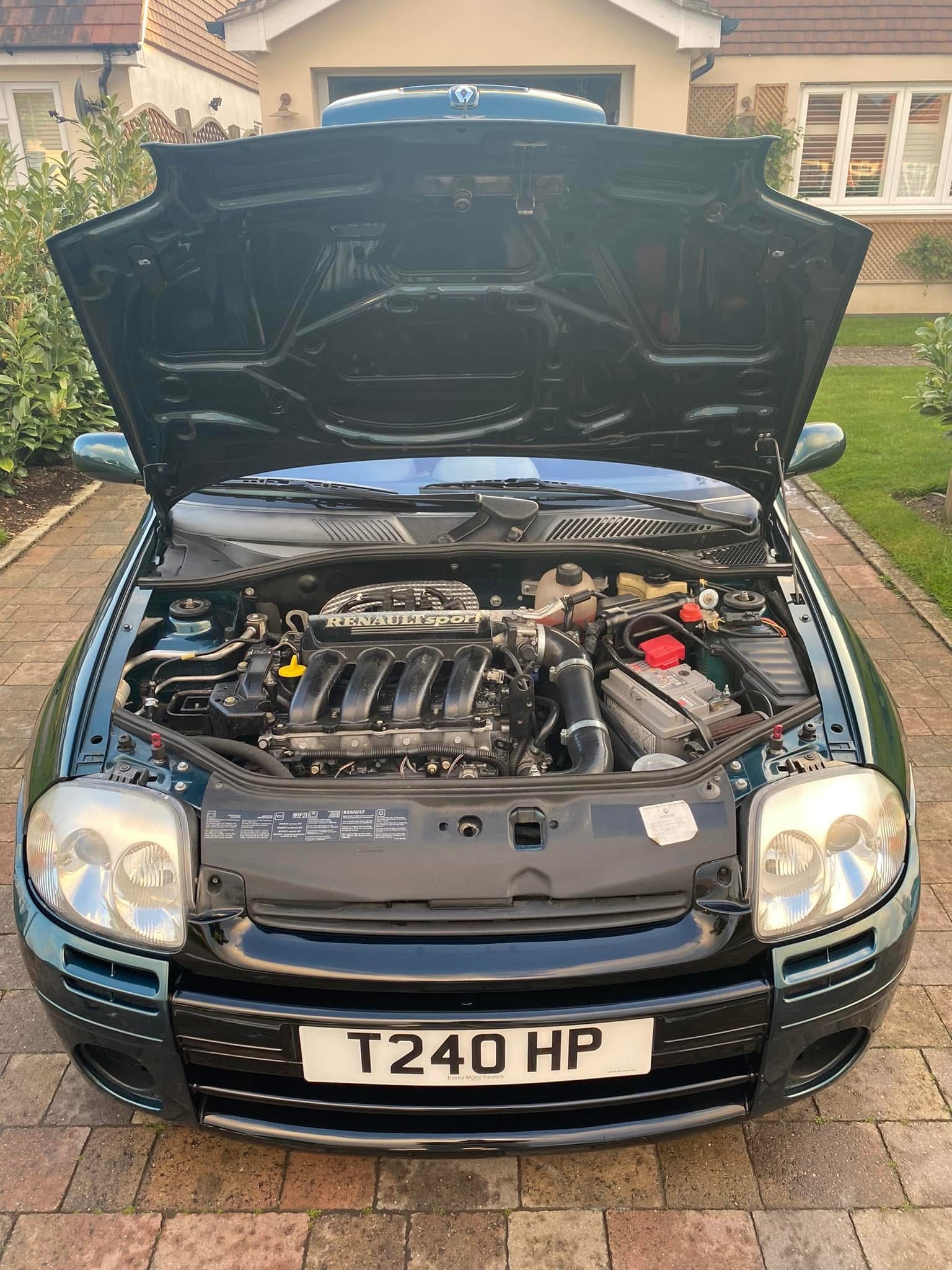

Also fitted a new bonnet seal as the old one had split in bits:
Today I changed the coolant and thermostat, as it never got up to proper temps, not sure if it’s low temp one or just failed but got a new Renault one and new Renault coolant tank from RPD with some new coolant get rid of the red rubbish:

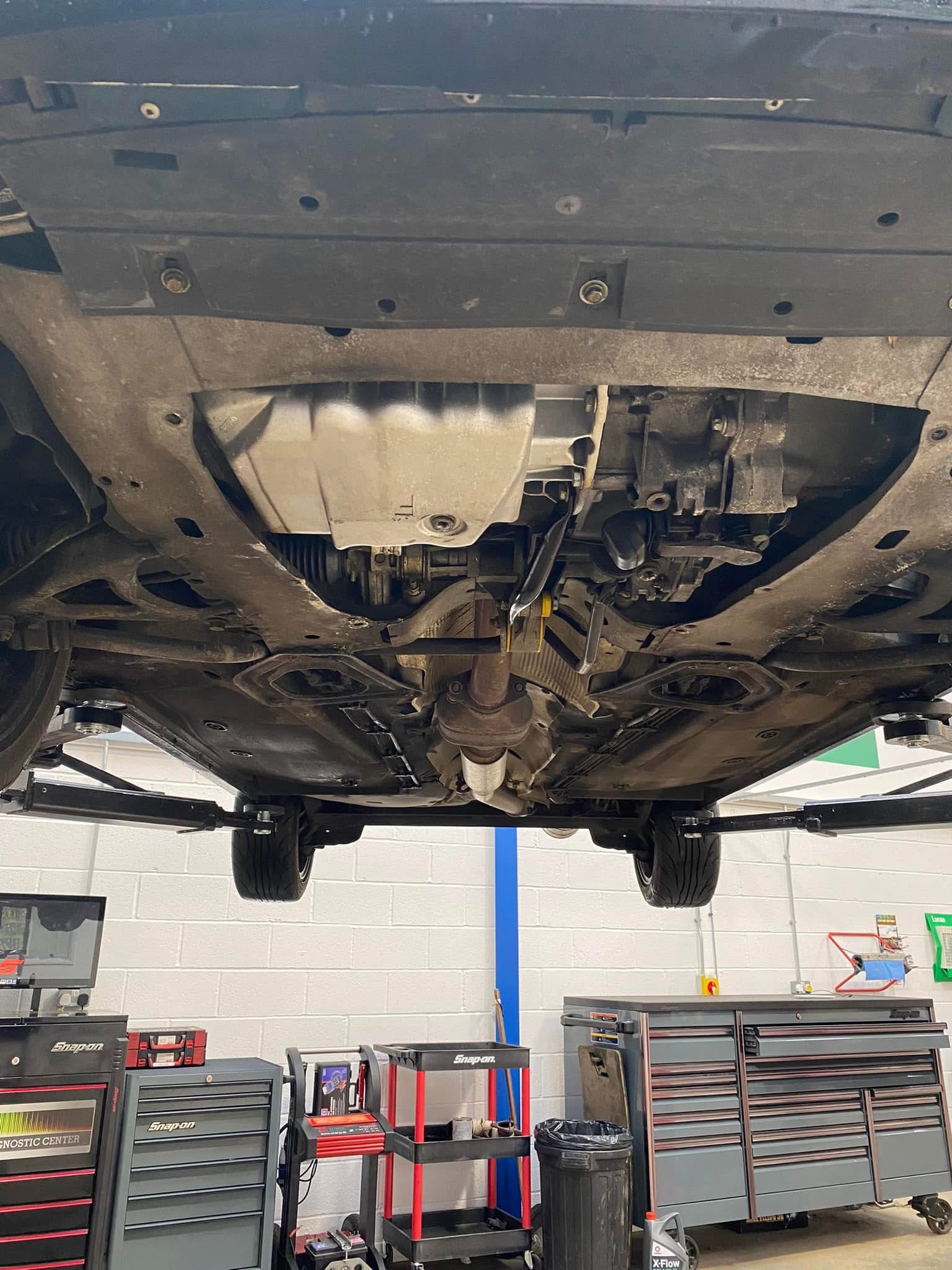

Its still alive and just been doing maintenance really, did the aux belt which wasn’t the most pleasant thing to do but the garage I had sent it to for a service wasn’t confident to do it so didn’t really fill me with any confidence them saying that but rather they be honest I guess.
