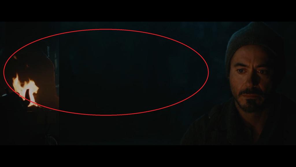

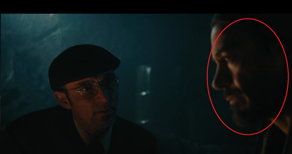

can anyone tell me what this problem i seem to be having is? i cant work out if its a poor downloaded copy of the film or if its my TV that cant handle the picture.
basically the only way i can describe it is "blocky" off blacks. so whenever its a dark picture (as below) the background thats suposed to be dark is really blocky.
i hope the quality is still in these pictures to give a proper example of what im trying to say.
its highly annoying and i understand if its the tv theres nothing i can do but it will help me with my choice in tv when i get a new one
as you can see the picture is great (faces are clear and crisp, but the rest is poor) but its not the complete package
(appologies if the pictures have been butchered by photobucket)

Lol I put them there to show where I was on about! Stupid thing is on my pc (on the same tv) the pictures looked fine for trying to explain what I was on about, on my iPad they look fine :(
What's the details of the movie? (GB, pixels, bit rate?).
I've seen this on really crap sources.
Jaff.
It's iron man in 1080p apparently from a bluray disk. It's in mp4 format, played on vlc and its about 1.7gb
frame width -1920
frame height - 800
data rate - 1781kbps
Total bitrate - 1873
and 23 frames/sec

You've got black lines top and bottom - I bet they make up the missing 280 lines ;)
It's a download in .mkv meaning it'll be compressed. BRs are about 20-30GB unless they're dual layer and that's doubled ;) If youve got a file that's less than 10% original size, you're going to see losses.
Get a real BR on the go and see what it looks like.

And that's your problem.
Nothing wrong with .mp4, but for a 1080p file, you need 4,000 kps+ and around 5-8gb in file size.
I'm taking a wild guess at a YIFY file? If so, they are crap (no 5.1 either).

1GB compression of a 30GB file, what did you expect?
Blu ray bit rates can top 40Mbit/s and your file is 1.9Mbit/s
